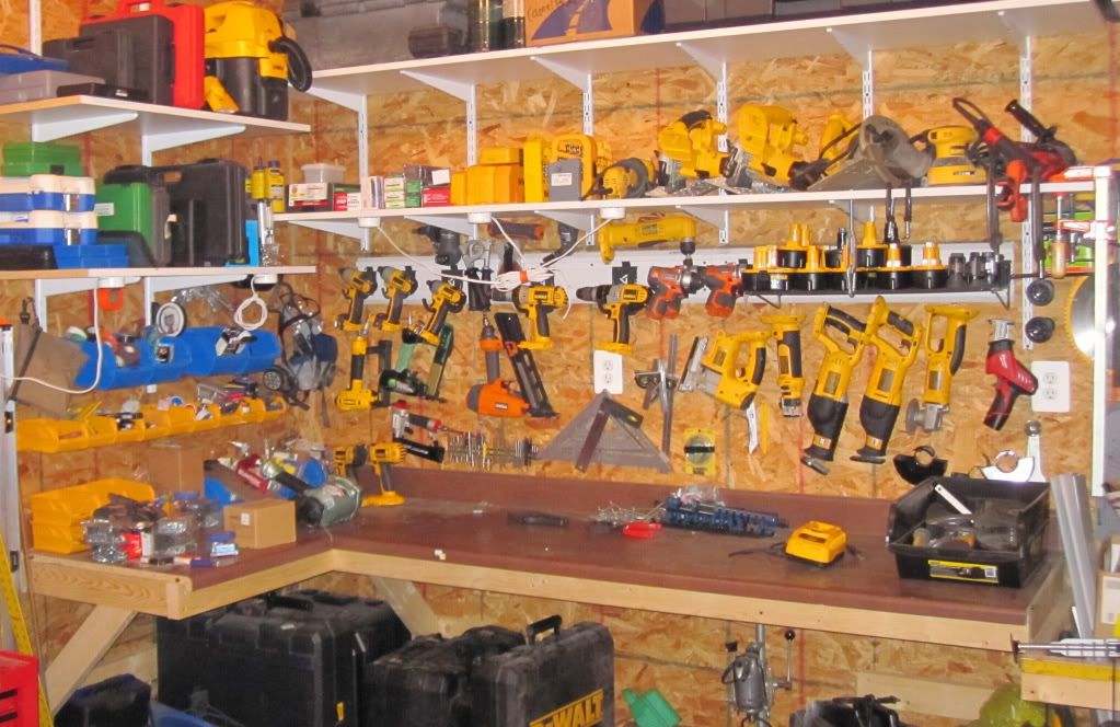

Just caught up on your build, looks like you are moving along! I have to give you credit in doing this in a 100 year old house!
My house was built in 1915 so I sympathise. My wife and I moved in 2 years ago and I have only just begun ripping out all the old knob and tube; god I hate that stuff.... The only good thing is that is giving me an excuse to rip out the plaster lathe and properly insulate.
My basement, unfourtunately is not dry like yours, with all the rain we've had I've been realizing how bad the drainage is around the house.
Good luck with the HT and baby! I will be checking in to see how things are going. I'm looking forward to the rotary sub build!
One more thing, I have to add on the cordless/corded discussion; I use cordless for almost everything except concrete drilling (bigger than 3/16") for that I use a corded SDS and heavy duty grinding. Prolonged use of the grinder is murder on the batteries.
I've been using DeWalt for nearly 10 years and have been very happy with their performance. I think it does make a difference how many batteries one has (I have about 25 XRP just for the Dewalt stuff) I always have a couple fully charged batteries waiting....
I have a bunch of stuff that is in tool bags in my truck that aren't in this picture...

You have an impressive amount of power tools! I still like my cords.

I have been "collecting" for a while.... It seems everything I do around the house "requires" a new tool
In any case "done" is a fluid goal! Keeping the wife happy seems to be a good bar to shoot for though. I would certainly love to have you over to check things out.
I would love to offer my services with your build as I love doing that sort of thing; finding time to get things done around my own house is hard enough though If I get some time, I will certainly drop you a note....
