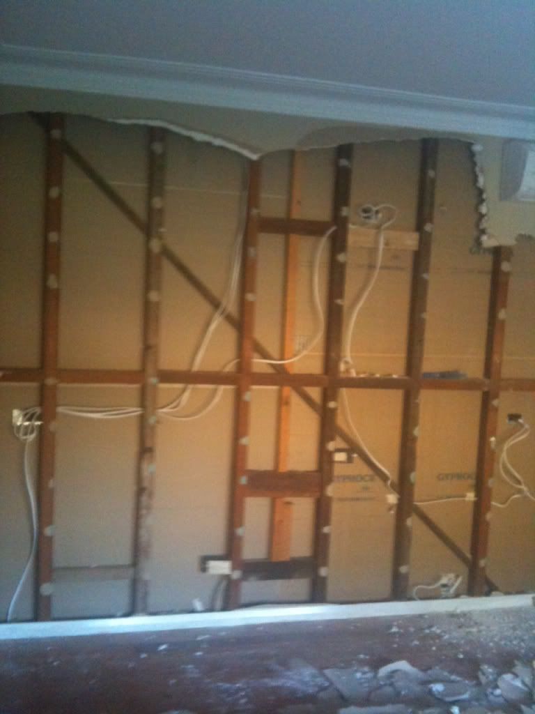

Well, up until now I had done just about everything except start the room. Today marked the first (of many) days of construction. Had the little fella in hospital yesterday with an ear operation but I managed to squeeze an hour or so this afternoon to start emptying out my room and demolition. Was looking forward to 'breaking drywall' but that first hammer swing on a perfectly good wall was a bit nerve wracking.
I managed to get most of the walls removed today. Have to clean up the remaining drywall, remove the ceiling (and that horrible blown insulation) remove the skirtings, make safe the electricals (which are 50 years old) and then I can lay the first of the soundproofing. Here are some iphone photos. Sorry about the poor quality.
I am hoping to do an hour or two each night this week to make sure that the mess is tidied up and I have a clean slate to get the construction happening. Have a question for those more learned than myself in terms of sound isolation. My home sits on brick piles and I have only timber floorboards (no concrete slab). I intend to lay some 19mm (about 3/4 inch) yellow tongue particle board over the existing flooring, with a layer of Green Glue between. I have two questions:
(1) Should I put the flooring down before I start drywalling the walls?
(2) I will be building a stud wall on two foot centres about 1 foot from the existing windows to block out the light and also for sound isolation. Should I lay the flooring to cover the whole existing flooring or should I build the stud wall and then lay the particle board within the new room measurements? My first instinct would be to just lay the flooring in the narrower room to avoid flanking but I am not sure.
Anyways, happy to be finally moving along with my build and to find a home for all my equipment (and unused projector still new in box!)
More updates to follow....

Lookin good mate - those hardwood studs?
PM Ted about the floor
I'd have thought it'd go in last, rationale being isolate it from the walls - leave a small gap and chaulk the gap with fire rated mastic

Hey there Peter,
How are things? Hope all is well. I tend to agree about the order you suggested. May be better to build the stud wall and then floor the area. I have some of the Green Glue acoustic caulk so will use that. If I run out I think the local stuff is cheaper and probably fine for that application. I am going to have an issue where the fire place was. There is a remaining brick / concrete pad where the previous open fire was. It sits probably 25mm proud of floor level. If I floor around it it will probably be close to level. May be a leakage point however. Only plus us that it will be under the riser so that will afford some isolation (was going to double ply the riser and green glue)
So, construction finally started! And I was enjoying living without drywall dust for a few months..... Atleast I can close the door on it and not have it go right through the house! How's that captive program going? Have your efforts borne fruit or simply provided respite from unwanted tensions????
Ps, yep. They are hardwood studs. I am hoping that the ceiling joists are equally solid to avoid having to beef it up for double drywall.

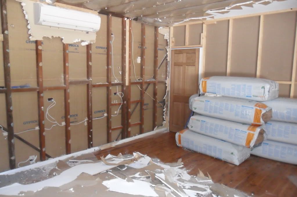

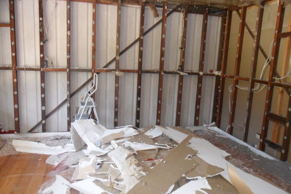

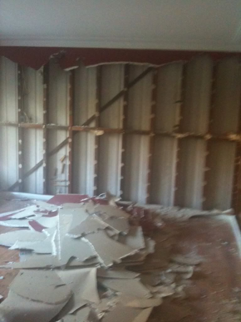

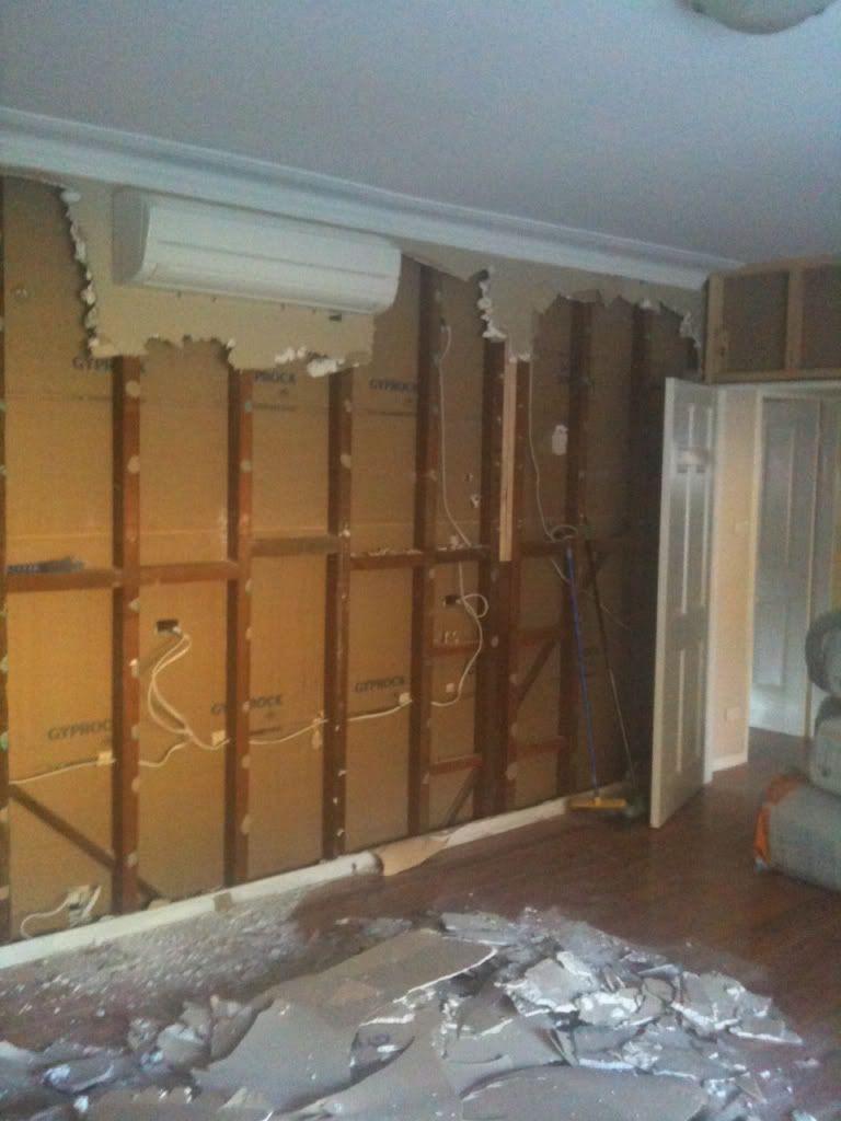

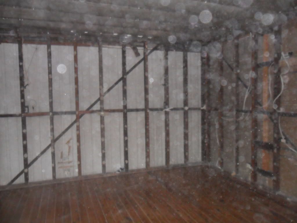

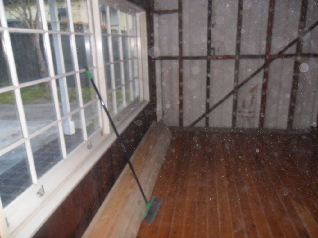

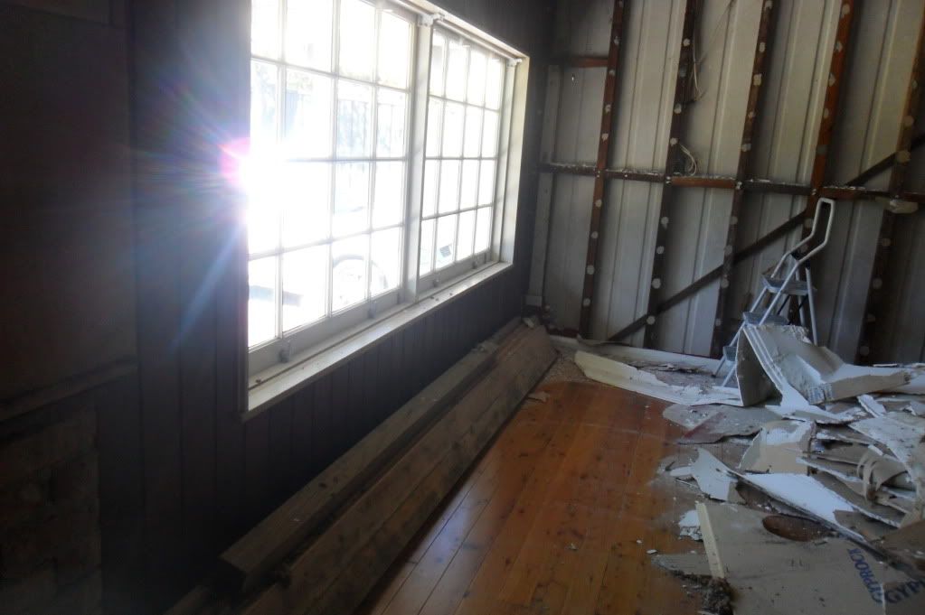

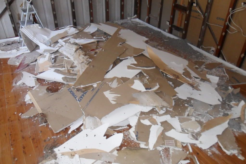

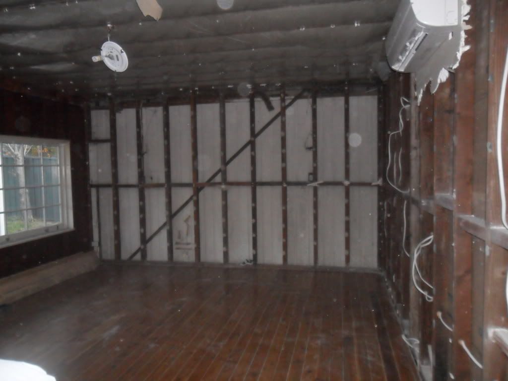

Thought I would just post some updated photos taken with my digital camera. Not great but much better than the last photos taken with the Iphone. Atleast the dust has settled down in the room a little.
I need to have the electrician back to remove the airconditioner head unit and evacuate the gas from the system. What a pain. Anyway, this will be a weak link in sound isolation if I don't remove it. Hopefully he can get here Monday to take it down and then I can finish that wall.
The bags in the corner are Knauf rockwool batts. They are R3.5 which are probably a little thicker than I need but at 2.00 per square metre on special, I thought they would be fine. Probably won't make much difference behind the other sound isolation measures but should keep the room nice and warm in winter. Oh, and they are not itchy to handle.
Above is a photo of the windows that will be blocked out. I have venetian blinds (which I took down during demo) and then I will block out the windows with black material on the inside behind the venetians. There will be an insulated stud wall the full length of the room which will totally block out any light and ensure that I get some effective isolation. Those windows leak sound terribly.
I estimate about 2 trailer loads of drywall and skirting boards to take to the rubbish dump. There goes another 100 bucks. Not sure about you guys in the US, but we pay through the teeth for garbage disposal here in Sydney. Since renovating my kitchen, knocking down a couple of walls and building the rear deck, I have shelled out over a thousand dollars in tipping charges
Well, no amount of posting photos and reading posts is going to get that pile in the middle of my lounge room cleaned up. Better get to it!

Two 6x4 trailer loads of drywall, 11 garbage bags of blown insulation (and that's just what fell out of the roof!), four hours of lugging waste outside, two Oxycontins (God bless prescription pain relief for back pain) and finally the room is clear. Won't be wanting to do that job again in a hurry. Took a photo tonight, 24 hours after finishing and it's still really dusty in there. Electrician will be here Thursday afternoon to take down the split system air-conditioner so that I can double drywall before remounting. Now I just need to pull out all of the old nails from the timbers and I am ready to get going. Here are some pictures from tonight. Sorry, but the dust is still a nightmare in there (even though you can't see it without using a flash).
Ordered lumber today. Silly me for thinking the majority of my money had been spent so far. Ordered some 19mm particle board for the subfloor, some 90x45mm pine for the side stud wall and some extra particle board for the riser cover. $1200 kaaaaching! Oh well, it's only money. Also needed some balustrades for the outside decking so it wasn't that bad.
Have decided that I am going to have a crack at drywalling myself (with the help of a couple of friends. (Don't worry Peter, you will get plenty of notice!) Finish doesn't need to be perfect, as I will be fabric lining the entire room. Best quote was about $1000 to do double drywall. That was two guys for two days, including the messing around with hat channel and GG. Figured that I could have a go at it. Would rather swear, drink beer and curse with friends than alone or pay someone else to swear and curse! Can borrow a drywall lift or pick one up for not much on Fleabay. Have a fair bit of work before I close those walls up in any case.
OK, so for todays question. I will be using double 16mm drywall, Green Glue and GG Whisper clips. What drywall screws do most people use here for double drywall applications? I understand that the first layer screws into the furring channel. What about the second layer? Does that just screw into the first layer of drywall or does it also affix to the channel?
So, framing starts on Saturday morning. Hope to get the framing for the stud wall done and maybe make a start on the flooring. Also need to finish off the rear decking with balustrading and get all of that squared away before I get too wrapped up in the theater room.
Would welcome any feedback....
