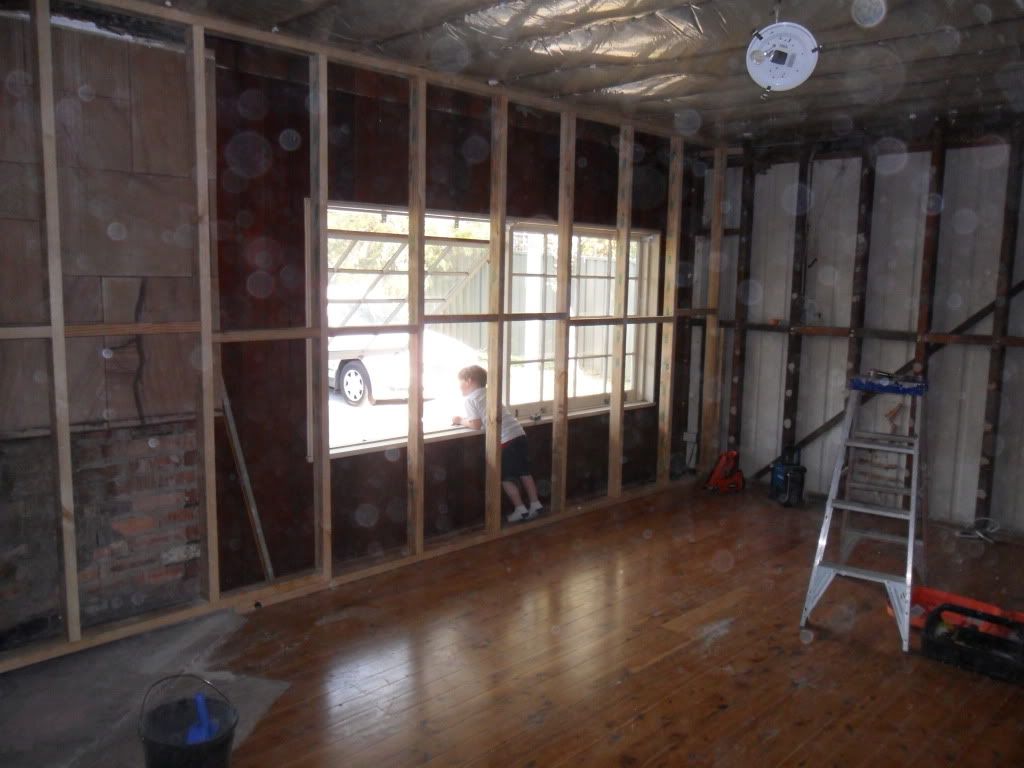

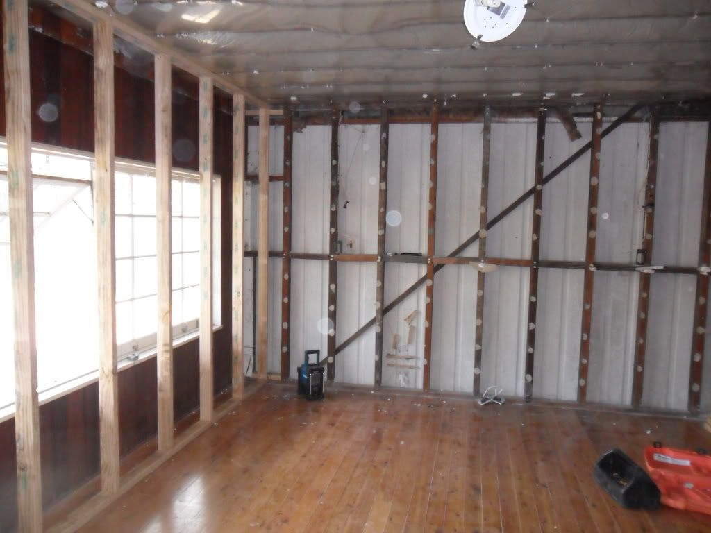

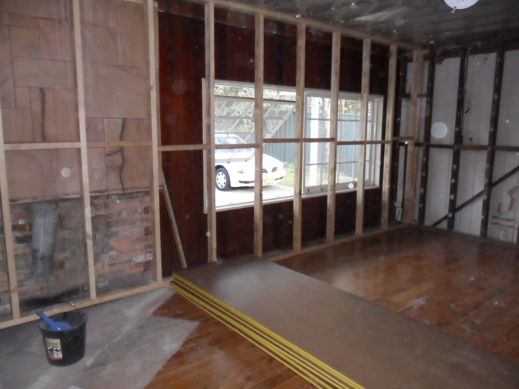

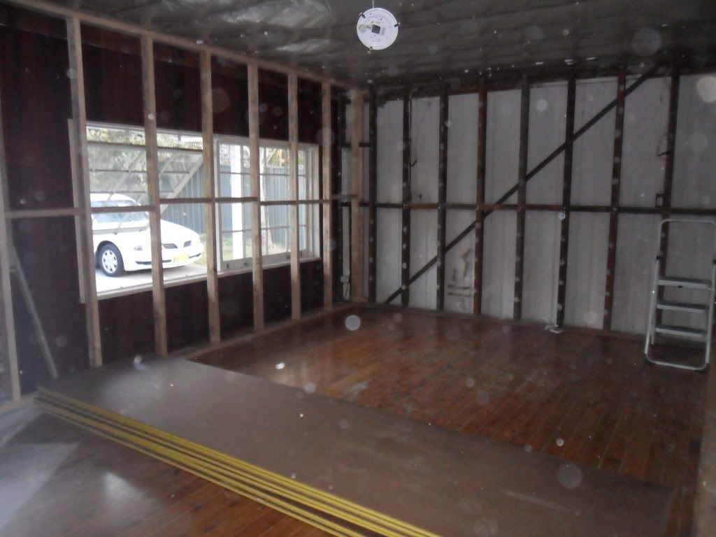

Sorry for the delay. I was going to post these photos a week ago when the work was completed but I had a 5 foot pile of insulation blocking my computer. Found somewhere else for that so here we go.
Managed to get the stud wall up last Saturday. a half day with my carpenter mate and 4YO to get the wall up. Sure it would have been faster with just the first two people. Anyway, the cinema will be just as much for Thomas as myself and I really want him to be involved in the process as much as possible (and safe)
Here are some photos...
I am planning to run most of my cables down behind that 1 foot gap under the window then conduit to outside the room. Obviously will be reinstalling the blinds and blacking out the windows.

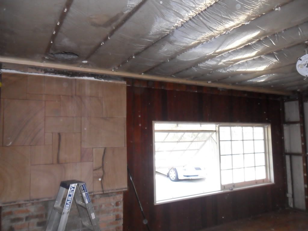

Hey there all,
Had a nice weekend away with the young apprentice to Canberra, which is the capital of Australia and about 3 hours drive from home. Enjoyed myself and called into Bunnings (again!) and picked up a new addition. No excuses for not working at night now... All for 30 bucks! God bless China!
Anyway, that, in combination with all of my drywall screws, wood screws for mounting the clips and a chalk line / level and I am set to get moving on the clips. Came home to what was (before I left) a very tidy room....
This is the small pile of fluff. The plastic that held it up is in pretty poor condition. Need to bang some nails or staples in to hold them up. The new drywall and channel should support them better. I will simply lay the R3.5 batts on top of what little blown insulation is left.

Looking good my friend! Enjoyed the photos of Thomas. Brings back many memories from the early days of Twinseltown. Cherish it man. There's nothing else more important.
Are you going to have access to that 1' space behind the windows? I see the windows open outward. Not sure if it matters, but seems like a feature you might need one day. Maybe when the possums.....errr, koalas take up residence in that nice, cool, private home you've built, the window gives an easy way to extract them? LOL

Hey there Tony,
It's been great to have Thomas involved with the work where I can. I drew the line with him painting outside, where more paint ended up on the grass than the timber posts. He's here on weekends so I try to find some jobs that he can do Will be nice to have a handyman look after me in my old age! You are so right... It's all about him and the moments are gone all too fast.
I wasn't planning on having access to that I foot gap. It's actually less than 1 foot for a lot of the wall, as the chimney intrudes on that space. I see the benefit of having some access point however it may cause an issue with the soundproofing efforts.
With regards to that, I managed to get about 1/3 of the clips and channel up by myself. Wasn't a lot of fun being dumped on with blown insulation and caused a lot of mess. Broke my drill bit so need to take a trip to the hardware for a good drill and driver for the clips. Wore out a couple of my Cheapies today. I will post some photos when I get the rest of the channel up. It's not so hard but it is fiddly work. Predrilling the hardwood was a monumental PITA!
Hopefully have the channel up by the end of the week and then I can start the prewiring.

Hi Greg,
Your clips and channel look good ... very neat and tidy installation.
I'd suggest you think about removing all the blown paper insulation ... that stuff sounds like a real fire hazard ... be very careful if you have any lights near it !

Lookin good Greg....you've got more patience than me, I'd have broken a dozen drill bits by now! one or two is pretty good!
I'll echo PeterM's comments on the insulation. Get someone to take that out......or go hire a massive dust extractor for a weekend (I mean massive, with like a 10" hose on it)...particularly given where you live

All good points. Thanks guys. I will look into it. Not going to run any electrics across the ceiling. Removing and making safe the current oyster light (very stylish!) but I understand it would be better to get rid of the stuff. Problem is that it's above every room. There's stacks if it.

Hey there mate,
Thanks for joining the madness. I have hit the dizzy heights of four subscribers now! Hold on tight... Its gonna be thrilling!
There are a few of us on here now. Causing trouble whenever we can, mainly building everything except home theaters! So far I have managed a deck and a new kitchen. Peter M takes the cake with building a whole house and the other Peter ran out of funds/steam/time/spousal approval after building the Taj Mahal of dog kennels. Figured it was about time for me to start on the theatre room otherwise the ANZUS treaty was in doubt. you know what these Americans are like.....
Ex picked up my son and left about 7.30 tonight. Gave me the opportunity to crack another couple of hours in. Have all but four of the ceiling channels in now. Actually had a few extra clips so I have used a few more clips on the ceiling than I probably needed to. Would rather avoid having half a Tonne of gyprock 16mm x2 falling on my head.
I have decided to go with the double particle board/ green glue sandwich for the floor. As much as I want to avoid the extra four hundred bucks I may as well do it as best as I can afford. Hopefully it will be enough. I am also being mindful of the fact that this is a ten year house so I don't want to overspend too much as the reality is that I will knock down and rebuild down the track.
I hope to finish the channel tomorrow night and then look at sorting out some of the wiring. I have only 50 metres of 12 AWG speaker wire so I think I may need to get some more in order for the surrounds.
