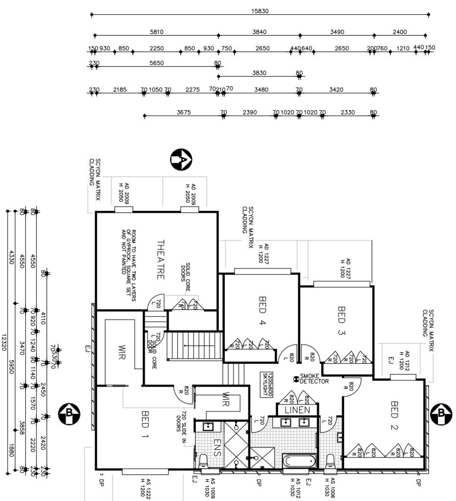

OK, worked out how to post pics properly now. Here are the internal floorplans, both upstairs and downstairs. The reason for the staggered shape of the front of the home is that there is a sewage pipe that runs diagonally across what would normally be the building platform. Did I forget to mention that????? So did the Real Estate Agent!
Downstairs
Upstairs (Theatre Level)
We really had to compromise on the theatre location, due to very strict council regulations. We have height restrictions with our local government, which has seen our home change from a dwelling with a high pitched gabled roof and a theatre room right at the base of the block to a flat roof home with the theatre now above the garage. Still, I have done my best to work around the issues and hopefully with the forthcoming work, we will end up with a great home and home theatre.

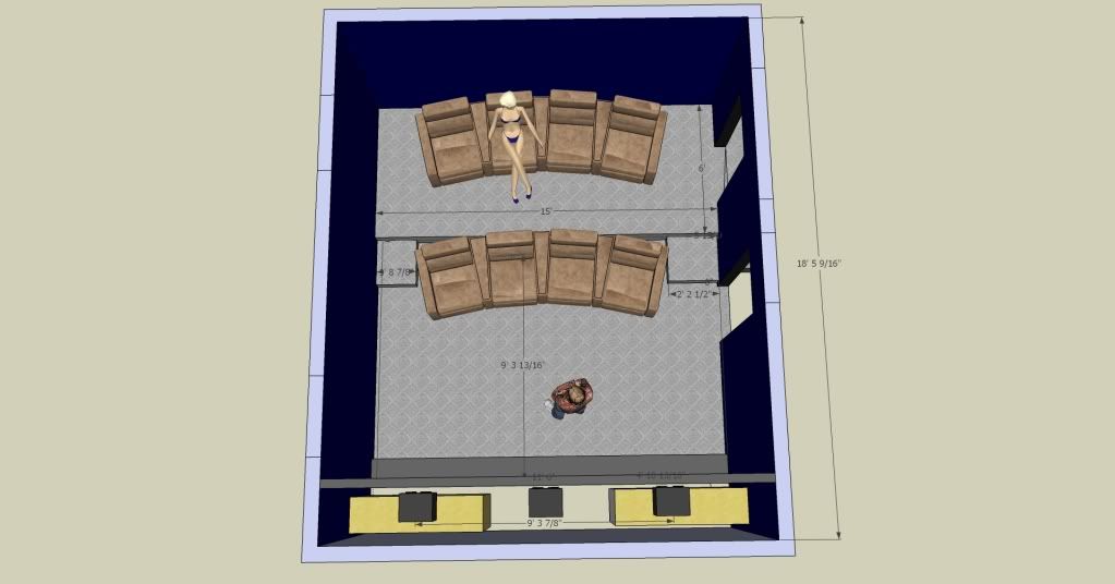

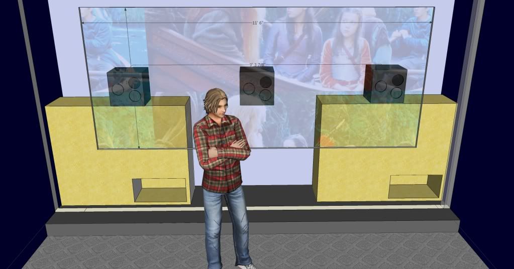

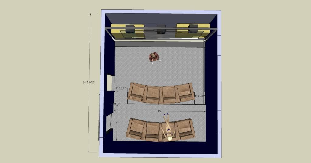

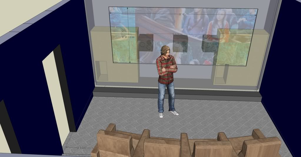

OK guys, this is an option for the proposed layout of the room. Basically, I have a room that sits atop the garage of our new home. It will measure 18.5 feet long x 15 feet wide x 8 feet high and also has a separate equipment room which should be more than adequate to hold my equipment stands. Entry will be by a two (exterior grade solid) door system to eliminate as much sound leakage as possible. The room will have a reasonable level of sound isolation built in (green Glue, double 5/8" drywall and GG clips for all walls, ceiling and Green Glue on the subfloor).
The plans will be a little different than what we are ending up with. The builder will now be supplying a single door to the equipment closet. This is something that showed up when the room was drawn with Sketchup (thanks again Tony!). Apart from that, it is all pretty much as the plans are. I am looking to build a false wall, approximately 20-24 inches in depth on the left hand wall (the Danleys are 16 inches thick and I need to leave some room for wall treatments). The false wall will be covered entirely by the screen and black acoustically transparent material from a local supplier here in Australia (RIM Fabrics Trilogy One range).
At the other end of the room will be a 6 foot deep riser, between 10-12 inches in height (to be calculated still) and two rows of 4 recliners, giving us seating for eight. I know that we are trying to fit a fair bit into a medium sized room, but that is all that I have to work with. Here are some Sketches of what I am thinking...
Here are the recliners that we have. We have two rows of these, in this colour. Apologies for the poor quality scan
The windows will be plugged with multiple layers of GG and then covered with fabric. I have not decided on any internal sound treatments yet. I know that many over there use Linacoustic but I cannot find it over here and as soon as you mention Home Theatre over here, prices just skyrocket. This is very much a limited budget project.
So, over to you guys now. This is the general plan at this point. I guess there are more options out there than I have considered. The main limiting factors that I have are the length of the room and how it affects the A-Lens and the placement of the Danleys. My preference would be for them to be put behind the front wall. There is the option to build them into the riser, but then it would be very high (about 17-18 inches high) and I only have 8 foot (2440mm) ceilings.
I had not really considered building soffits in the room, as I feel that they would encroach upon the limited space that I have. I have purchased 6 art deco themed sconce lights, which I will dig up and post. Actually came from a fellow AVS'er who lives in Melbourne. Hopefully they will illuminate the room enough for it's purpose. Don't want to use downlights as I am trying to minimise the amount of holes in the drywall to reduce sound leakage.
Any opinions of the layout would be warmly welcomed.

Hmm feedback, ok.....well - like me you're obviously trying to maximise seating, having a row against the back wall isn't a good idea - I'd drag them forward as much as you can, even if it means they cant recline, it'll sound better
I think you're going to need additional subs, even with the Danleys (I'm so jealous....this Vaf thing of mine had better live up to the hype...hey they build speakers flat at 19hz this has gotta be good right?)
Think about treatment - especially in the riser, you cant change that easily. I'd pay to have it designed as a trap, even if you get nothing else done.

Thanks for the feedback mate. I agree that moving the seats off the wall will give much better sound. I think from memory the seats are only about 4 - 4.5 feet deep even with the foot rest up, so a six foot riser should be OK to still have them off the wall, even if it's only a foot or just over off the rear wall. I will move them as far forward as possible. If I need to add a little depth to the riser I will. I have a feeling that the screen will be smaller in size than originally planned, so viewing angles can be maintained by moving the front row forward just a little. I guess a lot is going to be worked out once I can get the seats into the room and actually watch a few programs and see what viewing angles suit us, how the projector and lens work at different sizes and what just looks 'right'.
With regards to the riser, I was planning to stuff it to capacity with R3.5 fibreglass batts to quieten it down (I have about 8 large bags filling up my garage from the failed insulation scheme sell-off). I have read a little about drilling through the joists but I am unsure as to how that will achieve any effect. There must be some but any ideas would be welcome. Would there be a noticeable improvement in room acoustics by doing this? Also, can you give me an idea how much that acoustic matting cost you that you used under your stud walls. Would it be of benefit to use that under the stage (which is where the Danleys will most likely be located)?
I think that I will work out the other acoustic treatments a little further into the project. I see all these great theatres on here with the OC703 bass traps. I think our equivalent is the Ultratel but I am not sure if the budget would stretch to doing the front wall and bass traps in that material. It's about $100 a piece. OUCH!

OK, me back again with a question. I am not far off having to let the builder know about building materials for the HT. This is the plan so far:
I have tried to encompass as much in the design as I know for stopping sound exiting the room. It is important that this is an area that I can go to and watch movies at a time that suits me and not upset other members of the family and neighbours. I have an understanding wife (most of the time!) and a 3yo boy who goes to bed early. I work shift work, so I am often watching at odd hours. In line with the various constraints that I had with regards to Council height requirements, the need to have windows incorporated into the plans and space limitations, I have managed to incorporate a double door arrangement, which will hopefully reduce significantly any sound leakage through this means. The doors will be solid core, exterior grade and I will be sealing them on the bottom of the door with a standard rubber door seal (something simple).
I have also managed to incorporate an air space between the Home Theatre wall and bedroom 4. What would be the recommended material to line this cavity to provide the greatest sound insulation and prevent noise travelling into that room from the HT?
I have designed the Master Bedroom so that one of the Walk in Robes is adjoining the HT. I anticipate using a solid core sliding cavity door on this WIR to further reduce sound transmission into the Master Bedroom.
The Equipment room will have a single exterior grade solid core door to reduce the noise from equipment fans entering the HT.
Other factors in the proposed design:
*Standard construction 2 x 4 wall studs
*All walls and the ceiling within the home theatre and the equipment room will be
mounted on Whisper Clips.
*Walls and ceiling will be double drywall layered with Green Glue.
*Windows will be plugged with multiple layers of drywall with Green Glue.
*The floor will be double skinned with Green Glue to stop sound leakage to the
garage and through the subfloor into other rooms. Floor will be carpeted, using thick
rubber underlay.
*The whole room will be fabric covered (including the ceiling). There will be some sort of
acoustic treatment under the AT fabric (to be worked out later). I am using
FabricMate track (expensive but hopefully worthwhile - cost me a small fortune to
freight the tracks over here!)
First question at this point is what drywall should I be using. My understanding is that when using GG and whisper clips, it is unnecessary to spend the extra for the acoustic drywall. This material is quite expensive over here. I am hoping that 5/8" drywall (double layered) should be enough for what I am hoping.
Any feedback from you guys out there would be great. I am sure that there will be a million more questions along the way regarding just about everything, but I am going to need to specify building materials pretty soon so your advice would be great.
I am thick skinned, so please be honest. Feel free to comment on absolutely anything about the layout, plans, equipment choice, screen size, whatever. This project is a learning experience for me and I am hoping that, with your help, it can be a success.
Thanks guys once again. For those who have been in contact with me, I really appreciate it. Please keep the comments coming....even the nasty ones about me showing my age with Laserdiscs. Sorry, But I also have a very nice Coleco-Vision video game system and Atari 2600 in the garage if you feel the need to strike a real low blow. Cheers!

Wow, slow down there. In no particular order:
- shearflex is $35 a sheet of 300x300. But no it wont help your issue. You need to isolate the floor somehow, otherwise your measures with the whisper clips will be wasted as the floor will flank the entire house
- give Embelton a call and tell them what you're doing, they're really good guys, they'll be able to tell you what you need - they have isolating stuff for floors.
- In terms of the gyprock you use, I'll be using 16mm fire rates BGC board, its cheap and high quality (yes, I know that sounds odd)
- Dont buy Ultratel - www.acoustica.com.au sell a polyester product which is cheaper, the dame density and you can sleep on it (i.e. no fibreglass problems)
- bass trap riser - you need to design the inside of it to maximise volume around the edge of it.....from what I understand, which might be wrong. Drilling holes isn't enough. You need basically something the same size as a HVAC bar diffuser opening(s)...I think I might have some info on it in my thread somewhere....yeah good luck with that
- acoustica also sell an isolation underlay, its not cheap, but I think I'll use it, but you will need more than that on the floor
- seal the whole room with Bostik 1, its the largest flex, fire rated sealant you can buy in Oz.
Have a read of my thread a bit more, I've referenced most materials there that are locally available, I've looked into densities, construction etc etc - save yourself the hassle
Underlay - if you dont go witht he Acoustica stuff you want thick felt, its better for acoustics, not so soft. DONT get rubber, it just compresses over time, even foam is better
I love the look of laser disks, it'd be great to see Starwars on one.....I've got an old ninteno somewhere.....plus a 128kb "word store" the size of an encyclopedia....need to toss that
Oh if you're buying tiles (and have a choice from your builder), the best tile shop in Sydney happens to be in Waitara, Ceramic Fashions, talk with Tina and Max - I cant speak highly enough about them....again, after 2 reno's and a build we have that one narrowed down. Bathroom products - WC Bath and Shower in Chatswood (they're the snotty version of a large plumbing group from down south). Reece in Artarmon are also good (nice assistants too )
Edit - do the whisper clips come with instructions, I read somewhere they dont work if you over torque the screws, another important, small detail
Instructions are up to the supplier. We have our own proprietary SIMs for that. Over-torquing causing a reduction in isolation is not a concern with these clips.
Hi Ted, nice to see you here. Really appreciate and respect your comments. Hope that you will bear with me through this build. The whole sound isolation process has been a very steep learning curve and I am humbled by those who have so much knowledge in this field. Thanks for your input. Please feel free to critique to your hearts content! Regards. Greg.
Hi there Peter. Thanks mate. Sorry for all of the questions. I just have so many questions and ideas going around in my head they all just pour out sometimes...
With regards to the floor, I was going to lay another floor over that supplied by the builder and use Green Glue between the layers. I was hoping that this would help somewhat in isolating any sound from leaving the room via this means.
Thanks for the tip on the gyprock. I will make some enquiries about this material.
The price of the ultratel was worrying me. I will look into the acoustic product. This would Aldo be ok cut down for bass traps in the front corners?
I will make some enquiries. Thanks for that.

You putting in two DTS-10's? You are a naughty boy aren't you? I'm enjoying my one Super Spud immensely. Good luck on your build it looks like it's going to be incredible!

Hi there Flyng,
I went for the second Danley for two reasons. The main was after hearing from another user on the forum (Tony123) who had so many placement problems using one. From the very size of them, placement options are a little more limiting than other subs. He has found the second unit has brought his bass to life. Oh, and the other reason.... because I really, really really didn't need it! But at the price, they were a steal. Believe me that they cost not much less each to sea freight them over here.
Thanks for dropping by.
