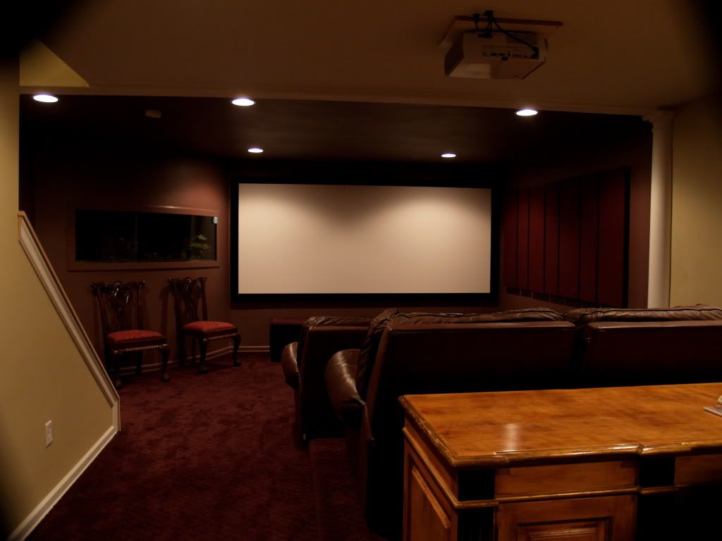

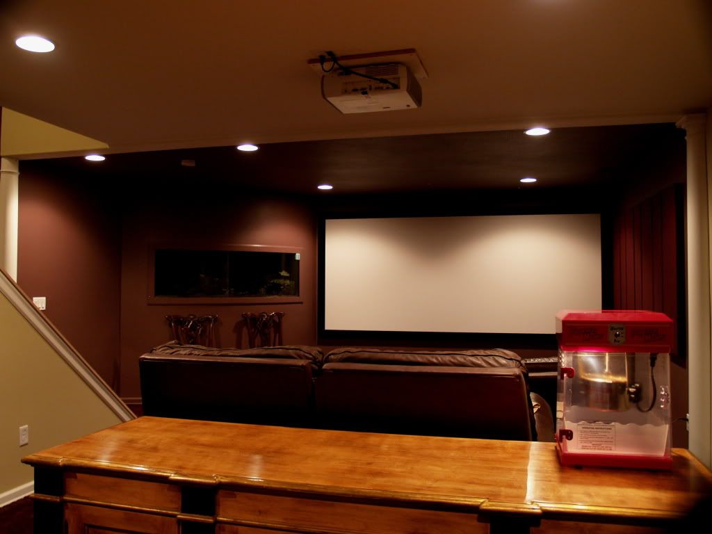

Wow Jeff,
Was'nt me that I can promise you, I enjoyed our discussion greatly, you were most helpful!
This thread peaked my interest greatly, I have always found star ceilings sort of "gimicky" and "everyone has one,so theyre un-original these days" but in all fairness........when done properly they are incredible and what else can you really do with a ceiling to make it neat?
I have a smaller theater Im experimenting with and this is one of the things I want to see the possibilities
Like I said, nothing much to look at (the curved reef tank is cool but cant take good pics while its on) so a star ceiling would really help.
Im going to order some of Jeffs ( thread starter) paint and try it, while waiting I had the wife pick up some yesterday from a local guy who claims the best star paint available and supposedly lasts 48 hours, this claim is bogus, it might be glowing but you would need to be a black hole with a magnifying glass, it loses its luster in under a half hour.
With this product it charges with a normal light but you have to move the light around, Black light charges it as well but same story, you have to move the light close (3-4') and sweep the entire ceiling.
At first its kind of cool and realist other than the stars arent white, theyre a greenish "glow in the dark" color. I think a WHITE ceiling is a must for this to work properly, my ceiling is dark burgandy as the pics show. This stuff stains the ceiling, you can definately see it with lights on in theater. My guess is it has to be this way. For theater use whos going to have a white ceiling washing out their screens? Im guessing to make this cool you would have to pre-paint the stars white first, then apply several coats of the star paint as mentioned in the instructions ( it states 2-3 coats on dark ceilings, I have 2-3 in areas)
After first charged and in a black out condition, the stars reflect outwards actually lighting up the ceiling making it slightly blotchy even on dark ceilings, after a couple minutes this disappears and your eyes adjust and I think your brain helps the effect by taking a little of the "glow in the dark" greenish look out and you actually think they're real looking. Dont get me wrong its very cool.......but not the color of real stars, hopefully Jeffs stuff is different.
My advice on star placement is this........a little is ALOT, your eyes multiply the stars with a fill in the blank type effect so if you go crazy with 50 stars in a sq. ft. youre screwing up. In a 15' by 15' ceiling I would have about 1 Big star per foot but not every sq foot, you may have a 4 sq.ft. area with no Big stars and very few if any little stars. Put three big stars clumped her and there with a couple randomly scattered through out. Smaller stars need to be the same and in Lightning boltish patterns across corners. So go 4'-6' up one wall and end 2' off the adjacent wall in a line flucuating between a couple inche and maybe 1' wide. Remember a little is Alot, you can always add more later. Large (1/4"- 3/8") to small (1/16")
We charged ours before a movie last night and after the movie it was barely glowing if glowing at all.
Hopefully Jeffs paint is much better than this stuff, it must be , he takes pictures of it andit looks good, I cant pull that off with this stuff........Ill try later
