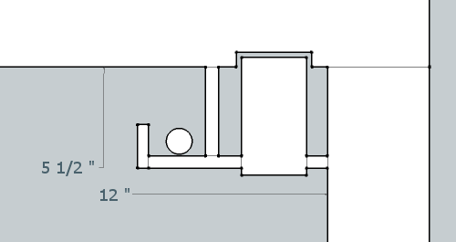

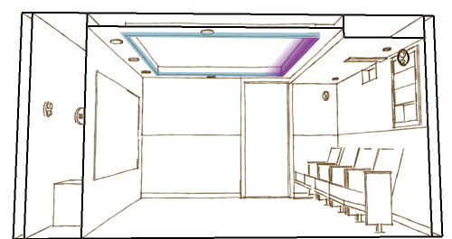

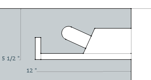

Thanks for all the detailed info guys. A few more specifics regarding my plan...
The soffit will only drop about 5 1/2" from the ceiling, due to the ceiling being low and the soffit potentially interfering with the existing door frame. Rather than a full drywalled soffit it will be more of a wooden tray with only the inside face of the side and front soffit drywalled (due to the recessed lights.) At the rear of the room the "soffit" will just be a wooden tray attached to an existing soffit containing the HVAC duct, unless I determine that a more robust structure will be needed to support the tray, in which case I will add frame and drywall here as well.
My plan is to have rope around the sides and front (probably blue?), and a black light in the rear. The internal dimensions of the ceiling will actually only be 6' x 6' so I was thinking that a 4' tube at the rear would be sufficient to illuminate the ceiling. I'm hoping to achieve an effect similar to early evening darkness whereby the brightest stars and darkest sky will be almost overhead, and the stars would fade out somewhat as the blue rope illuminates more of the "horizon" line.
Rough sketch of the front & side soffit with recessed cans and rope light...
Rough sketch of the rear soffit with 4' fluorescent black light installed at an angle...
Having never done, or even seen anything like this in person I'm having difficulty visualizing the end result - any comments on the approach would be greatly appreciated!

OK, that helps. And, with the area to be painted only 6 x 6... that should make things easier to get by with a soffit that is close to the ceiling.
I think that it will work out fine... but let me offer a couple of other options just to see what you think.
First, you might want to consider 2 black lights... on in the front and one in the back. They would charge the entire ceiling... which is important to what you are trying to accomplish.
Then, maybe instead of regular rope lighting... you get some of the new LED rope lights that you can dim and also make brighter by just a remote control. You can also create something like 30 different color combinations (I can't remember the number of colors that you can create, but it was quite a few) with one strand. So, if you want blue... you just adjust the LEDs to show blue. Want red... same thing and so on. So, with one string of lights... you can create any number of moods and looks.
Now, charge up the paint by turning on the black lights. Then, turn them off and turn on the LED strip and adjust the color and brightness to get the effect that you want. You can wash some of the stars out in the rear of the room as if that were the western sky at night... and it would get darker as you go towards the center. You could also accomplish the look by having a good, high powered UV Black Light panel (I have an American DJ 160 watt panel that has 4 lights in it that would do the trick) that you use to charge up the paint for about 5 to 10 minutes and then put it away. Then, you do the LED light trick. I'm thinking that you want to do away with an on-the-ground black light... but in case it doesn't work in the soffit area, a ground one would. Plus, that 4 light box will zap those stars really quickly!
I think, from what you are saying, that the LED's that can change colors and brightness (my wife has been trying to find a brightness remote that would work on me for a while, with no luck) would be really perfect for the effects that you are going for. Then, even if you don't want to charge up the stars... you could still play with the lighting.
