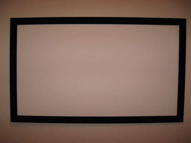

I hung the screen in a more permanent position today, in order to get a better feel for how the projector needs to be rehung. Here are a couple pics...
As you can (hardly) tell, the projected image isn't square, the PJ needs to be dropped about a foot.

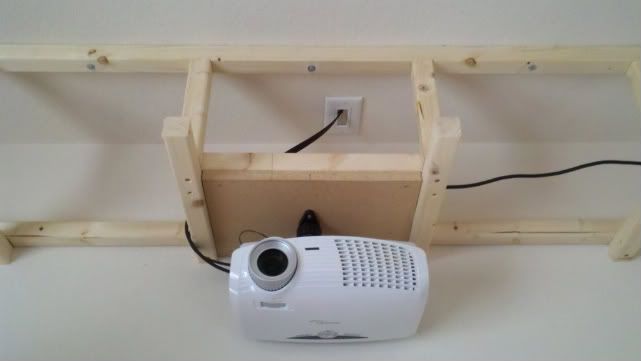

I dropped the PJ down to where it should hang. Although its sits very close to the wall. I was able to find a 90 degree power cable for it, I had to order a 90 degree HDMI adapter... The cable presses against the wall, not allowing the projected image to come far enough down on the screen. The adapter will be in tomorrow, I'll post an updated screenie when installed.

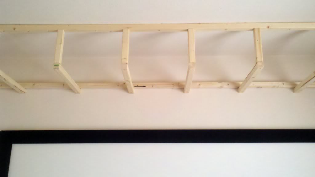

A quick update on my theater room. The soffit is coming along nicely. Its all framed out and ready for sheet rock. I was planing on using 1/4" sheet rock to keep it light, but I'm convinced this thing is sturdy enough for 5/8".
I have my sights on pot lights and rope lighting, I'll keep you posted.

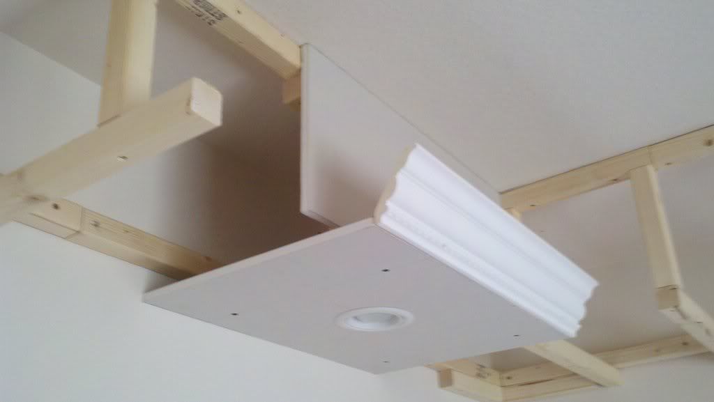

Here is a quick mockup I did tonight, it turned out looking very good IMO. Please give me some criticism, do you like it, would you use MDF instead??

post #74 of 323 Old 12-18-2010, 11:51 PM
edmove's Avatar
Location: Iowa
Posts: 333
That looks great. I am going to have to redo my soffit molding. I want to do a star field on my ceiling now and need to hide the black lights. Looking forward to seeing your completed soffit.
How is the crown molding held in place? Is there a brace or gusset behind it attached to the top of the piece of drywall in some way?

As you can see in the pcture, just to the left of the mockup, the 2X2. The crown moulding will be nailed in every 16 inches. The moulding is a foam form, very light weight. I think it will be ok without a gusset, what do you think??
I have a sheet of 1/4 inch masonite, I could lay that down across the 2X2, giving my a brace/gusset that could be glued in place. That would give me a place to install rope/black lighting too.
Actually, if it were made of wood, it might be okay. But foam, ehhhhh, not so much.
I'd maybe throw another 2x2 across the tops of all those protruding 2x2s and really get some backing behind that crown. As it is, it could either sag down between the supports, or those brads could push too far through the foam and end up not providing any support at all.

Thanks for your opinion Drew_V, but I'm sure the foam molding will be fine. It's very light weight, and the way its made leaves no room for sagging. I have yet to commit to my mockup, just throwing it together to get some opinions and pointers.

FWIW, this framing is similar to how I did my soffit in my basement and the I had drywall crew hang and they just finished. This is not the ideal way for framing as it doesn't provide a consistent edge for the corner bead at the bottom for the finished product. My work wasn't perfect and I had edges that ran over 20'...this showed the 'waves' when the corner bead was put on....we'll see how the crew finishes to hide my framing sins. bottom line, I had to reinforce the braces as they had 'twist and play'. When I get to my theater, I will change the way I frame the soffit.

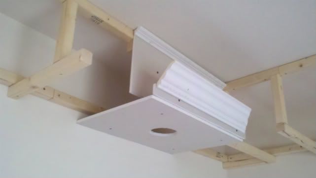

Here is another mockup of my soffit. I still plan on using a different method of installing the crown moulding (reinforced) . This picture shows the pot light I will end up using in the finished product. I really like how the bulb is recessed as opposed to the earlier light used in the pictures above.

Here is a new and improved mockup with crown molding support. What do you guys think?? I'm only hours away from kicking off the soffit sheet rock installation. Input would be great! I'm going to use bull nose corner bead around the edge.
Please give me some feedback.
