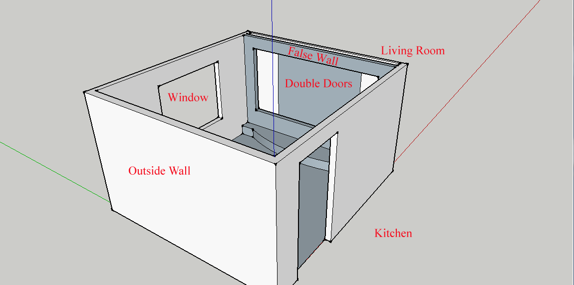

Here is a mock-up using Sketchup...
The door to the kitchen is a slider. The double doors will be locked, a good access point for my equipment wiring (equipment cabinet not in drawing). The screen as shown, is a bit larger (scale) than planned. Still debating on an AT screen with speakers behind.
I plan on building a plug for the window to block any light entering the room.
What do you guys think??

How about a sectional, would that be better? I'd like to have it seat 4 to 5 people comfortably.
So if I do without a stage, I'd like to have some cabinets underneath the screen to house my equipment. Maybe a HUGE built in entertainment center, allowing me to use bookshelf size speakers on either side of the screen, and a center channel too.
I would like to go as "all out" as possible. LandShark's theater build is a good inspiration for me. I've always liked his modest build.
I'm using Sketchup right now, designing a couple mockups.
I agree. In that size room your choices are very limited. You can use a coach or you can get actual cinema chairs. Four cinema chairs will fit fairly well. My room is 11.5' x 13.5' and I was able to fit a 106" AT masking screen along with four subwoofers. I use a couch 2.5' off the back wall. My room is also sound treated. With careful planing you can do a lot with a small room.
mjg100 is offline

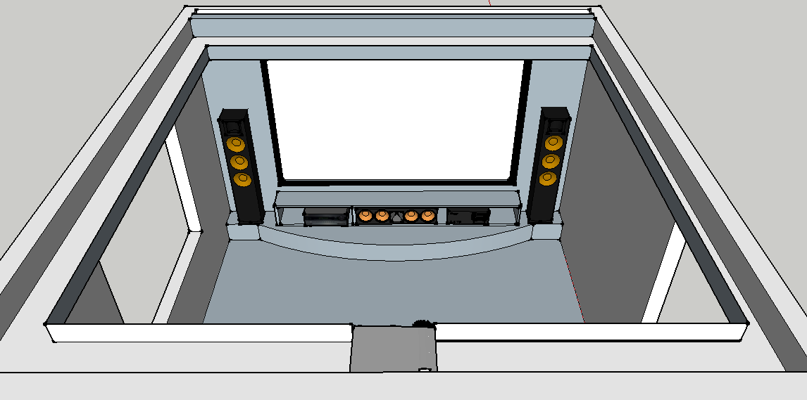

So how does my drawing look so far??

I have come a long way with the Skethcup mockup... I will post it up tomorrow. I wanna show you guys my riser idea.

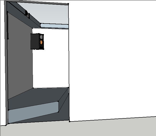

1. Given where your door is and the size of the room, your riser idea looks challenging, as it appears you'll either have to immediately step up into the room or make the riser narrower than the room, which is already borderline width for the seating you want. Can you elaborate on your riser plan and show it in Sketchup?
2. A siding door will leak a lot of sound to the house in what seems like a central location. You good with that?

1) I plan on angling the riser at the slider entry way. Still debating on the riser with a couch on it for the back row.
2) I'm hoping to replace the slider (cheap hollow) door with a solid wood slider, not sure if thats been done, or is possible. That should help keep the sound from entering the kitchen... Where I really dont mind sound entering anyway.
Here is a link to download my theater (you need Google Sketchup to view). Please have a look, mainly at the riser area and give me some insight. Will it be possible for a riser there?? Any help/criticism will be greatly appreciated.
Here is my most recent build, what do you guys think??
And here is the view with the riser from the kitchen, would somethingg like this work??

I'm having a hard time visualizing how you will fit two rows, a stage & a riser which will have to be angled to accommodate the doorway in a room that is 11' x 13', especially with that door location. I can't access the sketchup file from my work computer - does it show exact dimensions for your riser & seating plan? It kind of seems to me that you're trying to fit the proverbial 10 pounds of stuff into a 5 pound bag, but it is your bag to fill as you see fit!
Secondly, I don't think any sliding door will contain sound well at all, even if it's solid wood, because of the way they are constructed with a pocket in the wall itself. There could be a lot of sound escaping from that dining room/HT.

Anyone have any feedback on the Sketchup drawing??

xzener,
I know, that is alot of stuff I'm trying to cram in there... Just trying to make it seem as a "real" dedicated home theater, and not a room with a projector. I assure you, when complete, it will not be goddy.
I understand the sound "will" escape unless I go the extra yard. I just think another layer of sheet rock with green glue is to much effort for such a small room. I dont think sound escaping will be much of an issue. The whole family will be in there watching a movie... My wife agrees too.
Although my occasional gaming session might be a problem... May have to keep the volume to a minimum there.
The link of my sketchup drawing is a 3D replica of the room I'm designing. Use can view it from any angle. The picture above isn't a good representation of the riser... There is more walking room than appears.
Xzener

Well, I hit a snag with the closing of my house. I signed all the documents so far, wired the down payment... And am now waiting for the seller to come up with the last bit of money so we can close this thing.
So I decided to go shopping. I've been looking like crazy (online) for in-wall speakers and have found some. They are reasonably priced, and have good reviews. Here is a link to the speaker I may go with.
My question is, can I build enclosures for these, or do they need to be free air sort of speak??
I also found a great gang box for a 7.2 setup. Would a 7.2 be to much for a room this small?? I'd like to upgrade my AVR to one with preouts so I can get amplifiers eventually.
What gauge wire do you guys recommend to run through the walls?? Monoprice has 100' speaker wire for sale. I'd like to go ahead and order all the cables, gang boxes, and speakers in preparation for my build. Any recommendations would be greatly appreciated.
