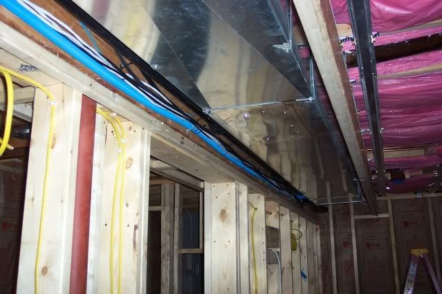

So I don't want to have to put and and rip down my soffits three times....so I have a question.
On the west side of the theater there are two duct mains running down the side. I plan on building a soffit around them when doing the rest of the room envelope. After that is done, I will decide if I want to install a matching soffit on the other three sides. This will allow me to install cans in the rest of the soffit without leaking sound outside the room.
I am a little hung up on the details of the soffit containing the ductwork.
Here is a picture of what I think should work...I am looking for comments to see if I am going about it wrong.
My main question is regarding the DC-04 clips and whisper clip/hat channels....
I am pretty sure I need DC-04#1 as shown in the picture above.
Do I need DC-04#2? Or can I just attach the soffit ladder straight to the joists? Are the DC-04 clips even strong enough to support a ladder and associated hat channel and sheetrock?
I just need to know if I am going overboard. Is the law of diminishing returns kicking in here? Can I get rid of the whisper clips/hat channel on the soffit portion?
I don't really know all the rules here. So I am hoping Ted or someone with experience can chime in here.
I am thinking I need DC-04 #1, but not #2. My reasoning is that the rest of the ceiling is only being isolated with whisper clips, so it wont hurt to have the soffit isolated the same way. The hole in that reasoning is that if its okay to only use whisper clips on the ceiling, why are DC-04 clips even needed for the walls?!?

I'm no expert, but this is my take on it.
If you're using whisper clips and channel, I don't think there would be much advantage to using DC-04s also.
When I get around to building my dedicated room, I'm going to use clips and channel on the ceiling only, and DC-04s on the walls and attach the DD to the studs.

Here is an updated picture to incorporate the suggestions. I just want to make sure I have this correct.
What I changed:
1) I am now supporting the soffit ladder with whisper clips and hat channel instead of DC-04 clips.
2) I removed the clips/channel from the side walls (the DC-04 clips will be enough sound isolation for the walls)
I am not doing any staggered stud walls. I just wanted to verify that the DC-04 clips would take care of the sound isolation (and that I dont need any whisper clips or hat channel on the walls)
What kind of clip spacing do I need to use on the hat channel that will be supporting the soffit. It will be supporting not only horizontal drywall, but also the ladder framing and associated vertical drywall.
brausch is offline

That should work fine in my opinion. I don't believe you need that section of track that is supporting the soffit underside section at the wall. Since your wall will be decoupled, attaching the soffit to the will will render that intersection decoupled as well. Just screw or nail up a 2x2 to the wall to attach the soffit to there.
I put my clips for the soffit ladder on every joist, or 16" centers to be safe. Here's a pic of my build which is exactly what you are proposing.
My wall was a bit problematic since it was under my main beam, but I used DC-04's to decouple it. You can also see the 2x2 nailed at the top of the wall for attaching the soffit, which was a piece of 5/8" OSB for the horizontal section.
