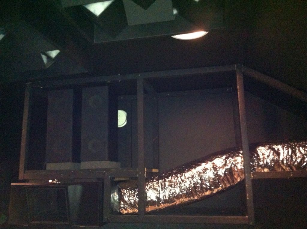

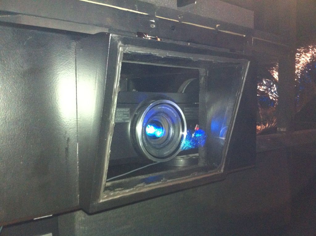

Originally Posted by Nick****achi View Post
I finished running the ductwork for the hushbox today and specd out the ducting for the rack. The ducting worked out pretty well and simpler than i thought it would be......
Now i need to run the ducts for the rack and play with the PID controller to see how it works. Once i got a grip on that ill order the fans and hook it all up.
Sorry about the crappy iphone pics:
Here is a shot of the duct and conduit running to hush box:

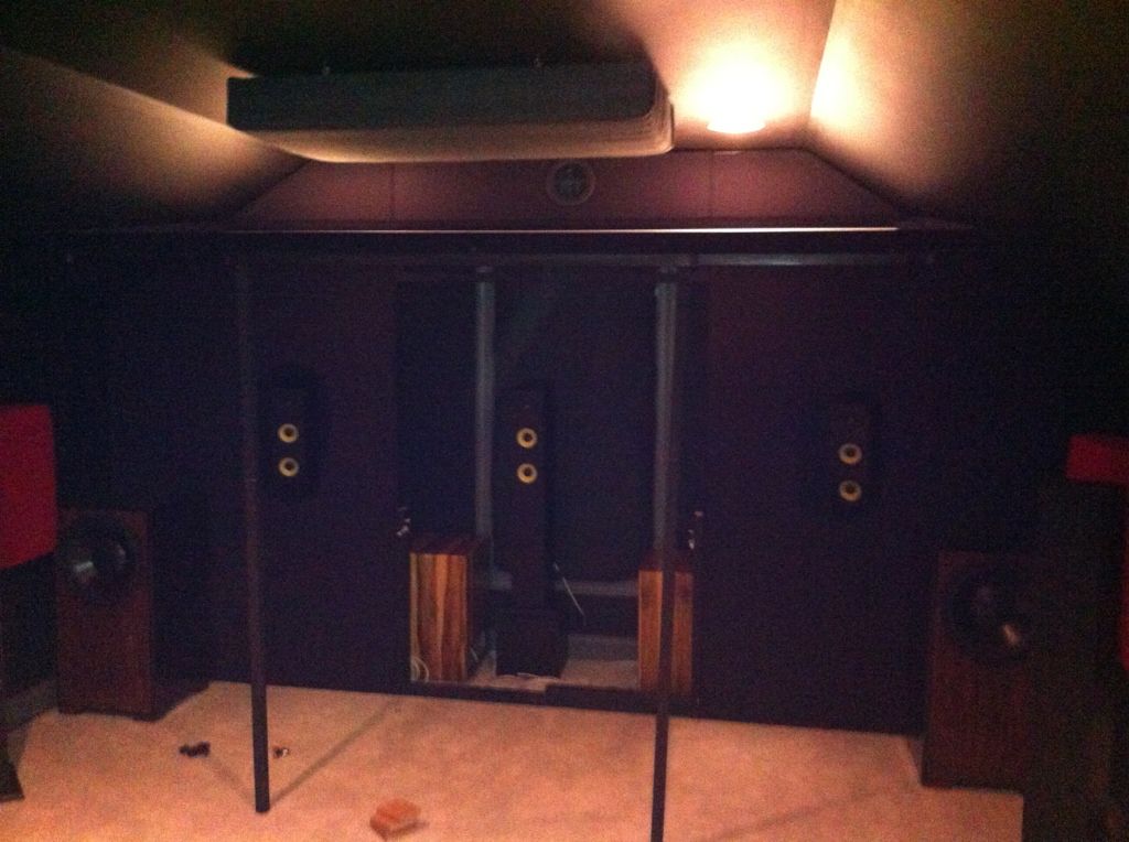

While i was up there working i wanted to reposition my subs, move and re-angle the mains so I took a quick shot with the "Hood Popped" smile.gif
I also repositioned seating.
Bad part: Now i gotta recalibrate and EQ the subs over......

You may be addressing this in your attic ductwork, but do you have a return line going into your hush box? I may not have the term correct, but you need hot air (pull) and cold air (return), right? I only see one line.
Also, quick question of the glass mount. How are you securing it to the frame?

Originally Posted by Java View Post
Looking very nice, Nicholas!!
Java
Hi Java,
Thanks, it is coming together pretty well.
The projector box is mounted to a shared wall with the stairwell.  The hush box has a short duct in the back that sticks through the wall back wall of theater into stairwell.  This is the cool "supply" and the duct you see leading away from box is the "return" which leads to fan in attic.
I'm not sure yet on the attachment of the glass.  I always thought I would "glaze" it into the frame with silicone or something.  I could put an applique on the outside if the glazing was too hideous.  Any ideas?

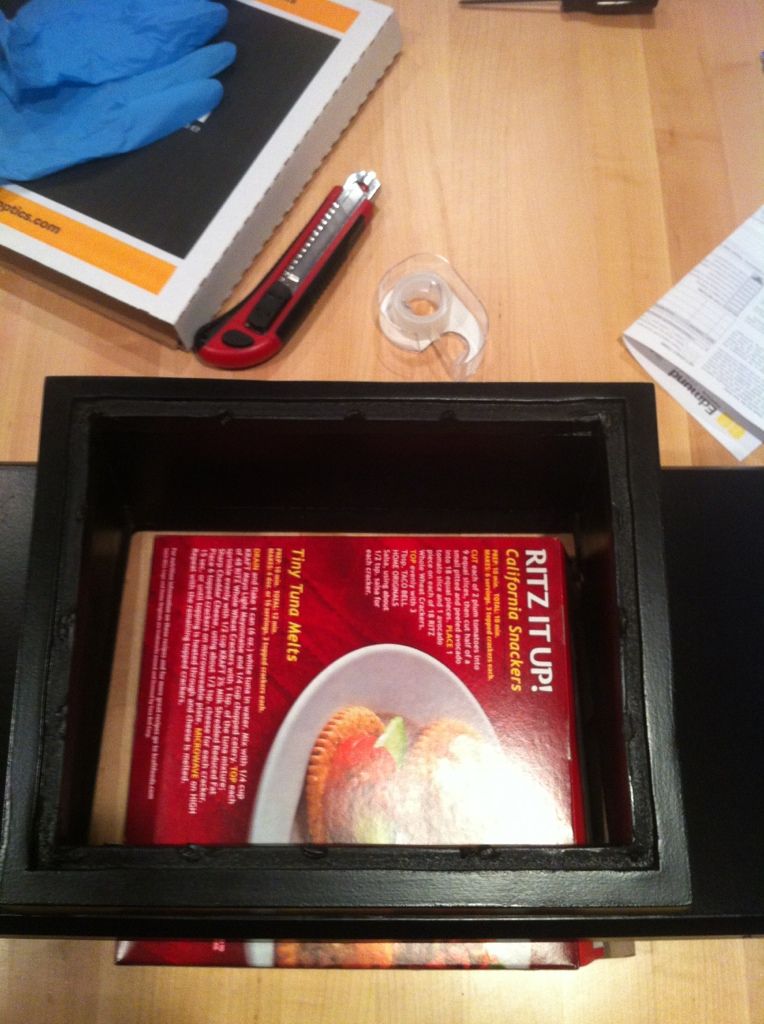

I was thinking along the lines you were until I saw Dennis' comment on perminently mounting the glass in the projection glass thread: http://www.avsforum.com/t/1434061/projection-glass-optiwhite-vs-edmund-optics#post_22504033
External frame for the glass .... good idea. Gluing the external frame--bad idea.
You want to be able to remove the frame and glass easily so you can:
1. Clean the glass front and back (finger prints/dust)
2. Easily replace the glass after you break it.
3. Easily get to the front of the anamorphic lens, the slide, and the projector lens for maintenance, adjustment, focus, cleaning, etc.
Maybe a silicone seal isn't too bad because you can "re-pane" it if needed. Any other option I can think of that isn't sealed, would kind of negate the sound damping benefits.

Good point, i think having the flip down front might address most of those concerns, but IDK.
I hope Dennis posts back there there were a few questions still unanswered.

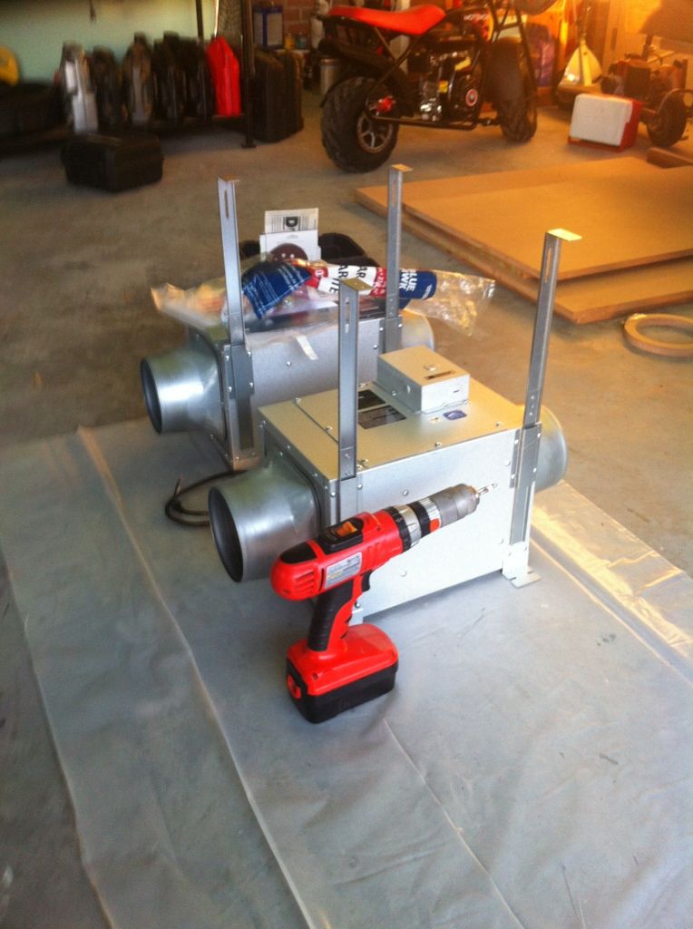

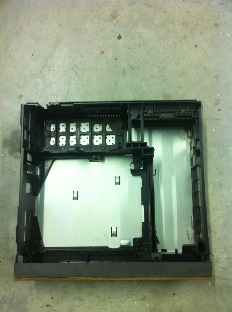

Fans came in today, so got them prepped:
Heres a couple shots of the VCR chassis coming along....
Lots of little things to do, its hard to keep focused. I seem to get pulled in all directions. Im estimating 2-3weeks to complete.

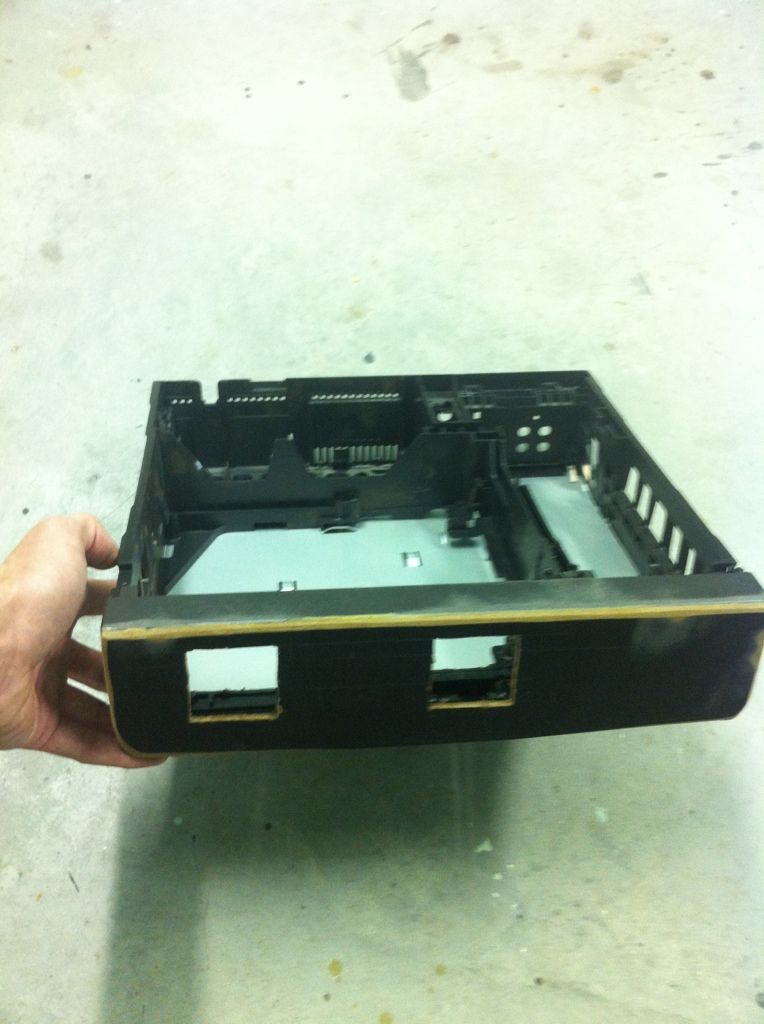

This weeks been pretty steady.  I started playing with Durham's Water Putty this week.  I saw it used in curved speaker cabinets as a filler putty for kerfs in bent MDF.  This is a large gap putty that doesn't shrink and cures "rock hard."  Man this stuff does cure hard, it doesn't hardly sand even....  After ventilation and Acoustic Treatments you might see this stuff in action with my DIY SEOS build.  I wanted to use it to see how it works and it works great.  I used it to fill in the odd shapes and gaps in the VCR face so its flat and presentable.  Maybe some pics on that tonight before round two of sanding and filling. wink.gif My biggest gripe with wood putty is it dries out before I use it all up.  This stuff is powder and you mix up what you need and the rest is good forever.....
I've spent a lot of time with my crimping pliers this week routing wires in the VCR chassis.  The relays came in yesterday but the long thermocouple and the 24V alarms are not delivered yet.  Those are the last two items I'm waiting on to finish up the fan install.
Order of tasks to finish fan Install:
  • Install Relay board, Long thermocouple, and alarms into VCR Chassis.
  • Finish putting Lipstick on VCR face.
  • Final assembly and testing of thermal controller assembly
  • Cut holes in Rack
  • Run Rack ductwork
  • Install fans and hook up power
  • Tweak fan speed, setpoints, and other parameters.

Task List Update:
  • Finish putting Lipstick on VCR face. Done
  • Cut holes in Rack - One of two cut.
  • Run Rack ductwork - On of two done

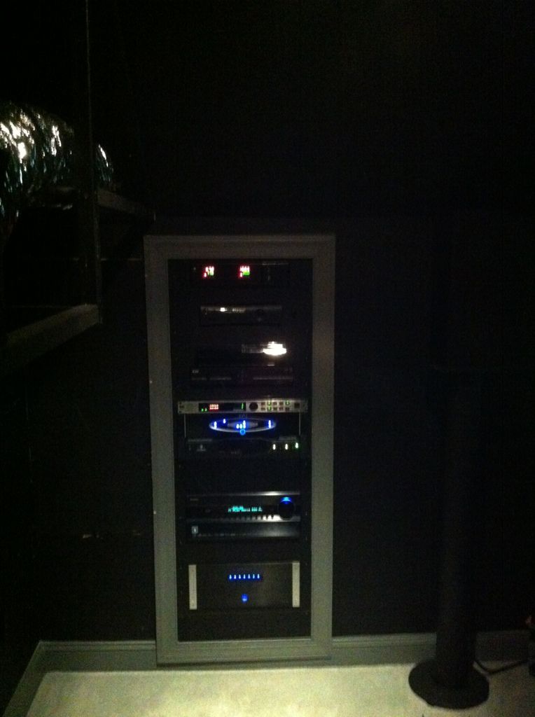

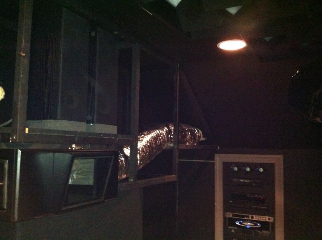

Chassis is coming along.  Final assembly is awaiting final paint to dry and the long thermocouple.
I forgot to take a pic while I installed the duct to the bottom of the rack, but here's an afterthought shot.
Here you can see where I ran the cool air supply ducts into the stairwell leading up to theater.....  Not the prettiest grills but anyone on these stairs is on their way up to the theater anyways.  I wouldn't want these in my living room but theyre ok here.

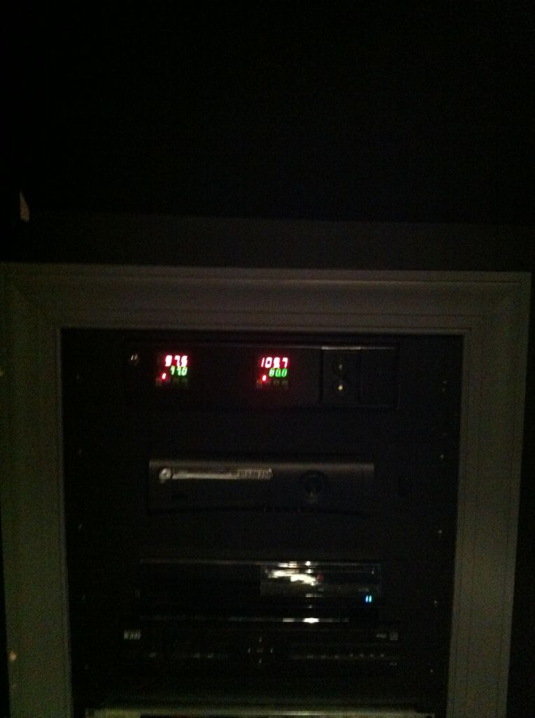

So since I blew up the original relay board, I decided to do what any self respecting DIY man would.  I DIYed my my relay board from the pieces that weren't destroyed by my misunderstanding.  One trip to radioshack for a perforated board and some solid copper wire......and
Next we finish mounting that relay board into our SEEEEXY chassis.......
All Done! But Still photos are boring, want to see it all work?
NicksHitachi is offline

  • Install Edmunds Optics Glass- Came In Yesterday.

Theater is out of commission until I finish this ventilation install. That should motivate me to get this project done!
I had to pull all the cables and wiring from the ceiling coduit and re-route through the conduit leading to the back soffit and hush box. Since the cabling is now disconnected the theater is out of commission until I can relocate the projector. Relocating the projector is contingent on finishing the ventilation, so you get what I mean.

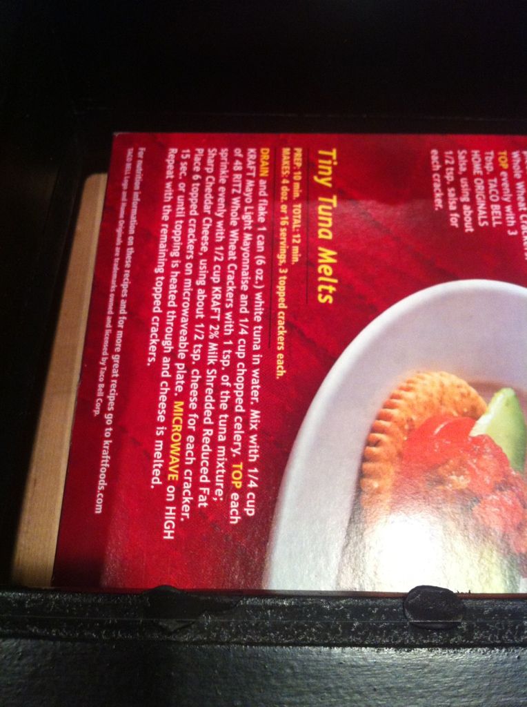

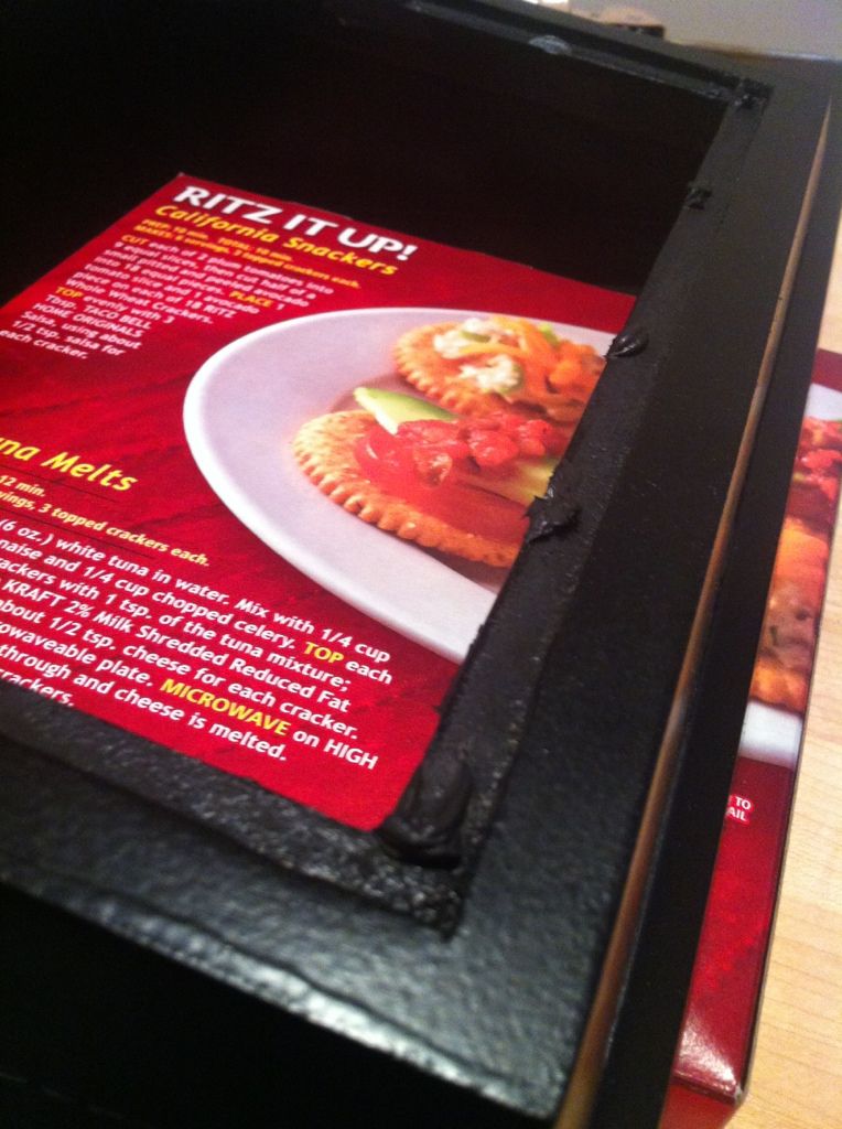

Tore the upper rack apart in preparation for cutting the last hole for ventilation.
Put one of the fans in the attic scoping out available real estate.
I can see why this glass comes so highly recommended. Its very trasparent and controls reflections very well. Its actually very similar to museaum glass for framing artwork but much thinner. At 1mm thick I had to be very careful removing the protective film as it was stuck on very well. It probably took like 5 mins total to remove the film from both sides.
Hers some pics of the glass install:
Put a few dabs of black caulk around the perimeter for the glass to rest upon.
Laid glass down onto dabs and seated allowing glass to rest on caulk for support. Notice how clear and reflection free the glass is! Some of the shots its completely invisible, thats good!
Finish up glazing around perimeter of glass.

  • Install Relay board, Long thermocouple, and alarms into VCR Chassis.  Done
  • Final assembly and testing of thermal controller assembly  Done
  • Run Rack ductwork - done
  • Install fans - done

Update I finished the install of the ventilation....  Oh Happy Day!  I am so tired of crawling around my attic.
A little adjustment of the "hysteresis" setting on the controllers has them coming on and off as needed.  The rack ventilation comes on twice every three hours for about 10 minutes each time..
The projector fan comes on and keeps the outlet temp within 5 degrees of what it ran free-air.
The AVR runs at exactly the same temp as when I had the old case fan setup.
Noticeable reduction in noise with the projector in the box and the reduced fans in the room, too soon to tell about the heat as I havent spent enough time with it yet.
So far I'm stoked!  I'll put up some pics tomorrow, but one pic to show my misery today while crawling around attic....

I took a few shots to share from iphone.
First for anyone considering a hush box and contemplating the angle of the glass. I used 15degrees and have the projector very close to the glass. the reflected light just hits the top of the lens, so I might need to move the projector back a bit. No problem though plenty of room. Its sooooo much easier to setup the projector on its feet over a ceiling mount too!

That VHS/ temperature controller turned out very well - nice job!

I moved the projector back in the hushbox about 2" last night so that the reflected light completely misses the lens. It seems to look better but I wouldn't swear its not an psycho-optical illusion.cool.gif
