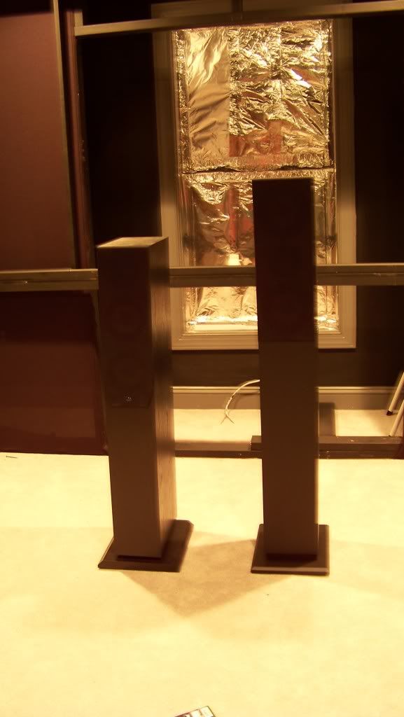

So been a while since I posted.... Here's what I been up 2. I realized today I never posted pics of my nifty screen mounting method so here we go! To mount the screen to the wall I used a piano hinge. I mounted the piano hinge to the screen itself first. I then mounted a 2x4 on the screen wall. This was important and made leveling the screen horizontally easy peasy lemon squeezy.
See piano hinge mounted to 2x4 here:
So now what? The bottom just swings and swings too far into the screen wall to be level. Its very important that its level, so i wanted an adjustment mechanism for the bottom to fine tune. I used a carriage bolt threaded through a T-nut mounted through a piece of wood with a lock nut on the back. I fine tuned level in and out until perfect and set lock nut on back. Pretty Slick! Check it!
I also dressed up all the speaker wires with pants and shirts(banana plugs) so theyre pretty
Cool Right!? Now we just need to watch some movies! Wait, then the blue ray drive in my PS3 dies..... So now I have 2 with dead blue ray drives!
Time to figure out how to replace the BR drive in a PS3.......
PS3 fixed!!!! Whew didn't know there was so much in there it was a chore to get it back together and load disks and all.....
So popped it back in the rack, oh wait rack is finally finished too with all components installed and without photos it didn't happen!!
Finally getting to the fine tune stage and I'm glad because I'm tired of my HT beaing a MESS!!!!
What yaw think??????????????????????????????????????????

Hey Nick what towers are those?
XBOX Live: Zz NiNj4 D4D zZ
Iusteve is online now
post #108 of 672 Old 07-09-2011, 12:05 PM - Thread Starter
NicksHitachi's Avatar
Location: Wilmington, NC
Posts: 3,792
Quoted: 182 Post(s)
Liked: 191
All the speaks in my system except the mains are identical: EMP EF30Cs which are the internet direct version of RBH's TK515Cs MTM bookshelves.
The mains are the EF30Ts or RBH TK5CTs, TMMW Towers
Those front wides are on DIY stands made to look like the towers. I had to make them extra tall to align the tweets but they turned out real good I think. The speakers are the best I've ever had. Heres a pic of the mains lined up with the wides in case your interested....
The fact you thought they were towers is a complement. Thank You.

Ok so mounting to the 2x4 helped the vibrating but did not completely solve it. I can still make out some vibration on seriously heavy bass scenes. But realistically it has to be so loud your wondering if the image got fuzzy or your vision blurred.....
I think eventually a rear wall cabinet will be in order and build-in my surround rears and projector. I think then I could put the projector on some foam as an isolator and it should be solid.
Just finished my DIY dual opposed MFW towers:
http://www.avsforum.com/avs-vb/showt...1348955&page=4
They have quite a bit more extension and SPL....
I'll post some frequency plots when I get a chance......
