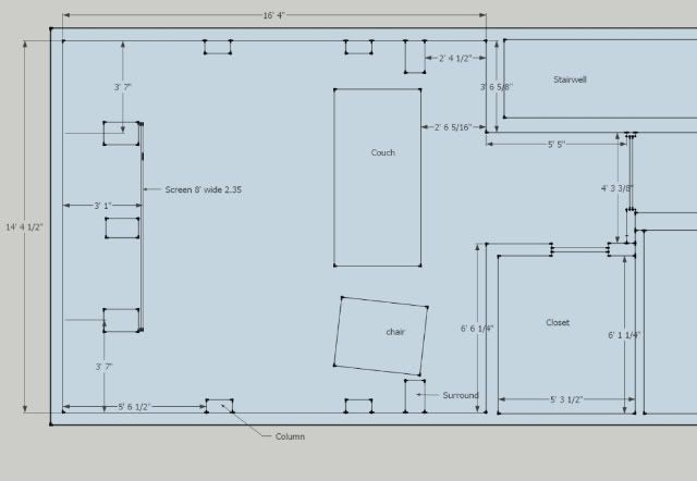

Here is my floorplan. I have no clue how I am going to wire for 7.1. The hall really makes that a challenge.
Jon_B is offline

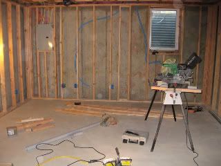

There is a window located on the screen wall. I plan to use a window plug to block out light and help reduce sound leaking in/out.
Jon_B is offline

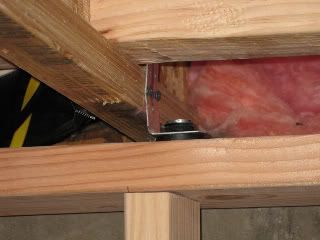

The stairwell was a concern for me for sound transmission. I spent a lot of time in the basement before building just listening. The stairwell was the area that always leaked noise from the neighbors. My plan was to seal up the area under the stairwell and build a double wall to help reduce sound transmission.
This support beam was also a concern for sound transmission. In my head a compared it to a needle on a record player. (I don't know if that is a good comparison or not) I plan to build a soffit around it after drywall and insulate, and dd, gg.
Jon_B is offline

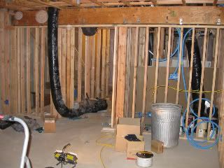

Front wall framed
Jon_B is offline

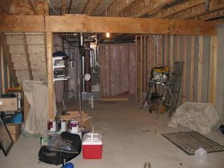

Rear wall framed. Stairwell enclosed.
Jon_B is offline

The WAF was zero on a stage, riser, and false wall due to us planing on selling at some point in the future.
Given your diagram it appears as thought you are planing for an AT screen. If that is true, you should EASILY be able to extend the side of the screen to create a false wall that is easily removable/repairable when you get around to selling.
False walls are just that, false. They do not support anything. It should be VERY easy to build frames of 2x2 pine (ripped 2X4s or even use metal studs), cover with fabric (cheap speaker cloth would work fine) and just attach to the drywall ceiling using drywall anchors and whatever is easy in the floor. When you're ready to move, remove the screws, take down the "wall," repair the drywall, paint the ceiling and done.

Tom, you are correct in that I am still planning some type of false wall. I want to figure out some way to do it without having to repair the drywall later on. Is that possible? I don't know yet, but at the rate I am going I'll have plenty of time to think about it.
Jon_B is offline
Not that I can think of. There's going to be SOME amount of drywall repair, but I think that if you can keep it to filling in a few screw holes and painting, it won't be much easier than that.
That is, unless BigMouth thinks up some genius way to do it.

Isn't 3ft of airspace behind the screen a bit much?
I would think you could it cut it down by 50% and would really open up the room and make it feel less confining.

I would rotate the room 90 degrees in either direction, looks cozy to me...

There is a hallway 6 ft x 4 ft at the back of the room which would make it difficult to rotate the room.
