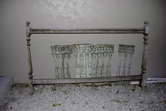

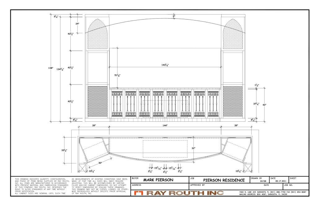

Here is a picture of the second drawing of the screen wall. The middle cabinet on either side of the screen will house the main speakers. They will have a door frame but nothing on the inside as I want to see me mains. The top cabinets have a gothic arch and bottom doors are shown with a metal mesh material which will be faux painted to look old. the large oval shaped center section looks a little funny right now but the cabinet will house my genelec hts-6 subwoofer. The cabinet will be lighted on the inside so you can see the sub. Those dark railing images are from a cast iron railing I purchased from a architectual salvage yard. I have a lot of this kind of stuff going in the house. They are heavy and I will have to figure out how to keep them from rattling.
Here is picture of the old railing I removed them from.
Drywall was delivered today and they should start hanging it tomorrow. With the two story house and no window access they had about 8 guys loading the house. They brought in a lot of boards today. I did take the liberty of taking the first picture of the front of the house since it was in the block stage. It is still not done as there is just a little more "stuff" to put on the house. If you saw my garage picture earlier in the thread you will notice the house matches the garage or the garage matches the house.....depends on if I am describing it or my wife. She is very happy to see the drywall show up. I did take the photo with a wide angle lens as I was shooting pictures of the inside of the house so the photo might be slightly askew.

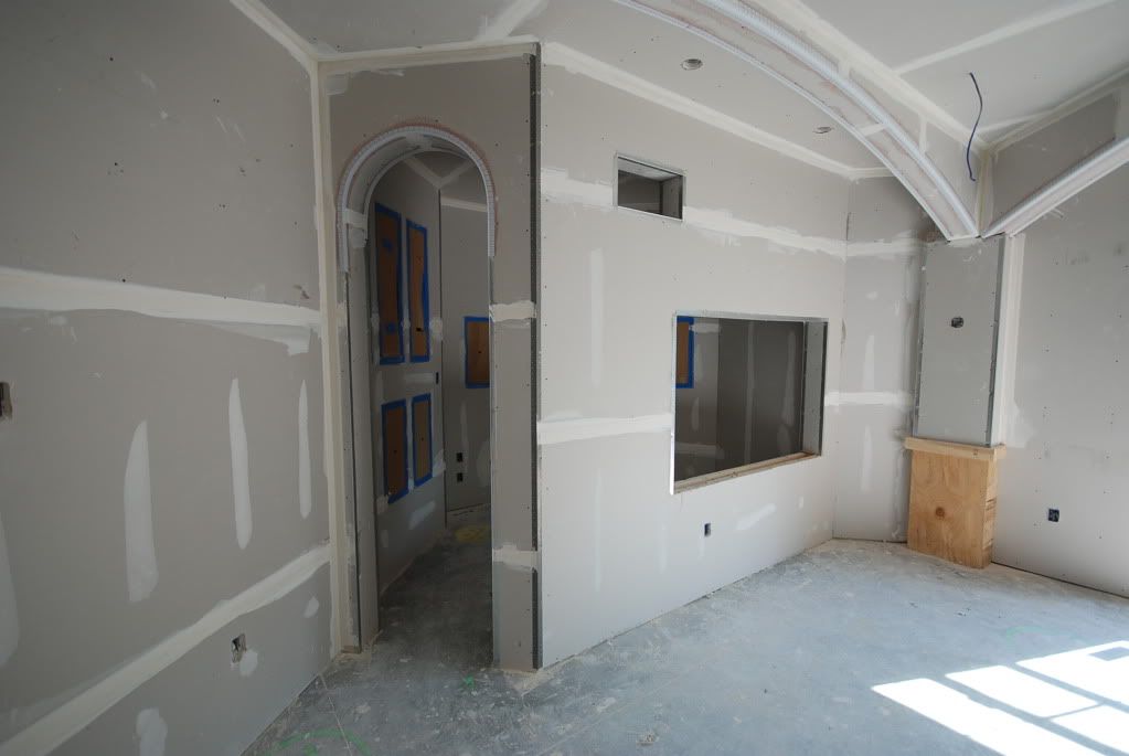

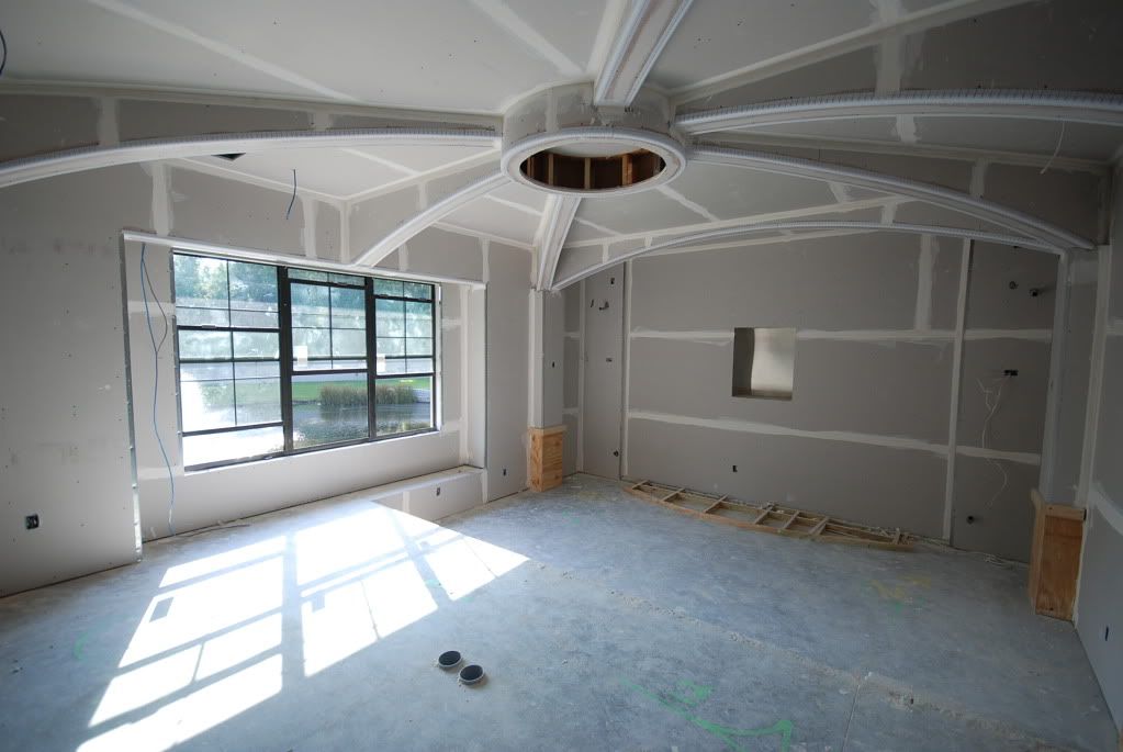

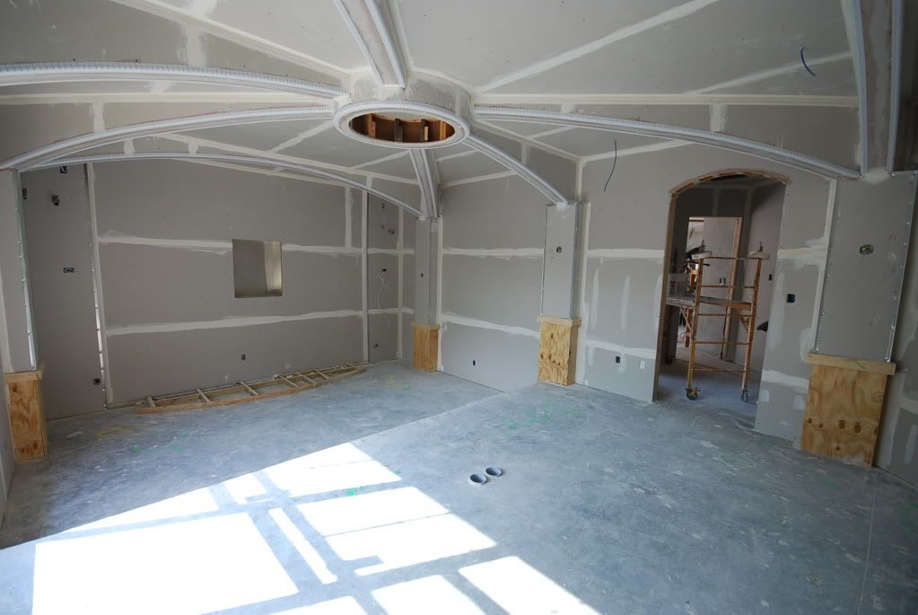

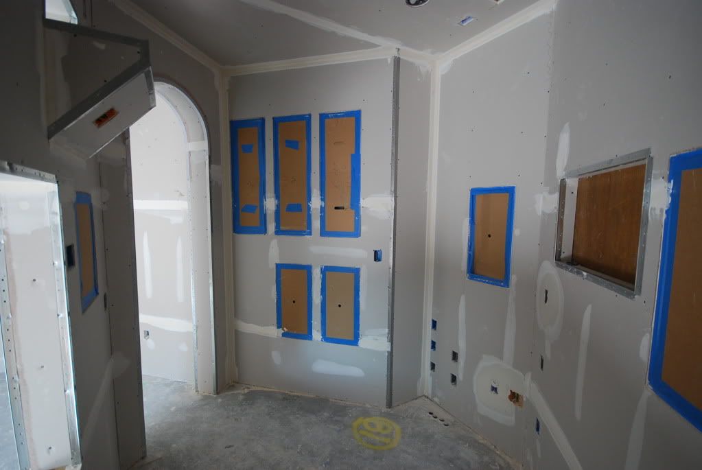

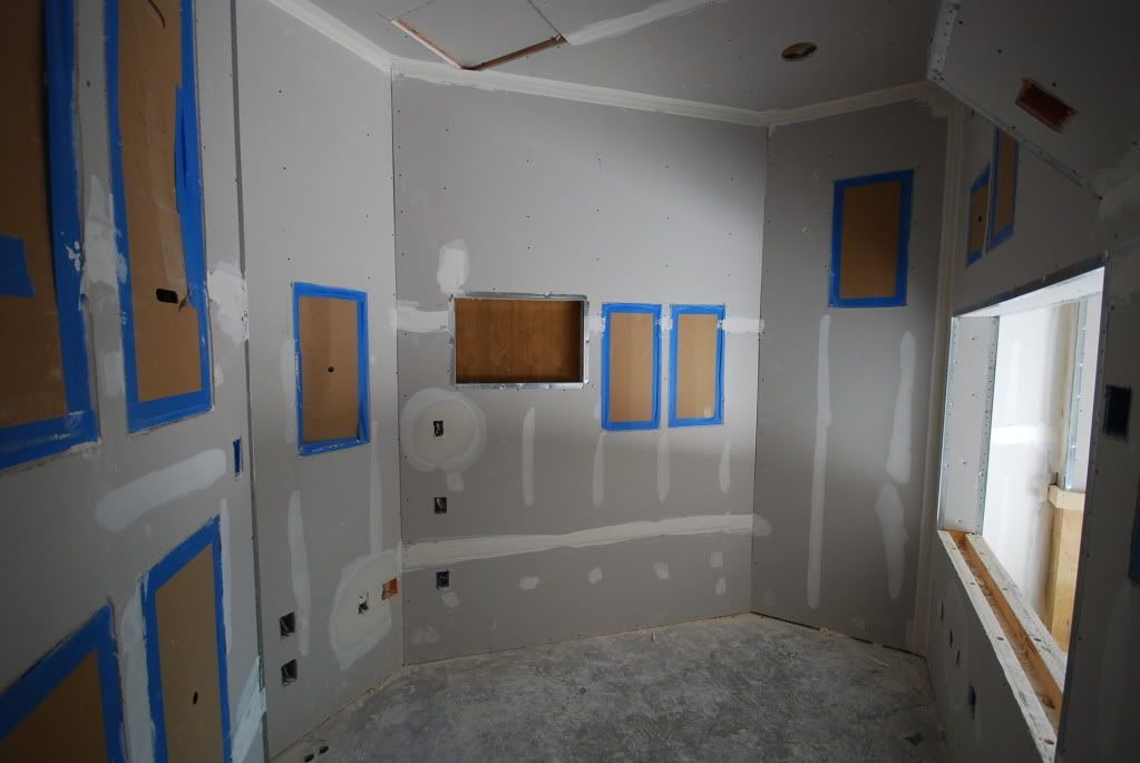

Today was a very exciting day in the media room as the drywall was hung and they began finishing. Wow what a relief to get to this step. I have spent more time in this room than the rest of the house combined in the last 3 months. I did not show any pictures but last week we insulated every interior wall of the house including the walk in pantry and all closets. I did put the master bedroom on the other side of the house from the theater but I wanted to take as many precautions as I could to keep sound down to a minimum. 70 percent of my theater walls are concrete block exterior walls filled with foam, then 3/4 inches of foam insulation with furring strips on top. The 30 feet or so of 2x 6 wall adjoin the interior of the house. We did use two layers of drywall with green glue on these walls with R19 batt insulation. 12 or so feet of the wall is inside the equipment room so i really do not have that much exposure. All and all I am very happy with my room. The plywood you see will be a base for the stone on the bottom of the columns. I originally planned on putting stone on the entire column but too much hard surface. I just could not giving up using some stone in the room.
I am really excited about this room now although there is so much more work to do.

Can you discribe what's going with the last two pictures? Trying to figure it out but Im at a loss.
Assuming his equipment room and shel for PJ...but there is alot going on in there

Ya man, I guess I got a little low voltage panel crazy but I had the room and I have had to fight panels with way too much wire in them and decided to segregate wiring more. The three tall panels placed a little higher up in the equipment room are Vantage lighting panels. There are two panels below them.....one panel has all of the shade wire run to it with room for the relays to operate them. the other panel next to it houses a bunch of 2 and 4 conductor wires for motions ( I have 6 Vantage motions outside in case someone approaches different entrances to the house and 7 inside the house to turn on lights as one enters a room at night. Most all of the closet doors have two conducter wires going to this box to turn on lights as you open the door, garage door wiring, etc.
The one panel on the wall by itself is the Elk alarm panel. The box with the unsightly brown background is for the computer monitor so i can recess it in the wall. I have one panel for network, one panel for camera's, and one panel for cat5 and cat6 to all of the tv locations. There is one panel for all of the 10 or so pairs of speakers in the house, and one of those boxes is the 100 dedicated electric service to the equipment room.
I know its a bunch but it really is organized pretty well.........I hope
It will all make more sense once I get to the finish stages. I hope I didn't confuse the question more by this answer!!

I absolutely love the arches and ceiling design. What a great looking room. Thanks for sharing!
thanks, I have been anxiously awaiting drywall on these arches to really see them. There have been so many changes to them I am glad to finally see them in their true form. Now it is just making sure we get the right finish on them to make the room pop.

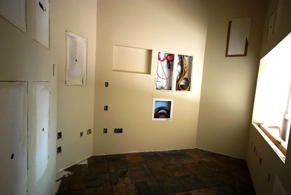

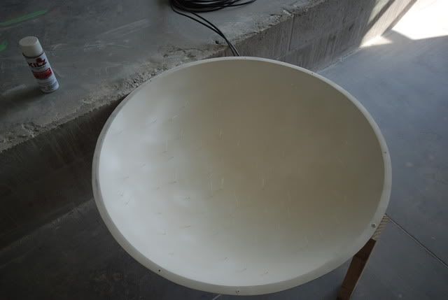

A little update on the theater. I just finished painting and laying the tile in the equipment room. I took a picture to post but it didn't come out so good so I will take another tomorrow. Today the electrician is hooking up the A/C systems on the house. The tile setters are working through the rest of the house setting tile and trim guy shows up tomorrow to start hanging doors. This friday the doors for the theater and equipment room should be delivered.....I cant wait to see them!
Although I am probably 3 or 4 weeks from installing the outlets and switches in the rest of the house we are going to go ahead and finish the electric in the equipment room this week. This way I can start messing around in the equipment room when i have time.
I wondering if any of you guys have installed LED tread lights. Here is a picture of the stairs leading to the lower seating area in the theater. I have 2 conductor wires at each tread and then installed back to the equipment room near an outlet where I can install a transformer for the low voltage. I am going to have carpet in the theater room so I thought I might find a led tread light which will act as a corner for each step.
Also, I am working on the fiber optic dome which is to be the center piece of the ceiling. They drilled holes in the fiberglass dome to install the fibers. The fibers were glued to the back of the dome. Unfortunately where they penetrate on the inside there is a hole so I am filling each hole around each fiber penetration with filler and then sanding. I know I am suppose to cut the fibers off after the final painting but does anyone know how long to leave the fibers sticking out??

I took another picture today of the media equipment room. We installed "slate" ceramic tile. The walls are a light earth tone and for now will do. Looking forward and hoping to get the a/c fired up in the next few days.....it is starting to get hot here in Florida!! Doors show up tomorrow!!

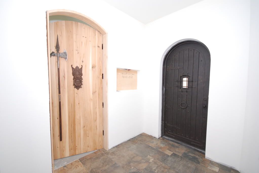

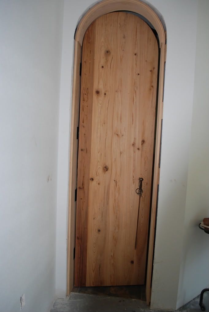

i am just now getting a chance to post the pictures of the theater doors. This past week we hung quite a few of the interior doors in the house. I was really looking forward to getting the theater doors hung. I priced a few custom doors and finally resolved to have my doors custom made by a local guy I buy my lumber from. Staying with the old world gothic theme we decided to use pecky cypress because it is already distressed. I will use a medium stain to darken up the doors. I have some pretty unique hardware I am experimenting with. Back in the late 60's my parents made there first trip overseas and one of places they visited was Spain. They brought back some armor, swords,and some battle axes and I thought I would make use of some of this artifacts we have had in our family homes over the years.
The area I am photographing here is what we call the friends foyer and there are three doors in this area........one to the garage (not pictured), one to the theater room, and one to the back door which most people who visit us will enter through. I mocked up a few ideas for the door to the theater......a big @@s door knocker, and one of the battle axes I will make brackets for and use as the door pull. The theater door is almost 3 inches thick and has the drop down threshold in the bottom and ball catches. There are 4 large hinges to hold the door in place. The back door you see is a iron door we had made for the house.
here is the door to the equipment room. it is an oval top and about 9 feet tall. I have a sword I am planning on using as the door pull........we'll make sure it is not sharp!!

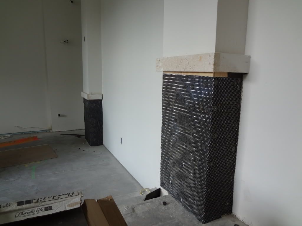

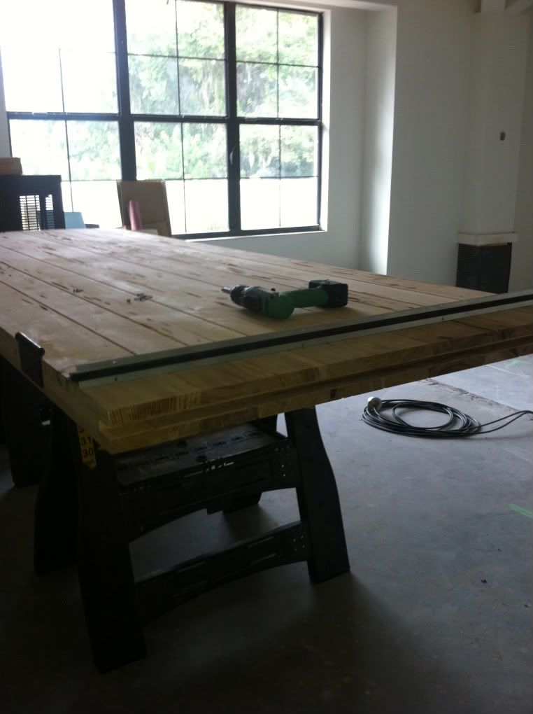

I just thought I would check in. I also have friends up north who have got on AVS to keep an eye on my theater room. We got back in there today and did a few things. We removed the main theater door which is a 3 man job cause that baby is solid and 3 inches thick. We routed out the grove in the bottom of the door to install the drop down threshold. It really is a cool product my lumber supplier turned me on to before I saw it on AVS. He uses them when he builds doors for wine reserves. It just screwed into the bottom of the door after we created the channel. We will adjust the drop of the threshold once we get our floor covering in.
We also wrapped the media room columns with wire lath today. Tomorrow we will do a skim coat of stucco to make ready to cover the lower 3 feet of the 5 column's with stone. We are using alot of stone surfaces on the exterior as well as the interior of the home. I know sound panels are a preferred wall covering but I just wanted to have some decor as well. I am using stone from Eldorado stone as well as Owens Corning. These synthetic stone companies produce a high quality stone product and it really is quite beautiful. It is more money than real stone but it is configured in such a way with the sizes it fits together much easier so the labor time is quite a bit less. It still looks random and natural with much better coloring in my opinion. I will capture some pictures of the install as we go.
