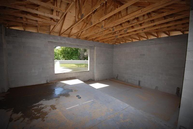

post #3 of 413 Old 10-01-2010, 06:32 PM - Thread Starter
IGO2XS's Avatar
Join Date: Sep 2010
Location: Sarasota, FL
Posts: 310

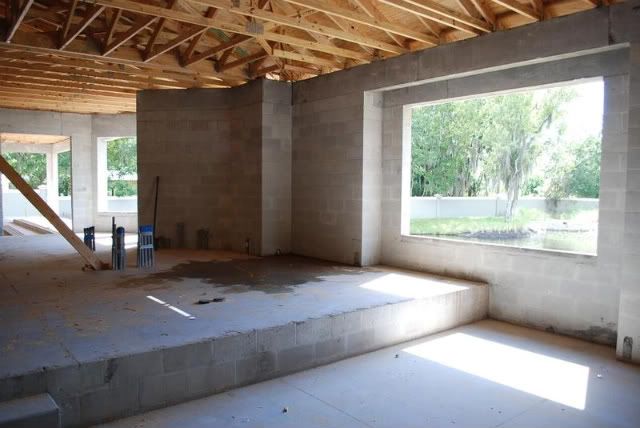

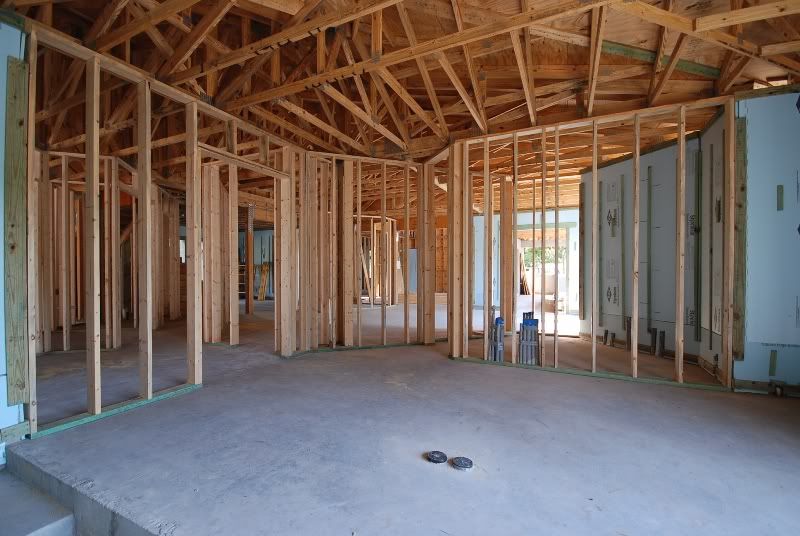

Picture taken from screen wall toward back of theater. Picture taken from approximate location of entry door to theater room. you can see a portion of my garage out the window on the above picture

this is the view out the theater room window. the fountain is lighted up at night with led underwater lighting. I guess I will see how this effect will work in the real world. If it is too distracting I guess I can just close the curtain.

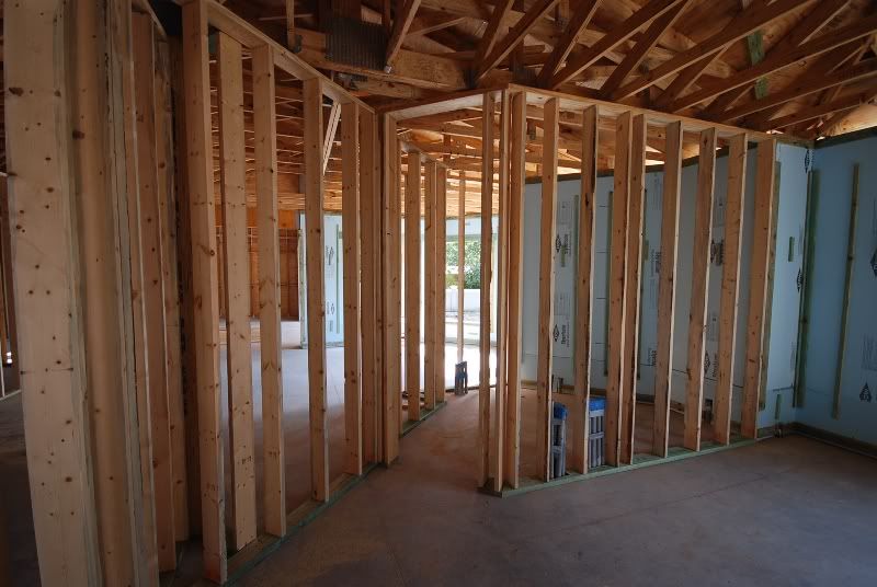

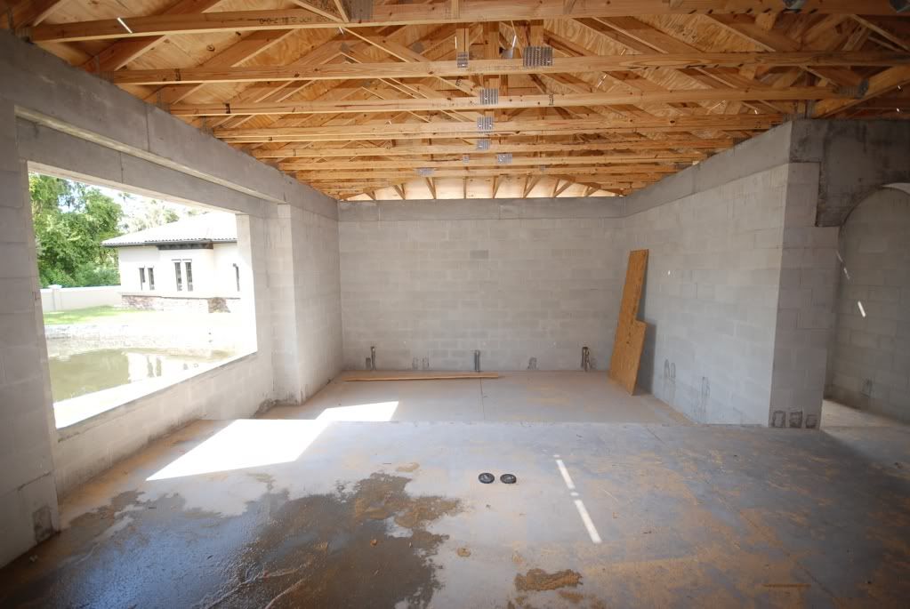

The framing crew was back in on Friday and finished the small portion of wall in the media room as well and framed the equipment room. I have quite a few 1 1/2" conduits stubed out in the concrete. 4 of the pipes run to the front of the room for each of the main speakers, center channel, and sub-woofers. The Genelec speakers have some large connecting cables running from the speakers to the amps. Each of the mains and center channel speakers are tri-amped. The other conduits are for connecting the Lutron lighting system to combine the detached garage lighting control to the house. I have a pair of conduits running to another house on the property owned by my brother as sometime in the future we will be connected with fiber. Still other 1 1/2" conduits running throughout the property distributing cat 5 cable for the ip camera system. There are currently 14 conduits entering the equipment room through the slab. I do plan on running conduit through the ceiling to key audio video areas in the house so I can have the flexibility to add or change wiring. I will be running my hdmi cables over the cat 5 cable distributed through the house.

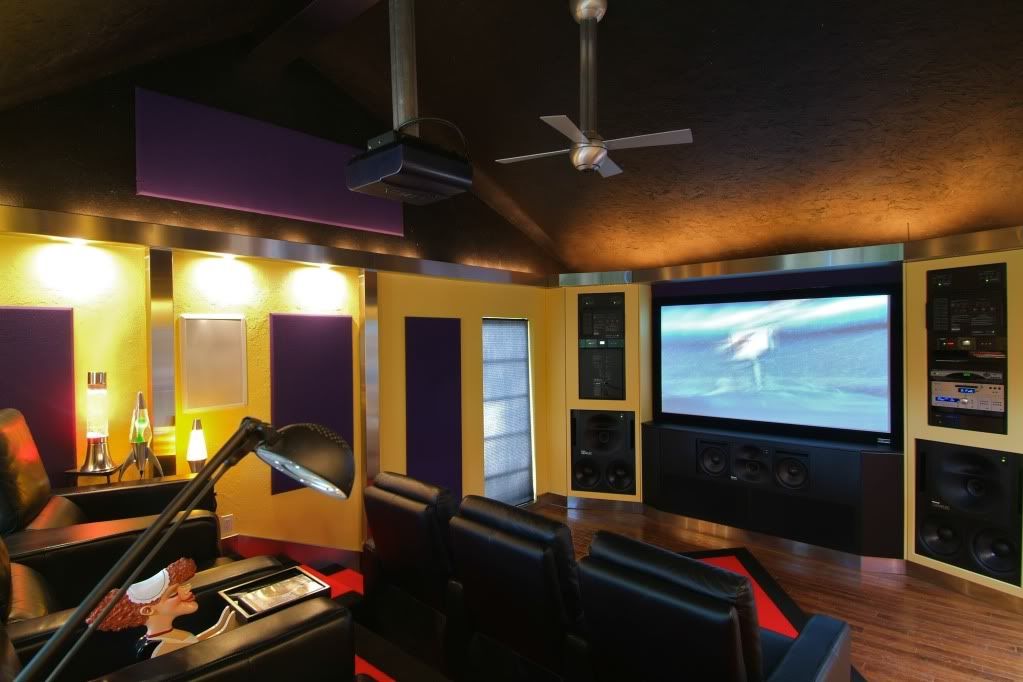

I want to show you what I did in my last theater room. I had all of the speakers visible in the wall unit we built. I am really in to the design and fabrication of the rooms. The metal you see is stainless steel and a friend of mine built the stainless valance that traveled all the way around the top of the room and then built the columns from stainless. You cant see but we had a 12 x 12 stainless beam across the top.....this room had a cathedral ceiling. Of course this was contemporary and I want a more traditional room this time. I had other acoustic treatments in the room not seen in this photo. I wish I would have taken more pictures of this theater.
IGO2XS is offline

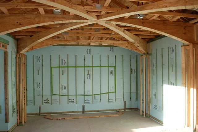

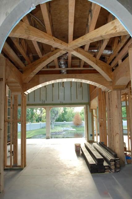

There have been a few developments in the theater build. We have framed in 60 x 60 inch opening in the front of the equipment room. I will be mounting 3 racks in this space to house my equipment. No more pulling equipment out to work on cables. NICE!!
My first cable order arrived yesterday. 5000 feet of Cat6, 1000 feet of Cat5e I might use for telephone lines, and 1000 feet of direct burial Cat5e for some additional outdoor ip cameras. Each TV location in the house will get (4) Cat6 wires and one RG6 cable. I am putting the cable in just to have it but probably will not get used. Looking at a Wyrestrorm HDMI matrix switcher to distribute audio and video to TV monitors.
Check this out. We spent the last 2 days building my ceiling detail. There are 6 columns that will be wrapped in stone to match the old world theme we are going with. There are 3 arches that extend from side to side. We then added two more arches than cross in the middle. The arches will have stone venere and some faux paint. I am thinking of installing mini led lights in the arches to keep the ceiling as clean as possible. The flat part of the ceiling will have accoustic panels with fabric stretched over the top. I want the panels on the ceiling to be seamless. I have working on a ceiling theme for months now and this just came to me 5 days ago. I taped up a 10 wide screen but thinking something more like 12 to 13 feet wide.
I am using the same ceiling arches in our foyer as I used in the theater. Wife is very happy with what i came up with.
IGO2XS is offline

Great ceiling, now that odd column placement makes sense.

thanks BM, we ended up locating the columns based on the arches and not as drawn on the plan.

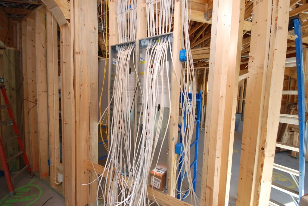

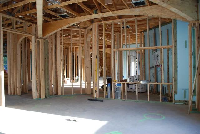

It has been a little while since I updated my theater room thread. The progress on the theater room has been in limbo as we have been working on other aspects of the house......primarily roofing and the plumbing and electrical contracting. We have been working about 30 days on the wiring and we are finally bringing the loads to the media room equipment room. I can tell you when the two Lutron Homeworks 59" panels arrived I couldn't wait to install them. They are huge and I guess I thought it was pretty cool to have these to monster panels almost 5 foot tall installed in my equipment room.
I have installed three 28" panels for wiring. I plan to use one for the security camera's, one for cat6 cable for video, and one for data. I figure the more cables the better. I have begun installing the cable in the house and I am running one rg6, one cat5, two cat6, and one 1 inch conduit to each location in case I miss something. The two black retangular boxes are 2 of the 3 equipment racks I am mounting in the wall so the equipment is exposeded to the media room.
It was like Christmas this week. I finally recieved my Digital Projection M-Vision Cine 260HC projecter which was on back order, the new Oppo BDP-93. and picked up a Sonos system from Best Buy. I know this is not a automobile forum but I happened to have the boxes sitting inside my garage and thought my street rod might make a good backdrop. I have the Oppo player hooked up in my temporary theater room and the picture looks awesome although I have not had much time to play with it. I have been obsessing over the iRule Control system and have been spending a lot of, time reading the AVS iRule thread and playing around with programming
