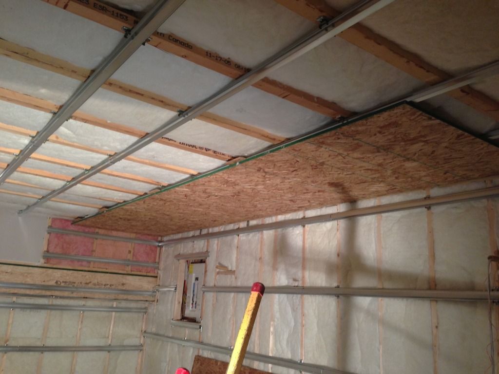

Im installing OSB right now onto my ceiling channels, can you run the sheets parallel with the channel or are you supposed to go perpendicular?
Figured it would be best to run the first layer of ceiling OSB parallel to the channel and then the second layer drywall running perpendicular (the normal way) to the channel. If the panels should be installed perpendicular to each other for seam overlapping purposes, one layer will obviously have to run parallel to the channel?
I am only a couple sheets in and want to make sure.

Ugh 5/8 OSB, finally done, on to green glue and 5/8 drywall tomorrow am.a9a6esed.jpg

Looks like some good work there. Keep it up.
