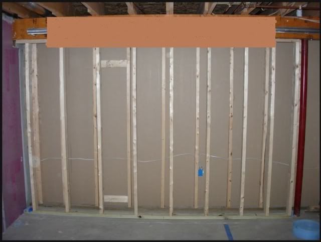

I bet most of you guys have seen this already, but my left side wall is framed under the structural beam, and so it will ride against clips/channel toward the top. Anyone have an option for how I could attach the crown to this side of the wall?

For your crown, could you frame it similar to how Ted's picture illustrates framing for a soffit with clips and channel (by adding another row of clips and channel where you'd attach the crown)?
Does that make sense? Might be overkill for just crown, but it would still keep everything decoupled.

You can add a dmall nailer to the wall to attach the crown to
You can use an initial layer of ply on that soffit, giving a nail base.

Thanks vids - That's kinda what I was thinking...maybe I could even just move that channel up until it's even with where the crown will be located...
But what does that do in terms of fasteners? I would have to screw the crown into the channel, right? I may be wrong, but I don't think you could use nails as you normally would for crown...maybe someone else can chime in on this?

Ted - Thanks, but I'm not sure I understand your comments...
Re your first comment, do you mean adding a nailer directly against the beam? Wouldn't that couple the wall to the beam?
Re the second comment...I'm not going to have a soffit in the room...maybe I could just use plywood in that area instead of the first layer of drywall?

I think this is what Ted may have been talking about with the ply/osb as support:
You could probably just rip it to width where you could get one wall done per sheet, or just use a whole sheet like you would the first layer of drywall if that's easier. Would probably cost you more that way though. Maybe it's just the pic but I was thinking that your hat channel on the beam could go up a bit further? Could be wrong.
Yes as fotto "photo-ed" ...The photo from fotto haha. Little things amuse me I guess

ok guys - great suggestions, and that's the way I'll plan on the first layer of drywall. 6-zone GE coming up...
And fotto - yeah, I have been thinking maybe I should move that channel up a touch...it could go up a little but not much once you account for the clips/channel on the ceiling...
The way my electrician ran the wires along the beam really scares me with regard to installing the crown...I would prefer not to put a nail through one of these wires...some reorganization may be required here

No pics until tonight () but I have been making some good progress (actually, contractors have been making some progress for me). Recent updates:
1 - Spent most of last weekend organizing all of those electrical wires. Things are looking much better now.
2 - Plumber was in yesterday and moved the refrigerator ice maker line and shut-off valve so I can access it after the ceiling is drywalled. He also replaced a short section of pipe because there was a soldering joint that looked a little ominous.
3 - Ordered a 6-zone GE. Better call the electrician back to run some more lights!
4 - The alarm system people are coming today to install a keypad in the theater. Unfortunately the keypad only comes in white and will be right next to my black GE. Time to work on my painting skills...
5 - I'm about to cry uncle on the HVAC install. I don't know what I'm doing and haven't had time to research it. I'm going to make a big effort to DIY it this weekend and if I can't get it done, I think I'm just gonna cough up the cash on this one.
My next project is to start researching projectors. I don't know anything about CIH. I'm not going to build the theater around a particular projector, but I think I may need to put the projector on the ceiling in the room rather than shooting through glass in the equipment room. My screen will be 9.5' wide 2.35:1, which means about a 98" diagonal 16:9 image. The throw distance from equipment room to screen will be long...about 22' and I don't know if I can project an image that small from that far away without a special lens.
Long story short: I think I need a projector outlet in the room, and I'm trying to plan that now...maybe at about 18' distance? I dunno...gotta start learning about anamorphic lenses and throw distance etc.
Right now, I have my eye on the JVC RS50, but I can't decide if I'm going to go 3D or not...if not, I may look at the Runco LS-5...and I guess SIM2 has something coming out soon for under $10K...I dunno. I probably don't want to spend that much money, but those options looked interesting.
