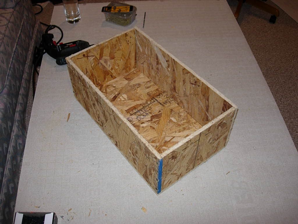

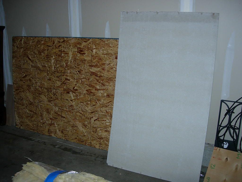

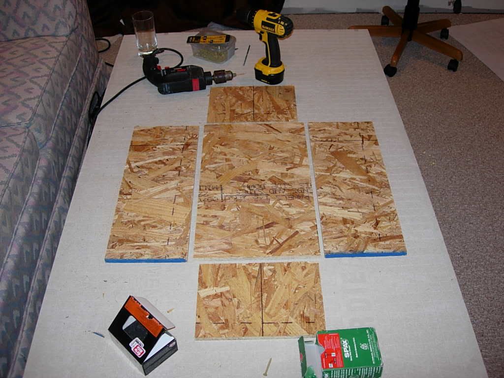

Ok back from HD with materials. 7/16" OSB and I ended up with 1/4" HardieBacker Board. It says right on the product that it's "the ultimate cement board" so how could I go wrong???? I'll double check with Ted tomorrow to be sure it's the right stuff.
Everything was great until my friend decided it floor it at a stop light (?!!?) and we left half of our materials in the road. Of course it's pouring outside too. Luckily we were able to grab everything up quickly and throw it back in the truck. No harm done.
I may not get to this project until next weekend, so I'm a little nervous about the OSB warping...is this the right way to store it or should I lay it down with the cement board on top of it?
I need to find a table saw. Of course it's the one thing my local HD does NOT rent. I was gonna buy one but I'm already a bit over budget and I'm not overly excited about another $400 right now...grrr. Anyone have suggestions on which one to buy if I'm gonna get one? I don't know anything about them, but I have liked the DeWalt tools I have bought so far (they're the only "real" tools I have ever owned).
AirBenji is offline
If you have 3 2x4's floating around I would lay the OSB down. I'm not sure if it will cup a little in a week. I can tell you it will warp for sure if it's longer than a month. If you're looking at table saws give the Ridgid a good look...I'm a Makita guy but my girlfriend bought me the granite top ridgid table saw last Christmas and I love it. I'm not a full time table saw guy but definitely use mine enough to have a pretty good idea if it's good or not. JMO
chainsaw12117 is offline

Well I didn't get as much done this weekend as I hoped because I ended up working a lot, but I did at least get started on my backer boxes. Here are some pics:
1 - Lay out materials.
2 - Explain to GAF that no, this is not going to be a jewelry box.
3 - Assemble box with drywall screws. Pre-drilling is definitely necessary with the 7/16" OSB.
4 - Take lunch break.
5 - Box has disappeared. Search house and find in GAF's closet, full of jewelry. Remove jewelry and reconfirm that this is not a jewelry box.
6 - Somehow get suckered into building a jewelry box for GAF. Add disclaimer: "as soon as this project is done" (hahahaha she has NO idea how long that's gonna be)
Repeat. A lot.
I cut and dry fit some of the cement board too. I hope to finish that up tonight so that I can finally break out some GG and SilenSeal tomorrow for the first time.
