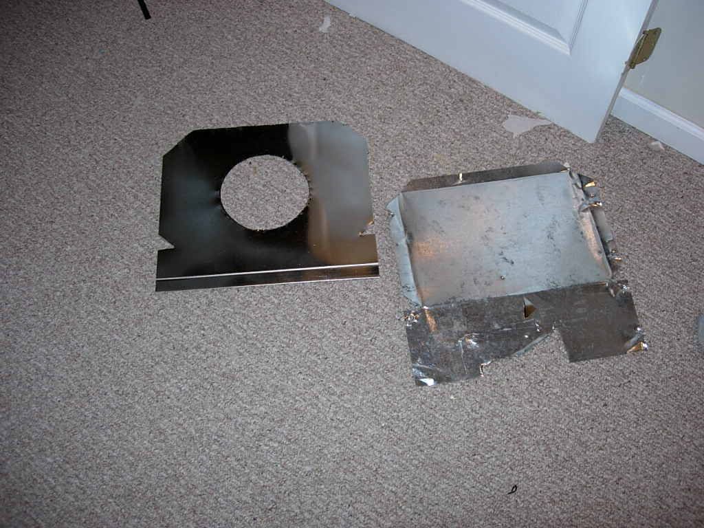

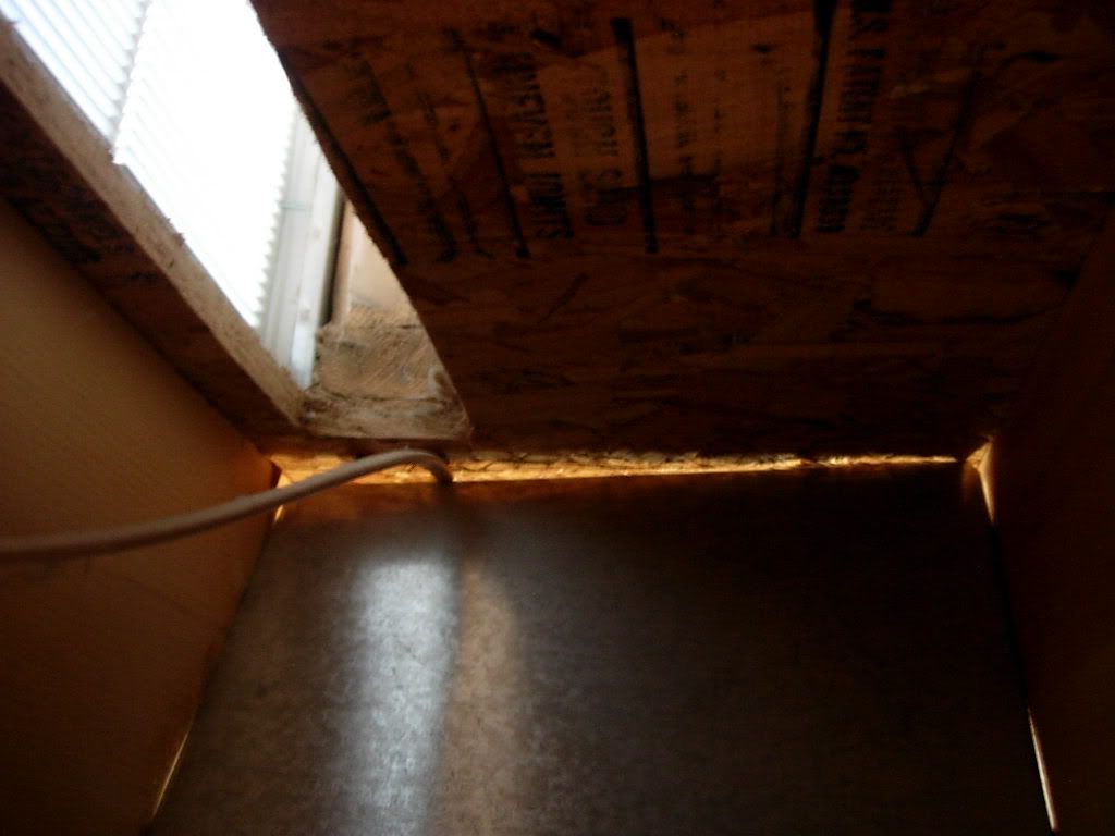

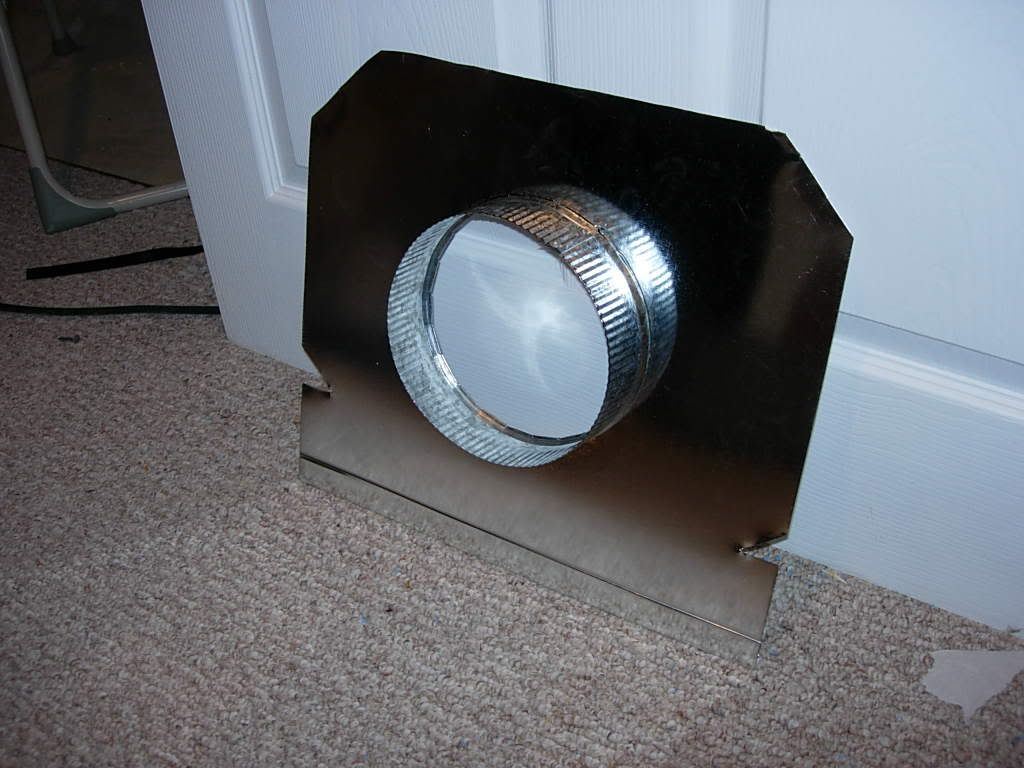

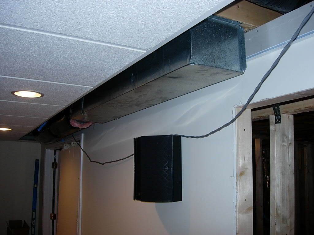

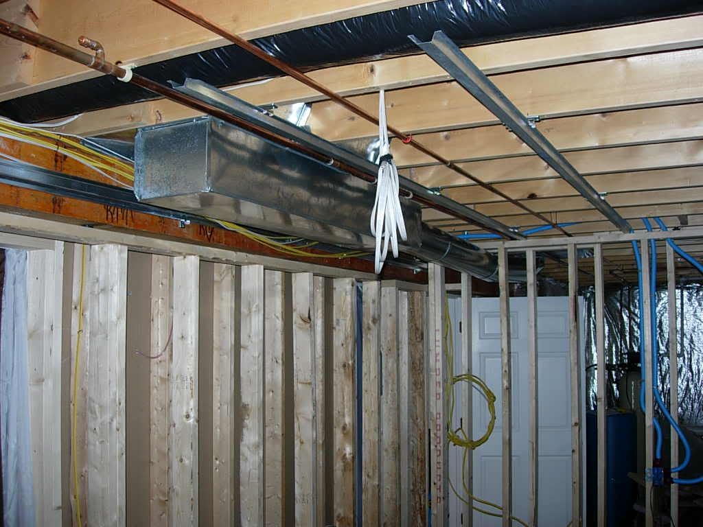

Now you see it....
Now you don't!
Estimate from contractor: $320
DIY materials cost: ~$60
Savings to me: $260! Then add that I gained a little knowledge and have the satisfaction of saying I did it myself...
Here are some pics from the process.

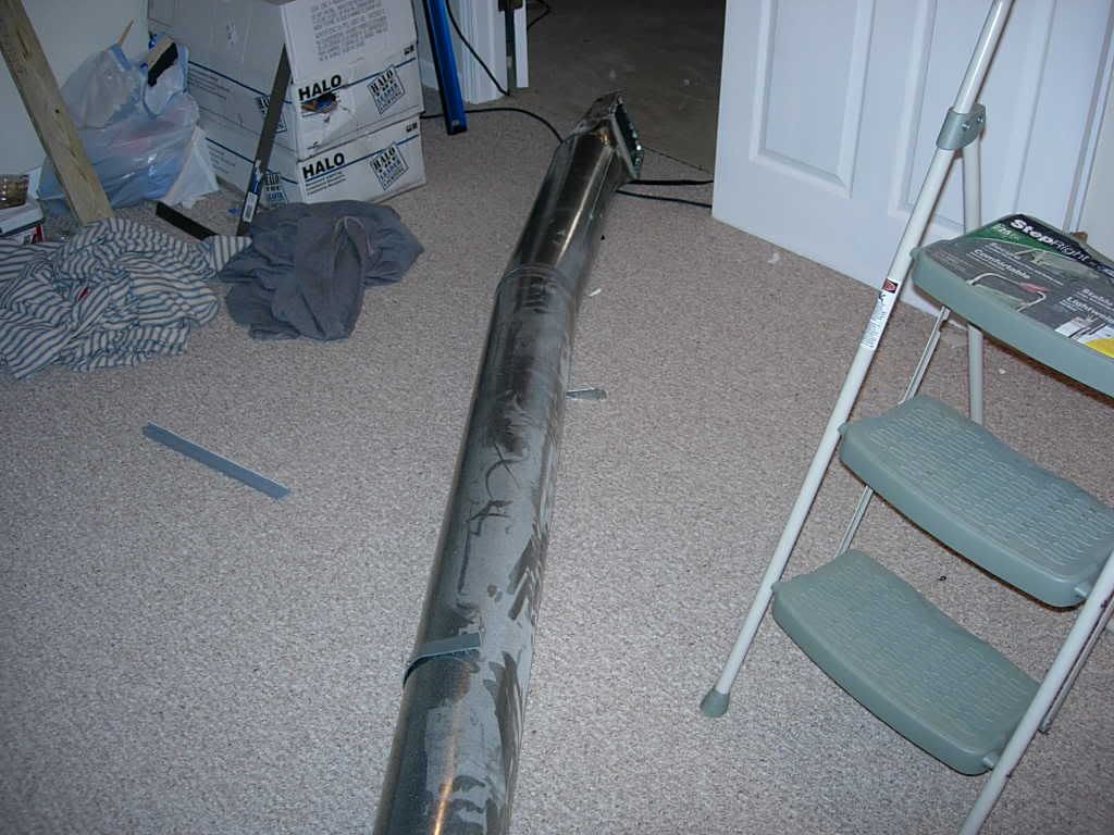

First I yanked out the metal trunk from the office that led back to the box...its amazing how dusty and gross those things get...and my allergies are still on fire from this! The people who owned the house before me had cats that I was verrrry allergic to...when I bought the house I had those carpet shampoo guys come and do the entire house twice and had every wall and floor cleaned...argh that was a pain in the butt...
Then I pulled out the old panning (which had an incredibly poorly cut bottom take-off) and cut new stuff to replace it with...I'm not sure I got the right collar though. This is what the guy at the store said I needed but I thought flex collars were a little longer...oh well, I can always add a little metal to the end of that if it slips off in the future.
Here's the collar...
I sealed up some of the other panning with silicon too while I was at it. You can see how bad some of it was from this pic...the system must have been running incredibly inefficiently because of stuff like this. I saw it in lots of places, so I think that may be one of my summer jobs...go around and seal all this up...I have a feeling it will help a lot...
I guess I didn't take a pic of the finished office line, but you can see most of the final result here. I will build a soffit in this room to hide that duct when I get around to building my "grand entrance" to the theater.
Electrician coming back this week to do a few more things...almost ready for insulation and drywall!

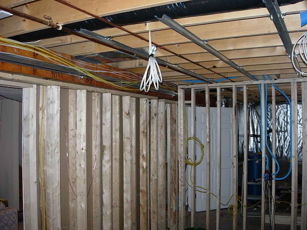

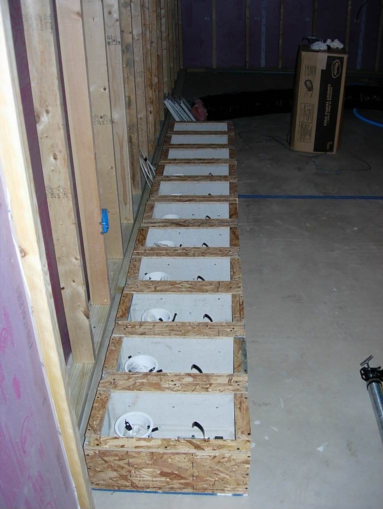

Thanks for all the kind words guys! This was definitely the most significant project I have taken on around the house to date, so I'm really glad to have it behind me!
Believe it or not, I have another pic update from today! I have been staring at a bunch of loose ends lately and they have been bothering me, so I am trying to knock them out one by one. I put the finishing touches on the last backer box tonight...
My conduit should be coming on Wednesday and then I can finish up the LV cables...one step closer to drywall!

Great job on the duct AND getting the backer boxes completed. You made a lot of progress this weekend.
