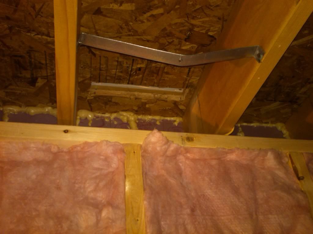

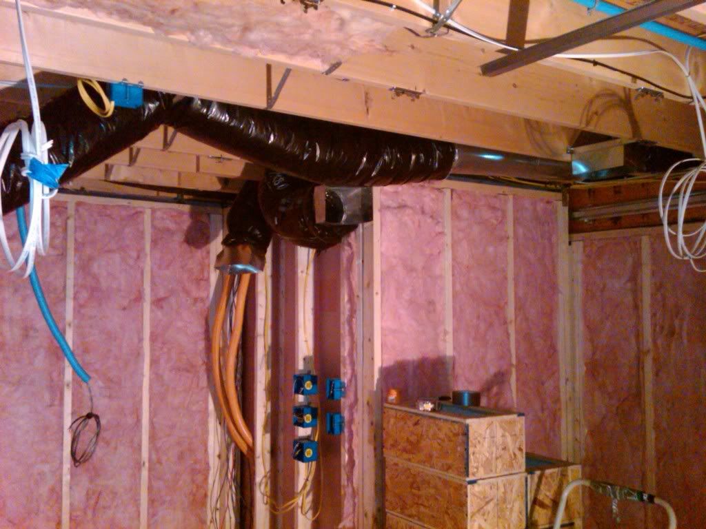

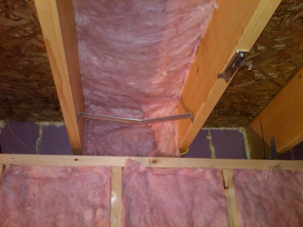

Ok wellllll I have to eat my words a little bit this morning. No way that first sheet of drywall is going up tonight. I hadn't worked in the theater for a few days and I think I convinced myself that the insulation was a lot closer to done than it actually is. I could get away with putting 10 sheets up in the front of the theater, but the back needs some attention before I can drywall. A few things I need to do:
1 - Run PJ HDMI, ethernet, and component cable. I still need to drill some holes in the joists and have been too much of a wimp to do it so far. Still figuring out exactly how I want to run the conduit, and now I realize that there is an HVAC duct in the way too. Grrrrrrr...I have wasted a lot of time on this one, but I'm gonna bite the bullet and get it done tonight!
2 - Finish silly flex duct. First, I forgot that this needed to be done, so it's the project I tackled last night. I am about 2' short , so I have to go buy another 25'. Pics below.
3 - Finish insulating. Duh. Again here, I convinced myself I was a little further along. Errrr, I have my work cut out for me to finish this by Saturday morning so I can spend SATURDAY drywalling!
Updated drywall start date: Saturday!

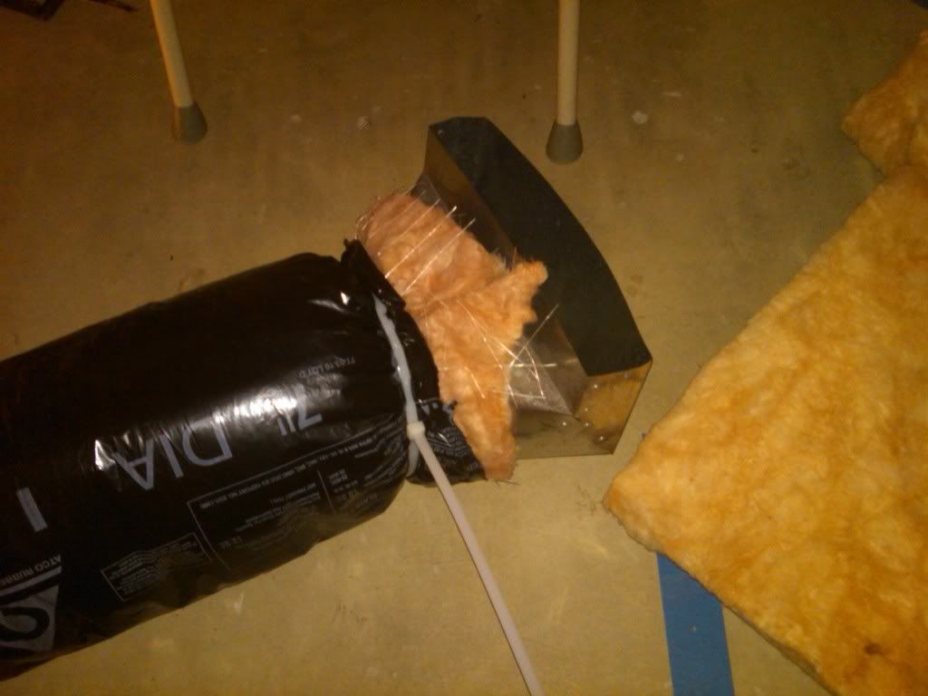

Ok, so last night I worked on replacing the metal HVAC duct with flex...here are some pics...
First, yank out the metal duct...
Next, pull off the boot and reuse. Unfortunately I had to cut about 4" off the metal duct and keep attached to the boot because otherwise there wasn't enough to securely attach the flex to the boot. Working with that stuff is like juggling razor blades...WEAR GLOVES!
Then line the cavity with some R-13. I tried R-19 on one of the earlier flex runs and it made the flex hang too low from the joist cavity and it was really smushed up against the hat channel. (Yes, "smushed" is a technical term of art. )
Finally, install flex and realize that I'm about 2-3' short. Crap. Gotta go get some more flex today...and figure out how to join the ends of two flex ducts together...
You can also see in that pic that I have started with the orange tube. I did that once I realized I didn't have enough flex last night. I think I finally have that plan worked out and it shouldn't take me too long now to resolve that mess of equipment room wires. Gotta find some time tonight and tomorrow night to put in a few more hours so I can get busy with this drywall!
Oh...and I need to build backer boxes for all of those electrical outlets and the GE! Add one more thing to the list!

Progress is progress, and you're still moving along at a good clip! Although, I faintly remember somewhere hearing mention that you would have your framing finished in 10 days or so in the beginning...
That's an easy one, just look for a 'flex coupling' at the store in the HVAC section, looks like this:
Slide the ends of your flex over each side, and tape. VoilÃ*!

I'm trying to come up with a solution that doesn't require taking every clip down and starting over, but I think that would require either cutting every sheet of drywall or adding 20 more clips. Looks like they're all coming down...
Pearl of wisdom: do some figuring and maybe even draw it out on graph paper before you just slap a bunch of clips on the ceiling! I got too over-zealous on that one for sure...
Ben, not sure what the actual channel problem is (recall that maybe your channel isn't exactly on 48" centers) but I do recall seeing in past posts that for the first layer of drywall it isn't absolutely necessary to have the drywall edge land on a channel (can hang over). Your second layer which does need to land it's edge on a channel will provide support to that first layer (assuming you have overlap of second layer at first layer "unconnected" edge). I recall as well that there is a special drywall screw (drywall to drywall) you can use to pull those areas tight together. This has been a while ago and don't recall the thread(s). Edit: here's the screw:http://www.grabberman.com/ItemDetail...icing#Features
Maybe that method would allow you to just have to cut your second layer vs. cutting both (if that's what you had in mind) and save you from re-arranging all of your channel.

Thanks fotto - I'll definitely look into that! The problem I'm having is basically this: if facing the screen wall, I started from left to right with the channel...but basically I started off a little too close to the side wall and didn't account for the electrical wires that are there now. So basically my clips are 47" from the side wall. It just means that I would have to cut 1" off of everything that's over on that side of the theater. Probably a lot better than taking down a million clips and moving them to the right one inch!
I also have some issues where I'm going to need to have breaks in the channel for the backer boxes. I was concerned about this so I talked to Ted. He said no biggie, so I think rather than rearrange, I'll go that route...although it requires ordering another 15-20 clips. That's my story for now...

Ok I have been trying to force myself not to post until I can say the room is ready for drywall, but obviously that's not gonna happen. Theater progress has been a little slow, but I am still making progress.
When I'm frustrated with a lack of progress, I tend to buy stuff. So I finally ordered the Oppo 93 this weekend and the light trims will be on the way shortly too. I was also going to order the Triad OnWall Bronze surrounds this weekend, but I haven't made a final decision on the color scheme for the room yet, and since my speakers are going to be visible in the room, I didn't want to miss out on the custom paint/grill matching they do. (I think my acoustic panels are going to end up being black, but not 100% sure yet.)
Regarding the color scheme, here's where I think I'm heading: these are blatantly stolen from John H's thread...I really like the light/darker gray colors...
I was originally tempted to go a little darker than this, but quite a bit more of my walls will be covered by acoustical panels than his...and if my panels are black, my room could quickly turn into a cave (which I don't want). I also think I'll look for a carpet with a little bit of a pattern in it...but you get the idea.
Anyway, finishing up insulation (sadly...very slowly) this week...hoping to get the first sheet of drywall up there before the weekend!
