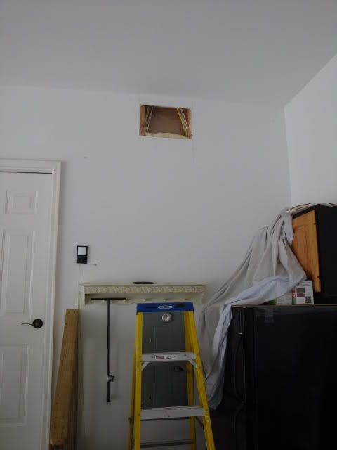

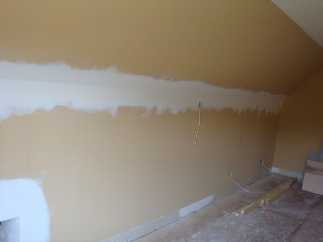

I had 3 circuits already wired into where I need it. 1 15A was/is running the preexisting can lights (removed) and outlets (this will all change). The builder had run 2 spare lines (14-3 and 12-2) as well (not connected to a breaker in the panel yet). I wanted 2 more 12-2 lines run.
An electrician friend of mine came over yesterday with the goal of running additional power from the sub-panel in the garage to the theater. Actually, all the power will be run to the unfinished room next to the theater and then branched from there to where it's needed in the theater.
Anyone who has run wiring to the second floor of a finished house understands how difficult/tricky it can be. I initially thought it wasn't going to be that bad because the main trunk of wiring for all of the second floor "seemed" to go straight up from the sub-panel into the unfinished room next to where the theater will be (above the garage).
Of course, the straight line to the panel wasn't exactly a straight line. The unfinished room does have sub-flooring down. The wiring went up under the sub-flooring in the unfinished room then turned and came up through the bottom of an unfinished wall. The distance between where it comes up from the panel to where it comes up through the unfinished wall is ~ 1 - 2 feet.
Needless to say it did require a bit more work.
1) Cut the sheet rock at the top of the garage wall directly above the sub-panel - being extremely careful not to nick the wiring behind it.
2) Cut a portion of the sub-flooring in the unfinished room on the second floor to gain access to the wiring.
We cut a new hole through the garage wall top plate (where the sheet rock was removed) up through into the unfinished room. 2 new 12-2 wires were run up in parallel with the existing wires, then up through the unfinished wall.
These will all be tied into the sub-panel in the future. I will be working through running the wiring throughout the theater room next (can lights, any additional outlets, AV Rack, etc.

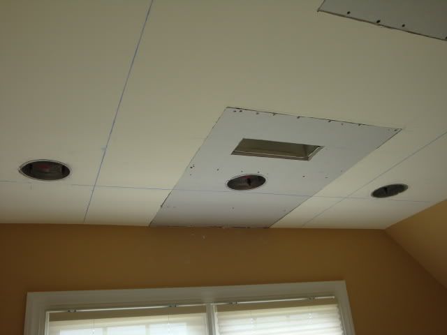

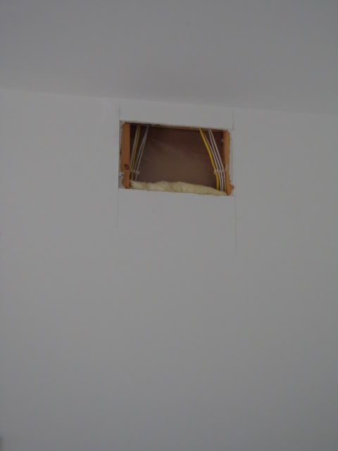

Spent the last couple/few days running the electric in the room for the can light housings. There will be a total of 9 can lights, 3 separate zones. running the electric was not the funnest. I had to get up in the "attic" crawl space again (and I will again to run other wires) which is tight, dark, full of insulation, no sub-floor, and hot as hell. I have to contort myself in positions I have never been in before .
BTW - this right here is a must when doing this type of work. Especially when you need all your limbs to balance and your working in a dark area.
http://www.amazon.com/gp/product/ima...sporting-goods
anyway - since we all love pictures here you go.
Here is the scheme for the electrical runs for the room.
Holes cut, wires run.
Run to the back wall where the switches will be.
6" Can Housings (IC Remodel) installed. Also notice the other holes in the ceiling are patched.
Up next is to accurately map out the column/sound absorption panel positions. I will be building a cove to house the side speakers and the subwoofers and running electric and wiring.

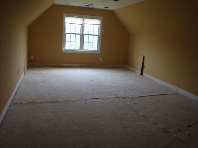

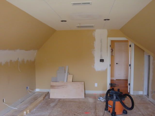

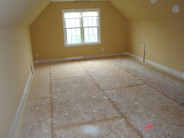

I decided before I go any further, it was time to remove the carpet. Pulled all the "stuff" aka tools out of the room, cut the carpet into 4 sections to make removal more manageable, removed pad, removed tacks, and vacuumed. Pics below.
Next up - build area for recessed Subwoofer, finish electrical wiring, run speaker wiring, tape & mud & sand.

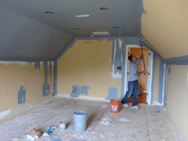

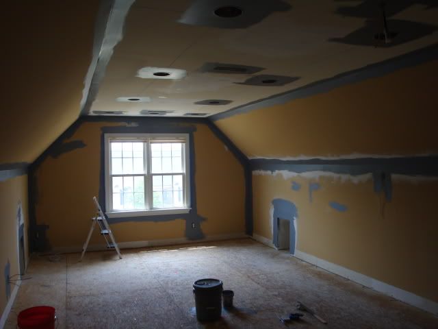

All wires are run, holes patched and sanded, and primer applied to ceiling and walls.
Thats me painitng

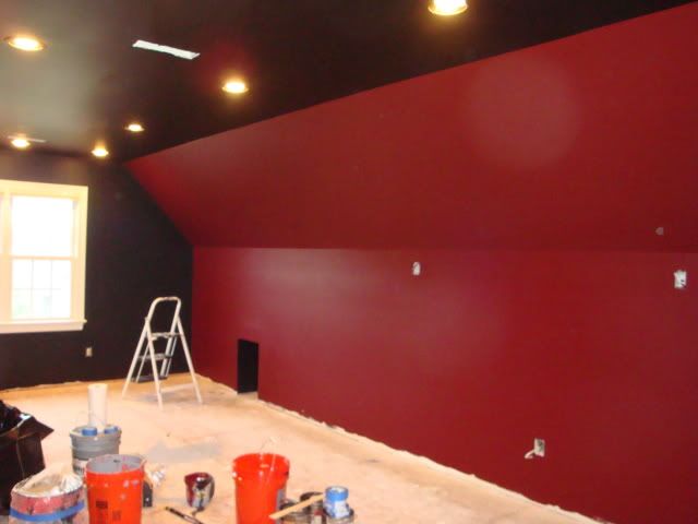

Some people wait until most construction is complete before painting. I have decided to go the other route, paint first, construct later. I have enough paint for any touch up work that will be needed.
Here is the color scheme so far:
The plan is for the fabric for acoustical treatments to be a deep beige to brown color. I haven't selected the fabric yet but that will come in due time.
Here is the front wall - painted black
Here is the rest of the room with painting finished. Everything took 2 coats on top of the tinted primer.
I was impatient with the photos and the "Chipolte Paste" paint is still wet. This paint actually darkens quite a bit when dry so the color will get deeper.
All the walls will probably get one final coat when all is said and done.
Next up .. window plug/box out and stage construction.

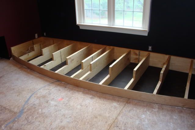

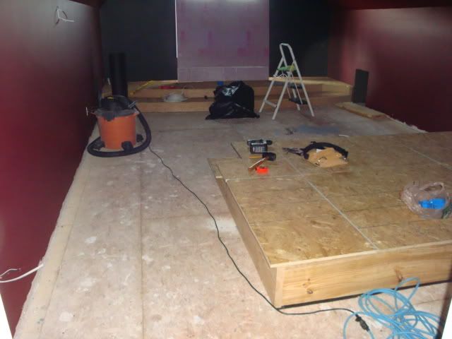

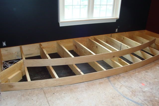

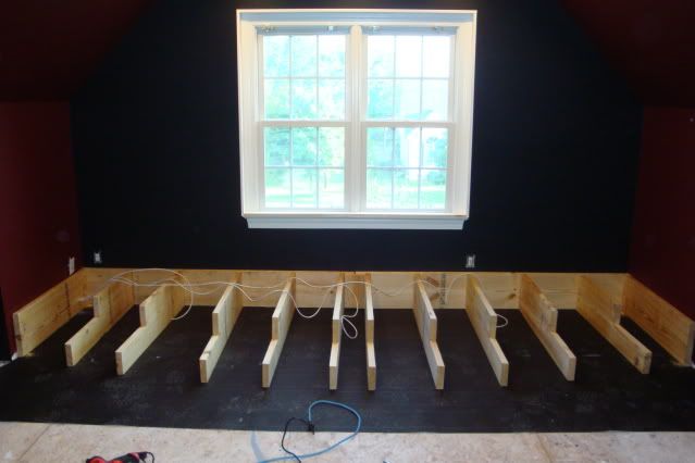

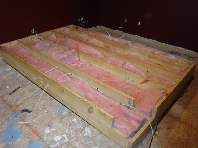

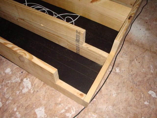

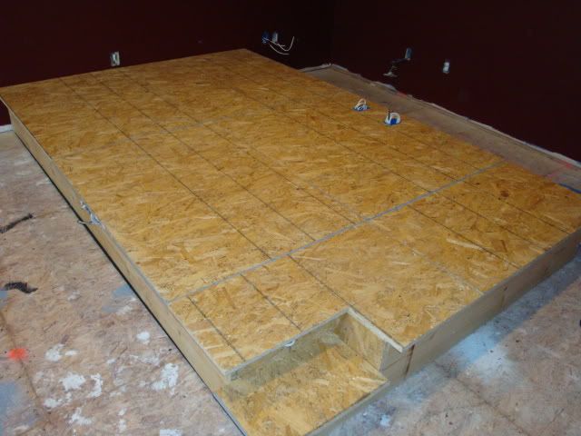

Moving along with three theater projects - Stage build, riser build, and window "plug." Still working on the window plug but I will document each in separate reply posts.
Stage
Plan:
Two tier curved stage that is 6" and 12 " tall. Here is the sketch with measurements:
Materials:
(2) 4'X8'X3/4" OSB
(8) 2" X 12" X 10'
(1) 4'X8'X1/8" Hardwood plywood
(2) boxes of 2 1/2" screws
Roofing felt
(3) old work 1 gang electrical boxes
Process/Progress:

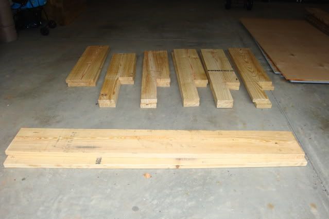

Stage was built to be free floating so (2) 2"X12"X10' were cut in equal lengths to match the width of the room (slightly shorter ~1/2" total). Each joist was cut to length X 2 (according to the sketch plan) and the notched to account for the step. (see above photo.)
30 lb roofing felt was laid on the floor to cover stage area.
Followed the plans, measured, framed, and secured all pieces.
Cut the hardwood plywood to height and length, doubled up and secured to the front for the top and bottom step.
Added the angle pieces near the walls.
Cut holes in the joists to run the speaker wire, added insulation, and ran the speaker wire.
Added OSB top. For this I laid the OSB down, traced the outline of the curve from underneath, then used a compass set to 2" and retraced to add 2" overhang. Cut trace with a hand held jigsaw, then secured to the joists.
Riser is framed as well and I'll try to post progress tonight.

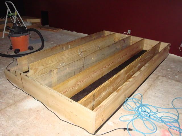

post #55 of 152 Old 08-23-2011, 03:39 PM - Thread Starter
MysticalJet's Avatar
Posts: 625
Quoted: 81 Post(s)
Liked: 153
Built the Riser over the last week as well. The total height of 12".
Plan:
Here is the sketch with measurements. One step on the front left of the riser.
Materials:
(6) 2"X12"X10'
(2) 2"X12"X8'
(3) 4'X8'X3/4" OSB
Roofing Felt
2 boxes of 2 1/2" screws
(6) single gang old work electrical boxes
14-2 electrical wire
Process/Progress
Cut all 2"X12" to appropriate lengths according to the plan, cut out spaces for electrical boxes, and pre-drilled holes for the electrical and speaker wire runs. Laid out the roofing felt, framed and secured all the wood joists. The Riser is floating and was kept ~1/4 inch off the wall.
Laid insulation in between all joists, ran electrical wire and the speaker wires.
Measured, cut OSB, precut outlet box openings, and installed OSB top. Left a 2" overhang on all sides. Same with the step. Installed all electrical boxes.
A picture from doorway behind riser facing stage (bad picture and will take another eventually and post).
That's it for the Riser. Next is to finish the window plug (about 80% complete), select carpet and have installed. (Screen wall is going up after the carpet).
