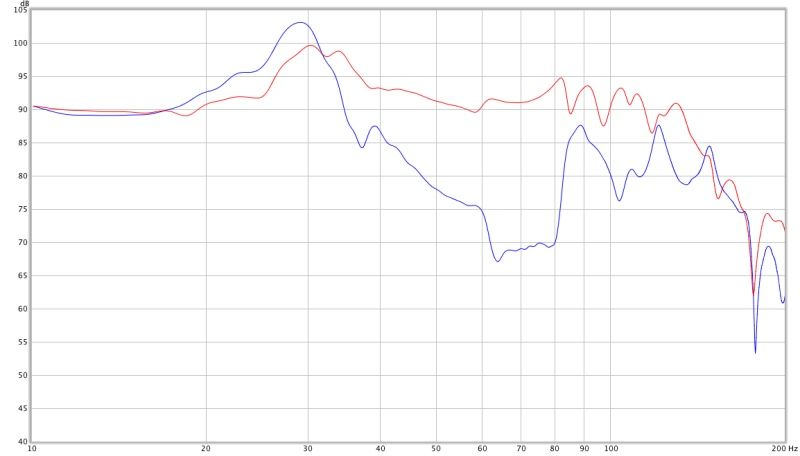

Thank you all for taking the time to respond. I have not done much more since last week, I've been busy renovation my bedroom and closet. I decided to come back down tonight to play around and did find something interesting. After I did the following test, I guess since the MFW's can't compete with the IB's, they actually won't do much good. I decided to unhook my IB's and run my MFW's only to see what results came of that. I found that with both MFW's in the front of the room, I got similar results (as compared to the IB's alone) only with about 7-8db less output. Now, if I have one MFW in front and the other right behind the rear center seat with the driver firing against the seat, I got MUCH better results in the back row except for a small sharp null at 30hz. My front row still had a huge 60hz rise but was smoother going up to it. Bottom line is that because the MFW's can't put out what the IB's can, it seems that they won't be much help in my situation.
To answer one of Fred's questions, yes, the the subs are level matched. If I play the IB's alone vs the MFW's alone, they both show 75db on my meter while using the receivers' test tone. I don't know why MFW's alone test at about 7-8db lower than the IB's alone
Also, all polarity seems fine, nothing out of wack.
Also, about placement. I don't feel the need to do a crawl test since I only have a few potential placement spots, but I wil try other tests to see what helps.
Here is graph comparing the IB's (with and without the rear MFW's) along with the MFW's alone. The red lines show the IB's alone vs the IB's with the MFW's in the rear, you can see that the MFW's helped slightly, by only by a few db. The blue lines show the MFW's (both up front vs one up front and one in the rear), what a difference! All FR's are of the rear row where I have that large 30hz mountain.

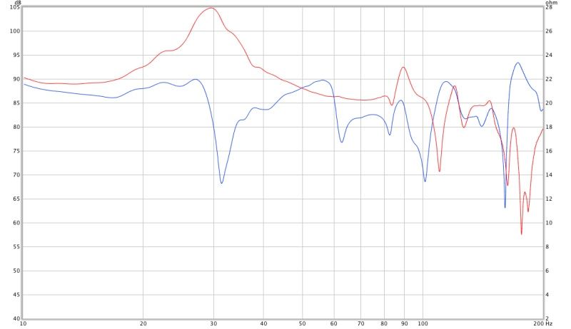

So, while I'm awaiting some feedback on my most recent graph, I would like to post a question that I have been thinking about lately.
First, lets take the front row for instance. I'm pretty flat up to about 60hz and I have level matched my sub output to that of my mains, but why oh why is there almost no bass present? I really feel almost no low end in the front row. Same goes for the back row if I EQ out the huge 30hz muontain. Why does it seem like I would have to seriously crank either the AVR volume or the gain on the EP4000 / sub gain in the AVR to get decent results?
It's been bothering me because I read about other folks buying regular box subs (granted they can be pretty massive like the Seaton Submersive, and others in that range) and they seem to rock the house of said purchaser! But why do I feel like I really need to crank it up to ear piercing levels to enjoy the LFE part of my system? I guess I need to take some SPL reading during some scenes that I'm familiar with and see what you guys think of my current levels. If I play The Incredible Hulk at my comfortable but still kind of loud volume, there is almost no bass in the front row. I guess bottom line is that at the volume I listen at, the bass is almost non existent. I feel that I should still have the bass "rumble" even at lower volumes.. What's wrong with this? rolleyes.gif

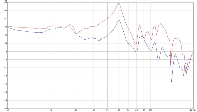

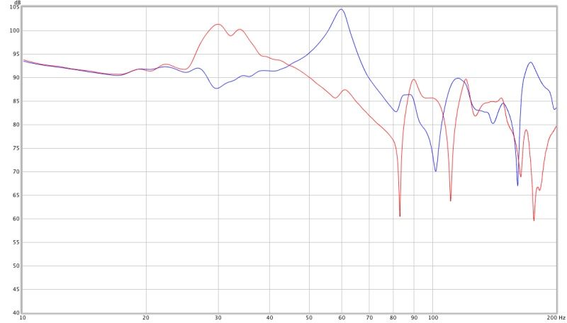

Originally Posted by Digital_Chris View Post
Front row overlaid...
Subs only = purple
Mains only = red
Subs + Mains = green
Rear row overlaid...
Subs only = purple
Mains only = blue
We see the front row has constructive combination occurring between the subs & LCR which is further emphasizing the peak near 60Hz, while the rear row measurement shows cancellation with the level droping below either speaker/sub individual measurement. An adjustment of the subwoofer distance would be the easiest to experiment with quickly. 60-70Hz equates to a 1/2 wavelength of 9.5' to 8'. We don't want full cancellation, so I would start by adding 4-5 ft. to the subwoofer distance. Before making this adjustment, measure the center channel + subwoofers as you currently have them. Now make the +4ms adjustment and repeat the measurement in both locations, making no other changes. I would then focus on the front row to make adjustments that best smooth the peak at 60Hz without major holes in the response. Now check what happened in the rear row. I suspect you will see the combined response above both of the individual responses. Not perfect, but it could be a big improvement and you haven't asked any more output from your speakers or subs.
First make these adjustments to get some improvement around the crossover. You can tinker with the 30Hz peak in the rear row after you get the front row sounding more impressive.
Hopefully that helps some.

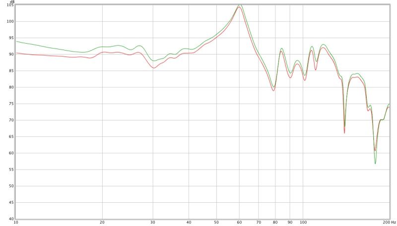

And thanks Mark, I did a little more testing today without the mains in the mix and set the crossover to 250hz and I made a startling discovery!! If I put one MFW in each rear corner firing into the corner bass trap, my rear row is IMPRESSIVELY improved! Take a look! Bue is IB's alone and Red is with the MFW's in the corners.
I tried the MFW's in all other spots back there before and nothing had a change like this did, but today I WILL try those other spots again just to confirm that firing INTO the corner actually does the trick!
The front row has a change as well, in a good/bad way I suppose. What do you think?
Now another funny thing, this is all with no EQ inline, just rca from AVR to EP4000. If I add the BFD inline and deactivate all EQ functions, I get a few db rise over the whole graph, is this normal?

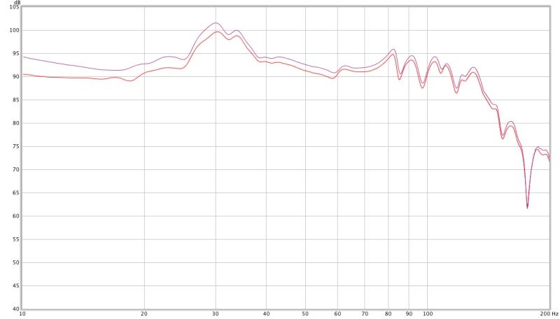

Ladies and gentlemen, I have some VERY good results from the other night! I think I've mentioned this already but whenever I added my mains to the mix, the freq response goes bonkers! So, I decided to play with crossovers and sub distance. After about a half hour of playing around, I came to a very acceptable setting! X-Over at 60hz and sub distance at, wait for it...... 1ft !!!
I went from this (60hz x-over and true speaker distance)...
To this just by dropping the subwoofer distance in the AVR down to 1 ft!!!
My only concern is with the MFW's... I had to turn them up about 5-6db higher than the IB's to get this flat... I'm worried about over excursion of the MFW's at lower freq. I decided to add in a 30hz FMOD for the MFW's and this is what happened...

Well, the eq.2 subsonic filter does more damage than good no matter what freq I set it at, so that's a no go. I do have some good results from last night but most likely won't be able to keep them, here's why. I ended up cranking the MFW's up more than last time and then added a 30hz boost to the MFW's of roughly 5db. On top of that, I played with x-over points and subwoofer distances until I came up with this...
Looks great, right? Here's another thought. I have feasibility of taking two of the IB drivers and mounting them on the wall in the rear right corner of the room. I just need confirmation from the IB forums that this will work.
On a weird note, even after I got this flat via REW, when I play music, the bass notes and bass drums are at least 6-8 db louder in the front row vs the back row. No where on my graph in the bassy region do I see that sweep except around 170hz. Front row is red btw.
These notes I'm hearing/feeling a difference in could be higher than 200hz, I don't know.
