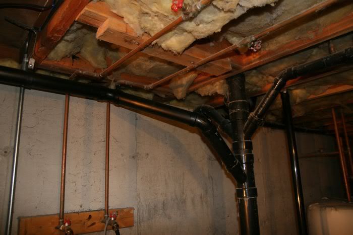

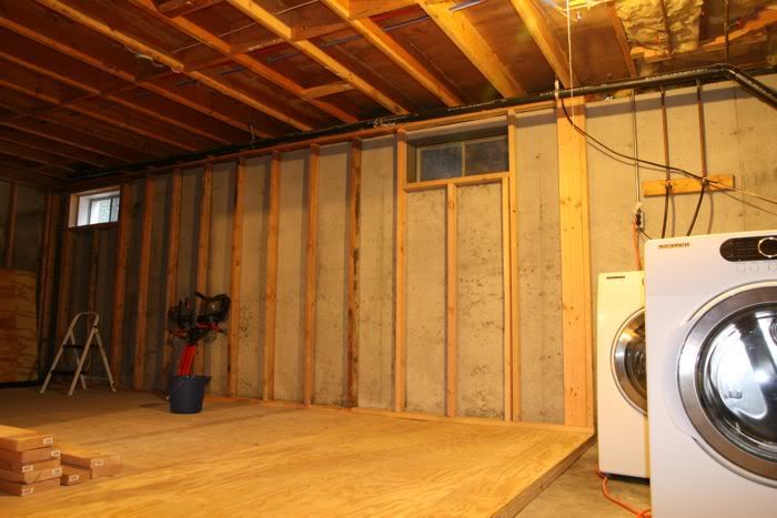

Here are some pictures of the basement room, again, the room right now is about 14 ft long by 10.5 ft wide. I want to move the wall past the window to the 2nd concrete line maybe a little farther but not much...
And now here is the room all gutted of drywall and most insulation...
Here is the corner door area of the wall I want to remove/move...
The piping you see will be moved and tucked up against the wall and the copper water lines will be tucked up into the ceiling, I want the room to be able to do a DD/GG ceiling along with the walls..

To be honest though, I'm sure I'd be plenty happy with only DD/GG all the way around. The ceiling is really the only part I would like to sound proof the most since the rest of the walls don't lead into the upstairs.

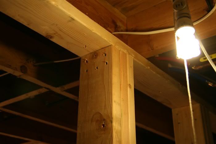

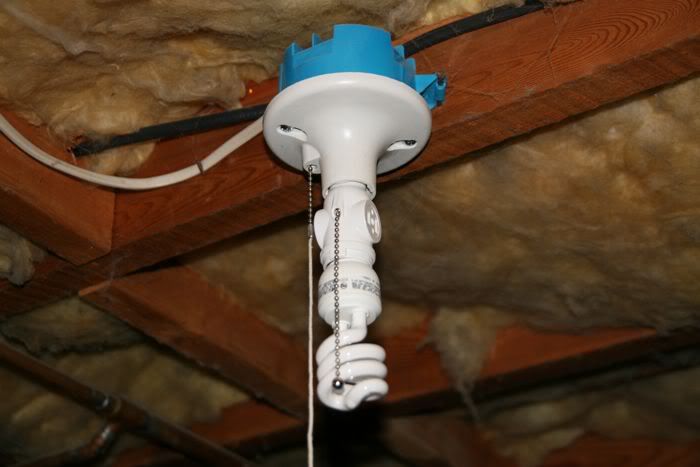

More importantly, what's the deal with the light bulb in this picture? It looks like 3 bulbs.

LMAO!!! Here is a closeup just for you

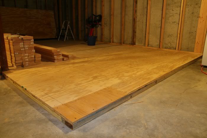

YAY!!! Finally making some progress! Floor has been extended and new walls are starting to go up! I will post pictures soon
I do have a question though... I will need to get a door soon, solid core or solid wood is what I'm looking at, but the catch is that my door will have to be shorter than normal by about 6"-8" or so because of clearance issues... What do you guys recommend for a door and frame? I'm looking for a nice solid door to help keep sound in but I'm not looking for a total sound proof room, just something solid and tight.. Any suggestions?

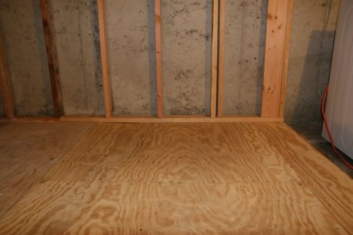

I decided to build my wall from doubled up 2x6's, 24" on center with double 5/8" subfloor plywood on top. I think that should give me plenty of bracing and I can always box around each sub, bracing them even more.

On a good note, here are a few pics of the upgrade work so far...

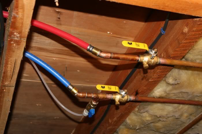

We removed the copper water lines to the kitchen sink and replaced them with PEX tubing and fittings up into the beams, that way I can put drywall up there. The sink drain is the next upgrade, will be done in a few days...
The final room dimensions with CC/DD should be just about 18' long by 10.5' wide by 7' high, should be a nice size for 6 seats (2 rows of 3)

post #56 of 300 Old 04-10-2011, 04:48 PM - Thread Starter
Digital_Chris's Avatar
Join Date: May 2010
Location: Enfield, CT USA
Posts: 651

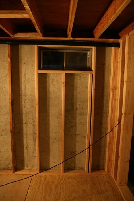

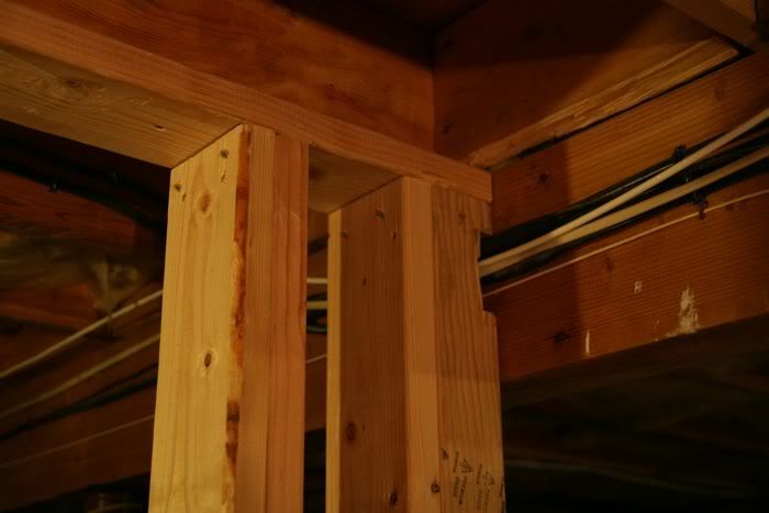

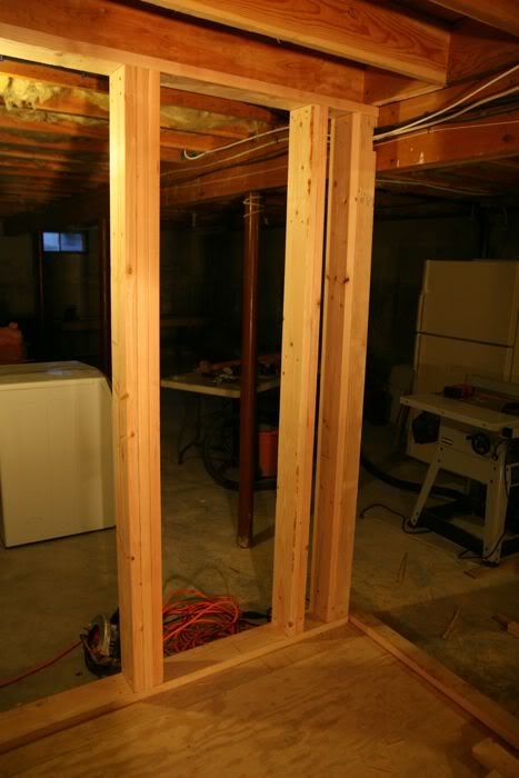

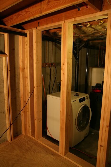

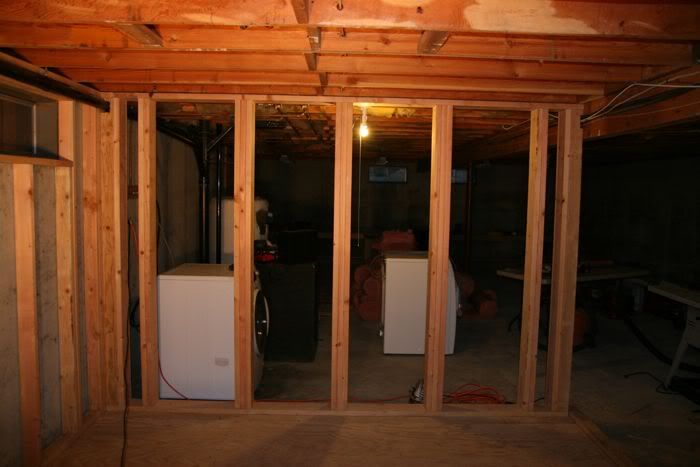

Oh MY Gosh!! FInally got some work done. The screen wall is up, braced better than originally planned, no such think as too much weight and rigidity when it comes to a line array
Check it out!!

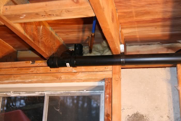

Here is the plumbing, nicely tucked up against the wall and corner..
The wall itself is made from 2x6's roughly 24" OC. The 3 middle sets of studs are tripled up and the ends are doubled, I'm sure it's not a necessity but I had the wood so why not..
So there it is, next week is framing out for the door which I am still unsure of what to get. Couple off issues I am in the middle of working on...
1. I mentioned the door, I have about 4" less room than a standard door requires and I need a nice solid door. What are your recommendations? Should I see if Home Depot can custom order something for me? Should I have a custom exterior solid door made? I'm not too sure on where to start besides the knowing the specs of the door itself (solid, heavy and flat).
