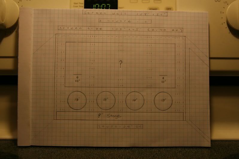

Thanks so much for you input, just a couple questions and concerns I guess..
For the two walls against concrete, I should just chop off the top of the stud and use DC-04 clips in place? Also, because they are against concrete, why the DD/GG?
Now, for my other two walls. One of them is the screen wall. I don't know if it would be a good idea to decouple it from the ceiling joists because I need the rigidity for the IB subwoofers. Maybe the DC-04's are stronger than I'm picturing and I can just use multiple DC-04's per stud? If you take a glance at the previous page (whatever page shows my completed screen wall), you can get a better idea of what I'm working with.
The 2nd interior wall will be on the long side of the room. I don't think I need to do staggered studs because I'm not so woried about the sound on the other side of that wall, just up through the ceiling into the upstairs. Can I just to DC-04's with DD/GG and call it a day?

RE the two walls against concrete, you can rework them with shorter studs but keep same top plate (now disconnected from joists except for DC04's). You question almost sounds like you are asking about cutting them and then putting a DC04 on each stud? That would get expensive and I've not seen that done before. People use the top plate again on the shorter studs, and then DC04's every 4'. If that's too much work, you can alternatively use clips and channel on the existing wall(s) and leave them as is. I recommended DD there as that's what Ted recommends (to me at least)
Don't know what to tell you on the screen wall for sure. I suspect you could still use DC04 on that wall and go closer than 4' spacing (maybe every 2'?). I'd give Ted a call to discuss further.
I guess your idea on the 2nd interior wall is one of those areas where it becomes cloudy on results if you don't do staggered studs. While you may achieve disconnection improvement, not getting it properly decoupled may allow enough sound through opposite side that it will flank up into the second floor anyway. Tough to say how much.

I plan on doing 4 18's in a line array below my screen with the back of them open to the rest of the basement... should work out well
I decided to build my wall from doubled up 2x6's, 24" on center with double 5/8" subfloor plywood on top. I think that should give me plenty of bracing and I can always box around each sub, bracing them even more.
I just noticed this...although I haven't looked into IB, from what I've seen in other builds people doing an IB set-up typically have a totally sound isolated "chamber" built if sound isolation is a goal. So, if your IB chamber is "the rest of the basement", what's the point in worrying about soundproofing your walls?
Sorry if this is a stupid question but I don't get it
fotto is offline

It's not a stupid question, but now that you ask, it made me think for a minute. Overall, I guess I'm just trying to sound proof the upstairs from everything but LFE content. If I'm going that route, is all of the above sound isolation necessary or can I get away with less because I'm not trying to isolate LFE?

I don't believe that I can give you a qualified answer, as I've never ran across this scenario before.
I really think Ted White is the one you need to consult

IBs can't really be sound isolated unless you isolate the back chamber also. The sound will go through the cones of the IB drivers.

Well, while I'm in the middle of figuring out my sound isolation construction, I bought some audio gear and almost finished my screen... what a PITA! I mean, I'm a hands on fella and unfortunately a perfectionist so when things don't come out perfect, I get annoyed, very fast.
Here is my progress so far...
Last week I built my screen frame, that went pretty well except for when I made my 45 deg cuts on each piece, they didn't come out at a perfect 45 deg, so my squareness was a little off... Then I bought material to cover it, bought felt the first time around and realized it was the wrong stuff and that I should have bought velvet instead, so, I went back to Jo-Annes and bought the correct material. Then came the wrapping of the pieces, eh, not soo good. Now, stretching the Seymour AT screen material over the frame? I am NOT having fun with this
Digital_Chris is offline

looking at those sub boxes I would suggest 1-2.5' off the primary wall, so you'll be looking at a false wall at 2.5-3' or may be 4'..
you could insulate the boxes a bit though I'm not sure if that would help your situation, I would say it might be better to dome the wall behind the subs might help deflect some of the reverb noise...
