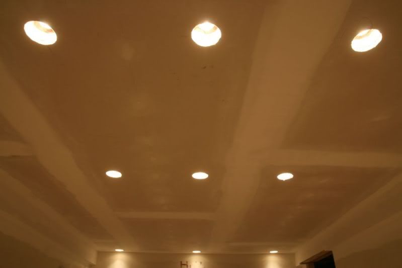

Well, this update is so overdue I'm almost embarrassed
I have done quite a bit since my last update so bear with me...

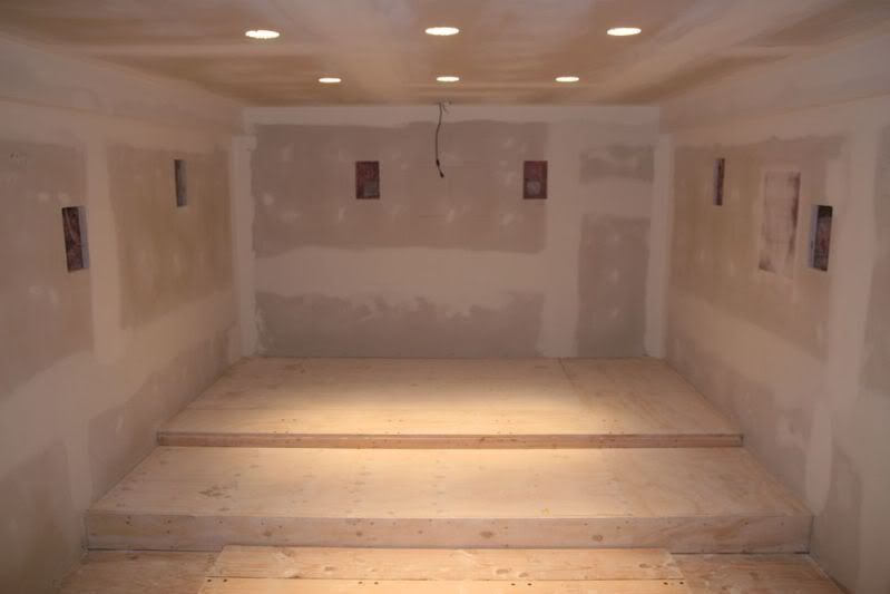

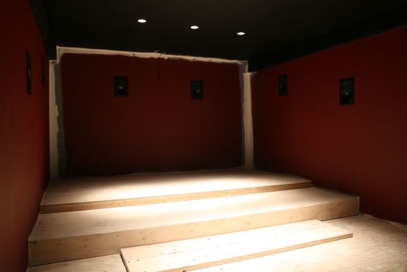

First came the 2nd layer of drywall, as you can see in the first few pics I didn't have studs behind a few pieces so I had to "clamp" the drywall together while the GG set up..

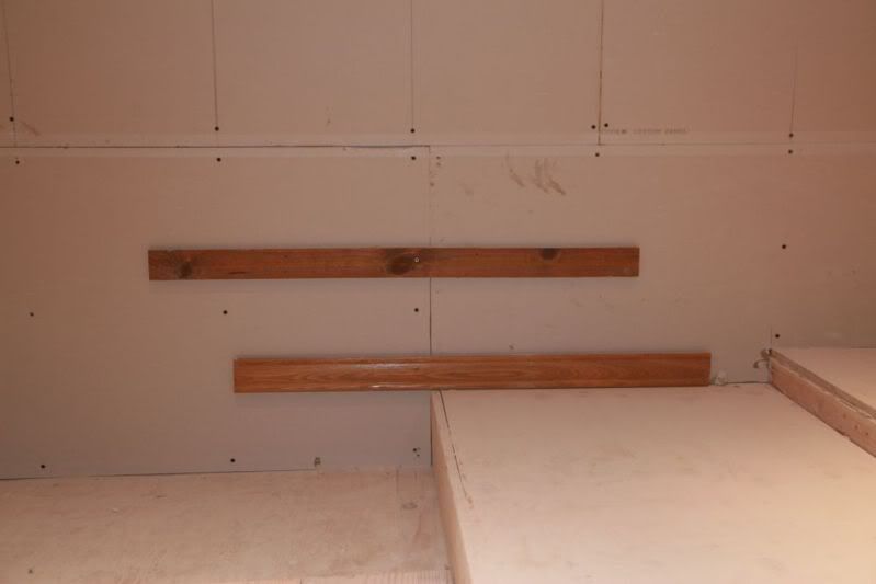

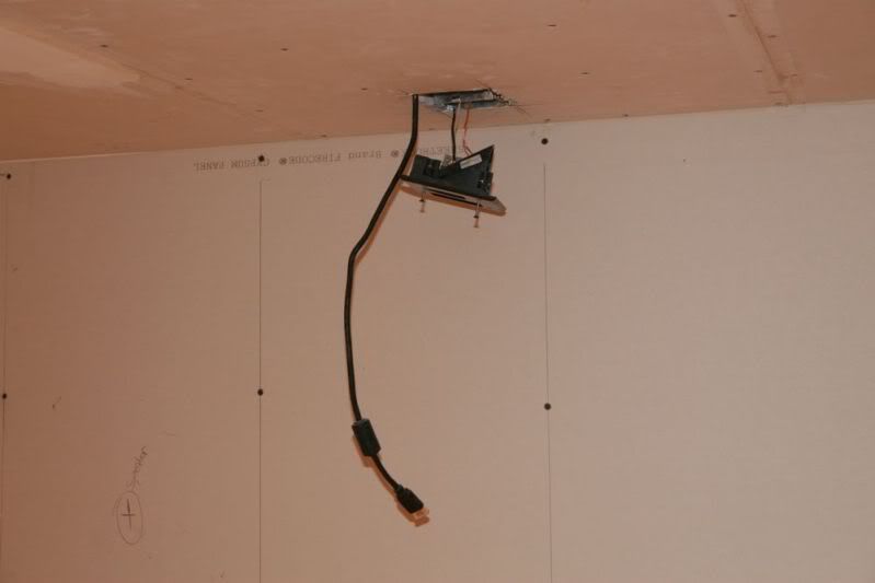

Here is a shot of the PJ wiring hanging like a champ...

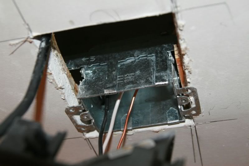

And a shot of the metal box I installed, which turned out to be a nightmare so I replaced it with a plastic box (no picture, sorry)...
And then came the dreaded mudding and taping.. I was at first ready to hire out the work, but then my good buddy justin came along and assured me it wouldn't be that bad. Well, at least I saved some money, right? ...
What a TERRIBLE TERRIBLE idea, so much mudding and taping it was ridiculous. Either way, it's done now...

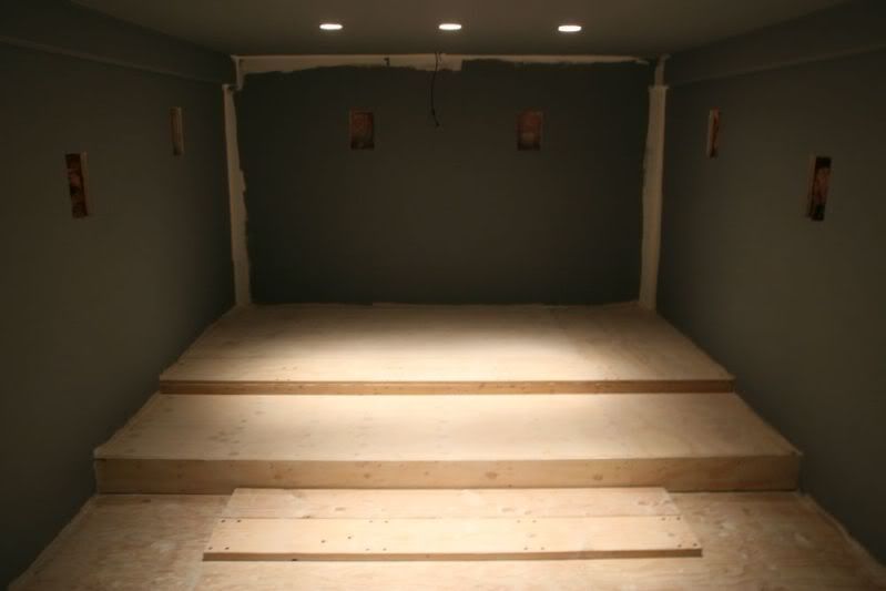

Then came the primer...
Followed by the paint (which came out terrible btw)...
Why terrible you ask? Well, I learned the hard way that I don't know how to paint properly... I let my arms do the work and not the paint, so, MAJOR roller marks were left behind, it looks absolutely disgusting. Disgusting to the point I want to buy another gallon of paint of each color and put on a proper final coat. I might not do the walls because they're not as bad as the ceiling and also because the fabric panels will cover most of the color but it still bugs me

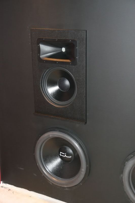

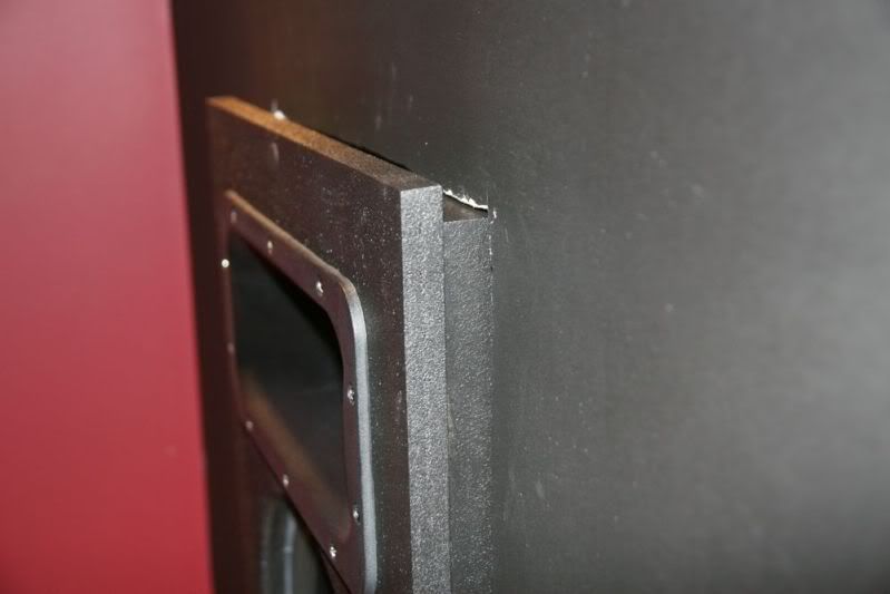

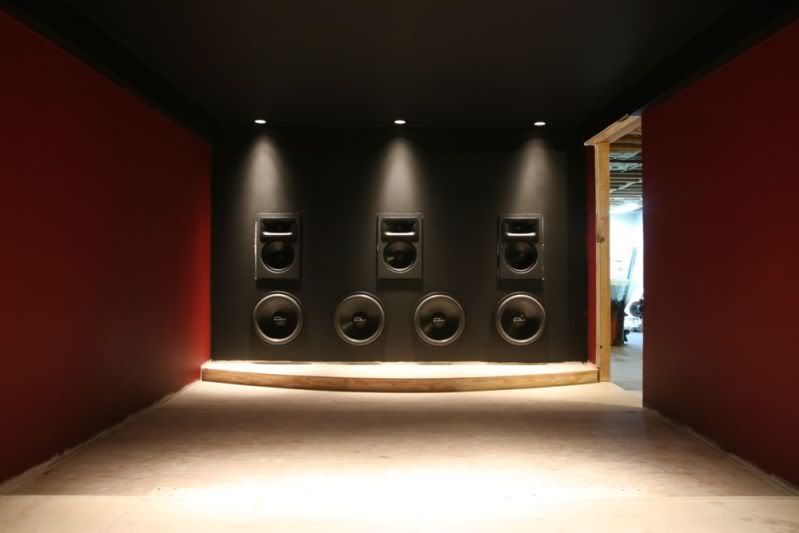

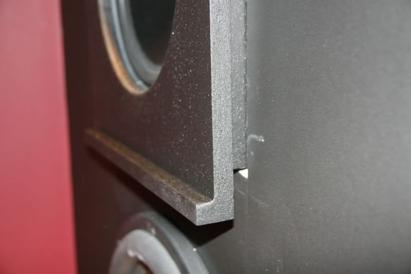

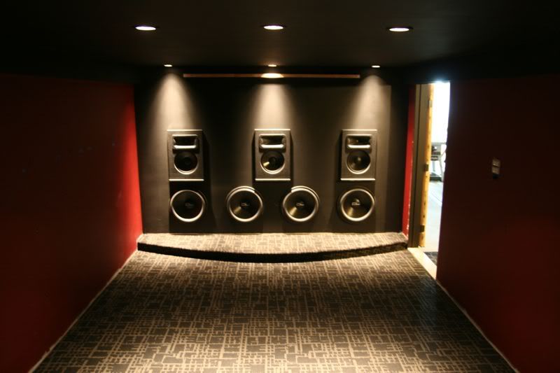

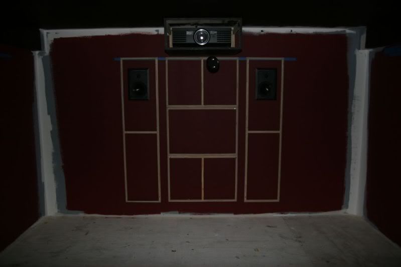

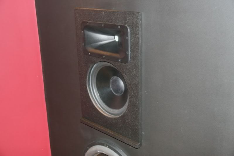

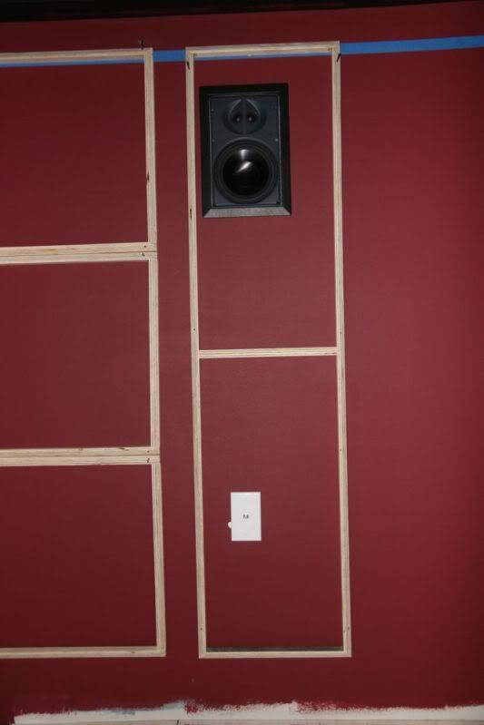

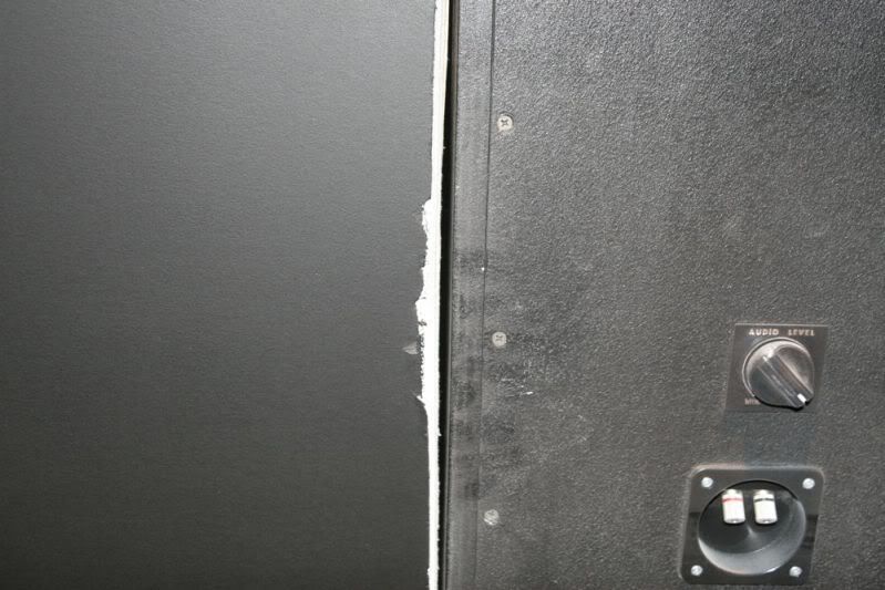

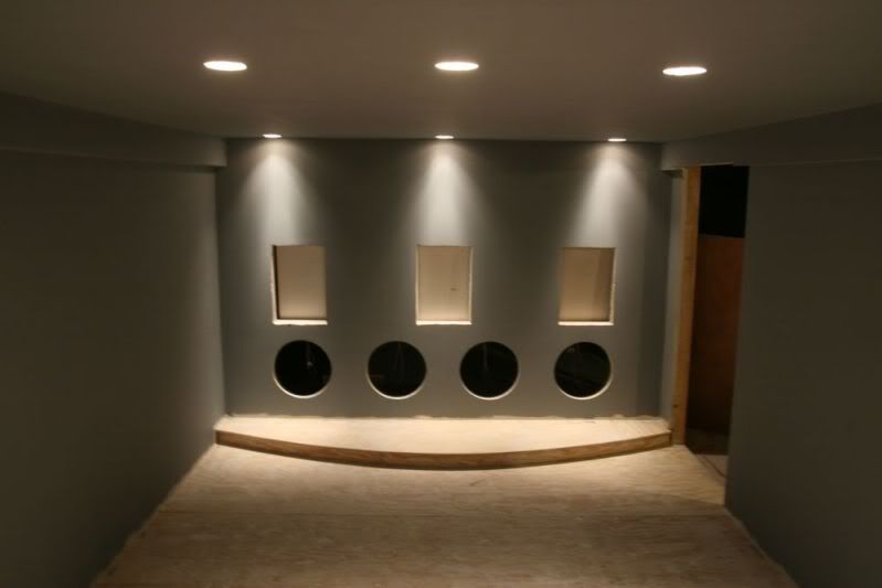

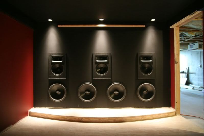

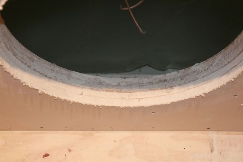

I also figured out how to seal up and mount my LCR speakers to the front wall... To seal them, I made a lip around the cab that will sit nice and flat against the wall with some weather stripping behind for the seal.. To mount, I installed a 2x4 above the cabs in the back and mounted them to that with brackets from home depot... The end result I am pleased with
Here is what the speaker would look like originally (cab reversed just to show gap)
Here is the lip and how is sits against the wall...
At the bottom of the cabs, you will notice a lip that extends "outward". That is what the screen frame will sit against and therefor be properly spaced away from the speakers.
All speakers installed in the front wall...

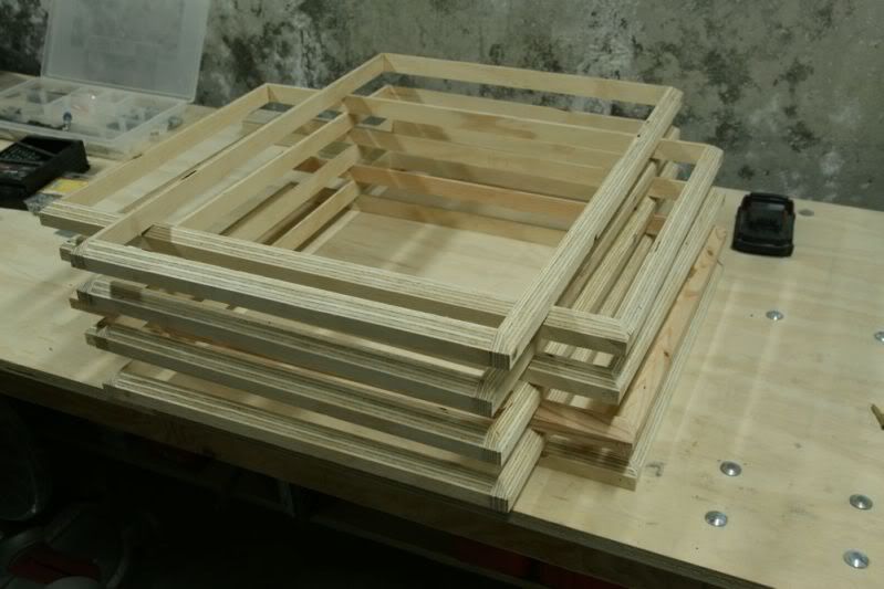

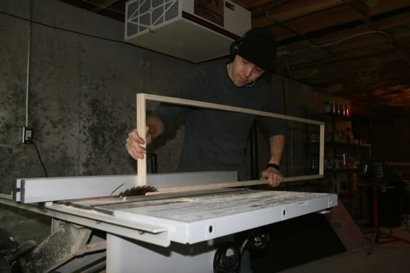

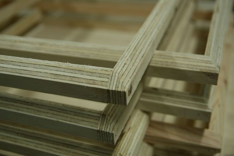

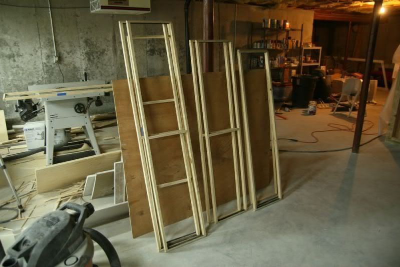

Next came the assembly of the fabric panels.. Using a similar technique to GPowers, I used "cabinet grade" plywood from home depot, cut proper length strips that were 1 1/16" x 3/4", assembled them into frames with a few braces if I felt were needed and then added a beveled edge to the perimeter using the table saw. The frames are 1 1/16" deep to accommodate 1" rigid fiberglass behind certain panels. I don't want to give up to much real estate for thicker panels but I still might space them away from the wall a tad for the "free lunch" as LocalHost would say...
Who sets up their camera to take a picture of them self cutting the bevels on the panels? Thats right, this guy does!!

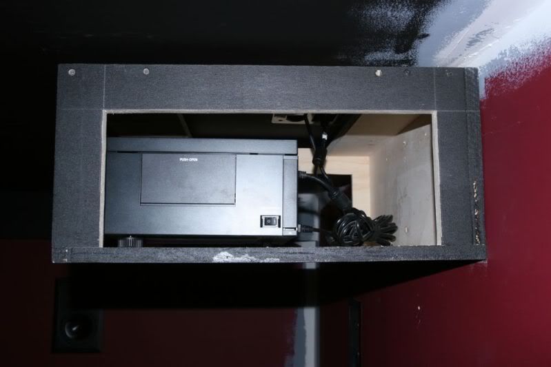

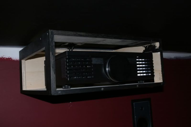

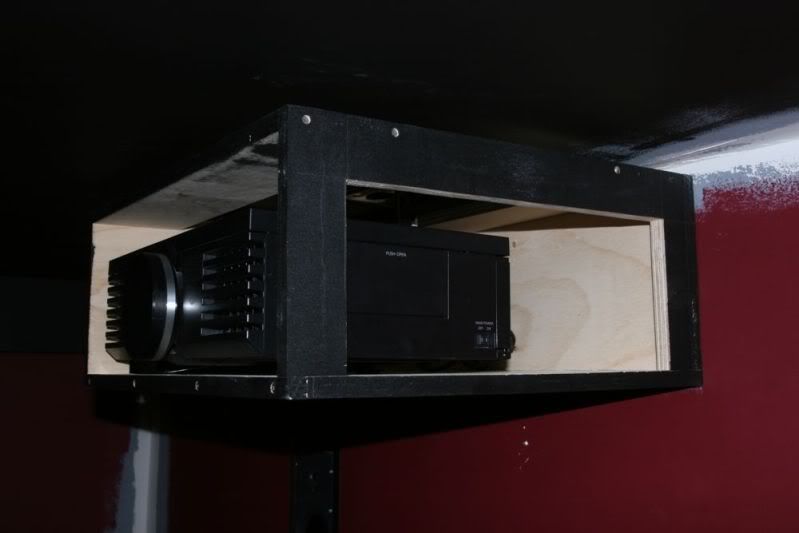

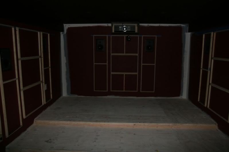

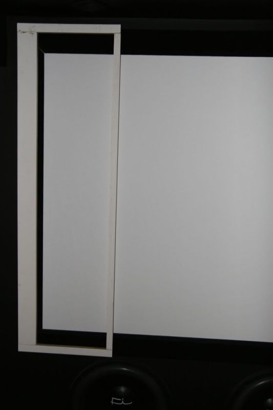

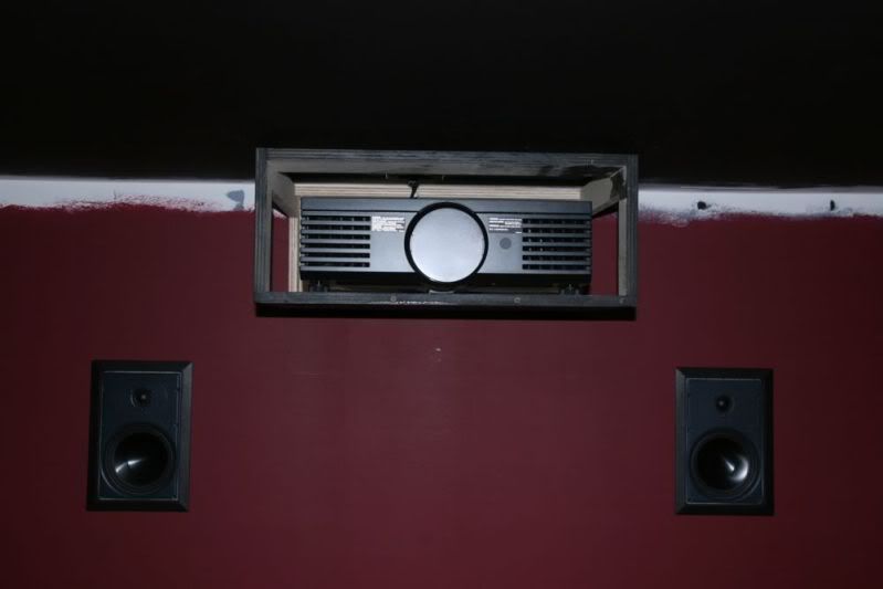

Here are a few shots of my new PJ mount. I decided to seal up the ceiling and make a "box" for my PJ, mounted it to the wall so it's more isolated/dampened than when it was attached right to the ceiling joists. The sides are all open for ventilation, but I will be covering the front and sides with fabric covered removable panels (similar to the wall panels)

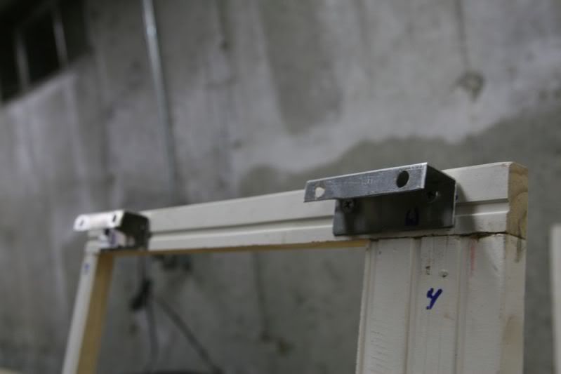

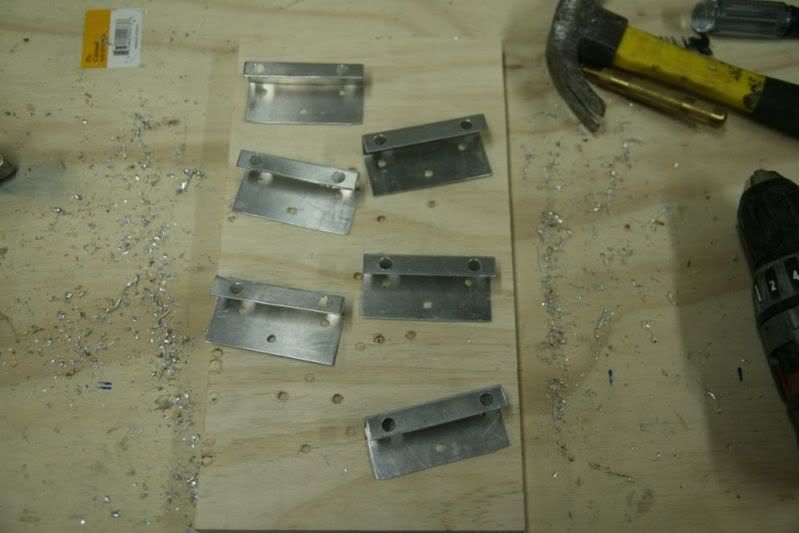

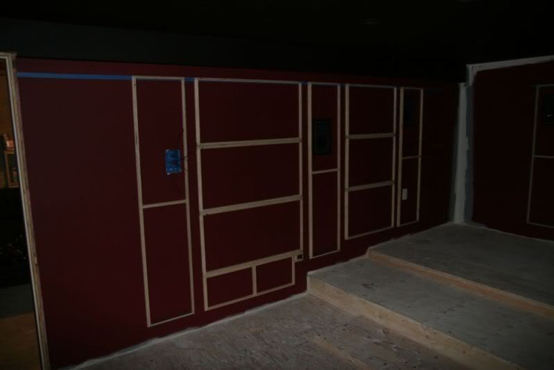

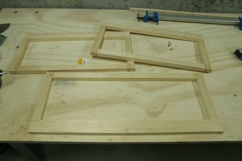

And not much here but these are custom brackets I fabricated to hang my masking panels. The panels needed a bit of attention to detail for correct mounting but they turned out well

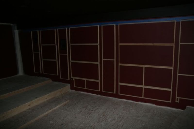

Now because I'm doing an AT screen, I can't just throw up fabric covered styrofoam like others could, so, I made an open frame the proper width and will cover with GOM. I kind of made these blind because I couldn't find much for making panels for an AT screen, don't know why (shrugs).

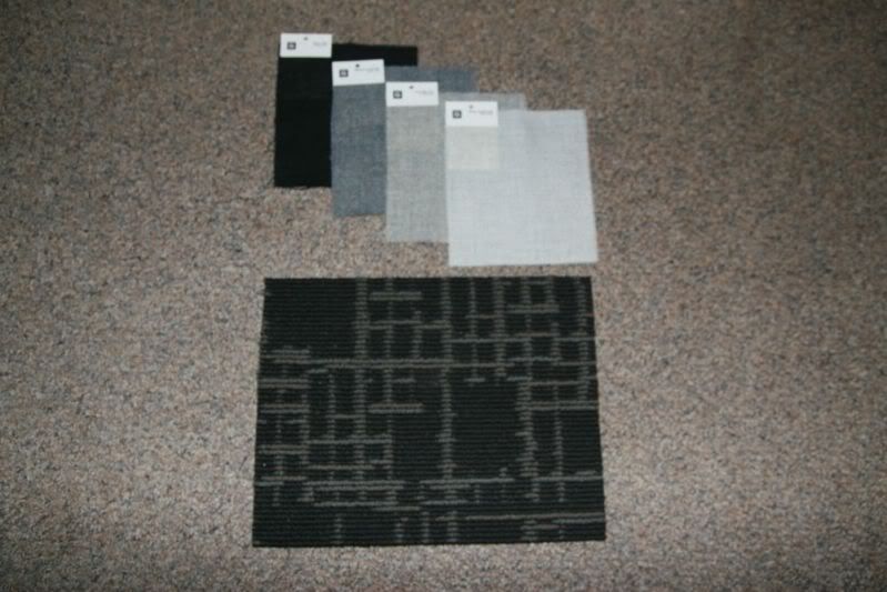

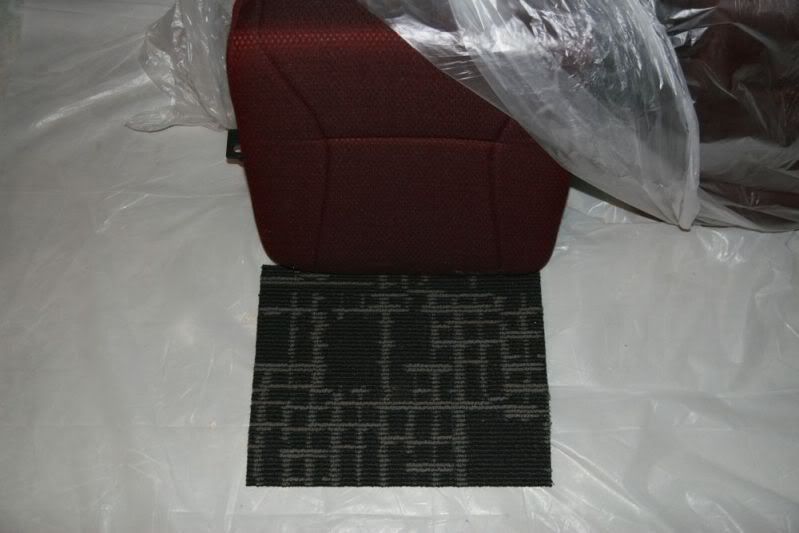

Here are my fabric and carpet choices...
Here is a shot of the carpet sample next to the seat cushion...
And finally a shot of the wall panels temporarily hung. I will be attaching them using grill guides from parts-express. They are tiny but they work well

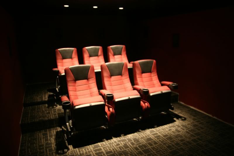

And then finally, my seats, anxiously waiting to be installed in the room.. C'mon carpet!!!

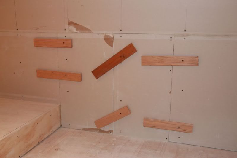

I can take a few pics of the rear and post them. I haven't done any extra bracing except for the 2x4 I mounted for the LCR cabs. I also haven't cranked the subs, at all, so I haven't noticed anything, yet :-/

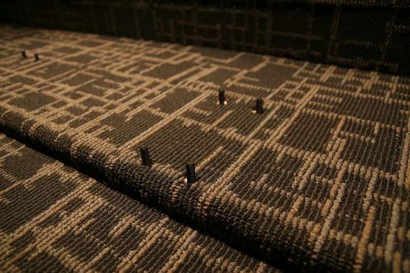

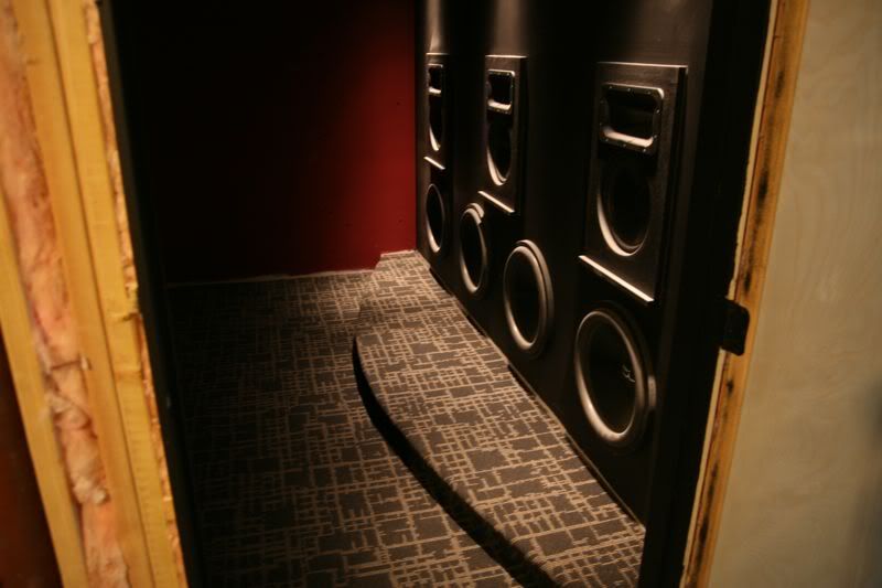

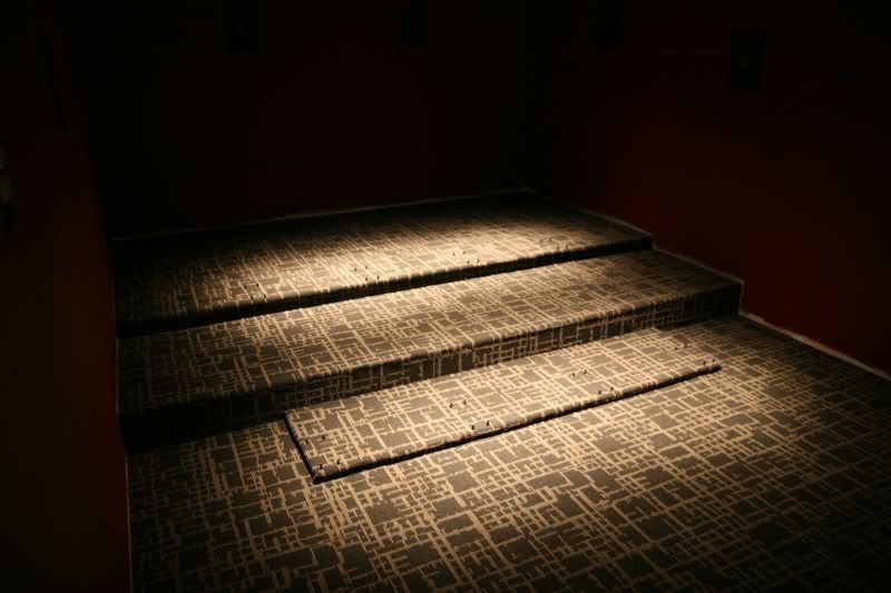

A Milestone has been achieved!!! Carpet and seats are in!! Check it!

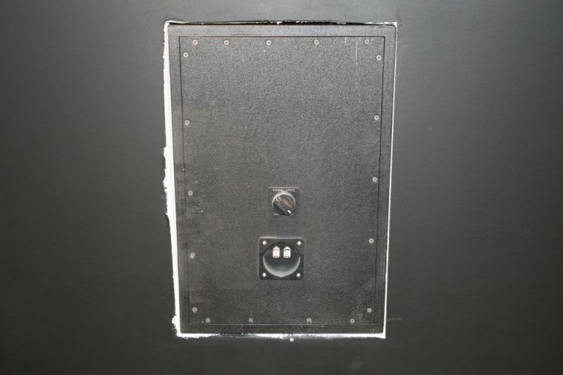

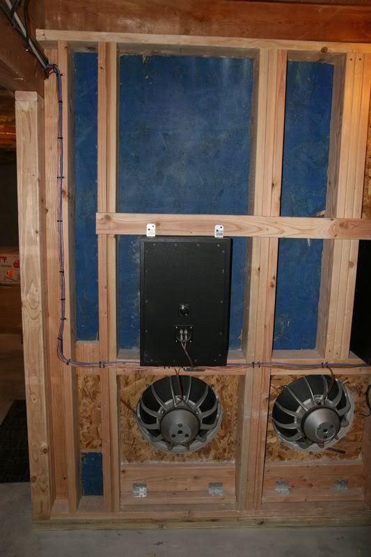

And here is a shot of the back of the wall, to show the "bracing" for the LCR's and sub's...
Now, I'm sure I'm getting ahead of myself, but the bass is just plain non-existent at the seats right now
It's like, the front 3 ft and rear 3 ft of the room house all the bass and everywhere else (both rows of seats) have nothing... Hopefully the bass traps will help out with that, or that I'm NOT in a null and just the front/rear walls are getting huge peaks! Almost time to run some sweeps and see exactly what is happening!

Posts: 651
Not too big of an update yet but here are a few new toys that arrived yesterday
The remote is the URC R50, pretty cool remote so far and pretty easy to setup. Just having trouble finding the perfect codes for my Marantz SR5005 AVR, the SR5003 that I have upstairs works perfect so far but the code isn't the same for the 5005 Might have to custom program it for that one.
The ECM8000 is going to be used instead of the R-Shack meter I currently have for measurements, I was going to grab the Dayton mic but that's still on backorder. I'm also going to use the generic cal file for the 8000 for now and maybe get it calibrated by Cross-Spectrum, they are actually pretty local so it should be an easy thing if that's something I decide to do
Stay tuned for a few graphs, I might take some later tonight, I'll post them here and in the other thread I started. I'm also going to throw them up on the REW thread as well.
The downside to the update is that ALL of the panels I made are for 1" insulation, but of course, now that I'm asking around more, it looks like 2" would be MUCH better for reflection treatment and that's not going to be an easy task to modify my panels for thicker FG
SO upset I didn't make them deeper... we will have to see what my ears hear and how they like the sound I guess, and if so, I will find a way to change the panel dimensions..

Man. That front looks sick too bad the screen covers it. Great job on the room.
qx56 is offline

Thanks a lot! The front does look nice, I agree

Tonight I started trimming the 3" rigied fg panels I bought, into cleaner shapes. In case you didn't see my other post, I found some remnant rigid fiberglass panels at a fairly local company and picked through their piles for the best ones I could find. Some of them still had wet spots from sitting in the rain, but I got the driest ones I could find. So, now they need to be trimmed from the bad spots and uneven ends.
I have gone through half of them tonight and maybe I'll tackle the rest tomorrow or monday, and then start figuiring out how to incorporate them with my current wall panels, aye yi yi..
I posted this in it's own thread but hopefully this fiberglass isn't too dense.. I've never dealt with rigid fg before so I'm not good with guessing pcf numbers but this stuff has got to be at least 6pcf... if it's greater than 6pcf, am I in trouble or would that be ok?
