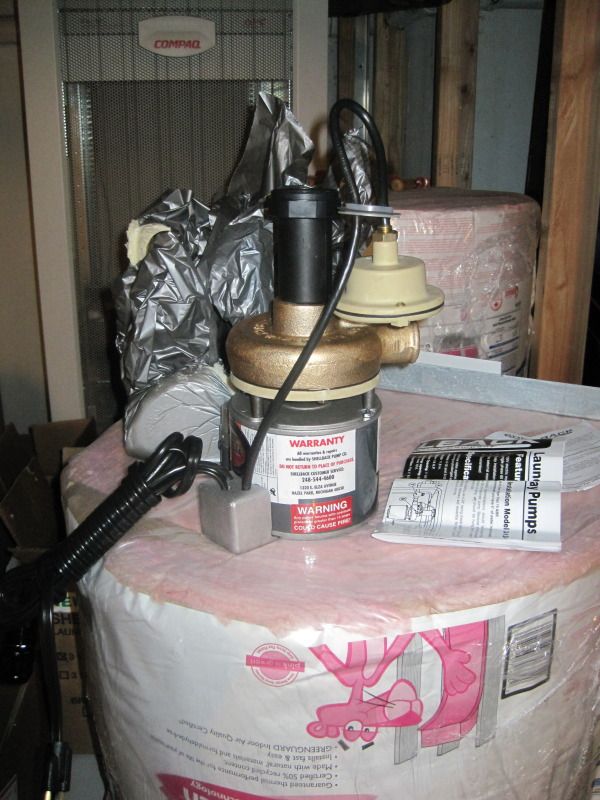

My house is on a well and septic system, so I don't have a regular sewer line. To eject the waste from the basement, there is a pit for an ejection pump in the corner of the bathroom. This will take the waste and pump it into the main waste line so it can drain into the septic tank. Because the bar is on the opposite side of the basement, I didn't want to tear up the concrete to run a waste line to the pit. The main waste line actually exits the house in the same corner as the bar, so I decide to use an under sink ejection pump to push the waste water from the bar sink up into the line. I have seen several models, but many of them received poor reviews due to quality issues. Many of them failed after only a couple of years. The better ones seem really nice, but they require that they be vented through the roof. That isn't really an option for me.
A friend told me about a local pump manufacturer that he got a solid brass sump pump from and it has lasted years with no problems. I called them and it ends up that they make a laundry lift pump that is designed to go directly under a laundry tub that will do the trick. It is very compact and doesn't require a vent. It is designed to hang right under the sink without a trap. Once the pipe on top fills, it automatically pumps out the waste water. It also comes prewired with a switch to manually activate the pump just in case.
I plan to mount this under my bar sink and also have my drip trays drain into the pipe under the sink so I can rinse them out as well. Because the keg fridge only puts out water, I will just drain it into my sump pump which is in the closet in the same corner.

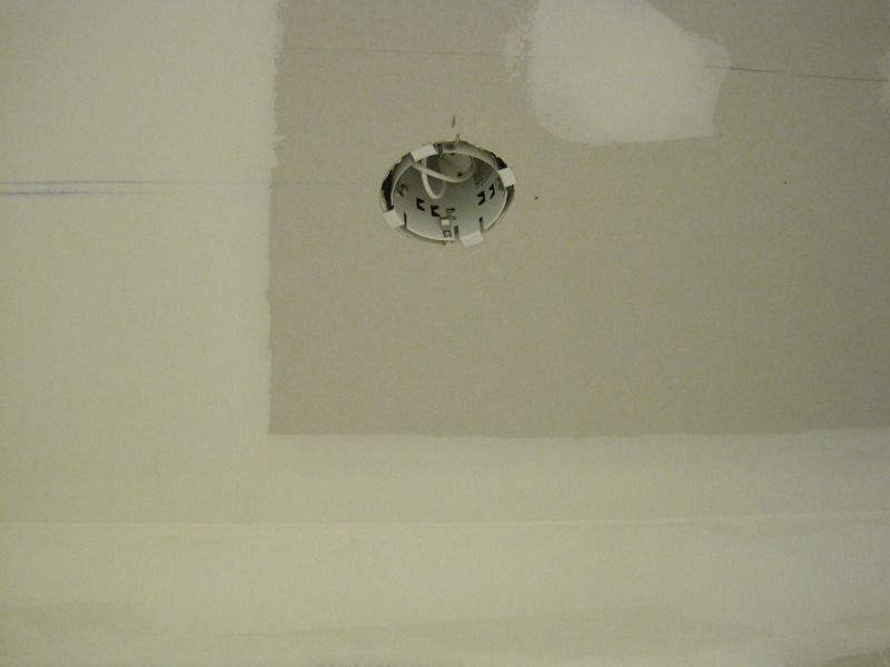

I also finalized the spacing on the 3" lights I plan to put in one of the soffits. Now I can run the wires to where these lights will be installed. I added a couple of items to my pre-drywall punch list, but fortunately the list is shrinking faster than it is growing.

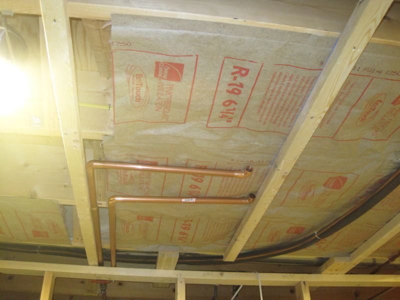

Lots of progress this weekend. I finally am starting to feel like Drywall is very close. Depending on how much I can get done during the evening this week, I will probably need one more full day next weekend to wrap up. With that said, I think I am close enough to have my friend order the drywall.
Here is a list of what I accomplished this weekend:
  • Ran the wiring for the soffit lights.
  • Ran a 20amp circuit to the bathroom.
  • Ran a 15 amp circuit to the bathroom to power the sewage ejection pump.
  • Put the last couple of pieces of insulation on the outside of the theater wall.
  • Raised a 1" copper pipe that runs the length of the game room so that it was up against the joists. It was installed using some wire pipe hangers, but it was hanging too low and would have interfered with the drywall on the ceiling.
  • Ran the thermostat wire for the main part of the basement.
  • Extended the wiring for an outdoor temperature sensor across the basement to my data closet.
  • Installed a bunch more metal protector plates on the studs where wiring passes through.
  • Ran the circuit for the back bar and side wall in the bar area (see picture below).
The two lower boxes will be inside a cabinet. I am thinking the left one will be used for audio/video equipment such as a satellite tuner. The right one may be used for something like a microwave that will be installed on a shelf below the counter. Then I installed two boxes for outlets above the counter. Lastly, the two wires in the center of the wall that don't connect will be for a recessed box that has a recessed outlet and a hole for cables. I will then mount a tv in front of this box.
On the side wall I installed a couple of outlets down low as well as two outlets higher up on the wall for neon signs.
I am very close now. I still need to insulate the bar wall behind the back bar, run a circuit for the bar itself and the keg cooler, finish up the plumbing, install the drain pipes for the bar sink, tape the seams on a few more ducts and wrap up some small miscellaneous items. If I can put in some time after work this week, I should be able to wrap everything up and clean the basement by next weekend.

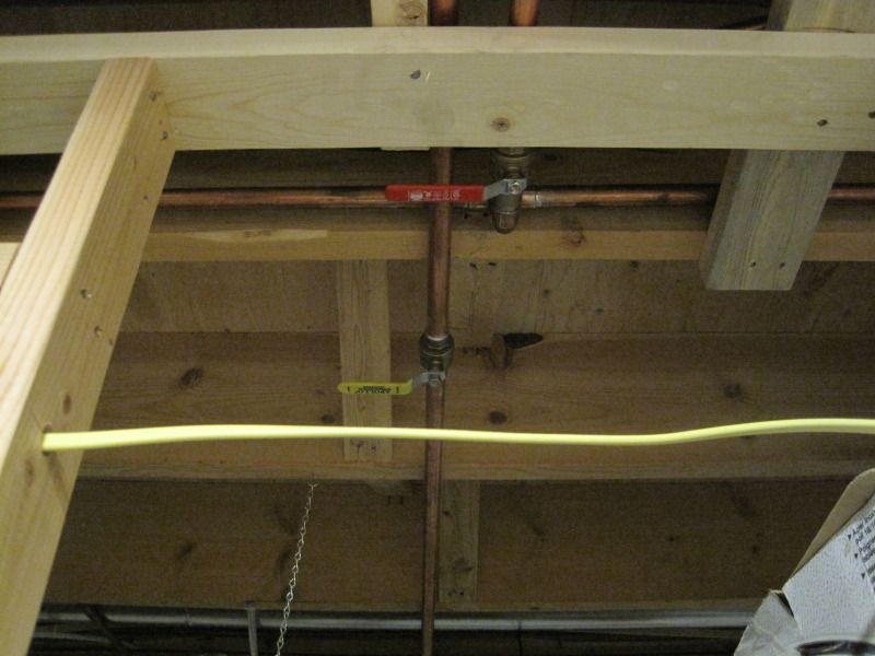

I guess I underestimated how much work I have left on the plumbing. I spent 3 hours last night and another hour tonight, and I am still not quite done. I have the plumbing run into the bathroom. I dropped the pipes down into the wall where the sink will be and ran the pipes that will eventually feed the shower and toilet into the ceiling. I still need to solder on a couple of elbows in the wall and put a wooden plate in to support the pipes where they will go through the wall under the vanity. Then I need to cap it all off.
In the bar area I soldered up the last of the pipe in the ceiling, ran the pipes across the room inside the soffit and soldered on the elbows to drop the pipes down into the wall. I still need to cut a couple more pieces for the bar sink and cap them off and I will be done with the water supply lines.
I am not finishing the bathroom quite yet, so I won't be messing with the drain pipe for now. In the bar area, I need to cut some PVC pipe to connect the ejection pump to the drain pipe which is 5 feet up the wall. I want to get the pump tested before drywalling to ensure that it works properly.

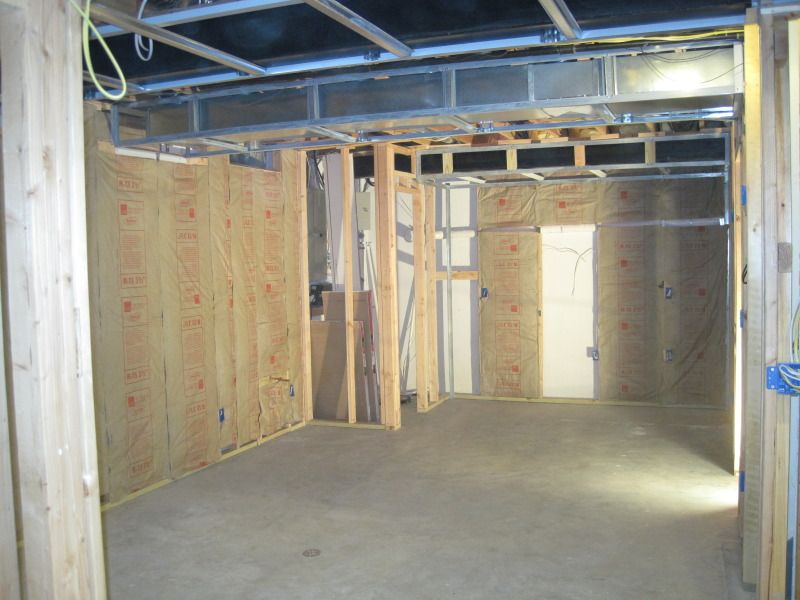

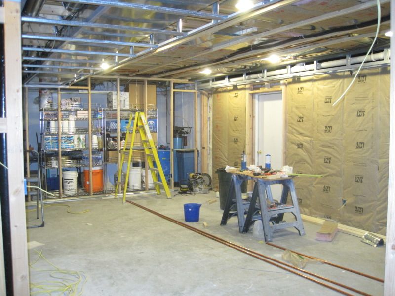

Everything is all complete and ready for drywall. That's a good thing since they are going to be installing it tomorrow. I took a few final shots of the room pre-drywall.
Main game room:
Bar area:

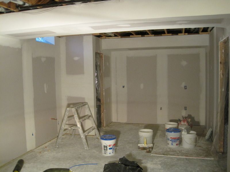

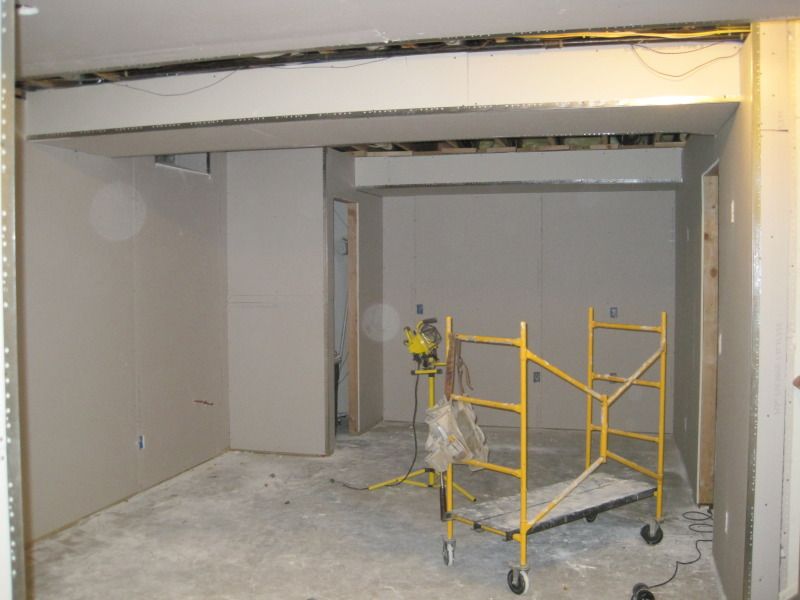

Drywall day one is complete. All of the drywall was hung with the exception of the theater wall. the plan is to hang the DD on the outside of the theater first thing tomorrow morning before the mudding is done. The mudding should be complete tomorrow.
Bar area:
Game area:

The drywalling is just about complete. On Friday morning he hung double 5/8" drywall with GG between the two layers. I debated on only doing one layer of 5/8", but I had a few sheets left from the theater and he had several sheets of 5/8" that had been sitting in his barn for a while, so he said he would do it for the same price as he originally quoted. It might be overkill, but why not. All that remains is for the person who did the mudding (same guy who did my theater) to come back for a couple of hours tomorrow to do the finish sanding and do any touch-ups that are necessary.
Here is a shot of the gameroom and the theater wall. I hung plastic over all of the doorways to keep the dust down in the other rooms while he is sanding. Also, it was very humid this weekend, so I ran a dehumidifier and a couple of fans all weekend to make sure the mud dried.
Here is the bar area:
I also installed 5 3" can lights in one of the soffits. I figured if I screwed up, he could fix it while he was here. Fortunately, everything went as planned . I am going to wire them to a dimmer and position them over my games so that I can light them when people aren't playing, but then dim them or turn them off when people are playing.
Once he sands tomorrow, I can begin the cleanup effort (my wife can't wait since there is drywall dust all over the floor at the top of the basement stairs). I also picked up some primer and some white ceiling paint.
I am also going to go ahead and hang the doors so that is out of the way. I would like to be able to close off the other areas so that I don't have to worry about anything while people are down in the basement playing pinball.
