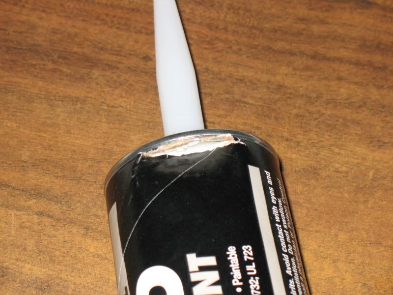

The case of acoustic caulk came in to the local hardware store yesterday and I picked it up last night with no problems. The free "deliver to store" option was a huge money saver. Unfortunately, 4 of the 12 tubes had some damage at the top of the tube. I am guessing that there is no liner within the tube, so the caulk will dry out. I guess I will need to return the 4 tubes to the store and then order 4 new tubes from the site (the acoustic caulk is not carried in the store).
A bit of a pain to have to run back and forth a couple of extra times, but the price was much better than paying for shipping. The store is only 5 minutes away, so not a huge deal.

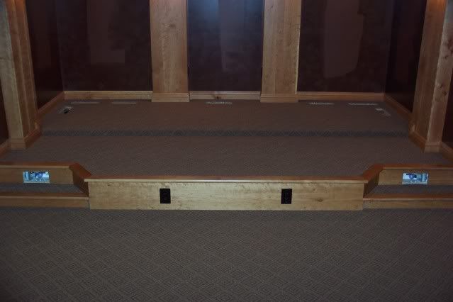

You could build your riser with the portion that people walk on (not sit on) some number of inches (2-4 roughly) lower than where they will sit. You would build a "mini-riser" on top of the main riser where your seating is, to bring that area up to where it needs to be to see over the front row.
Here's a pic of mine for a visual. The mini riser is about 2"/

Thanks fotto,
How high is your riser at the various points (steps, lower part and overall)?

Originally Posted by NGiovas View Post
Thanks fotto,
I built main riser (including underneath mini riser) with 2x10 and one sheet 3/4 ply which equals 9 1/2" + 3/4" or 10 1/2". Riser was made with 2x4 (on their sides) and one sheet 3/4 ply or 1 1/2 + 3/4 or 2 1/4. Overall then with mini riser equals 12 3/4". The steps are 2x4 on edge with either 1/2 or 3/4 ply (don't remember) on top.
On the walking part, I have around 6' 8" to the ceiling. You can always shorten the main riser height and lengthen the mini riser height if that works out better for you. I wouldn't go more than 3-4 inches for on the mini riser for people's comfort and ease of sitting in the chair unless you extend the mini-riser out in front of the chairs to create a step (such as what Cathan did).

post #60 of 1241 Old 01-24-2011, 11:50 AM
GoCaboNow's Avatar
Posts: 4,883
Quoted: 864 Post(s)
Liked: 758
I did a 4" mini riser and no issues accessing the chairs. Nice way to keep your standing clearance as high as possible and get your 2nd row up.
Very nice space you have to work with so take your time and look at it from all angles.
BTW, I am in the Northwest and Micro brews and Home brewing is big here. A buddy of mine does a Marzenfest every spring with a bunch of home brews - including the Marzen beer. Yummy!
