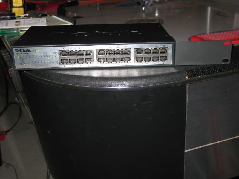

I received my gigabit switch yesterday. It seems to work fine, but I was surprised at how much noise the internal fan makes. It doesn't sound like a bearing noise - just the noise of a very small fan moving a lot of air. I am going to try to look into this to see if this is normal for this model. I also purchased some F connectors and RJ45 connectors so that I can finish cleaning up my wiring.

I've been using a D-Link DGS-1024D switch for a while now. I've been really happy with it. It runs pretty cool and uses a little bit less power than most.
BllDo, Does the fan on your switch run all the time? Does it make much noise? Mine seems really loud. I'm not sure if it is normal or not. Also, the fan is always running on mine. I wasn't sure if that is normal. I have a rack mount switch that has an internal fan, but it isn't nearly as loud and doesn't run all the time.

I'll have to double check mine when I get home today, but I don't think mine has fan. I certainly don't remember loud or offensive noise from it. Wonder if you got an older model?
Regardless, fans are cheap and may be able to just replace it.
It looks like the newer version of this model (same model number) doesn't have a fan. The older version does. They have the exact same features and specs with the exception that they eliminated the fan. I need to figure out if I can get a quieter fan for it. If not, I may have to spend the money to get the newer one. It is going in a closet that is not in the theater, so it may not be an issue.

Probably a replacement would take care of it... pop it open, find fan specs, few minutes on electronics suppliers sites...
I had a loud fan in a big UPS a while back, so I replaced it with a fan of the same voltage (clearly not the same overall specs) that was LOUD and almost never turned off. Eventually I decided I had to do something about it so I pulled out the original fan, looked up the specs, and found a fan with very similar specs - I think on Newark. I put that fan in, the UPS charged for one minute (with the fan much quieter even when running), and the fan shut off. Now the fan is hardly ever on anyway! Major win, it's the UPS for my theatre closet and having that thing quiet is a huge deal.
You could, of course, also open it up, hold the fan stationary and blow the whole thing out with compressed air. My brother and I have a penchant for doing that to our computers periodically, especially when they were in a dustier environment. And heck, when it came time to clean my refrigerator coils last time, I used the brush a bit but quickly dragged the air line in - which worked marvelously.

Thanks for the tip on the fan aackthpt. I hadn't really thought about finding a replacement, but that would probably do the trick. Unfortunately, it may not matter at this point. When I was testing out the switch tonight I discovered that they sent me the wrong model. I hadn't noticed it at first, but after taking a closer look, I realized that they didn't send what was pictured in the auction. I sent them a note, but I haven't heard back yet. Their auction says they have a 30 day return policy. I have a feeling I will end up eating the shipping cost in both directions. Hopefully they will take care of it since it was their error.
I view it as a small delay in finishing the wiring. I have the older switch still in place, so I will focus on something else until I can work this out. I think I will go downstairs and tear out the framing from the old wiring closet I originally had in my plan. That will be a good way to blow off some steam

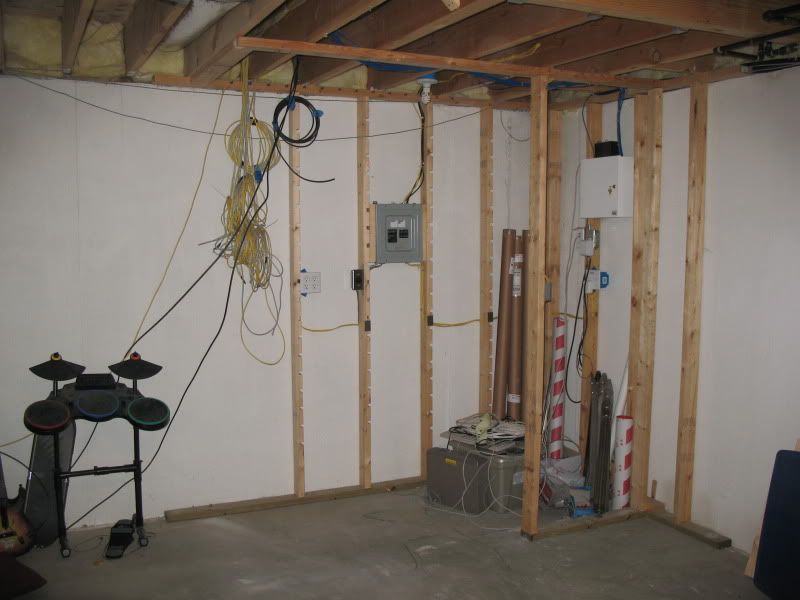

Well, as promised, I started tearing out the original wiring "closet" (it was never really finished). I installed the closet a few years ago as a way to contain wires for my whole house audio and home automation. In addition, I mounted some outlets and a sub panel in there. I couldn't completely remove it because I still have to remove the electrical "stuff" and the automation panel. Even though the closet wasn't very wide, it makes the room feel much wider without it there. I should be able to pull all of the electrical this weekend. I also hope to get the automation panel moved as well.

Well, it looks like everything will work out fine with the switch. The seller offered me a full refund including shipping and will send me a prepaid return label. They used the wrong photo when posting the ad, so they don't have the switch I wanted any longer.
I'm going to look around a bit more, but if I don't find anything I will probably just order one from Newegg.

I got my new network switch today. I ended up ordering the newer version of the D-Link DGS-1024D. What a huge difference!! It is completely silent. The fan on the old one was just way too loud. I am going to modify the rack mount tabs so that they turn towards the bottom of the switch. I will use them to mount the switch to the board I installed next to my electric panel.

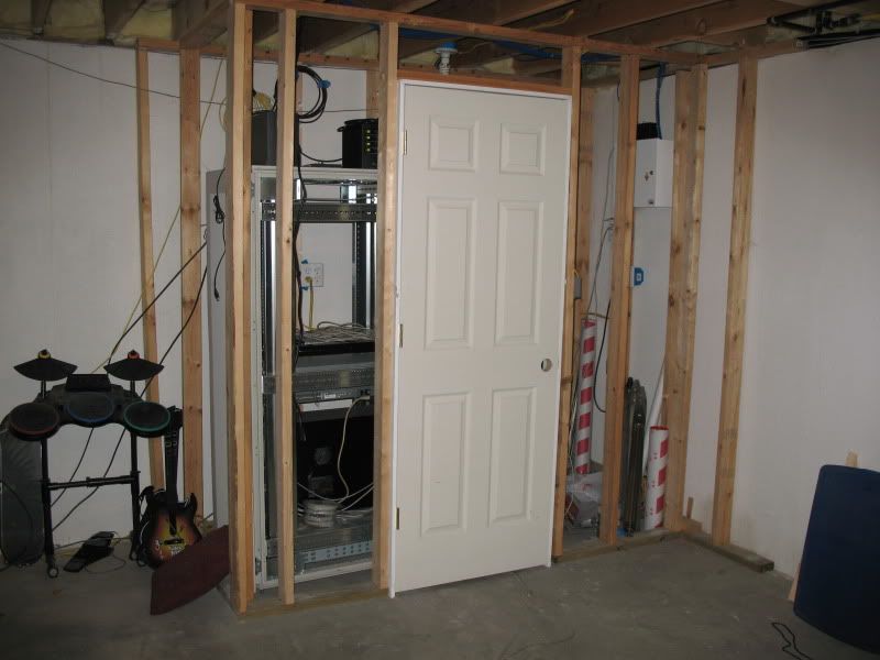

I did have one quick question. How wide does the rough opening need to be for a solid core door?
I framed mine to be 2" wider than the width of the door you will be using. 32" door=34" opening, 24" door=26" opening etc. Now I have yet to hang the doors so I am unsure if that is right or not but its what I read

2" bigger is good as long as your framing is on the money. Jamb material is usually 5/8" or 3/4" depending.. That gives you 1/4" each side to spare.
If you used some nice HD pretzel lumber or forgot your level that day.. You may want to bump it up 1/4" to 1/2".
I use 2" when I framed the openings and I know they are plumb.. very easy to shim
