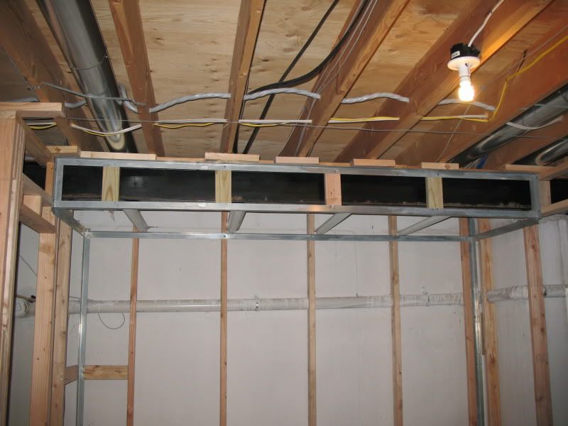

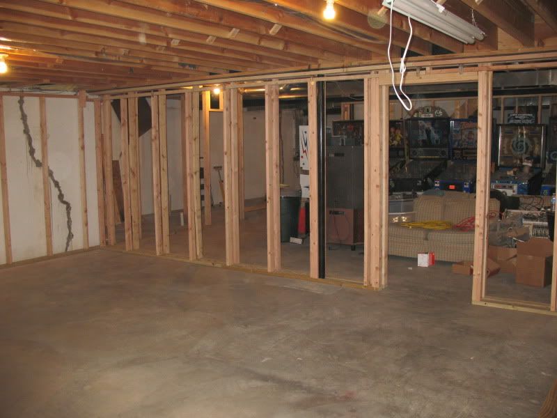

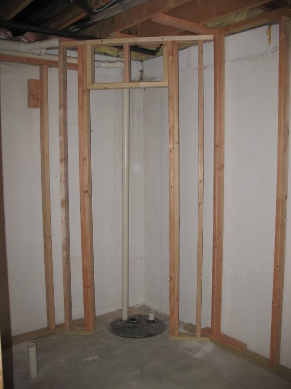

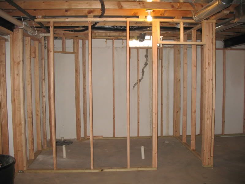

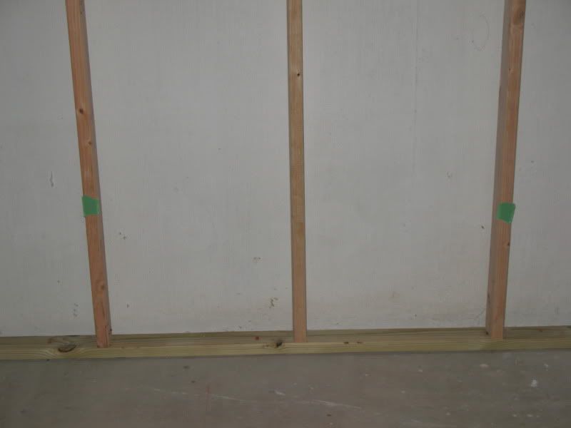

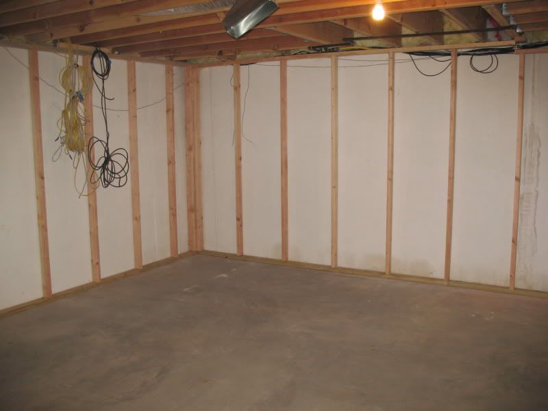

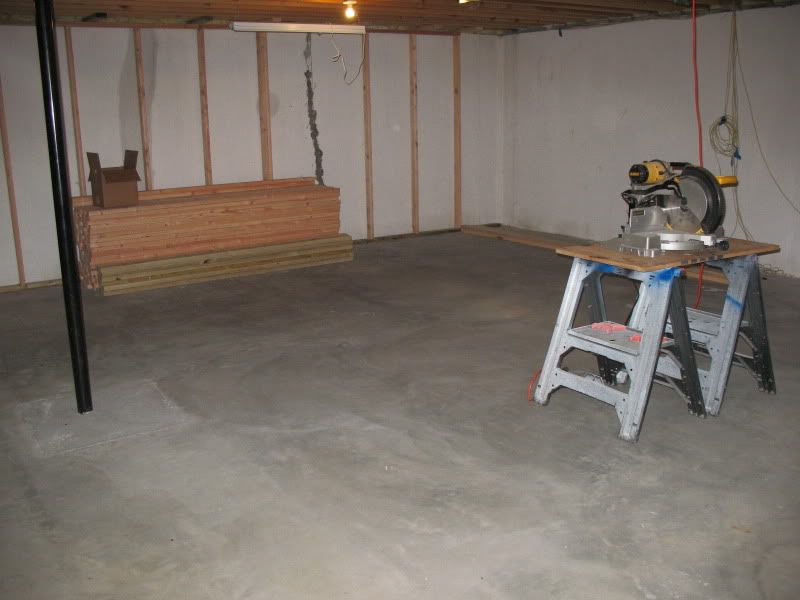

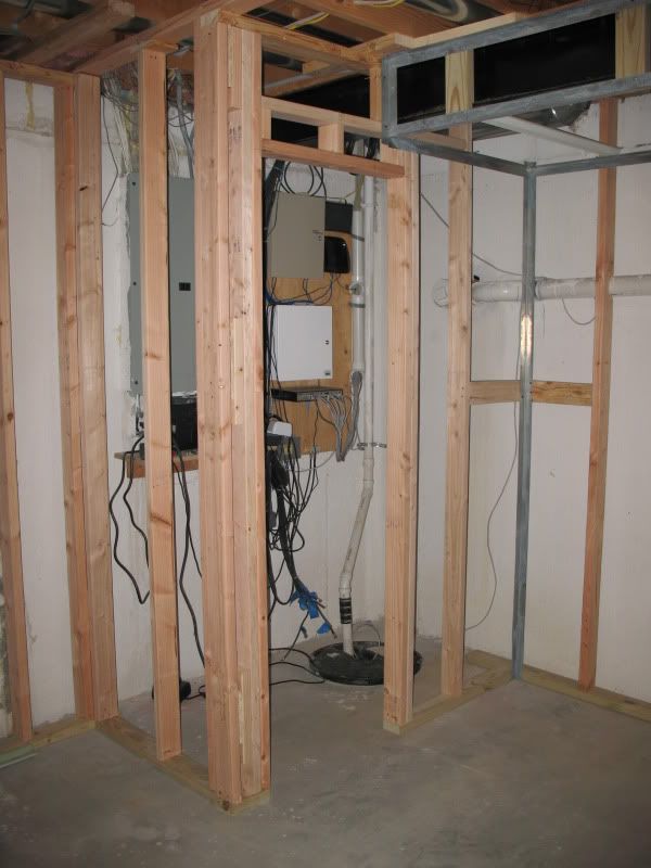

I finally have some real progress to report. I finished framing my theater today. I am glad I finally am moving forward again. The final interior dimensions on the theater (pre-drywall) are 18' 8" wide by 23' 3 1/4" long.
This is the entrance to the theater (from the outside):
Here a are a couple of photos from the interior of the theater. Rear left corner:
Door wall from inside theater:
Here is the screen wall:

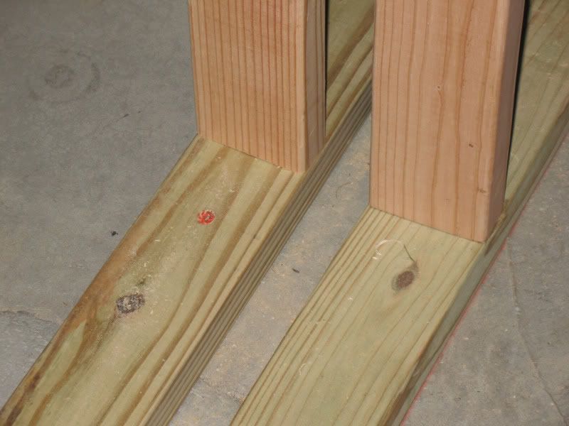

I used IB3 clips (from the Sound Proofing Company) to isolate all of the theater walls. The biggest challenge was isolating the door wall which is under a steel beam. John from the Sound Proofing Company suggested drilling through the beam, but it is very thick, hard steel, so I decided to attach a plate to the bottom of the beam and then mount the clips to this plate:
I also made sure that none of the framing came in contact with the poured concrete foundation walls. For the door wall, which is shared with the rest of the basement, I decided to construct two 2x4 walls with a 2 inch gap between them for better sound isolation:
Since we completed the theater, we also worked towards framing the remainder of the basement. We were able frame the exterior of the bathroom as well as put in the remaining top and bottom plates on the last two walls. I figure we should have the last of the framing completed with about a 1/2 days worth of work.
Once I wrap up the remainder of the framing, I can begin my electrical work. In the mean time, I plan to start some of the electrical layout. Once the electric is designed, I will probably turn most of my focus to getting the theater ready for drywall.
NGiovas is offline

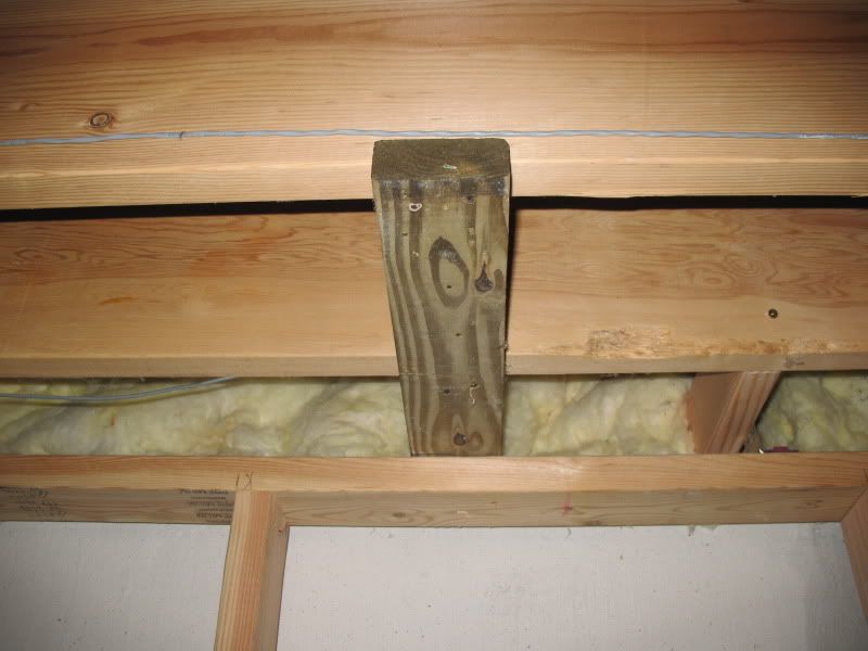

Nice tidy work. Great job. How did you attach the 2x4 nailer to the underside of that beam?
__________________
Ted
The Soundproofing Company
Ted White is offline
My friend has a Ramset that uses a larger bullet. It put a nail into the beam with no problems. I was very surprised considering how hard the steel is on those beams.
NGiovas is offline
post #133 of 1241 Old 03-08-2011, 06:32 AM
Ted White's Avatar
Join Date: May 1999
Location: Michigan, USA
Posts: 7,779
Quoted: 12 Post(s)
Liked: 44
Thanks for that info. If you ever have a chance to get the make and model of that Ramset I'd be interested. This is a common question, and this seems like the best answer. Maybe these can be rented.

Today was a successful build day. I was able to completed framing the last of the walls. I still have a couple of soffit decisions to make in the game area, but I don't need to make those decisions immediately.
I finished the back wall of the bathroom as well as framing out the closet for the ejection pump. The bathroom will likely be the last room completed, but I wanted all of the framing done now. It will probably end up being a tool storage area while the rest of the basement is finished.
I also finished framing up the bar area, the wiring closet and the soffit above the counter area behind the bar.
I previously had started some high level electrical planning. Now that the framing is done, I will need to finalize the electrical decisions. Outlets aren't a big deal because I know the exact requirements for my games as well as general purpose outlets. I do need to do some research regarding the lighting. I want to use a variety of lighting in the basement and dont' want to use strictly cans for the entire area.
Also, I have been planning to put a sub panel in the theater, but once that is installed I will have six slots remaining in the main service panel. These will need to service all lighting and other electrical for the entire basement. Some of the things I need to keep in mind while planning the basement electrical are:
