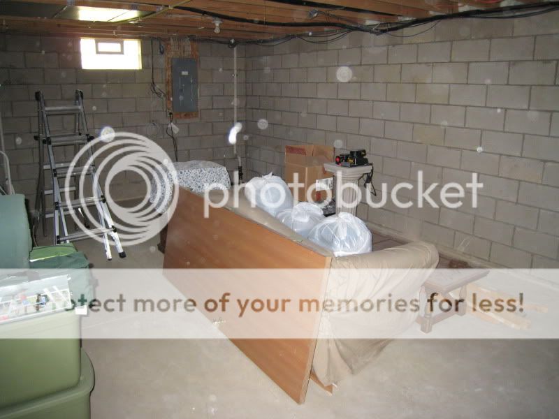

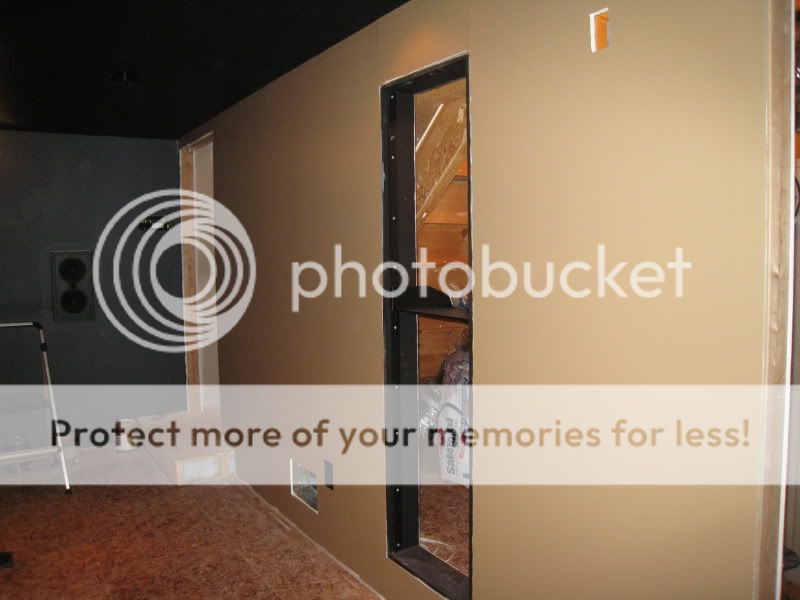

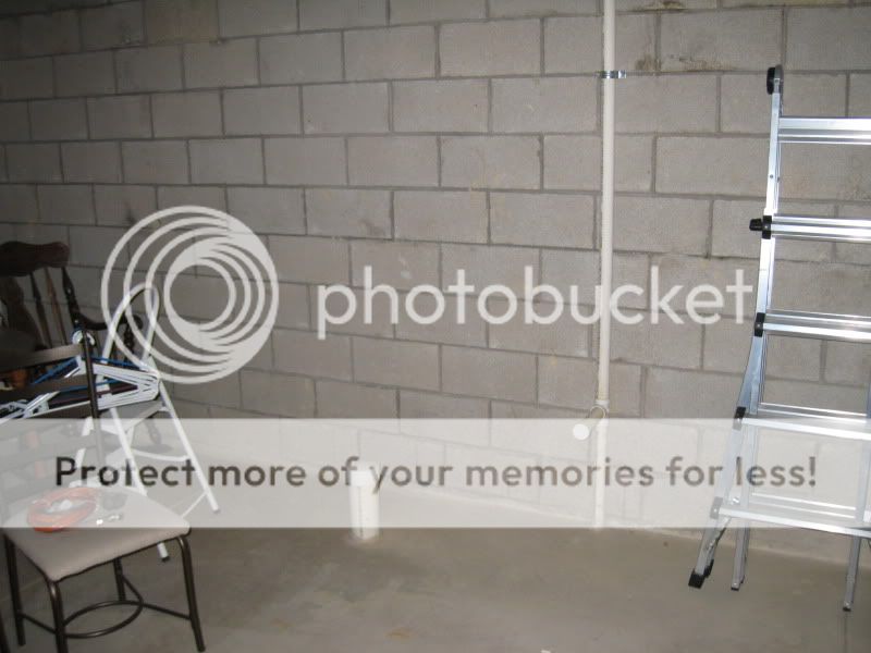

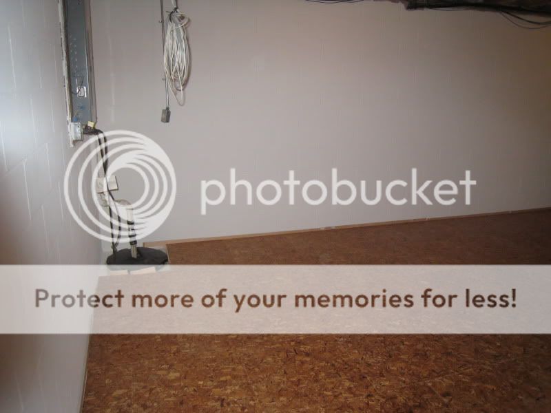

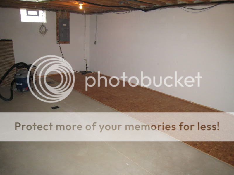

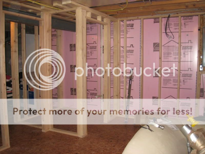

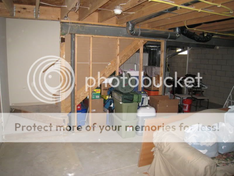

Heading down to the dungeon: This does not bode well for medium to large furnituremore on that later.

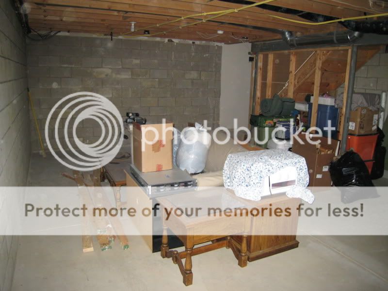

View from the bottom step. The back wall with the window is the rear of the theater. Sump pump is in the far corner.
From the front left corner.
View from sump location:
Existing water and drainage lines for a half bath. Not exactly in the perfect location.
Looking back toward the stairs from the sump. The far wall will be (or more accurately, is) the screen wall.
HDvids4all is offline

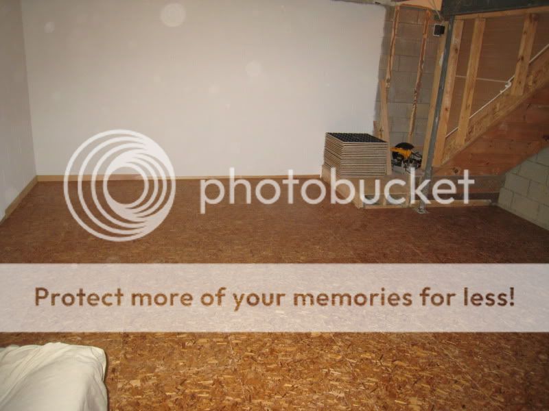

Obligatory 3 row shot of DRIcore installation. Cinder block has also been painted with DryLok, even though there were never any water issues.

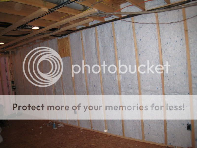

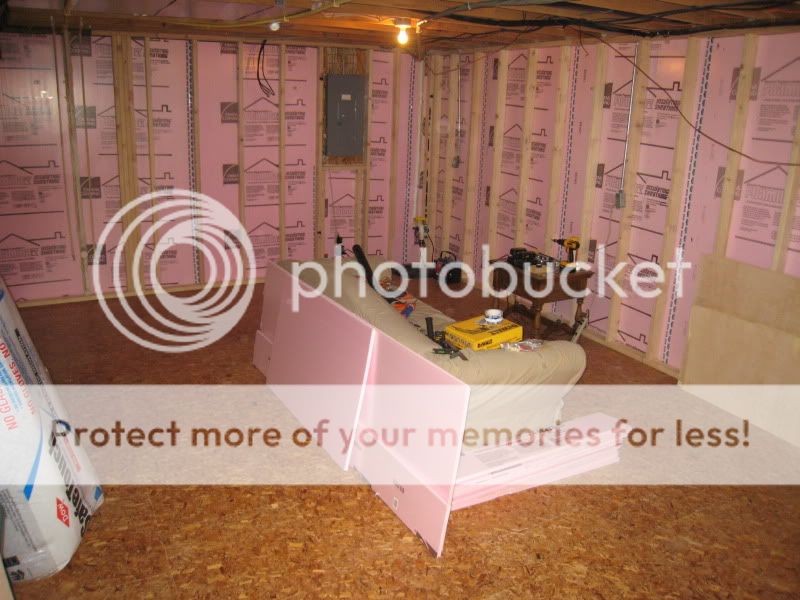

You definitely pay a premium for no itch insulation, but worth every penny IMHO. This is the left side of the room.

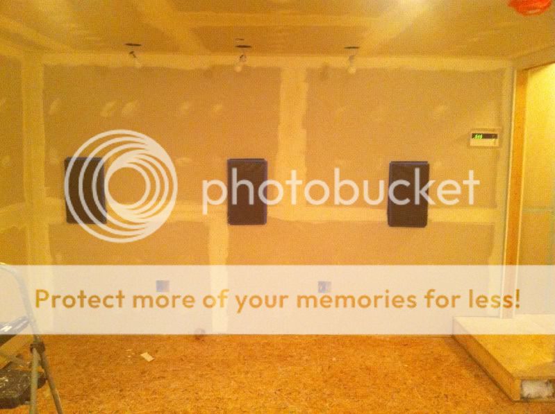

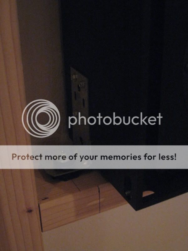

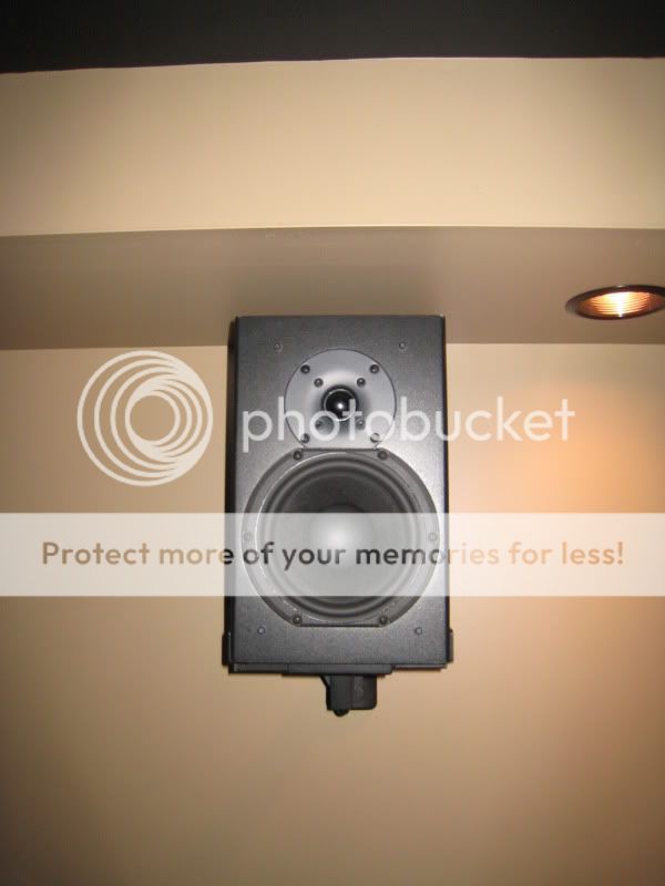

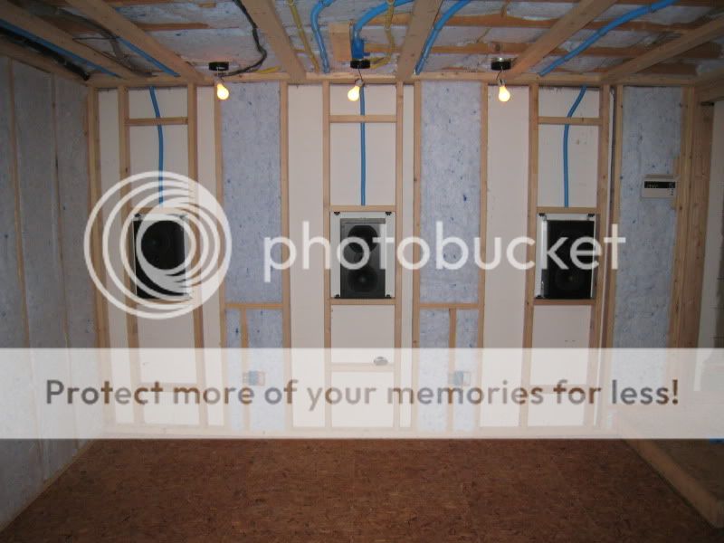

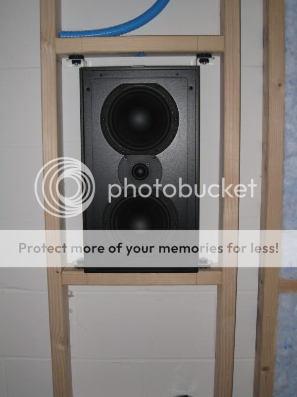

These LCRs are actually intended for 6 framing, even though I'm using 4 studs. The plan is to have 2 of acoustic insulation behind the screen, which will line up perfectly with the speakers once everything is in place. ¾ smurf tube ran to all speaker and sub locations, as well as 1 extra spot in the ceiling for IR distribution. I swear I filled in the rest of those bays with insulation!
LCRs mounted with RSIC DC-04 clips, 1 in each corner. Somewhat of a stressful process, the last thing you want to do is hose 3 brand new speakers by being too aggressive with your mounting hardware.
Close-up of DC04 installation - top
Bottom

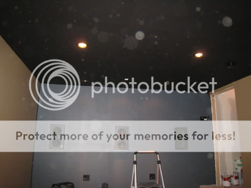

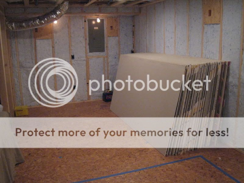

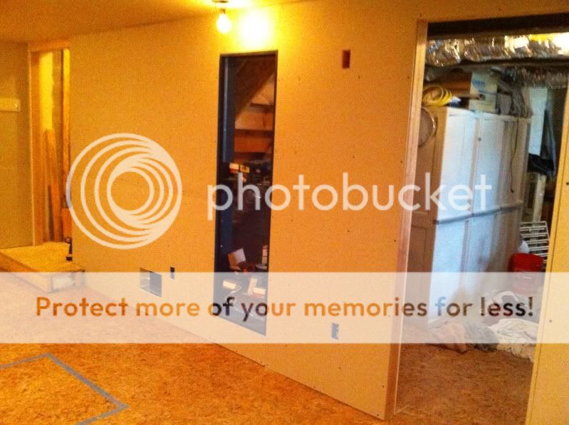

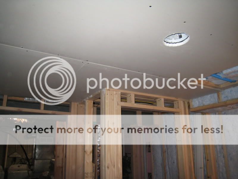

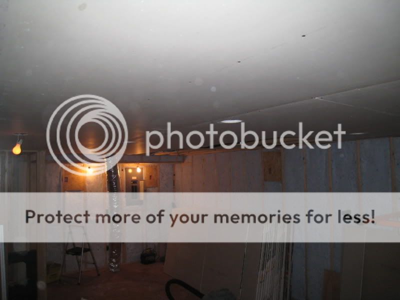

Drywall delivered. Glad I didn't have to carry all that down the stairs...
Ceiling going up

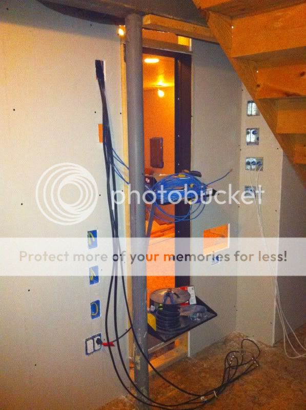

Backside of rack

I like the use of the clips for mounting your in-wall speakers. Since I also have in-walls, I'm curious if this is something you came up with on your own or is it a common practice? I'm more than a little nervous about drilling holes in the sides of the enclosure.
The idea came to me when I was trying to figure out a way to mount the InWalls exactly 2 inches past the outside face of the drywall so I could install acoustic insulation flush with the speakers (like a baffle wall). Searching around showed signs that a few people had done it before, but the best example I found was over in JoelC's 'Pictorial Essay' build thread.

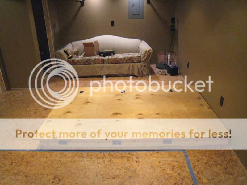

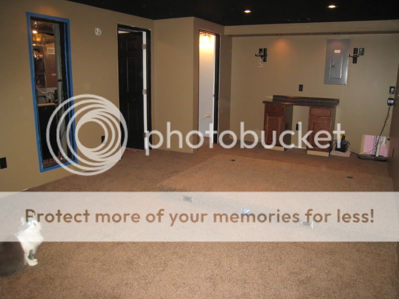

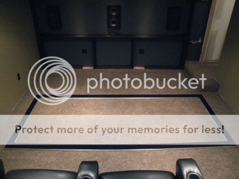

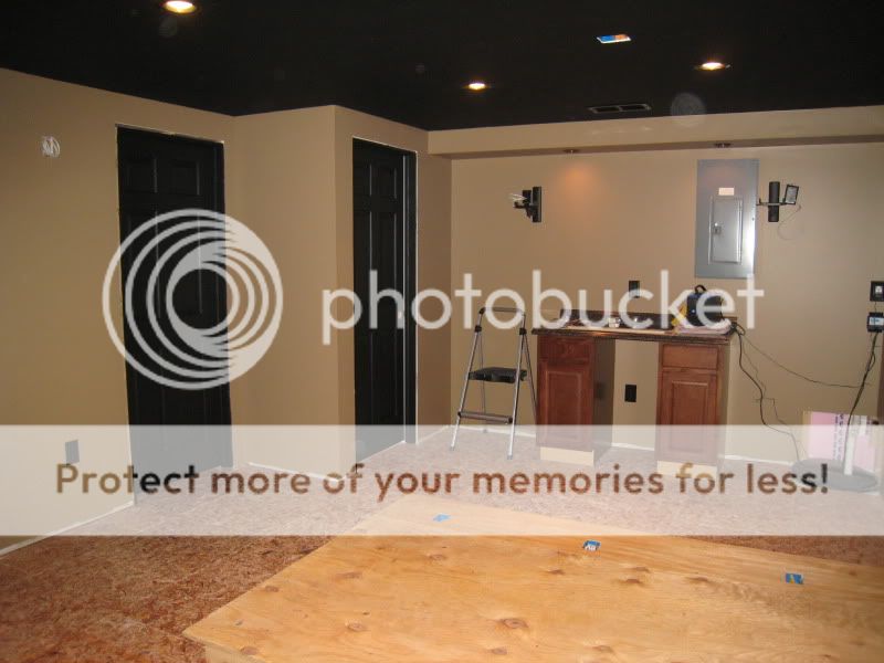

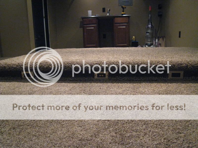

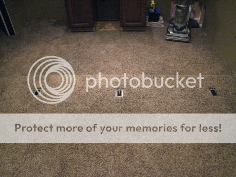

Carpet was installed in early December '10. , I was also ecstatic about finally getting rid of that hideous couch that has been doing double duty as a work table since day one.
Trying to find pictures without animals is much harder than I was expecting it to be.
Front of riser. The 2 outside boxes are power for berklines, and the center is a speaker connection for bass shakers that runs back to the BASH plate amp.
Same thing for the top

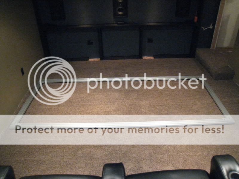

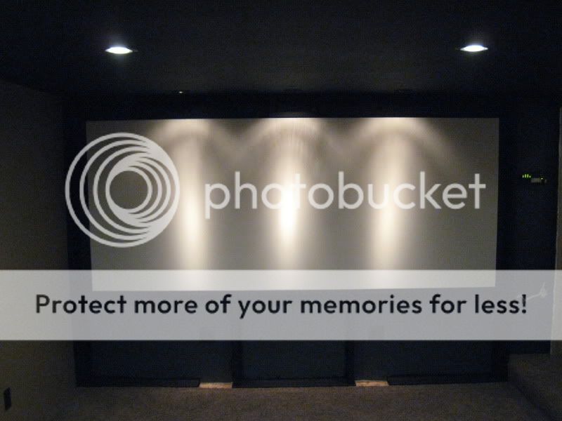

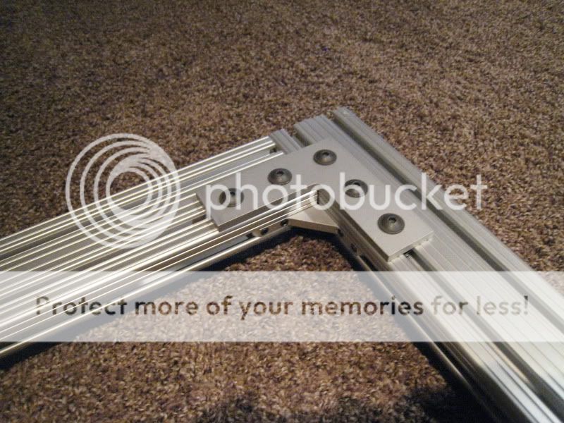

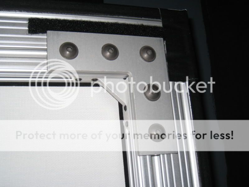

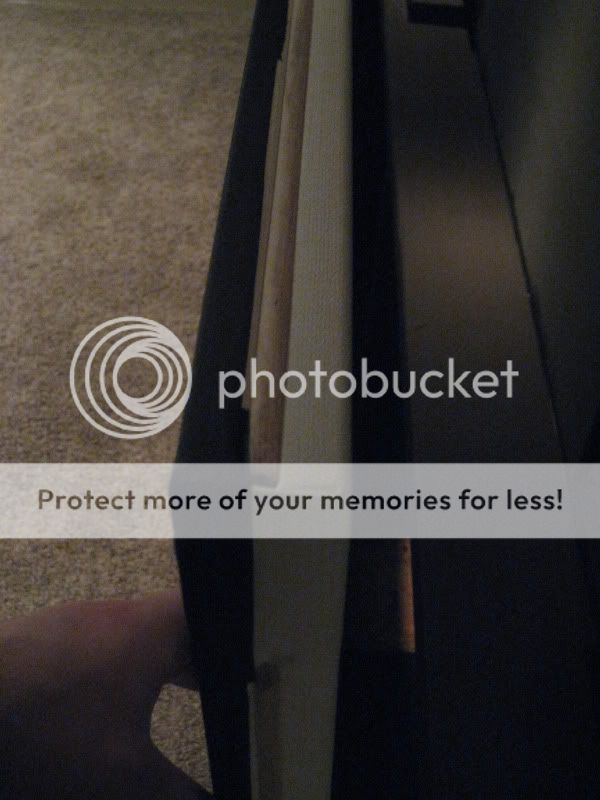

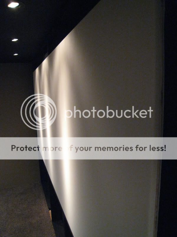

Probably one of the more interesting aspects of my build is the 80/20 aluminum screen frame. There are plenty of documented builds around using this stuff, but it always seemed to me that everyone had to have bracing members down the center of the screen to counteract bowing the structure when the screen material was applied. I'm sure this works just fine and there is no harm in having those extra pieces, but I wanted as large of an unobstructed area behind the screen as possible, so I ordered a slightly thicker dimension framing member than most do.
The frame is 80/20's 15 series t-slot lite, 1.5" x 3" profile with outside dimensions of 120 " x 50"
Here's a close-up of the corner bracing on the back side. I think you could probably get away with just the L brackets, but the small corner stiffeners made me feel a little better, and they're pretty cheep in the grand scheme of things.

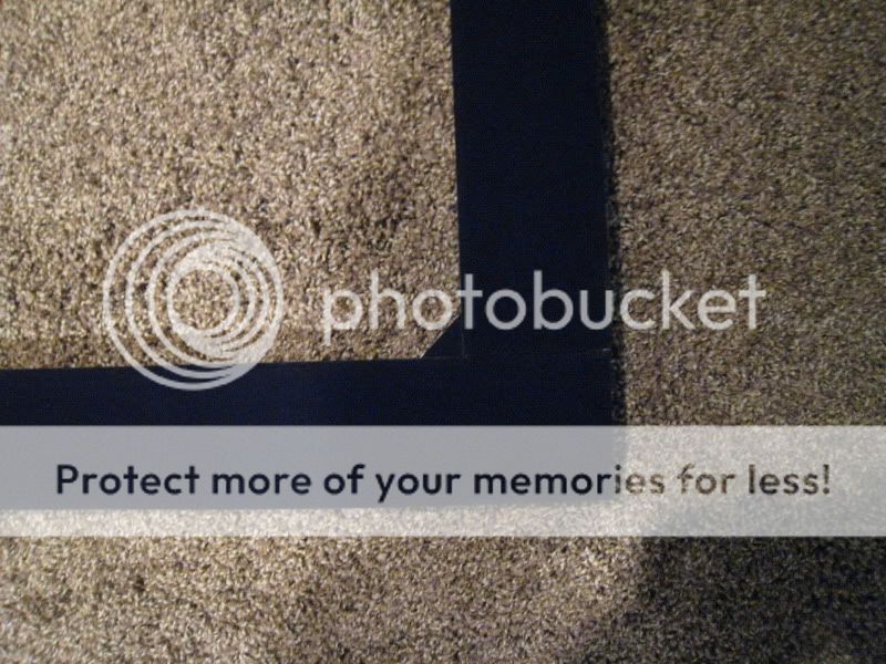

Since I was using the outside dimensions for overall viewing size, I wanted to block reflections from the aluminum on the viewing side of the screen directly under the Seymour AV material. I used a product intended for light absorption in telescopes called Protostar flocked light trap material. It looks like black velvet on sticky-back paper, pretty cool stuff.
The fabric was hammered into the outside channel of the t-slot using wooden dowels and a rubber mallet. I cut the material back about an inch, wrapped around the edge and just taped the excess down with gaffers tape.
The screen sits on top of the framing and and is kept upright by just a few strips of velcro placed on the back.
Screen completed and in-place. It has a floating look right now without any border. I still need to treat the wall behind it and build AT panels to finish off the false wall. I've already purchased a thin black velvet from Jo-Ann's that I will use for the panels, which will also act as the screen border. The screen sits 4" in front of the LCR speaker faces, which was about the minimum I was told to plan for.
I will say this, that is one strong frame! After spending about an hour and a half getting the material in, there is no reason at all to worry about bowing the frame over a 10' width without additional center bracing. The dowels aren't going to budge at all either. Pricing for all the parts for the frame came out to be just over $400 including shipping (which was $50 since it had to go freight due to the 10' pieces). Total screen cost with fabric was about $600. There are ways to get that price down lower for other DIY'ers, but I'm pretty pleased with how the entire thing turned out for the costs involved.

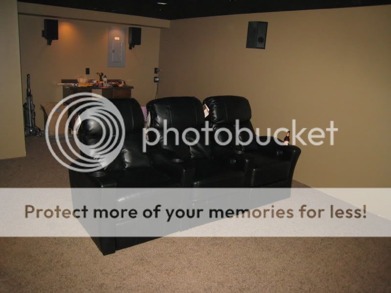

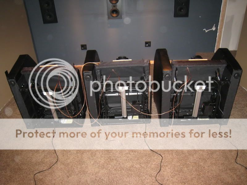

One row of seating is in. These are the Berkline 13175s I bought from Roman over the summer during the power buy at that time. My original plan was to have these as the front row, and a couch in the back row since I don't have enough room on the riser for full reclining HT seats (and the GAF wanted a regular style couch).
After trying (and failing miserably) to get a small couch down the stairs and around the corner, I ended up ordering another set of 3 Berkline 45013s without any armrests in the center. It'll still look and function like a regular couch (but with cup holders), but each seat will still be able to recline independently. Those are estimated to be delivered in early February.

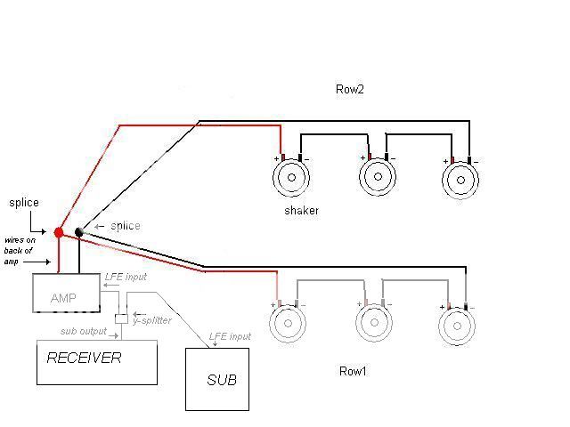

1 Aura bass shaker in each. Followed this guide to installing them in the 13175s. Really no need to rehash since kevinjs123 did such a great job documenting his own installation.
Here's the wiring diagram I used for the shakers. I have the splice in the center box on the top of the riser, which also runs the "extra" pair to the front of the riser as well. The only difference in my wiring is that I run the 2nd leg of the 'sub out' to the Anti-Mode 8033s, which then splits out to each of the Empires in different phase.

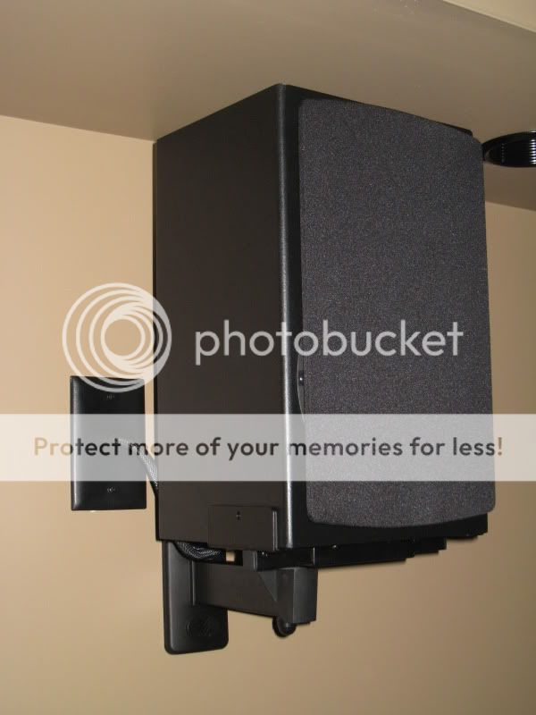

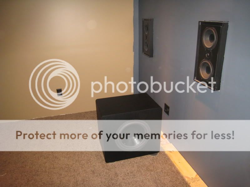

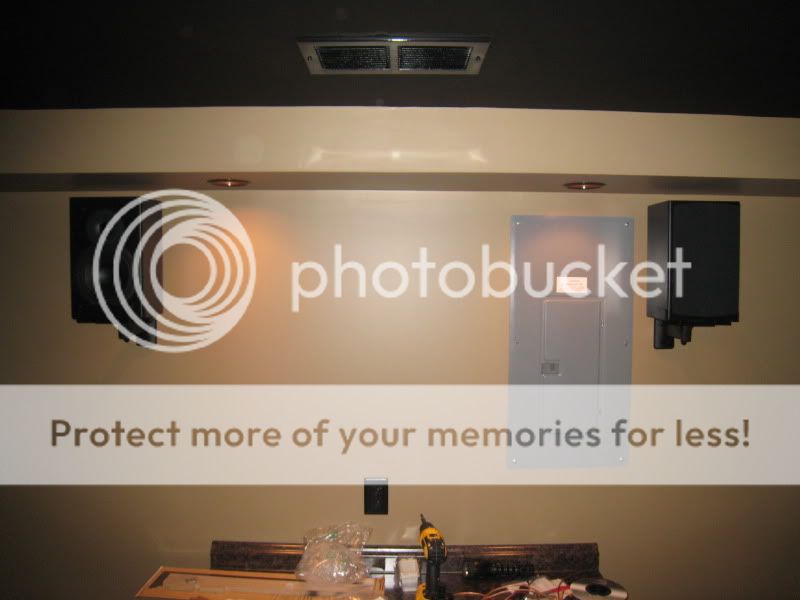

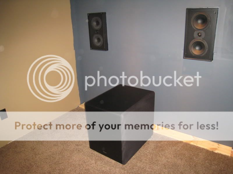

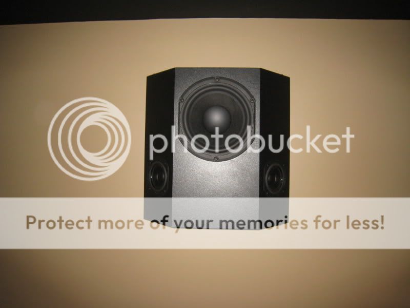

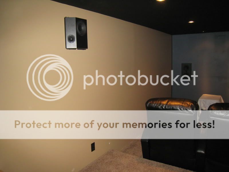

Here's a couple of close-ups of the surround speakers I'm using.
Omni Golds - Rear Surrounds
OnWall Silver Surrounds - Left & Right

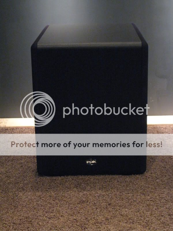

Dual Epik Empires - Placed between the LCRs.

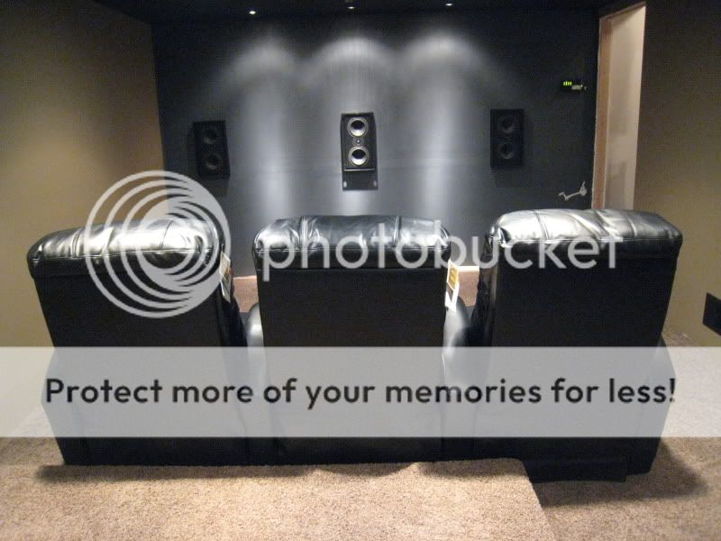

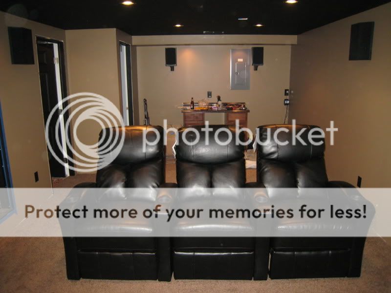

This brings everything up to the current state of the theater. Still have plenty of work ahead of me before I go shouting "Finished!" from the hilltops, but I figure that'll keep me busy while it's still cold outside for the next few months.
View From Screen
Screen Wall - You can just see the 4 zone Graphic Eye on the right-hand side. No faceplate on it right now, so the lights are a bit bright.

Business side of the rack (which is really just 2 rails purchased from Parts-Express). Need to put in a couple of other shelves on the left-hand side for routers and switches, cable terminations, etc. The 3 vertical power plugs are DIY PowerBridges, running to the projector and both subs up front.
This shows the BASH plate amp built into the wall. The large black tower with green lights is my hard drive enclosure for the HTPC (see my sig). Right now I have seven 2 TB drives in hardware RAID for my data/movie collection, and a separate 1 TB drive for TV recording through the HTPC.
Tiny "Refreshment Center" in the back. This was my bachelor pad microwave that's been wrapped up and stuffed in storage for the last 3 years. Right now all it does is popcorn for the GAF, I haven't come to a complete decision if I want to keep it here or not yet. Definitely need to box in the sump pumps in the corner too.
Half Bath - Still lots to do in here. Door has been painted black since this was taken, but not much else. The color is a light gray, although it looks like it has a blue tint in these pics.
That pretty much wraps it up at this point.
