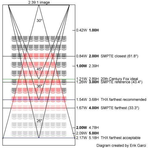

You can pull the seating a bit closer to a 10 ft wide 2.35 screen. My distance to my eyeballs is 130 inches for a 116 inch wide screen.

I'm sitting at 12' for a 120" wide screen and like it. I agree with Big about pulling your seating forward into the 12-13' range, not just for video but for acoustic purpose as well as you'll have bass build up along that back wall. Hang your 4000 just behind the seats at around 15' or so. You could go as far as the back wall (my 4000 is at 17' throw) but will get better image brightness closer.
That's what I'd do at least (I think)
130" from a 116" screen! That sounds a tad too close to me, but then I've never had a projector before so perhaps I just don;t know any better yet. Thank you for pointing it out though. For some odd reason moving the seats closer hadn't yet occurred to me and I could easily see going to 168" (14feet), or maybe even a bit closer, which would make the entrance much less busy. Curious that the projector people calculator shows the recommended distance at this size/throw to be between 14' - 22'.
I think this would definitely be better that swapping the screen wall since doing that means a smaller screen, no floor speakers, and the screen right next to the door.
Hmmm, seems like a small trend there on the seat position so I'll definitely have to go with it. I would love to hear how this helps the acoustics as this is one area I'm still fairly clueless about.
As for the projector I'm trying to keep it as close as possible to the screen to keep the brightness up but I also don't want it too close the fan which will be running at high speed when the room is in use. With the room and projector dimensions it would seem that 16' back is about as far as I will be able to go anyways. I'm hoping for 14'6" - 15'.

The seating position based on that screen size is probably a larger trend vs. a smaller one. If you do some additional reading of build threads, you'll see that many like a 40-45 degree field of view for first row. Following is a seating diagram showing various standards and recommended seating distances if you haven't seen it yet. In the end, it comes down to your preferences though...maybe you or the wife will get sick sitting so close. Easy to move the seating if so, but I would personally hate to have the projector above or hanging in front of my head. Tape your wall to screen dimensions and try to visualize for starters.
Depending on what you plan for audio eqpt(dedicated sub, or whatever) boundaries are notoriously bad for acoustics. In particular, bass will be higher near the rear wall. Common suggestion is to try to get your seating at least 2-3' or more away from the wall. In my room, my rear row is about 1.5' from the wall and I can definitely hear higher bass levels there, while leaning my head another foot forward brings it very close to what I hear at my first row, which is where the AVR is mainly tuned for via Audyssey.

Thank you. I have been doing some more reading and this definitely seems to be the consensus. While diving into another question I had - on aspect ratio 2:35 vs 1:85 I came across this thread http://www.avsforum.com/avs-vb/showthread.php?t=1287699 which really drove the point home. This all works out great since it clean up the room entrance and without a riser to worry about the seating can easily be moved. As for taping it all off - I stopped by Lowes a couple days ago and bought a nice big roll of tape. I've been trying various situations.
