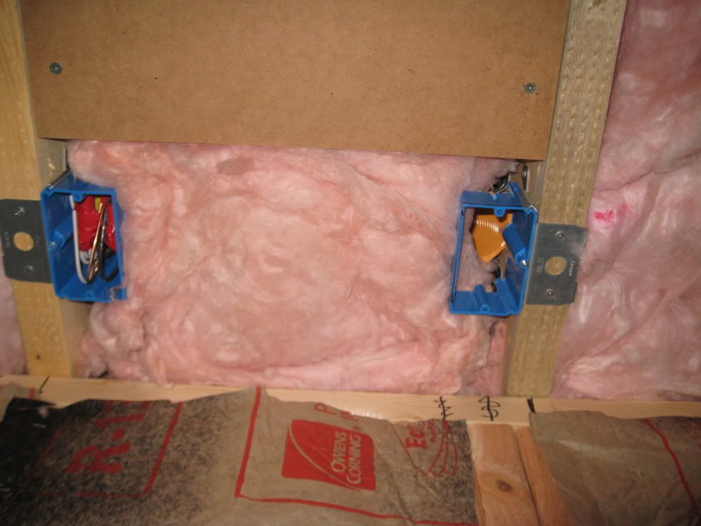

For electrical outlet boxes, the approach I used was normal metal boxes attached as usual to the studs at normal depth, and then appropriate depth box extender rings and mud rings. With low voltage I'm using plastic extensions and long screws. For the 3 gang deep box for the Grafik Eye, I just mounted the box further out on the studs.
If I had known about them though, I probably would have used adjustable depth boxes - here's one example, there are probably other makers as well:

There is no problem screwing drywall to a Microlam the way you described. You can bore a hole through a Microlam, but there are specific guidelines. You have the right idea by avoiding it altogether.
As for boxes, you have several routes. You can do was was mentioned-- get yourself a 4" square box (commonly called a 1900 [nineteen-hundred] box in these parts) paired with a 1" mud ring.
Or, you can get an adjustable depth plastic box. I know a lot of people here have used them; they are available in the bog box stores.
Last, you could use any typical electric box and use a box extender. The extender is installed after the last layer of GWB. It gives a nice flat surface for the devices to compress to:

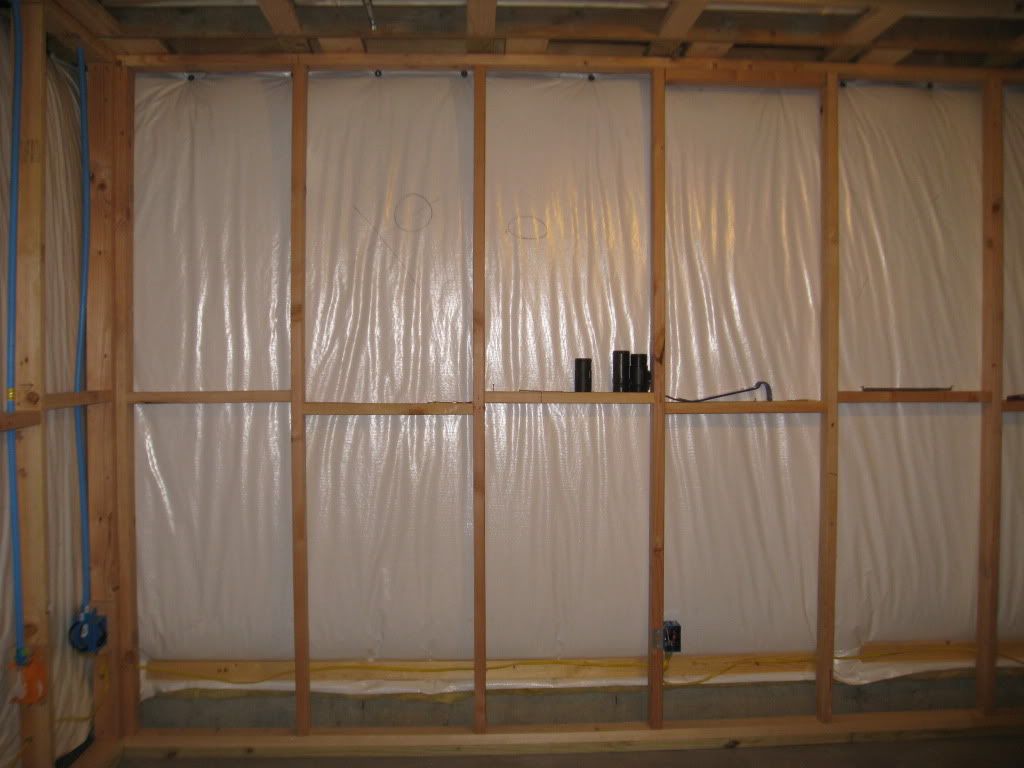

Alright let’s start this build over. I erased my super noob build questions. My HT room will be about 15'x19'.
Nothing fancy, I'll let the pictures talk for themselves.

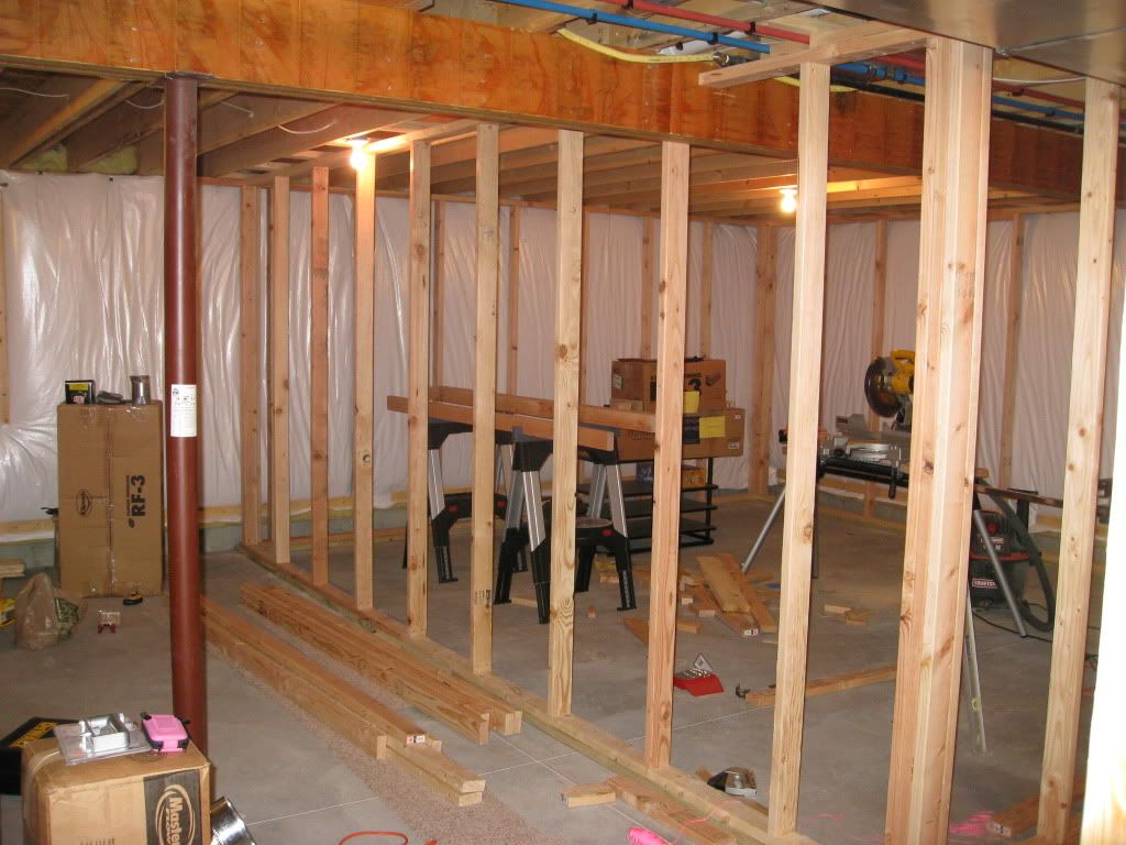

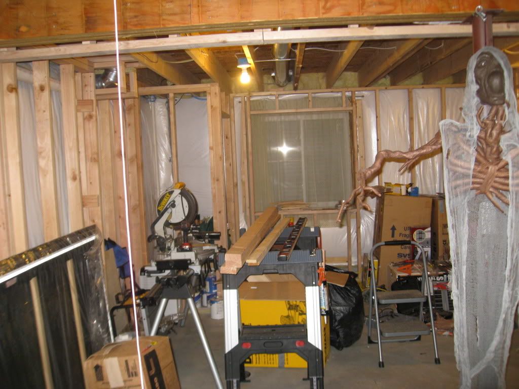

Here is the basement during the home build and pretty much how it looked when I started, oh the options....

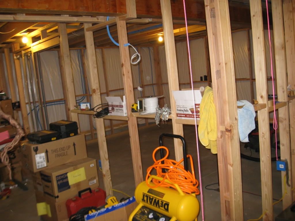

Let the framing start. I decided on 24" on center to help with noise transmission. I knew I wasn't going to get fancy with hat channels or whatever they are called. I knew I would insulate the room. I plan on two layers of 5/8" drywall but not 100%.

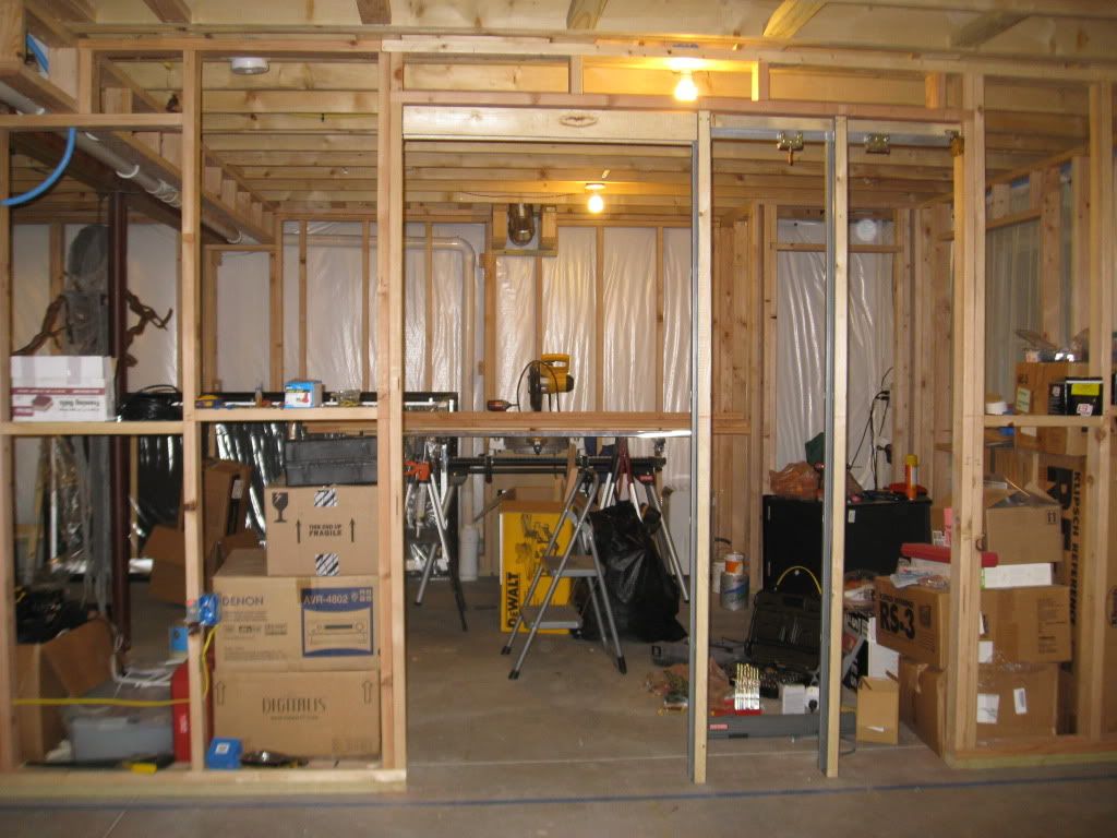

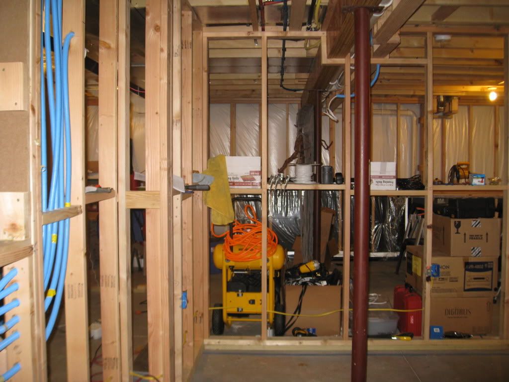

Here is an outside room shot. At this point I didn't frame a door I wasn't 100% where it was going to go. Since I was screwing the room together, I could easily make changes.... yes screw.... it was a long painful process. After the HT room was screwed together, I bought an air gun for the rest of the basement. All the lights will be removed lateras they serve as temp building lights.
Inside the room looking at the future screen wall
Looking into the room, this is the future door opening.

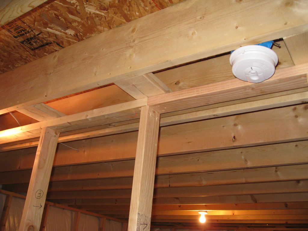

Just a shot how I tied the wall to the ceiling joist. I'll move the fire alarm later.

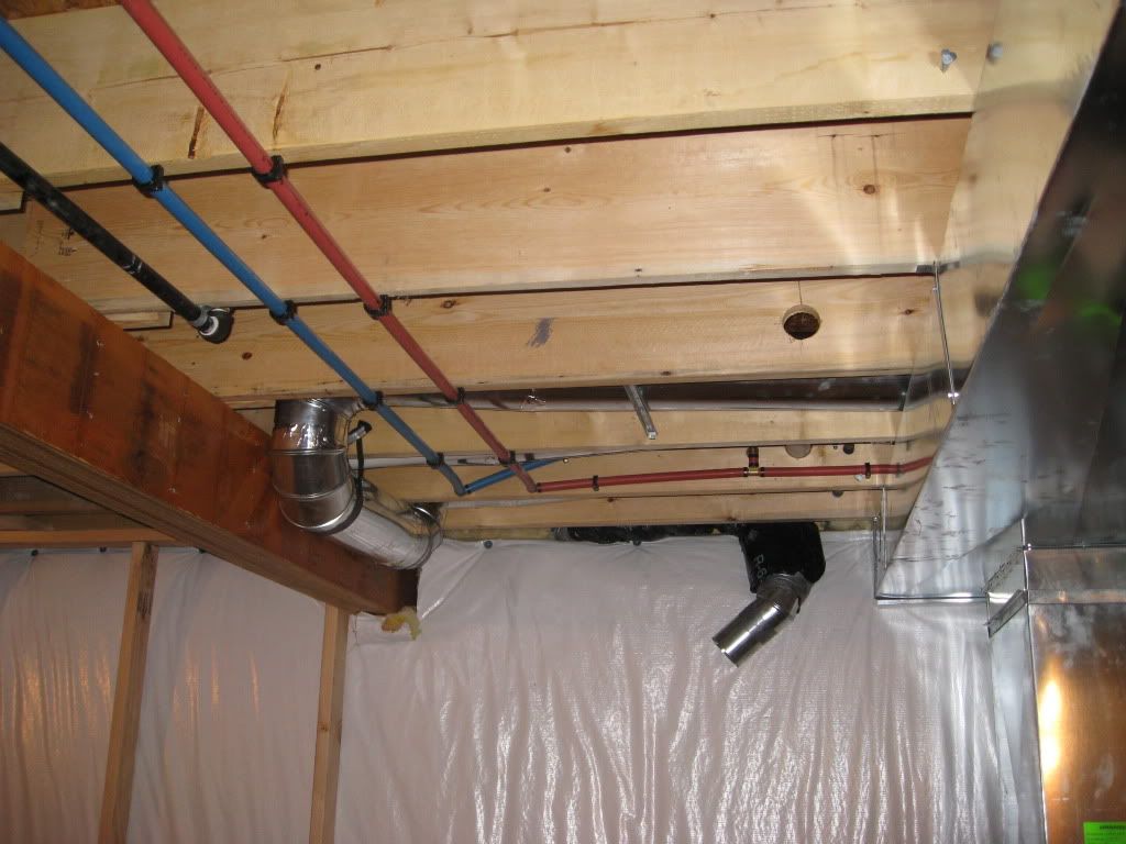

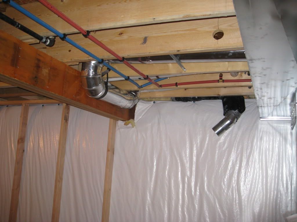

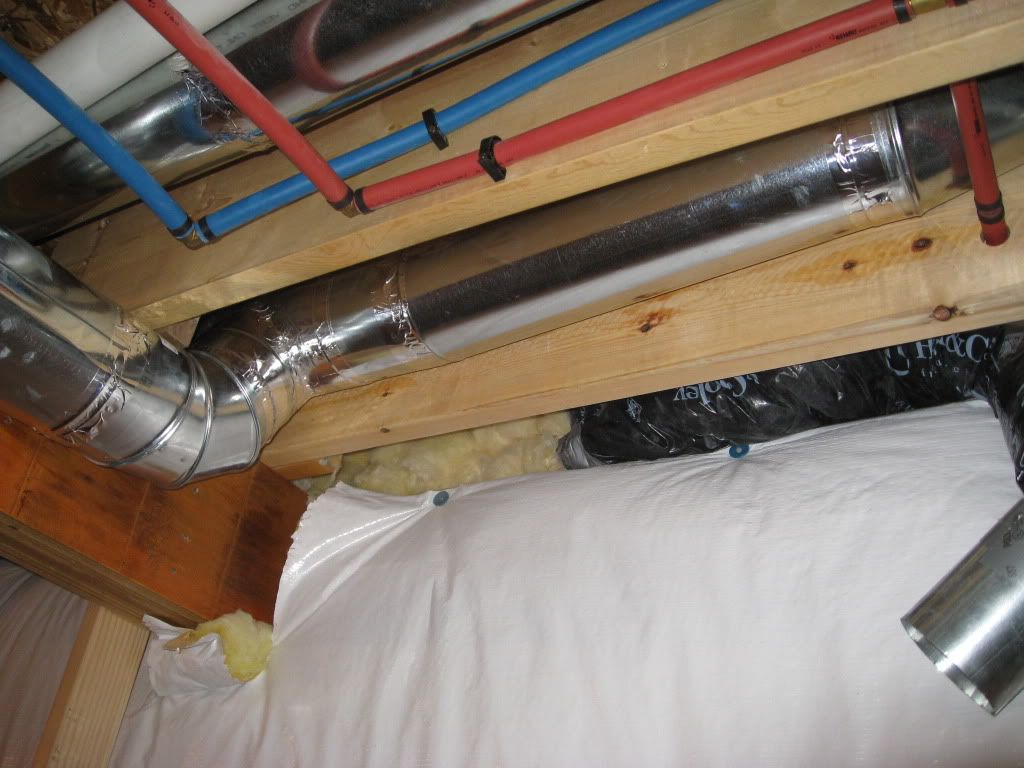

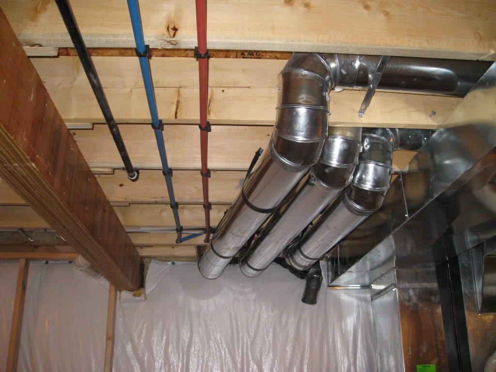

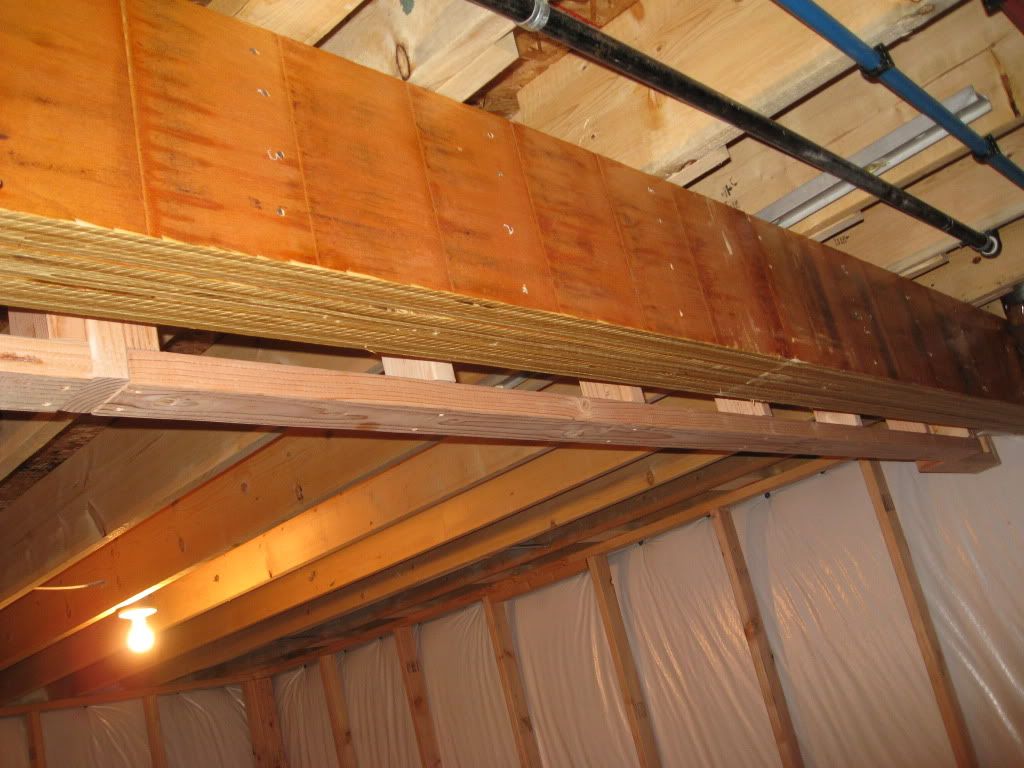

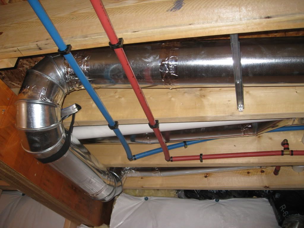

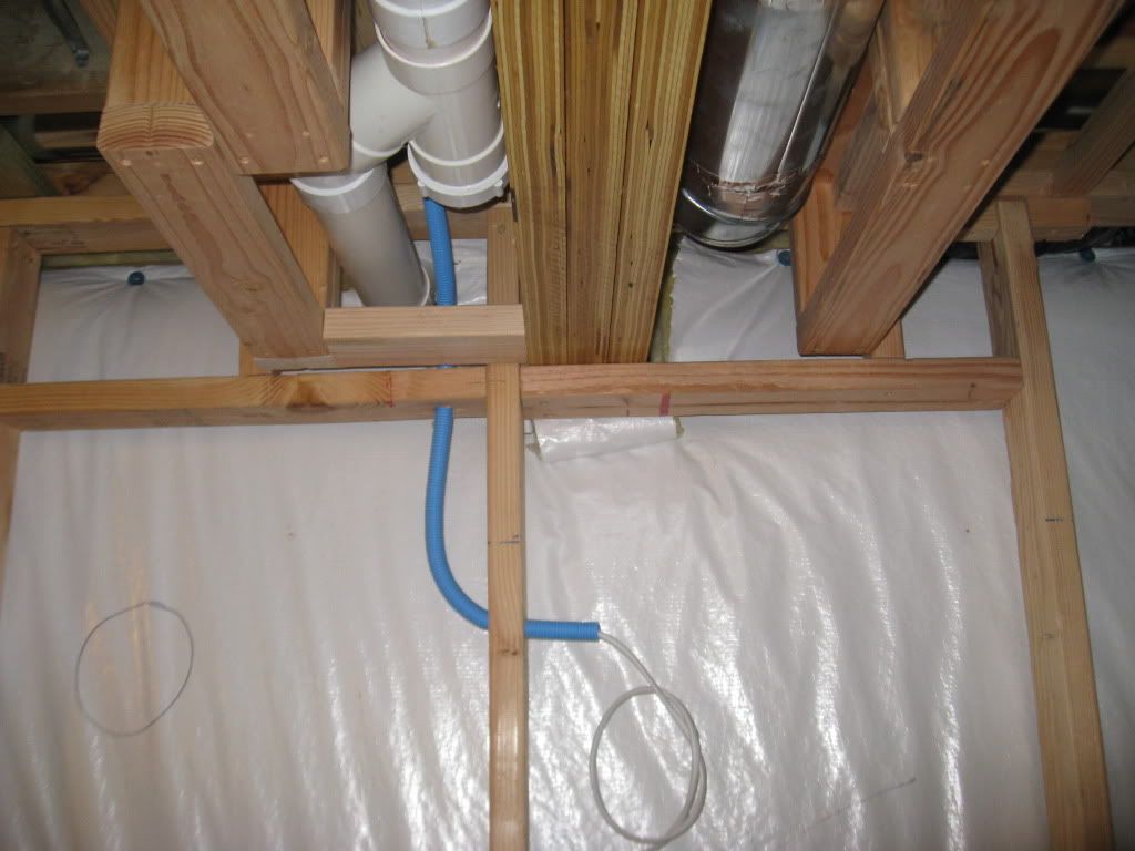

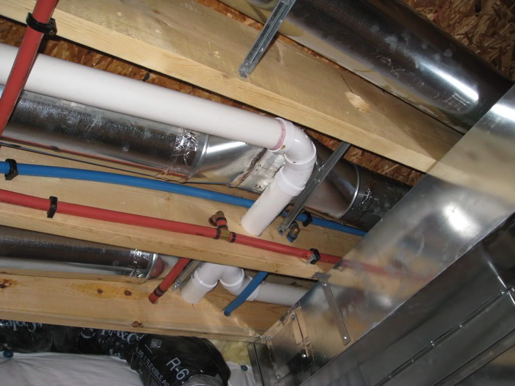

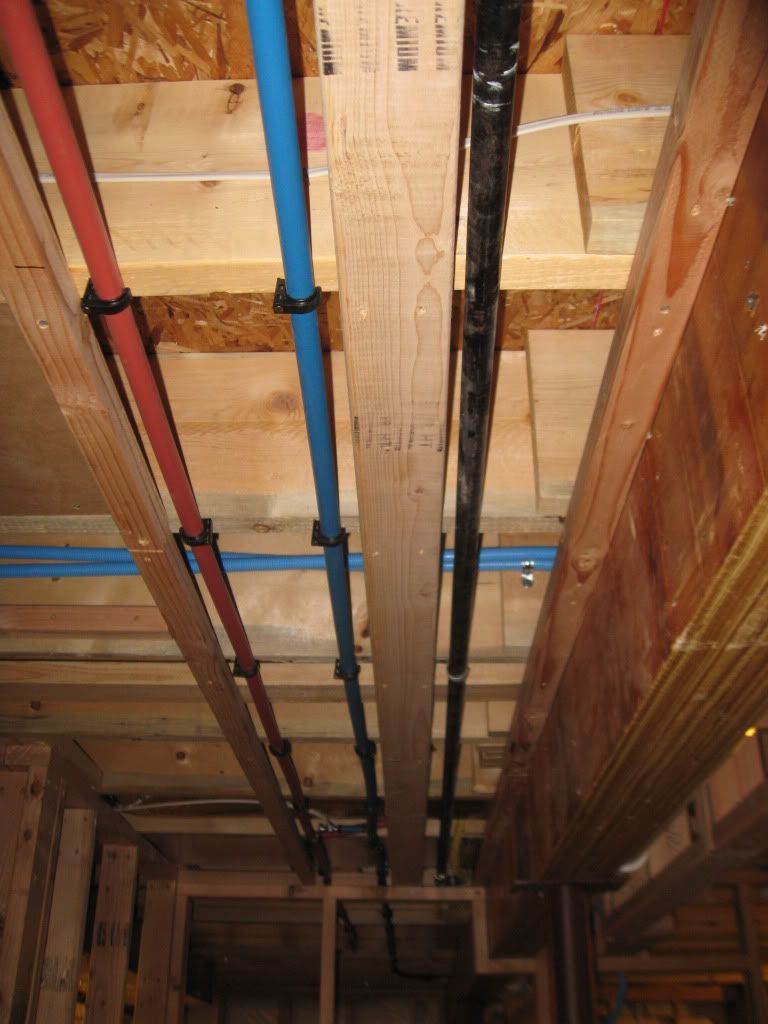

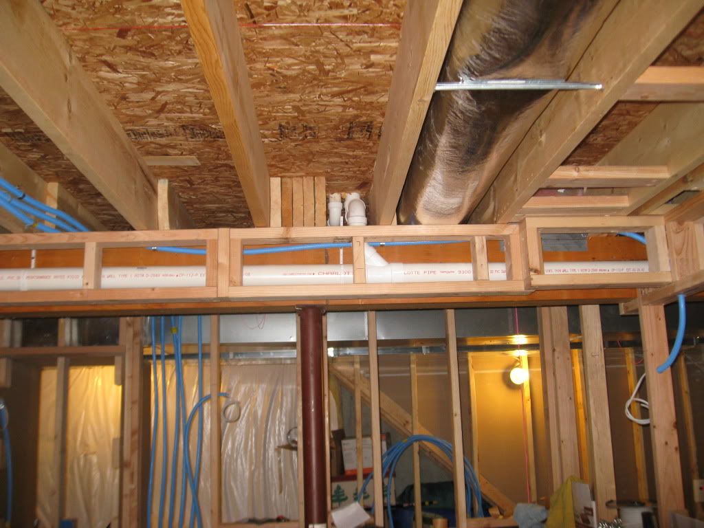

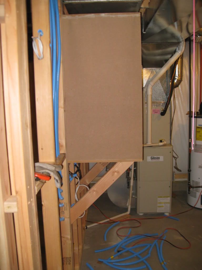

Here is the first mess I dealt within the build. Since my basement was barely 8' tall I need all the head room as possible and below these ducts would be the rear riser so head room was important. I also had to move these HVAC ducts as that was the location I had planned to tie the rear wall to the ceiling joist. The next series of pics are the before and after.
Here are the three runs moved. Now I only had one run that I moved next to the LVL beam. I also improved the HVAC because the old runs weren't taped. I was also able to make a new run and run it above the drain pipe with a simple 8" to 8" oval boot.

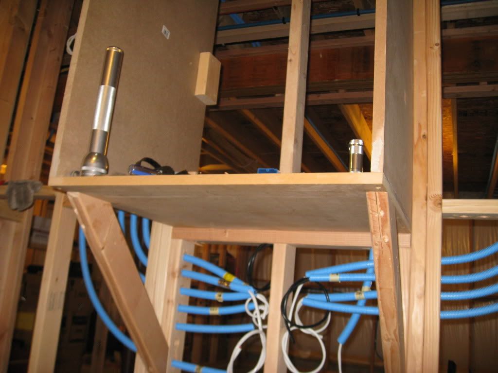

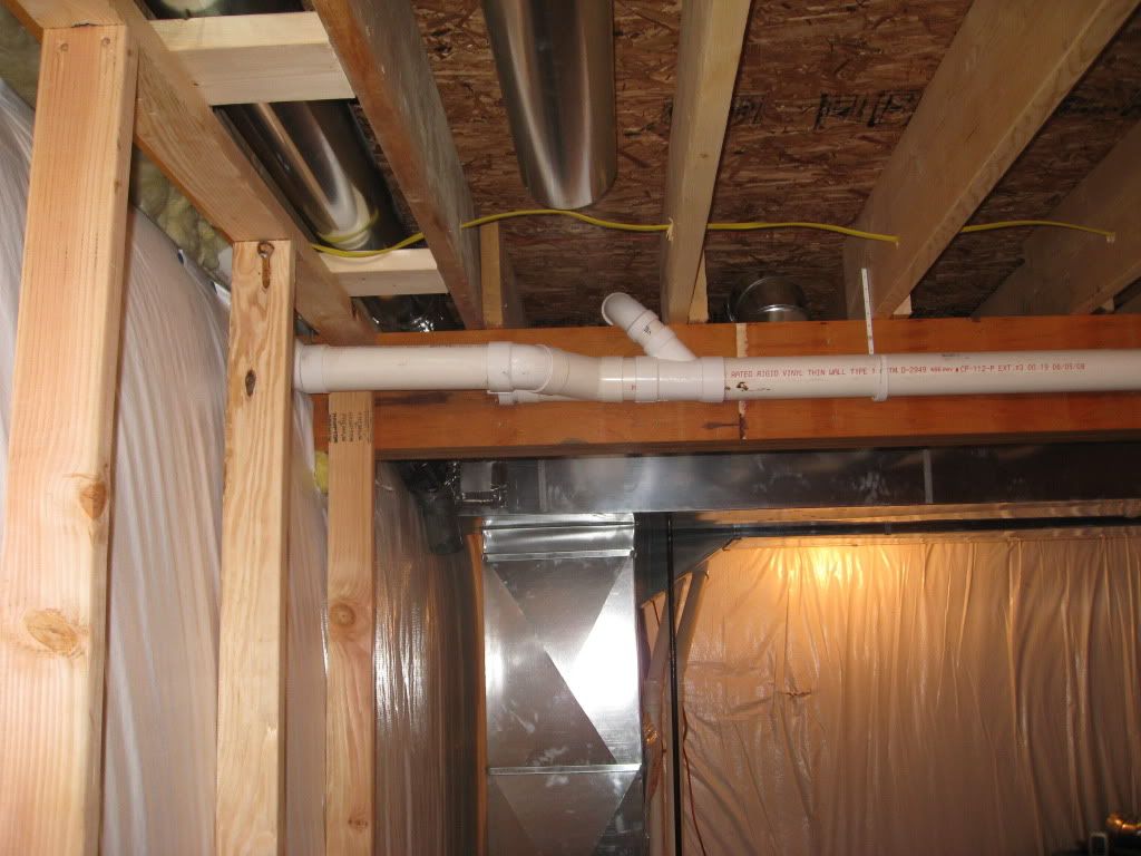

Alright, back wall is up with stereo rack. Started the ladder work for the waste pipe so I could box around the LVL beam. The freash air vent hanging in the studding will get moved later.

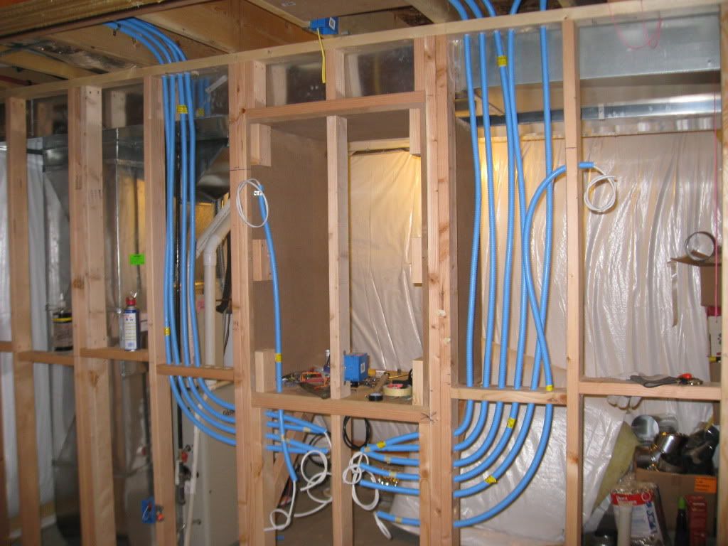

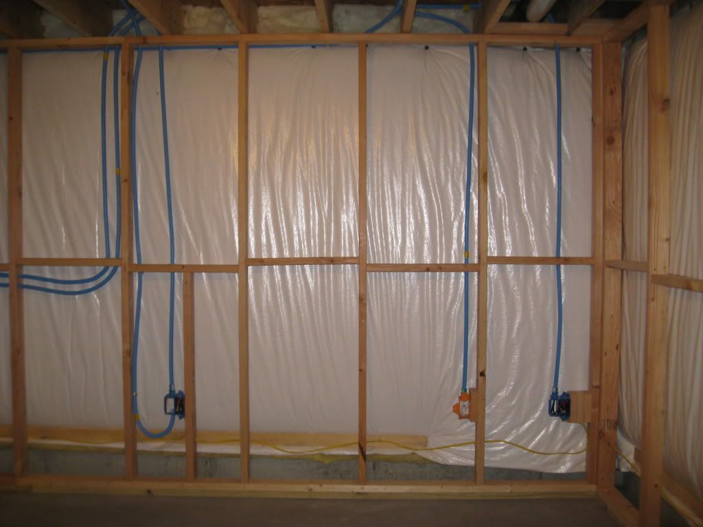

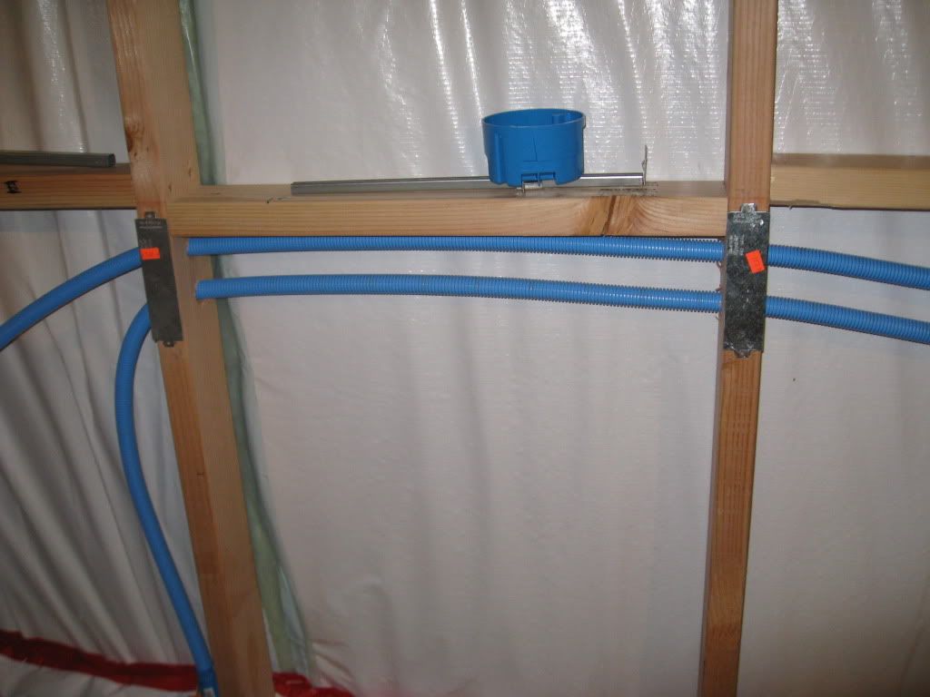

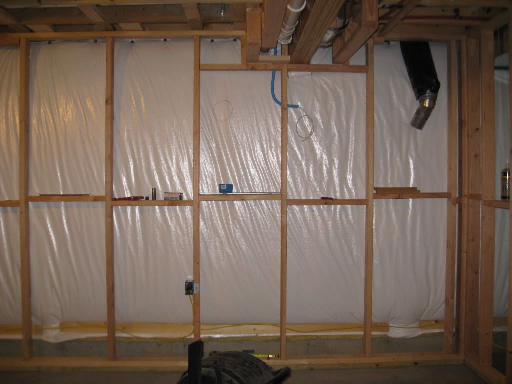

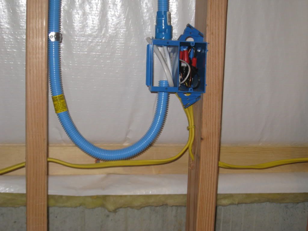

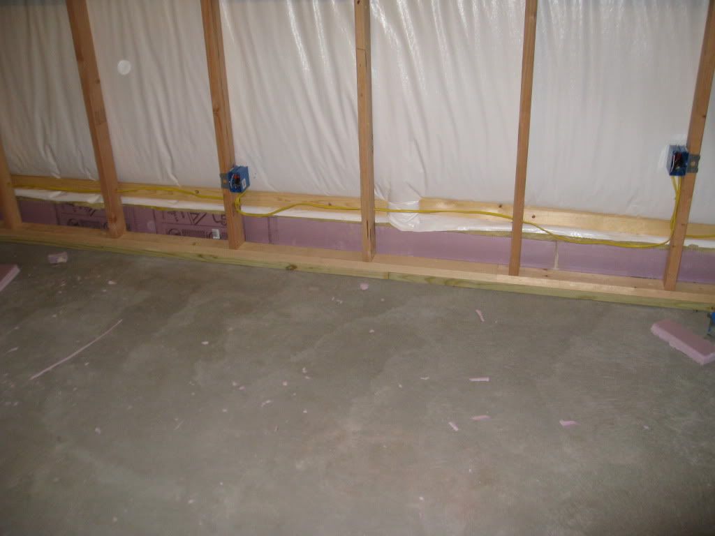

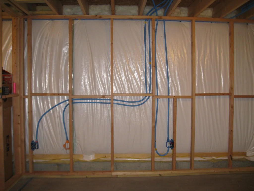

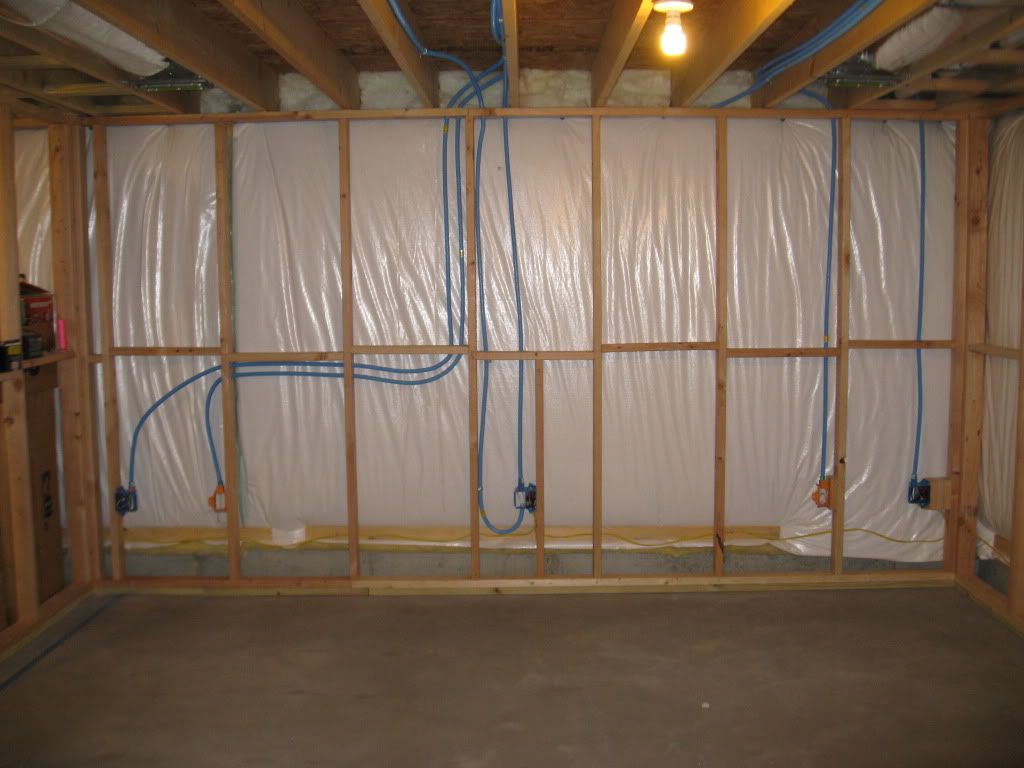

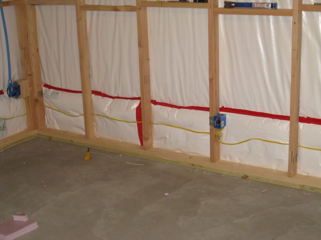

Okay I started the wiring. Here is a front wall shot. I used ½ smurf conduit which was a mistake because 12 gauge CL2 wire was a PITA to pull. I had to use lube, lots of it. I ran the romex low to avoid the speaker wires.
right front
left front
Side front
Side wall rear
Rear wall

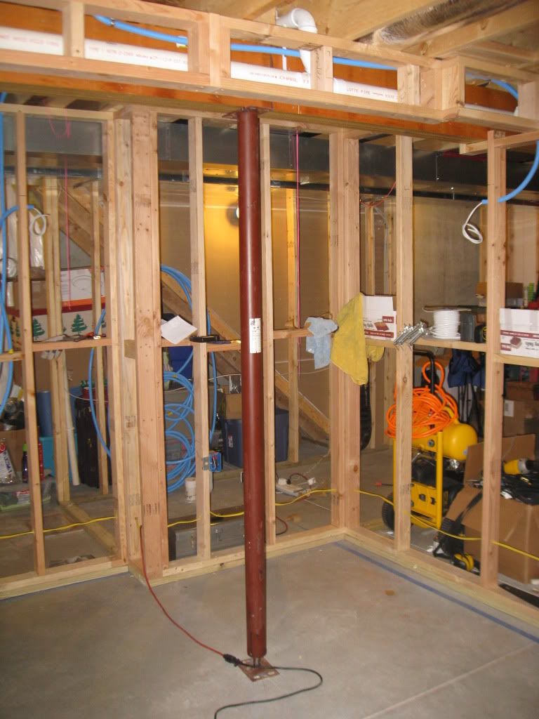

Rear wall right side. Here is one bummer with my lay out was the pole. No biggie, it in the rear seats will be to the left and one to the right for the rear seating. Laying the HT room out this way allowed me to build a family next to the HT room.

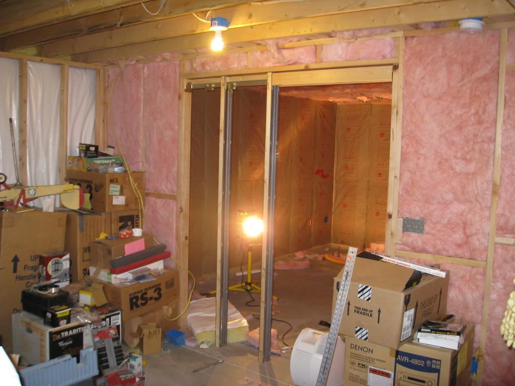

Here is the first shot of the door. I went with a pocket so a door wouldn't swing into the HT room or the family/rec room. Plus it was a compromise with the wife. She wanted a curtain as a wall to separate the HT room and family room, I was like hell no! This pocket door will support a 300 pound door slab. More on that later.

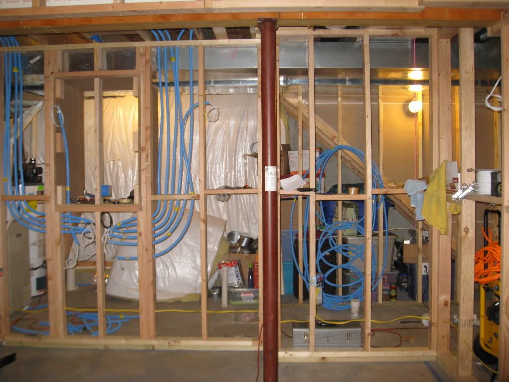

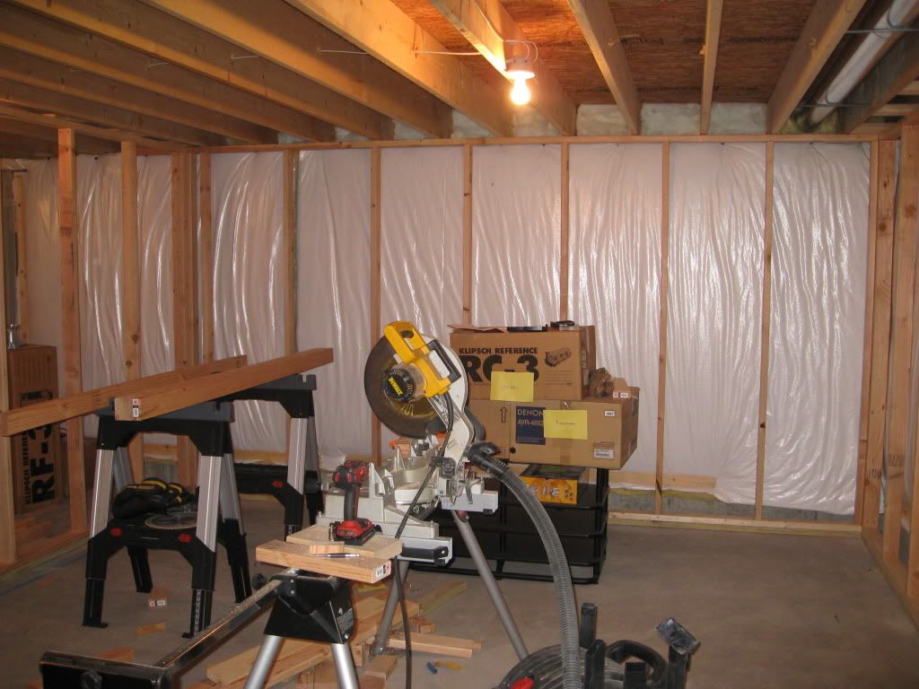

Full rear wall shot, if you're wondering why I went to 16" on center for the rear wall, it was because I wanted to line up the studs with the joists so I had clear runs if i decided to do a cold air return. I wanted to give myself options in the future. If you notice I have an odd stud in the mix is because I needed a 8' drywall sheet to end on a stud. Im trying to avoid butt joints when I get to the drywall.

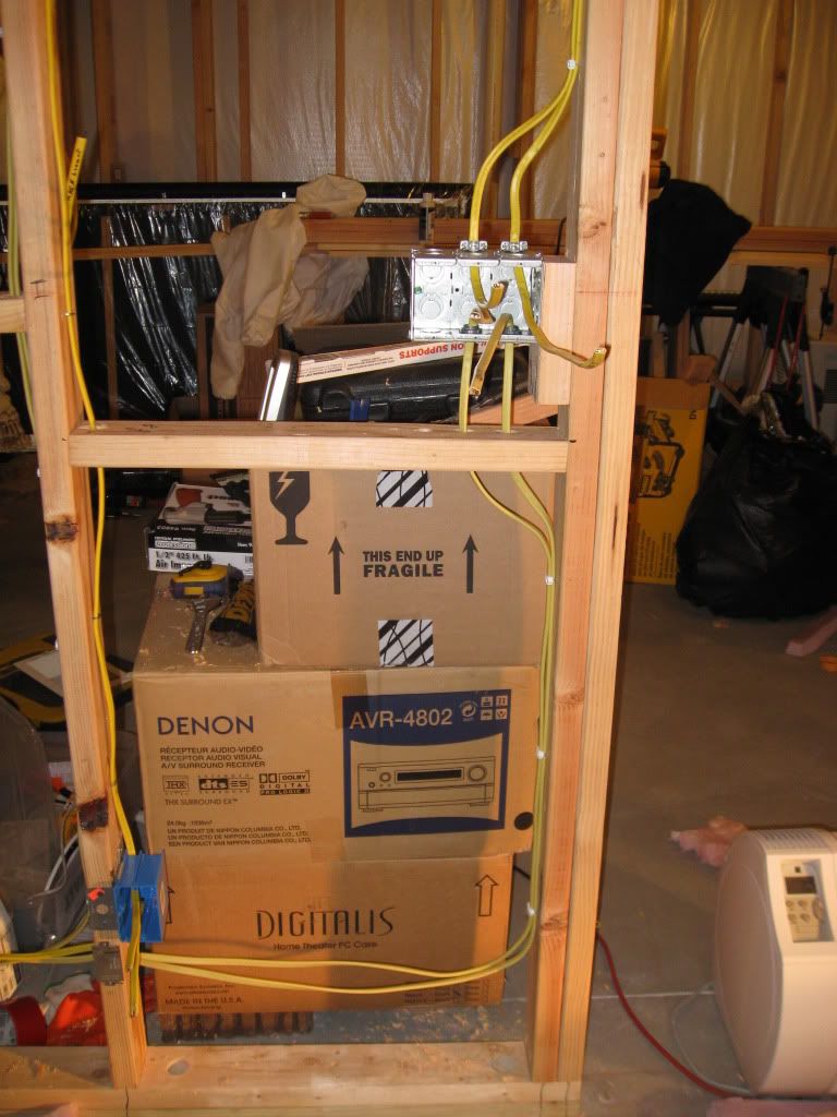

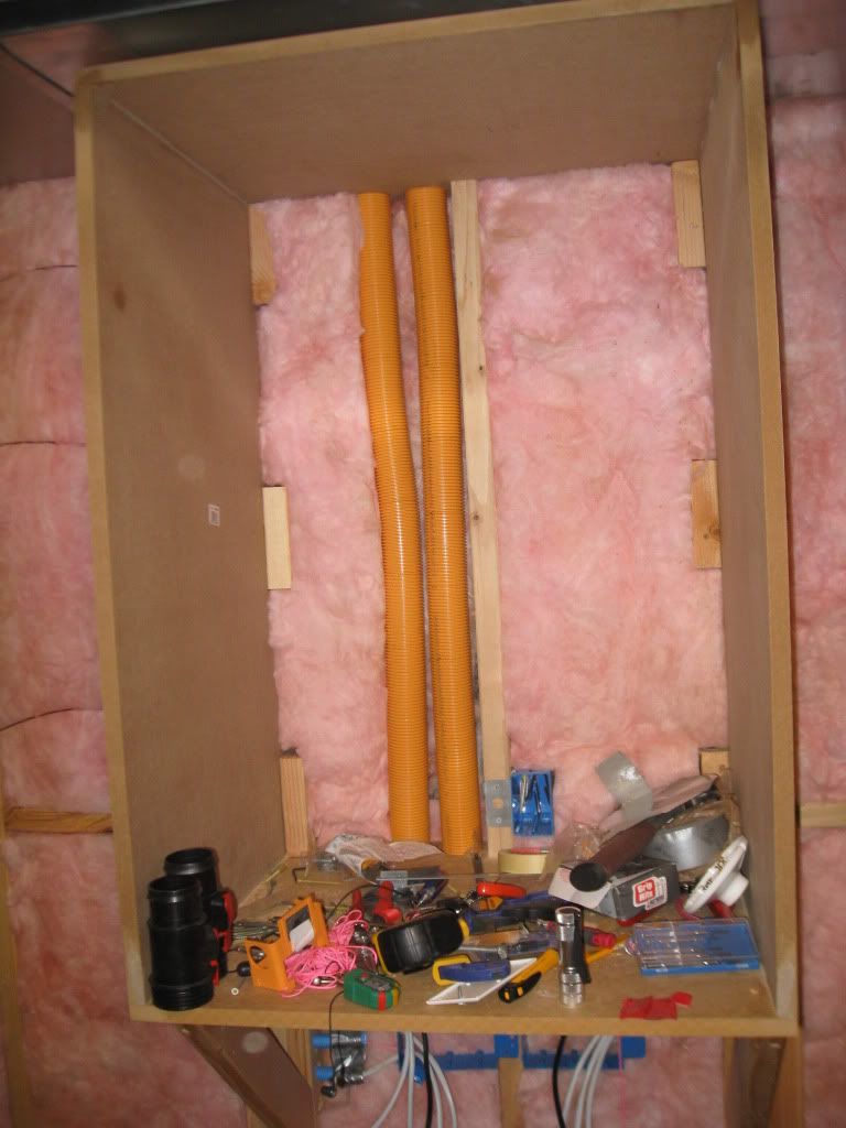

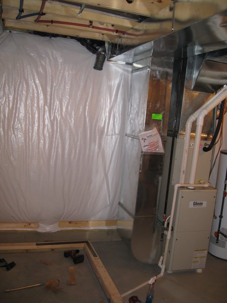

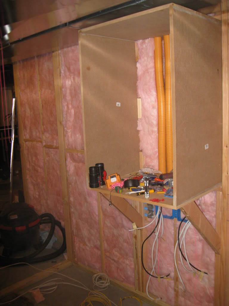

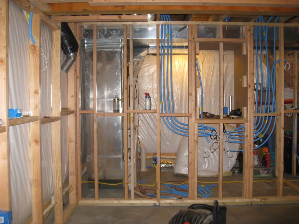

Here is the nerve center. I was going to make the rack accessible from the HT room then I changed my mind when I figured out the rear surround would be located in the rack given the room la out. Plus I wanted to move the equipment out of the room because of lights and noise. I wanted to also isolate the mech room noise out of the HT room. So the HT gear is now accessible from the mech room. I'll use a IR repeater to control the equiptment.
Another rack shot

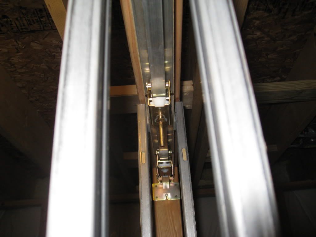

Okay here is a shot of the Johnson pocket door. It's a 36"X80" assembly and like I mentioned, it can hold a 300 pound 1-3/4" door slab.

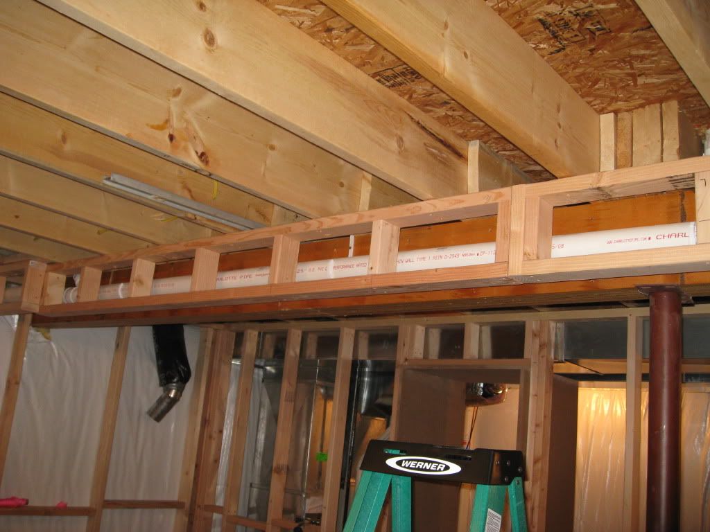

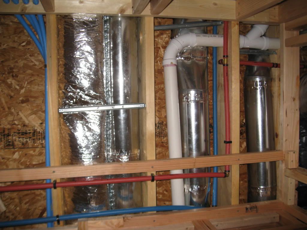

Framed around the rear HVAC duct and set up some furring strips for the water and gas pipe. This is in the rear of the room behind the LVL beam.

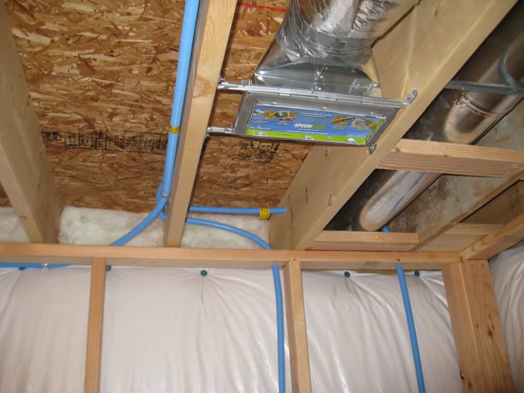

Another joist shot. I ran the first HT room duct using flexi ducting and a speed boot

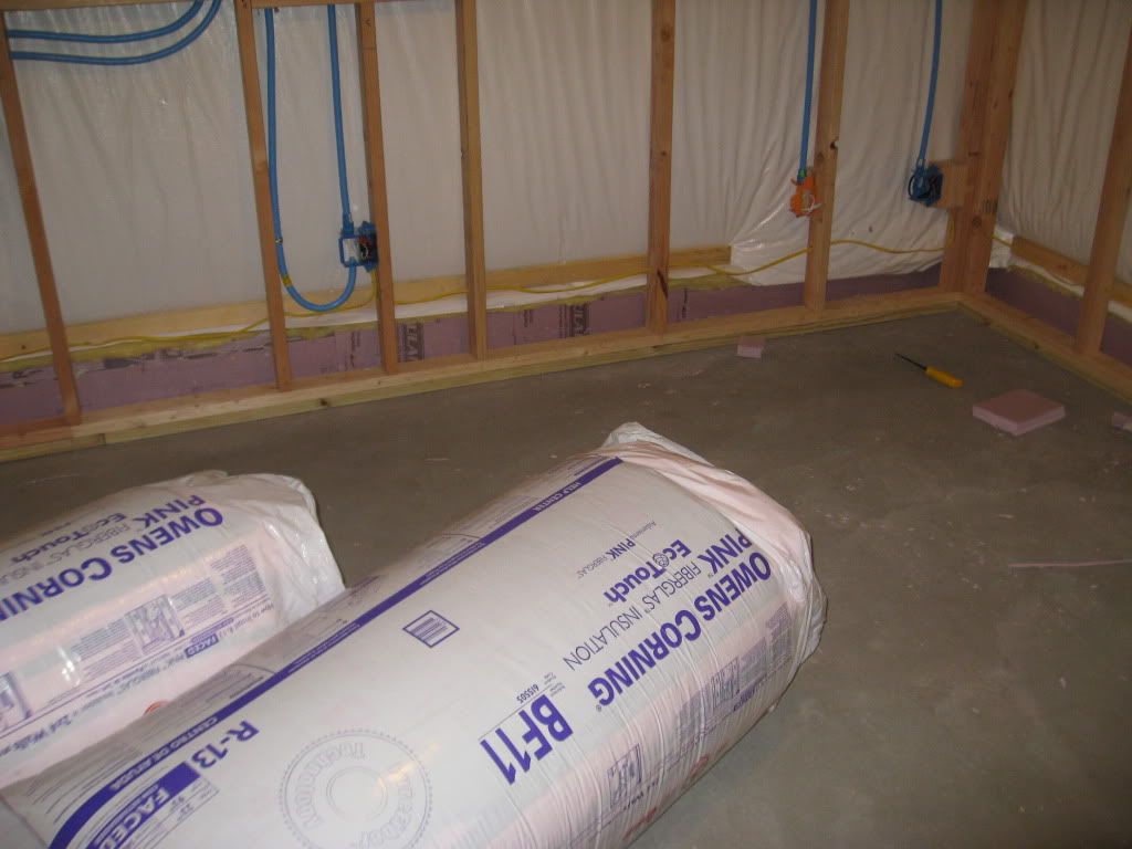

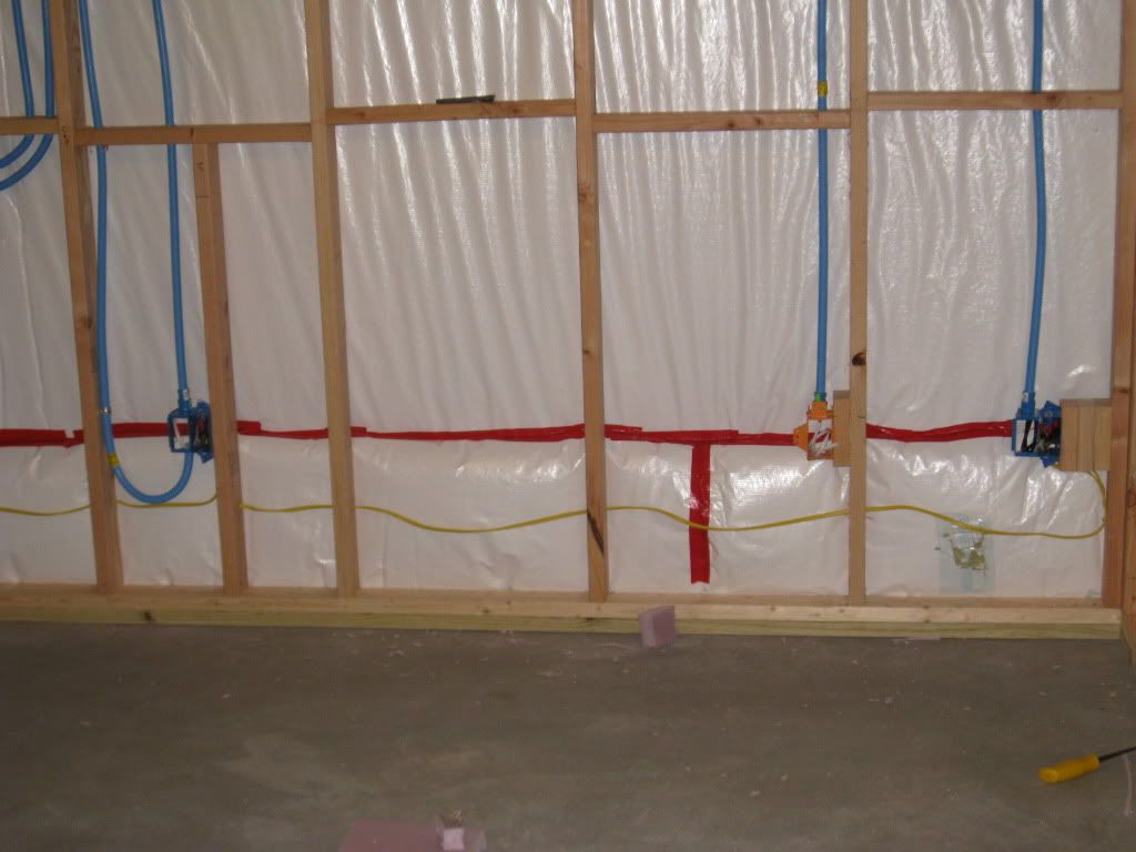

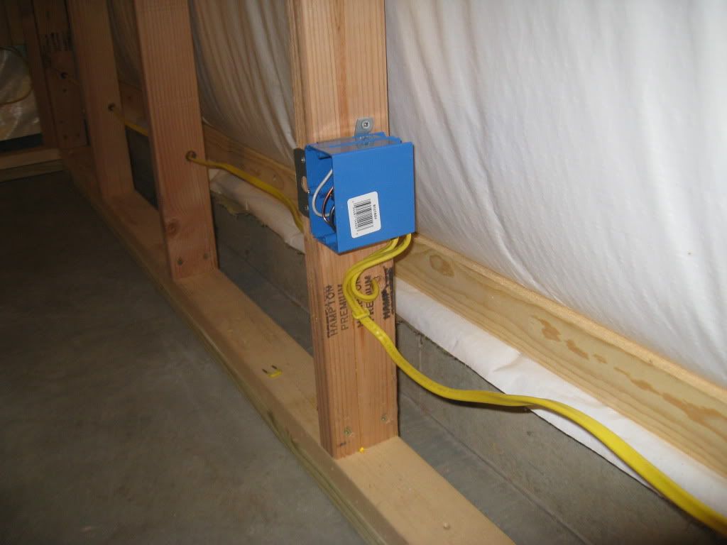

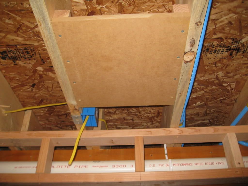

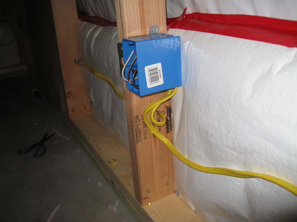

A shot of a plug. I'm using adjustable boxes for the multi-layers of drywall.
Front plug shot. This is a combo gang for a plug a subwoofer drop. I have one in each corner of the font stage.

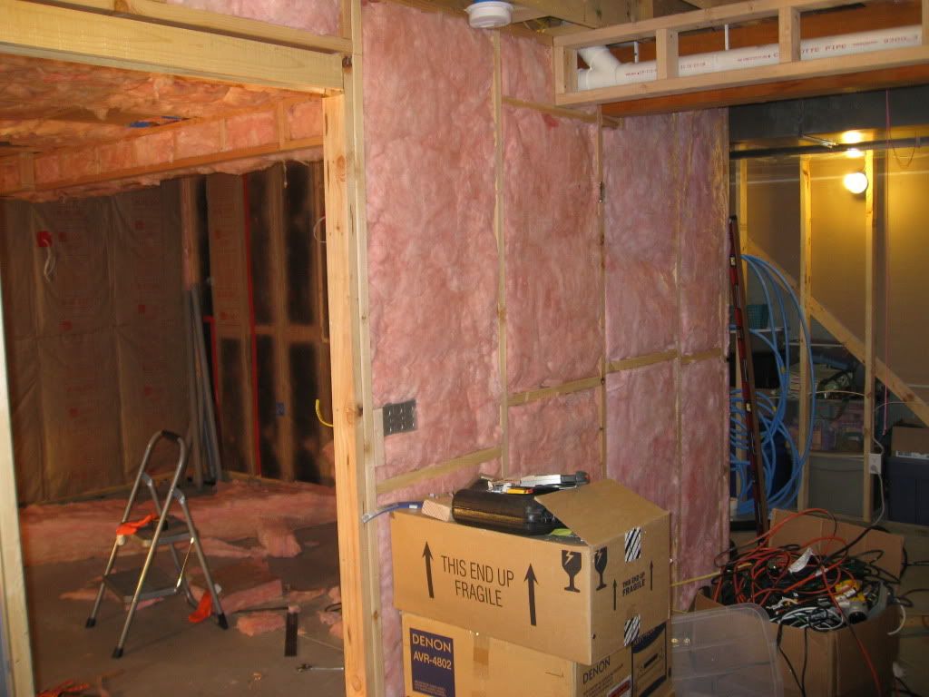

A shot of the speed boot. I opted not to build a box around the boot for sound isolation. Project is majorly behind and I’m pushing forward
I opted to use red head 1/2" sleeved concrete anchors at each end of the pocket door. Since I was going to have a heavy door, I wanted to make sure the base was nice and secure.
Another shot of the framing around the water and gas line. This is the back of the room behind the LVL beam.

Shot of the equipment rack from the mech room.

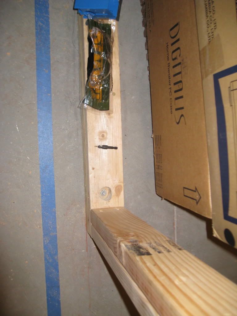

This is a drop for a plug, center channel, and run for the IR extender.

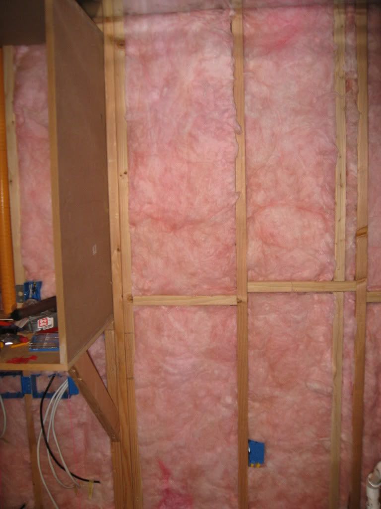

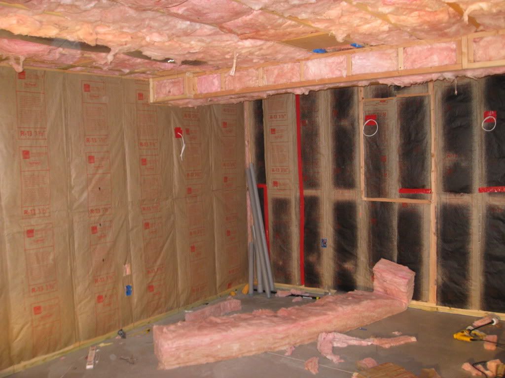

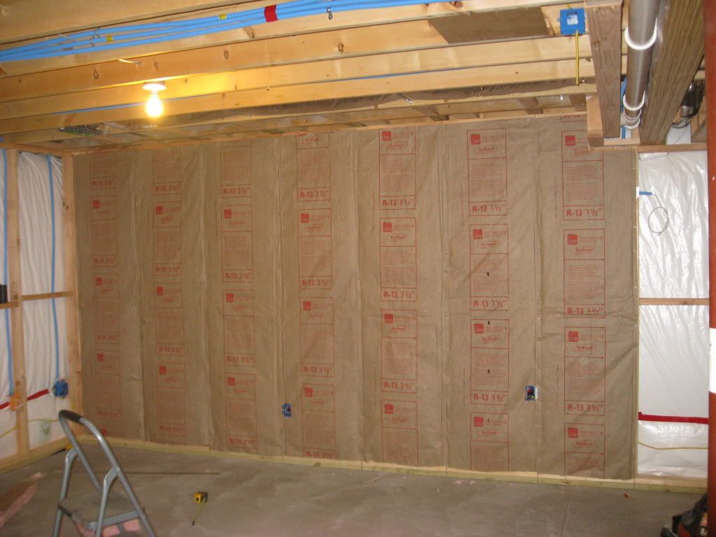

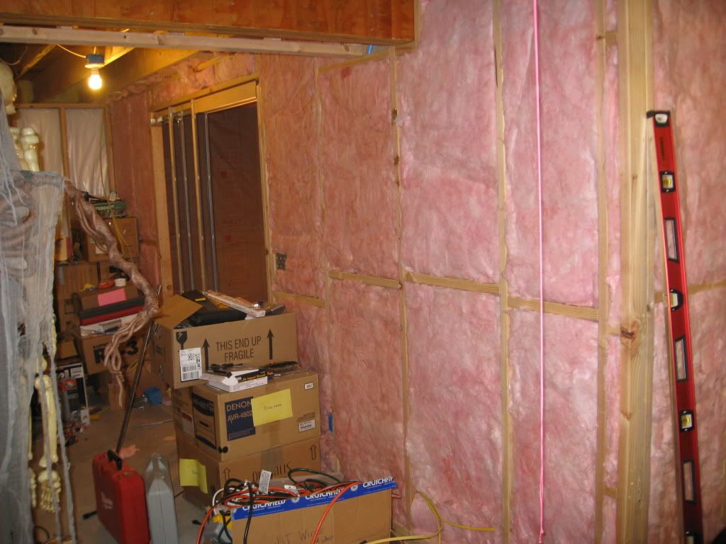

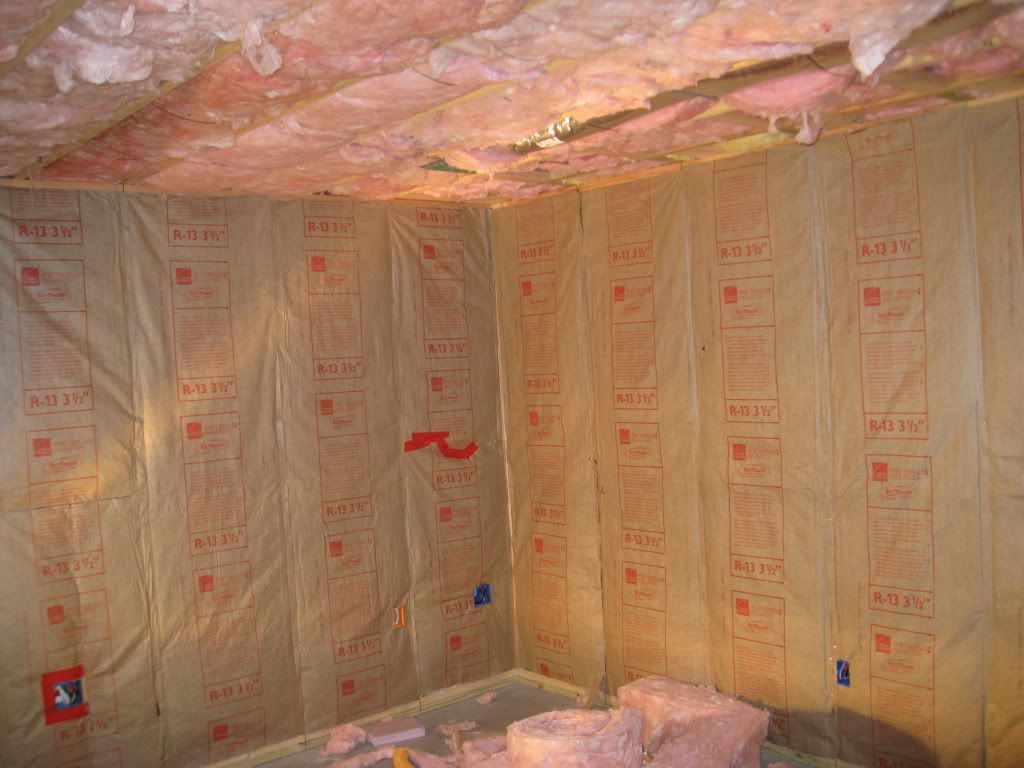

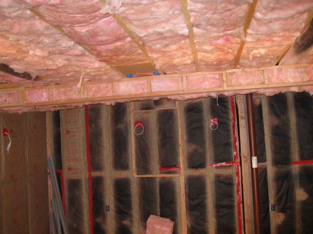

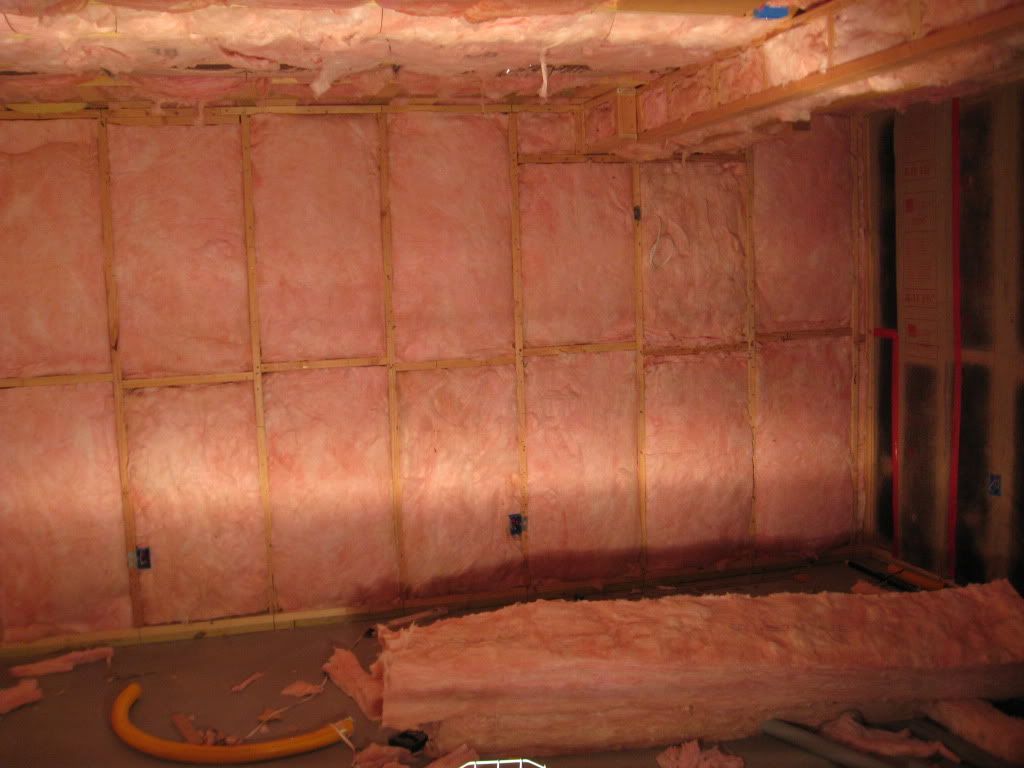

Let the insulation begin. I really regret not taking down the wall blanket. I hate how it pushes the framing so far off the wall. Not to mention the gap below. So I filled the gap with insulation foam board around the room. The builder recommended to me just to leave it when I built, mistake on many levels.
I then covered the insulation foam board with left over wall insulation I removed from another side of the basement. The real reason I did this was to fill the void between the bottom wall and the framing. I didn't want the cat or other critter venturing behind there or air movement.
A little protection for the speaker wires when time to dry wall. I don't think Ill ever get that 12 gauge speaker wire out of the 1/2" smurf conduit. Note to self, I should have used 3/4" smurf conduit. All well, I have fancy speaker wire holders now

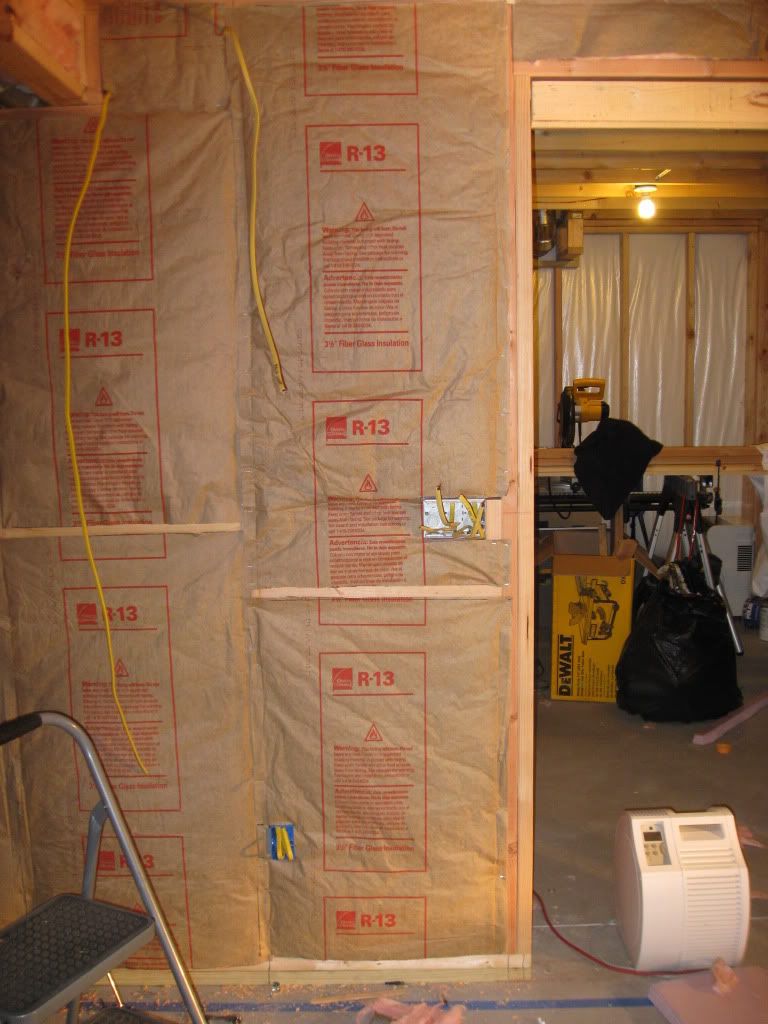

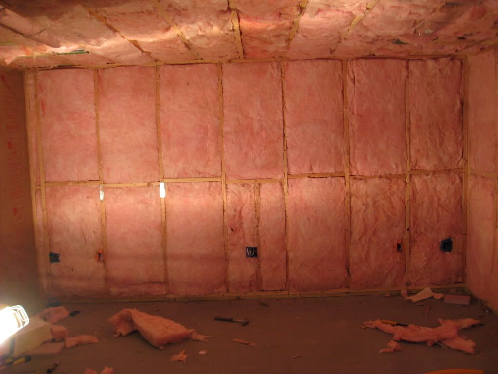

Okay now to throw up the insulation in the framing. I opted to staple the craft paper to the face of the stud to help isolate the drywall form the stud. This method also doesn't compress the insulation and doesn’t create a fire channel. You can't glue the drywall to the stud, but I don't care as I was going to screw it like a mad man... I also cut slits on the paper per my fathers advice since I had a double vapor barrier going on around the poured walls.
Shot of the wiring for the switch. I made provisions in case I want to use a Lutron GE in the future, extra deep gang. I'll have a dimmer for the a ceiling tray light (rope?), soffit lights, and front are rear stage/riser lighitng...rope?!?!

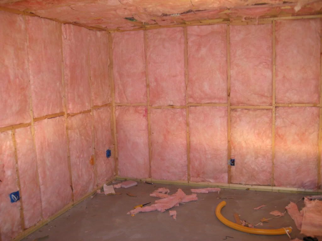

Okay room is insulated. I went a little nutty with the ceiling and used R30. That job SUCKED as insulation rains on you.

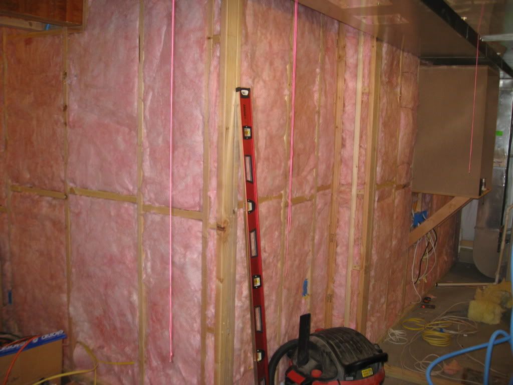

The last three shots are in the mech room looking at the stereo rack. The two orange lines run to the two PJ location.

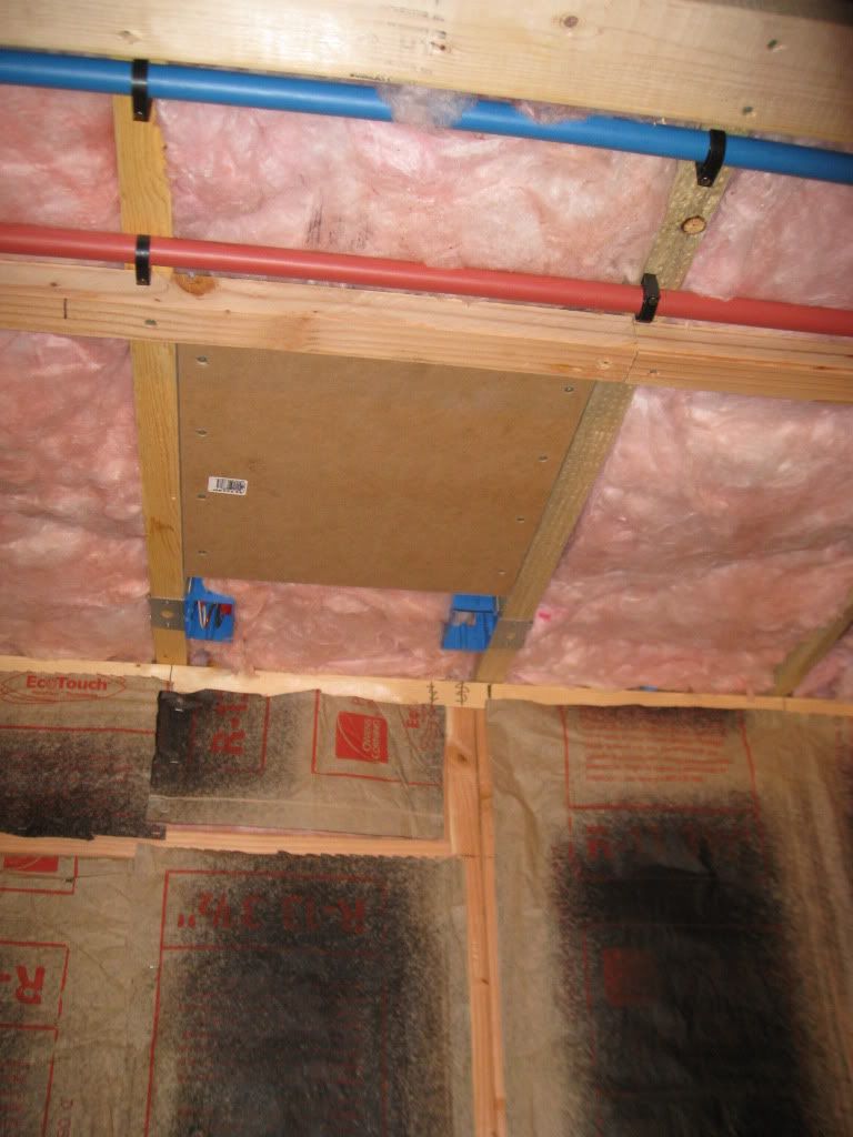

Shot of the power and A/V gang (both adjustable), you can see the orange conduit here for the HDMI and other a/v cables

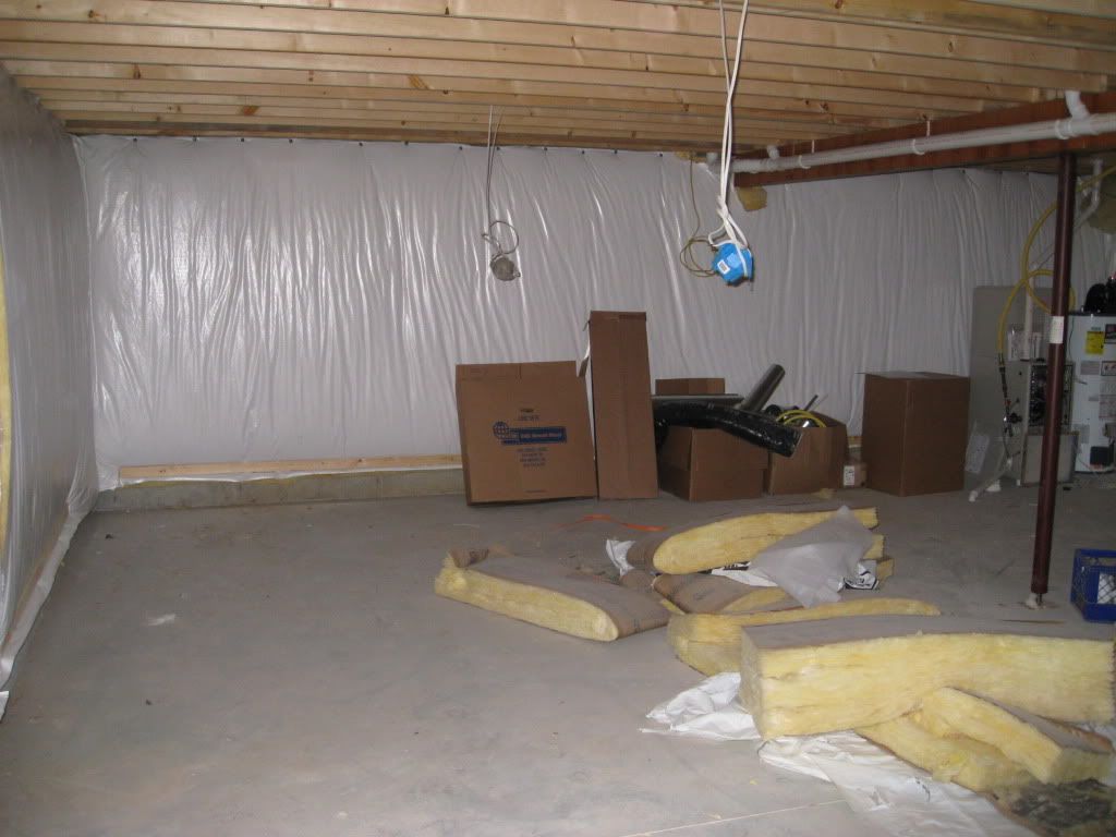

You should not have double layer of vapor barrier. More likely to trap moisture.
mike@avscience.com
Sony, JVC, Epson, Denon, Marantz, Yamaha, Onkyo, Triad, Atlantic Tech, M&K, RBH, SVS, Polk, Stewart, Seymour, Falcon, DNP, SI, Screen Excellence, Carada & more.

I have cut vents on the craft paper boarding the poured walls, that's not pictured here. Plus I'm lucky to have a very dry basement with the help of a radon system.

Alright Mike, you got in my head. I did a ton of reading about vapor barriers and there is a lot of conflicting info out there for basement insulation. One school of thought even says that painted drywall is a vapor barrier. To free my OCD mind I just removed the craft paper off the 2 walls bordering the poured concrete walls. mind eased

Here are some new shots. The drywall is completed so I'm building a lighting soffit. Soffit will only contain 3" halogen can lights like the Bacon Race Theater build and rope lighting hidden in crown, no HVAC.
In the pic above I still need to build the side rear lighting soffit, I won't be building a rear wall light soffit.
Here is my major question and I'm looking for opinions. The soffit will be skinned with 5/8" drywall next. I'll mount the can right on the drywall. Instructions say to keep insulation at least 3" away from the can. Is it even safe to fill the soffit with insulation at all, even if I keep it at least 3" away from the can? I read somewhere with lighting like this, it's a code violation to have insulation in the same area, even if it's 3" away. However, I'm worried if I don't insulate the soffit it will conduct noise from above. Is there a fire danger here or a situation to overhead the lighting? I built the soffit shallow to accommodate this particular can light to save head room.
