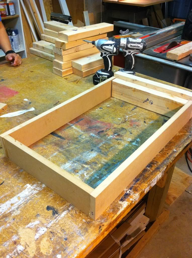

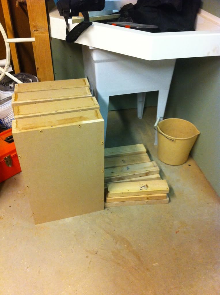

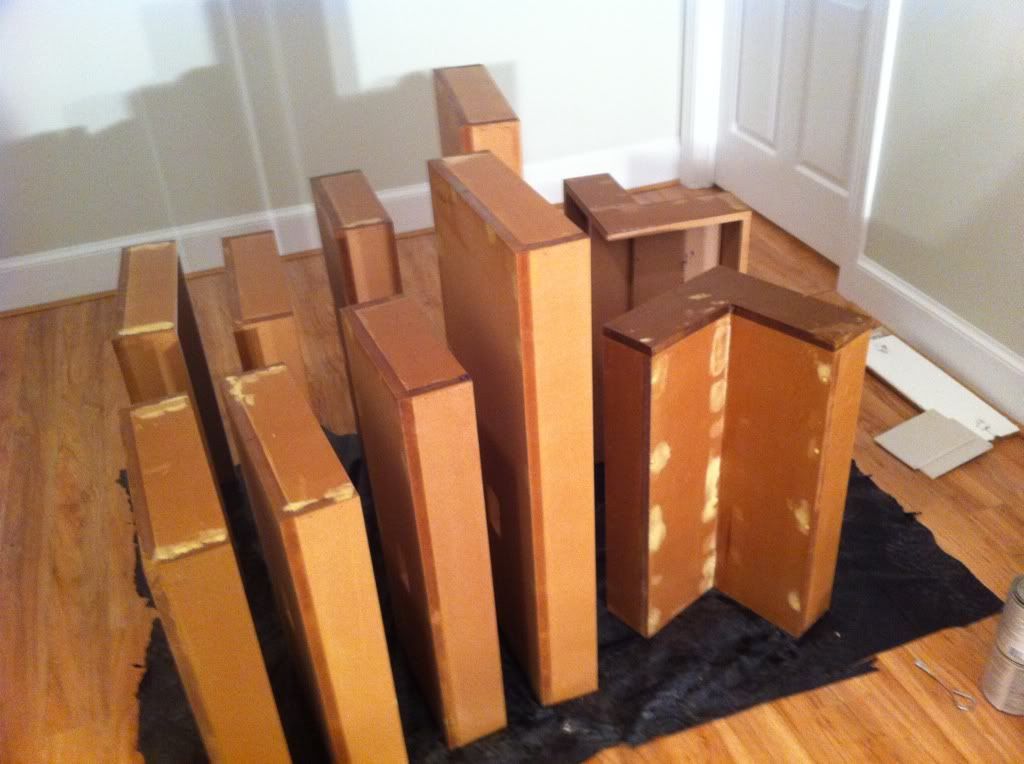

Today was columns day - lots and lots of columns - actually just column bases, but the rest will be easy after today
Day started with my future-brother-in-law coming over and us loading up his truck with lots of MDF faces pre-cut, boards to make the sides and tops, and lots and lots of 2x4 and 2x10 scraps and heading out over to Mr. Big's to build the sides, tops, bases, and wall mounts for the columns. Also needed to cut out the outlet boxes in 6 of the 12 columns and join 4 of the back columns together to make up the 2 back corners.

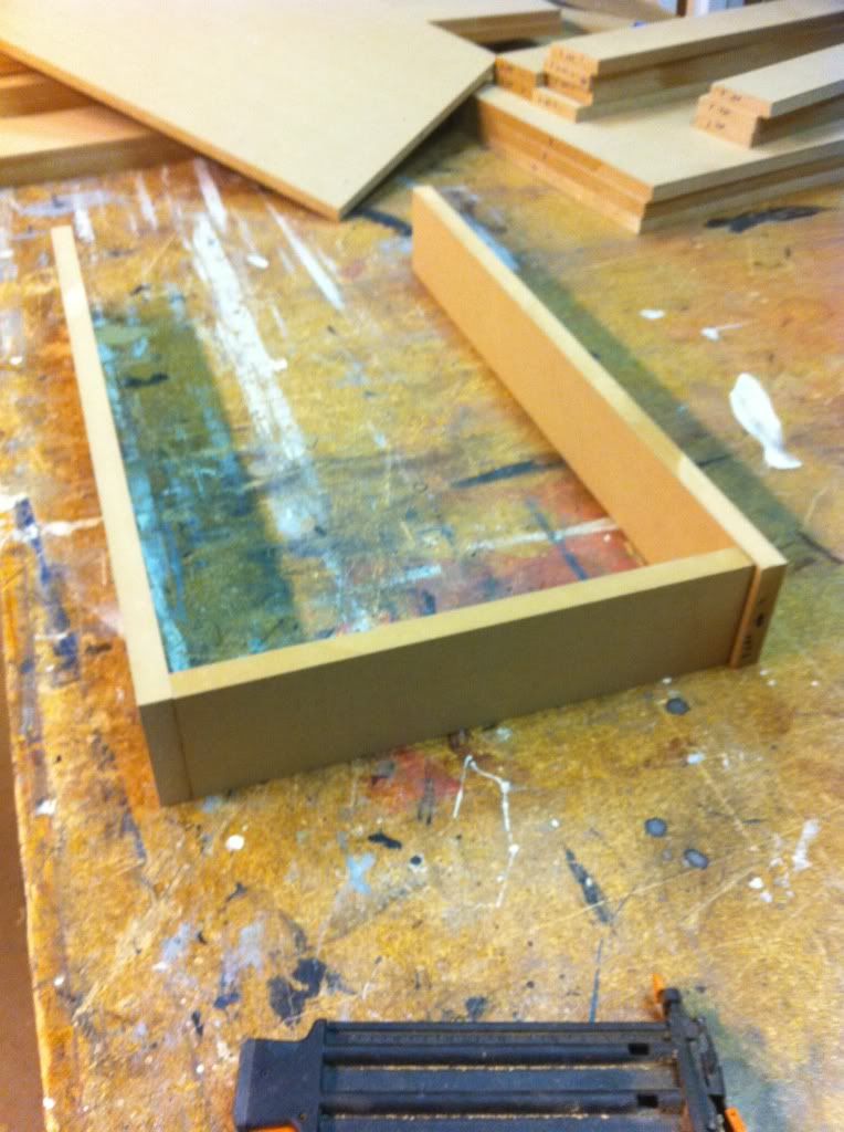

So 12 columns basically needed to be built including
1. sides cut
2. tops cut
3. corner columns constructed
4. bases built (2x4 on top of a ripped 2x10 w/ 3/4" offsets to slide the column bases onto them)
5. wall mounts cut
6. sides screwed to the tops
7. faces attached
8. screws puttied and sanded
9. edges of everything routed smooth
10. everything touched up and sanded
11. everything sealed
**Thank goodness all the faces were cut when i bought the MDF at home depot
FYI - we constructed everything by gluing first, brad nailing the pieces together while ensuring they were right with squares in the corners, then screwing everything together
then next steps
1. everything sanded again
2. everything primed
3. everything painted
Lots of organization, measuring cutting and sawdust - good times

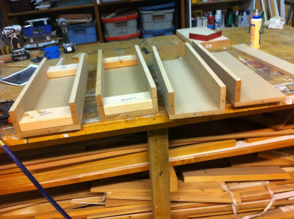

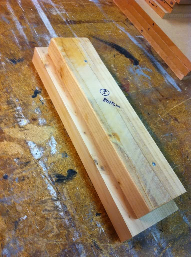

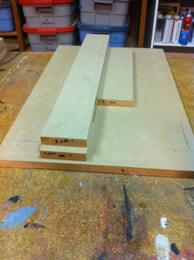

Organization was key here - we put sets like this together for each column before any construction began:
then we built the bases for each column - decided to lift the columns up about 1.5" to accommodate a little higher chair rail - also makes it easy to attach the base to the floor and just slide the column on top and screw it together

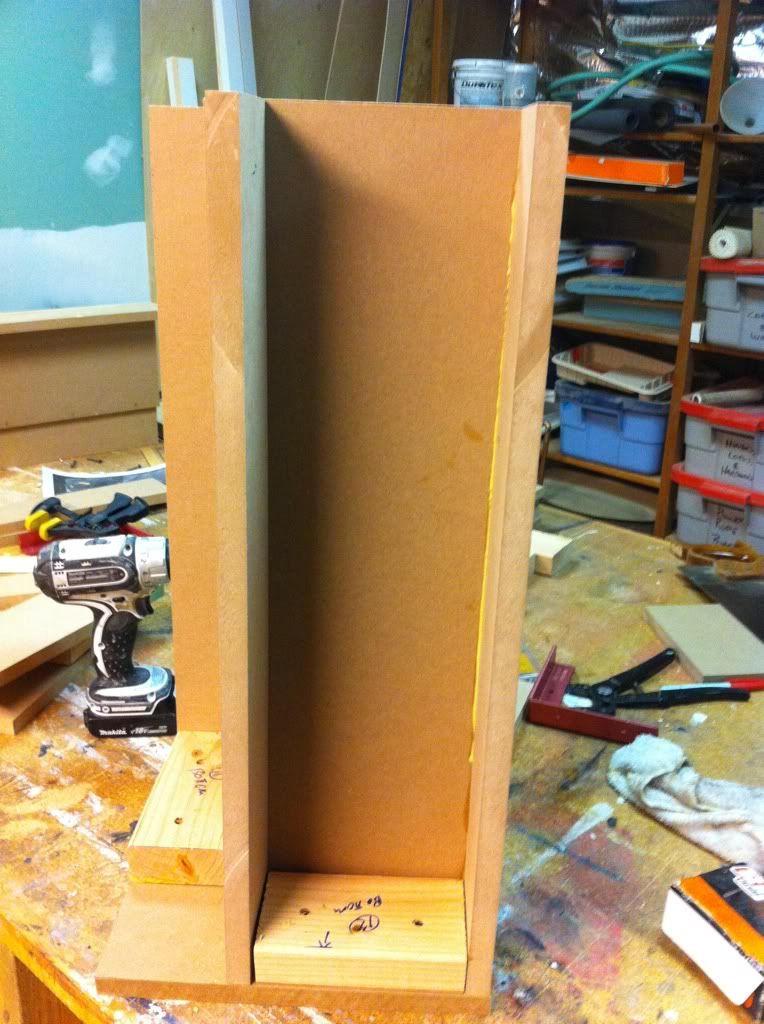

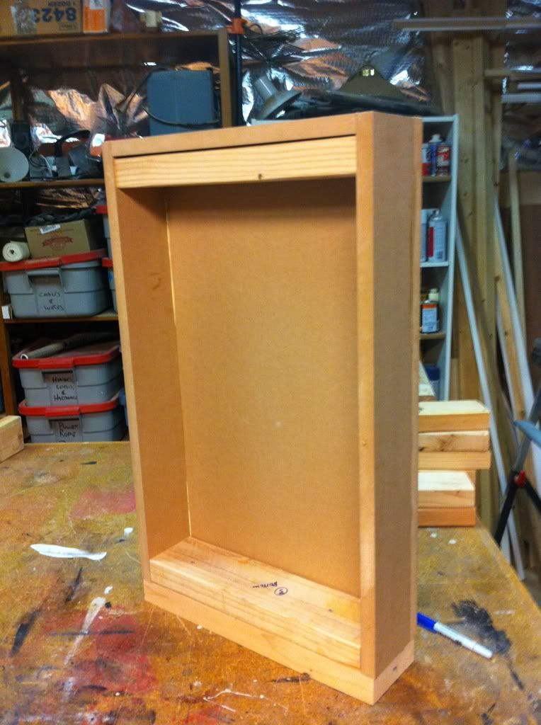

Next it was time to attach the sides and the tops
Testing the base
Once the face was attached, we could test the top mount (basically a 2x4 cut to size which we can also attach to the wall
And thats how we completed one of the first columns
Here some of the ducks all lined up

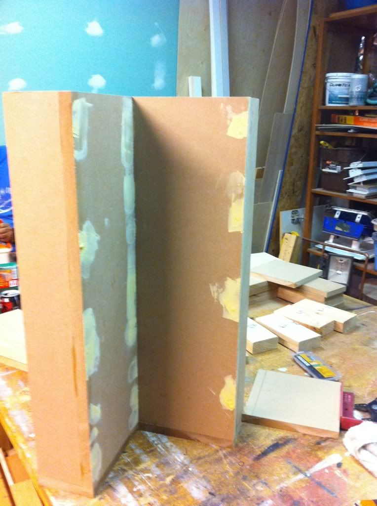

We saved the corner columns last because we knew they would be a pain
Here are the four columns ready to be built and connected into the two corners
and here they are being constructed
- we were actually able to get away with just using 3 sides (the third being a support in the rear). The top and bases for these were a little different in that we just used 3/4" MDF on top and bottom to make up the 1 1/2" lift for which we used the 2x10s on the others. This allowed us to cut a nice single piece top that will look great.
Now on to putty and sanding- this was handled by my future-brother-in-law

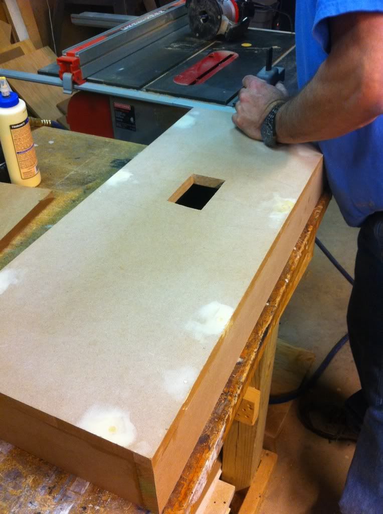

Next up - cutting out the spaces for the outlets - also handled by my in-law, he was doing a lot of this while we were constructing the columns - we were definitely all working hard and getting stuff done fairly efficiently. You can see one of the outlet cut-outs in the next pic
Finally, routing the edges to get "furniture quality, frameless" columns Here's Mr. Big smoothing off the edges on a puttied, sanded, and outlet-prepped column base
By this time it was late, and time to head home to the family for dinner
I guess I must be somewhat OCD, because I couldn't just let things be and go to bed (hence me posting now as well)
So, after hauling everything off the truck and back into the basement - time to seal everything for sanding and priming tomorrow.
Here's everyone all lined up again, this time with a solid two coats of primer, drying for the night for sanding, priming and hopefully painting tomorrow
and another pic b/c i'm so proud of keeping things going to the midnight hour (yet again) - a little bit sad, ain't it?

Yes it was a busy day yesterday with three of use working away in the shop. I pleased to report that it was an injury free day.
As we used some of the scraps from the riser to build bases for the columns we came across the plans for the soffit over the screen. Here we were planning the spacing of the framing and location of the recessed lights.
As a preview of some of todays tasks, I wonder what this might turn into. Come back tomorrow for the details

Weekend Wrap up.
Starting at 1PM today and ending a little after midnight Jesto and I launched into a Blitz of theater building activity. It culminated with inauguration of his new projector and a 120 inch wide DIY 2.35:1 acoustically transparent screen. So without further delay here is 120 inches of Megan.
All the details of the build later today.
