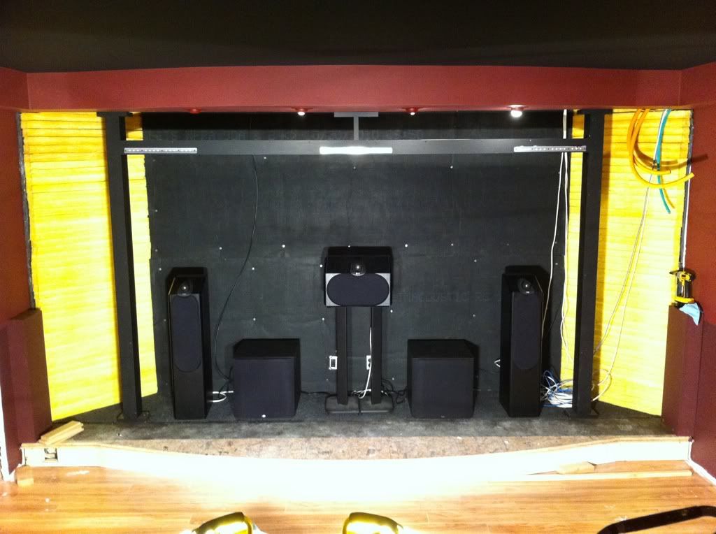

Re: the plywood- we put a 4x4 sheet up on the ceiling directly on the channel in the center back of the room. This was really the only place in the room where the projector would work (without installing it on the back wall behind the seats) - so we figured 4'x4' was a good size

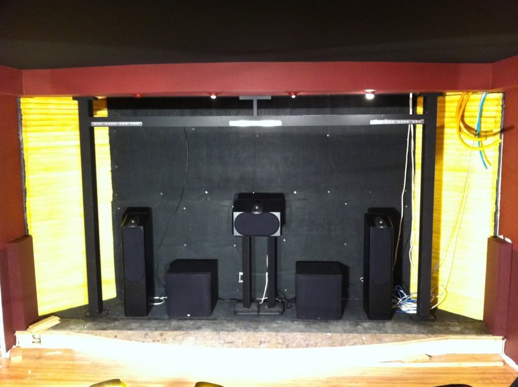

here are some pics before the screenwall went up - a couple of changes after the pic was taken
1) wires were tucked in behind linacoustic
2) L/R speakers were elevated a bit
3) all the spools were cleaned up
4) room was touched up (thanks Mr. Big!)

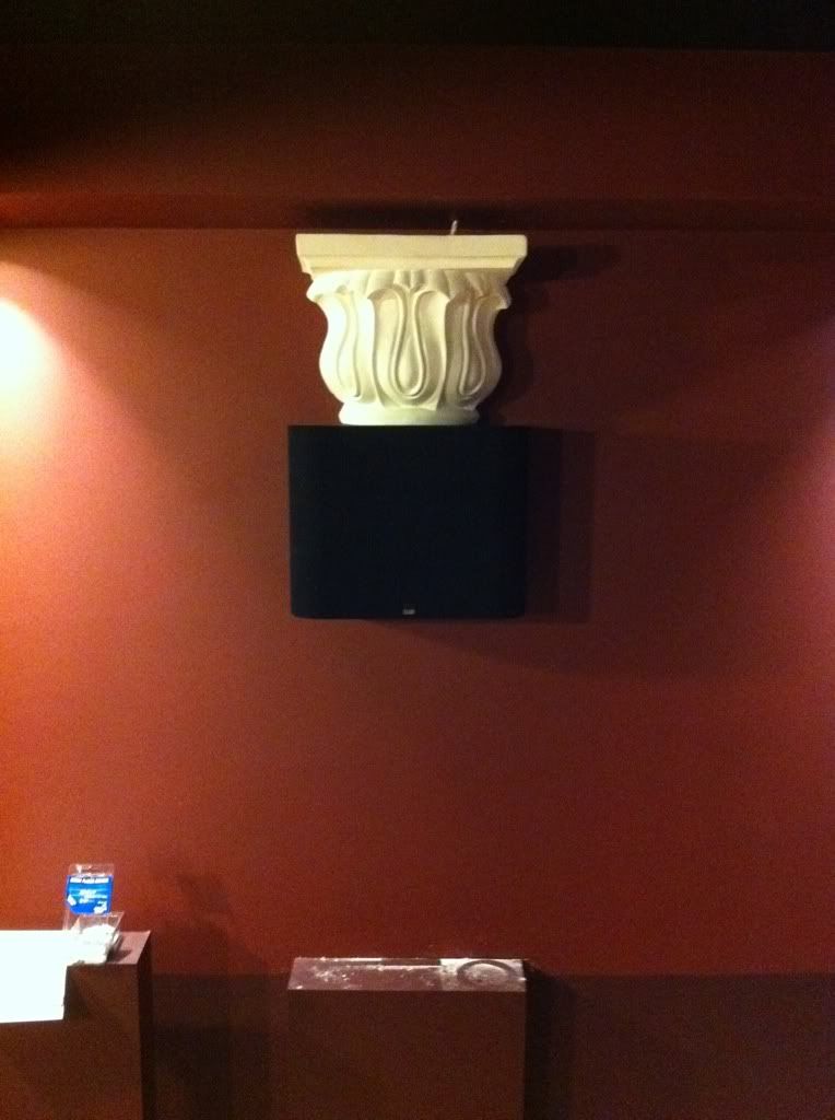

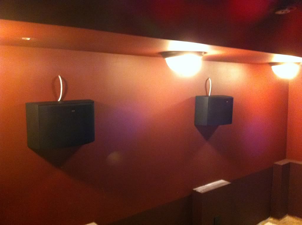

and of the rear speakers - the column capital (even if we don't use the ones in the pics) will cover the wires
and one of the sides
couch is in the room - sound is insanely good - picture is awesome - i'm THRILLED

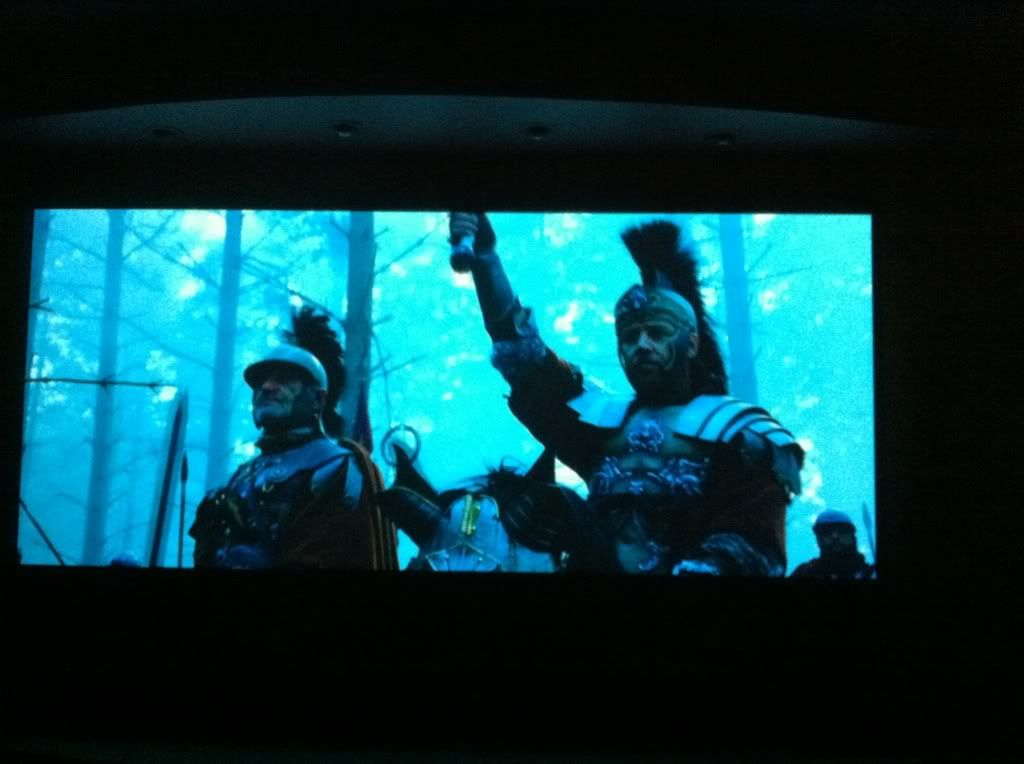

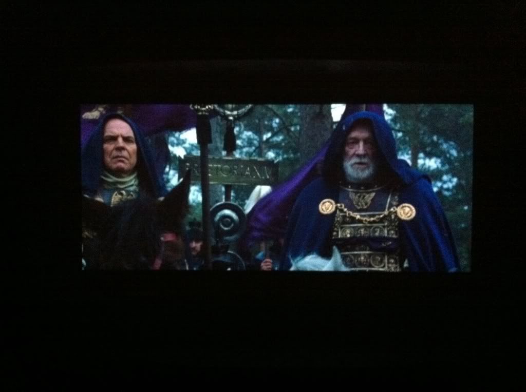

oh - and a screen shot - definitely will get a better shot with a real camera (trust me - it looks amazing)
to test - we watched the gladiator opening battle scene like 3 times

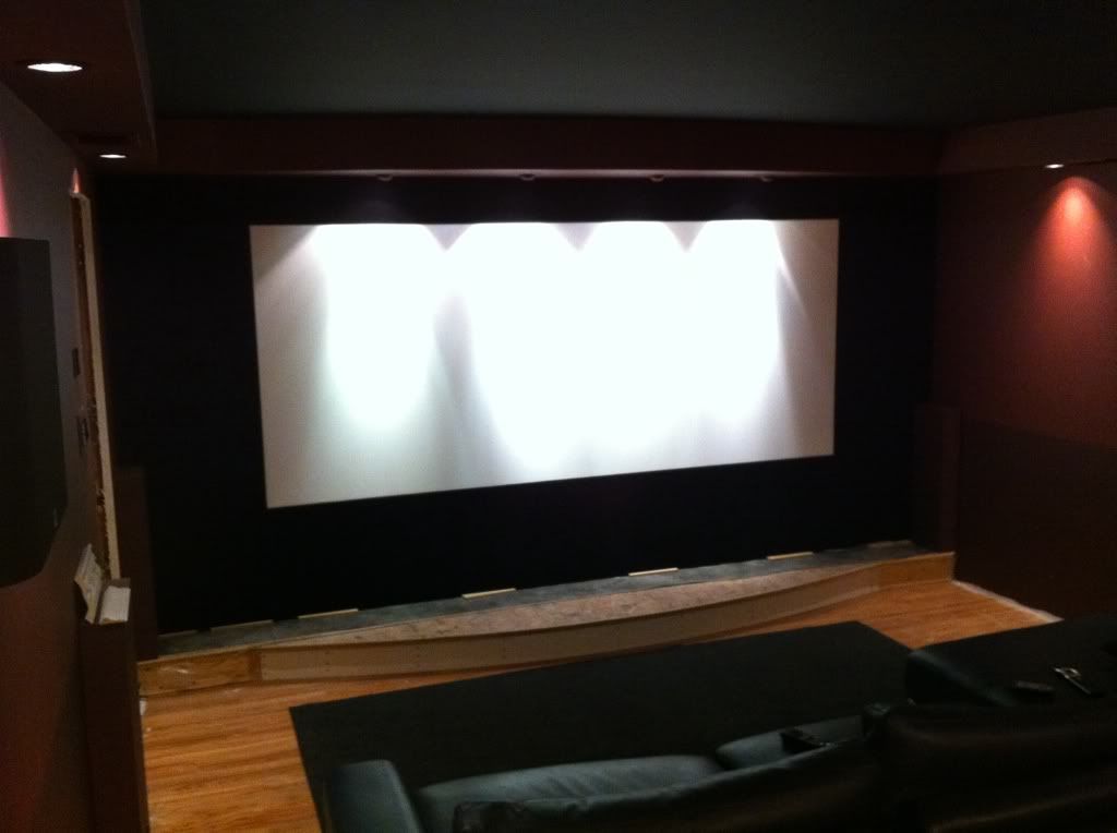

Now that Phase 1 is complete - here are some updated pics

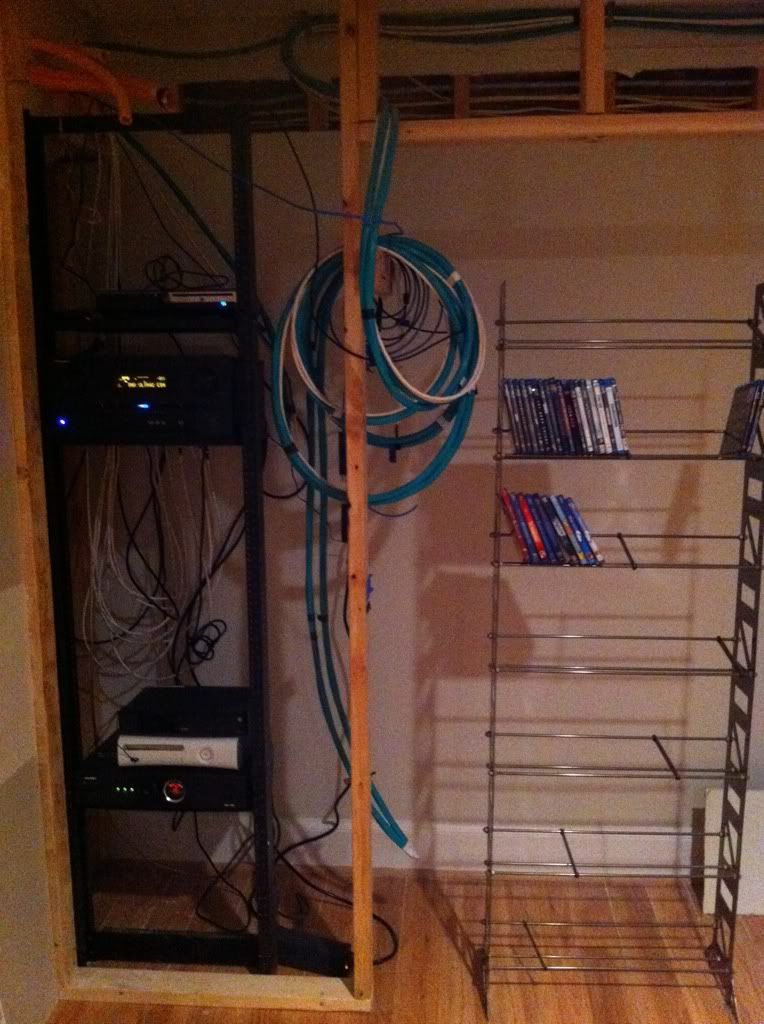

Here's the rack as set up (temporarily) - will probably still go with creating a door into the room

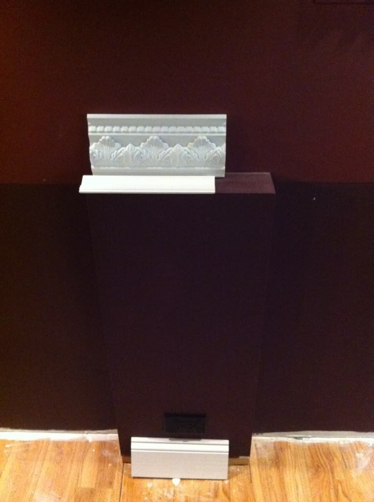

Here's the plan for the moldings - but going with a shorter baseboard so we can picture mold the column bases

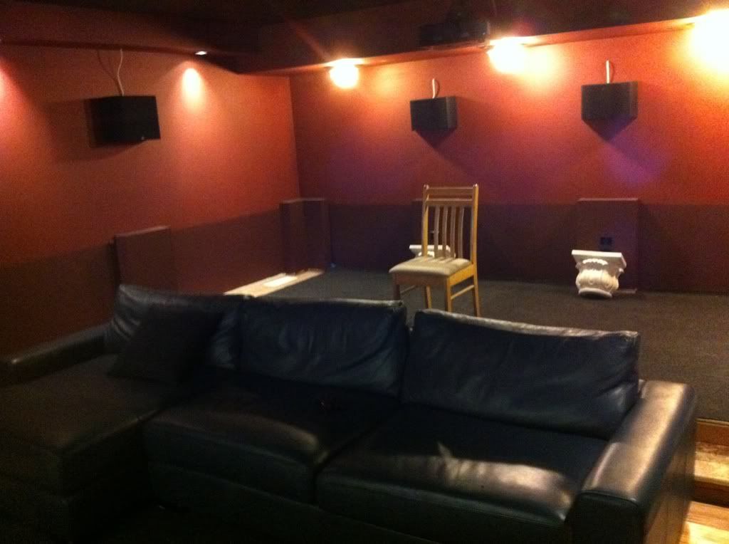

Front of the room, including screenwall, temp couch, and temp carpet
Back of the room including temp carpet
and finally - a better screenshot (i hope)
Note: loving the Panasonic - you can do split screen optimizatinos, save projection settings (currently set up for both 2.35 and 16:9)

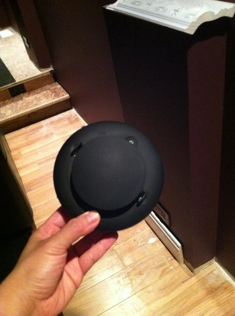

Smoke alarm installed today - ordered it from the folks that did my security system so it ties in with the rest of the house - Dude went the extra mile and painted it black for me before he brought it over - now that's the kind of service we need everywhere!
Also, step lights arrived - i'll have to paint them myself. Luckily my electrician friend is coming over on Saturday for the party - so I have a sneaky suspicion i might be getting those installed on Saturday as well I'll need to paint those black myself

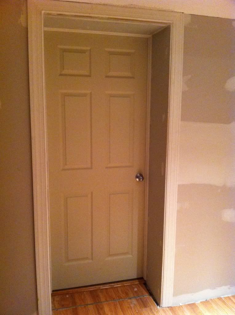

Theater has a door

The door is a 1 3/4 thick Masonite solid core Safe and Sound. Regular doors are 1 3/8 so this is a little beefier. It matches the other doors in the house. His guy couldn't get a prehung on a weatherstripped jamb so we may need to do a retrofit on that aspect.
Originally Jesto was planning on a double door entry because he had the space, but in the end decided to give this a try first and see what additional measures are necessary.
If normal theater sounds don't make it up to the second floor bedrooms then there really isn't a need for the additional door
Turns out other than that little issue of me being overzealous with the 2 subwoofers.... once the single door was shut - ABSOLUTELY NO SOUND GOT OUT OF THE THEATER - even down in the basement
I originally bought an interior door frame which turned out to be a waste of money because it was just too small. My contractor built out the door frame for the depth of the wall using 3/4" plywood, and then we put weather stripping all around the door. As i mentioned - this worked perfectly
So for now i'm thinking the single door is enough and the entrance to the theater will probably be framed with a nice curtain on the outside.
