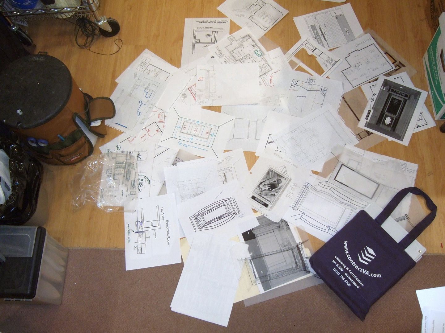

I'm so happy I got the the first Mr. Big back of the napkin (graph paper) diagram
jesto is offline

To be correct that would also be the first Post Licensing napkin! It's now more valuable.
Hey! I see MY screen wall back-of-napkin in that pile! It's upside down. And you guys wonder why it's taking me so long.
I call shenanigans!

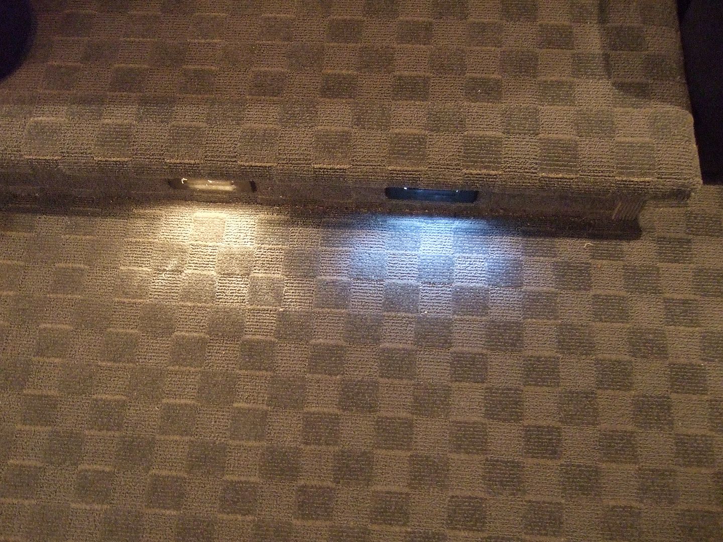

Actually I've modified my personal 120v pin bulb Halogen step lights to use a 120v LED light source. I got tired of the halogens always burning out and they ran very hot. The light I linked uses a screw in 25 watt bulb,
LED on the right.
4AlexF and DocG1914 like this.
