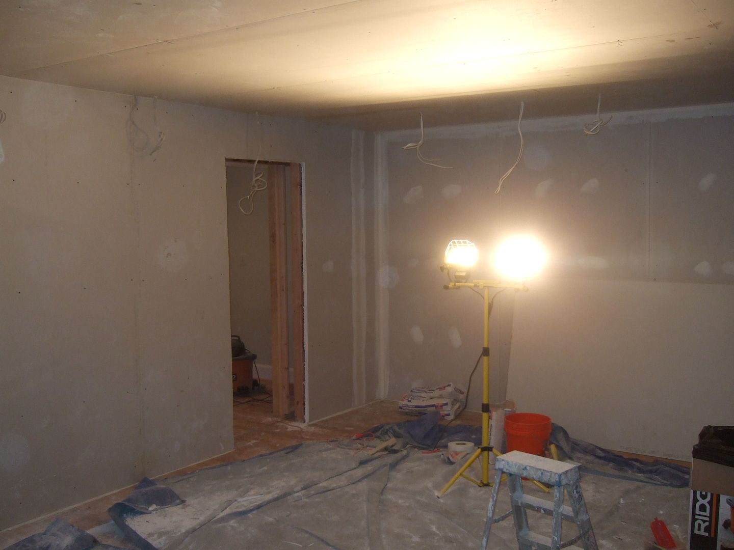

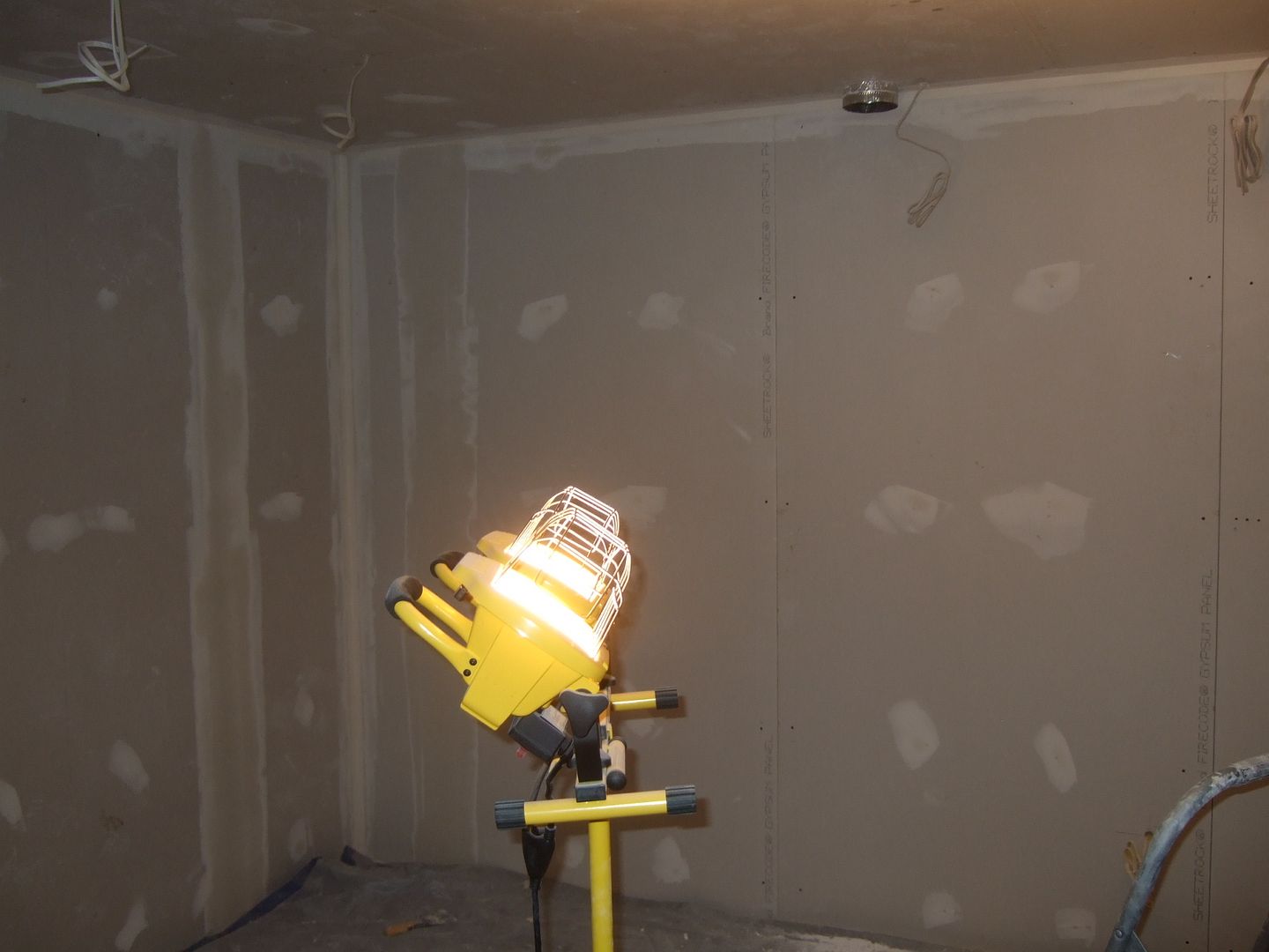

OK,
Time for an update from the office while Mr. Big is being a super-trooper and helping with the build. Feeling really really guilty that I'm not there helping - but hey, I have to work to pay for this hobby right?
Looks like the drywalling will be done today - the first layer on the walls is complete and the second layer is almost done (had to wait on the contractor to bring a bunch of additional sheets by, because as usual - i under estimated)
while waiting for delivery the mudding began
Photos are courtesy of the wife who is actually getting really excited now- mainly from the sound isolation standpoint (she keeps texting me that she doesn't hear anything), and the reality that we will have a home theater soon to watch movies in
Once again - Massive Thanks to Mr. Big for helping this all happen so quickly

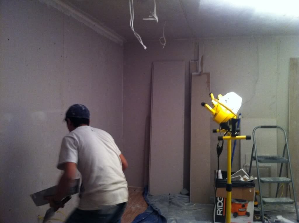

post #185 of 589 Old 04-05-2011, 01:10 PM - Thread Starter
jesto's Avatar
Posts: 200
Liked: 34

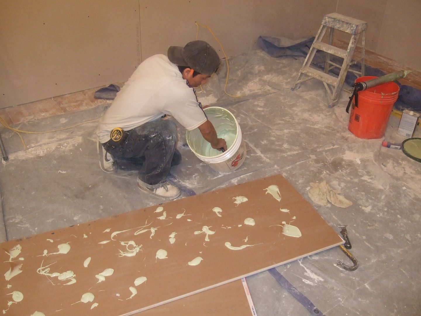

One more action shot - this is the screen wall that is getting mudded

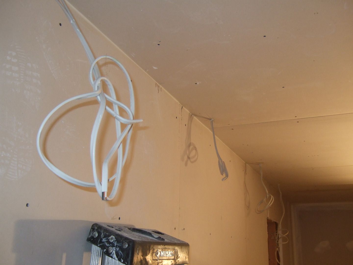

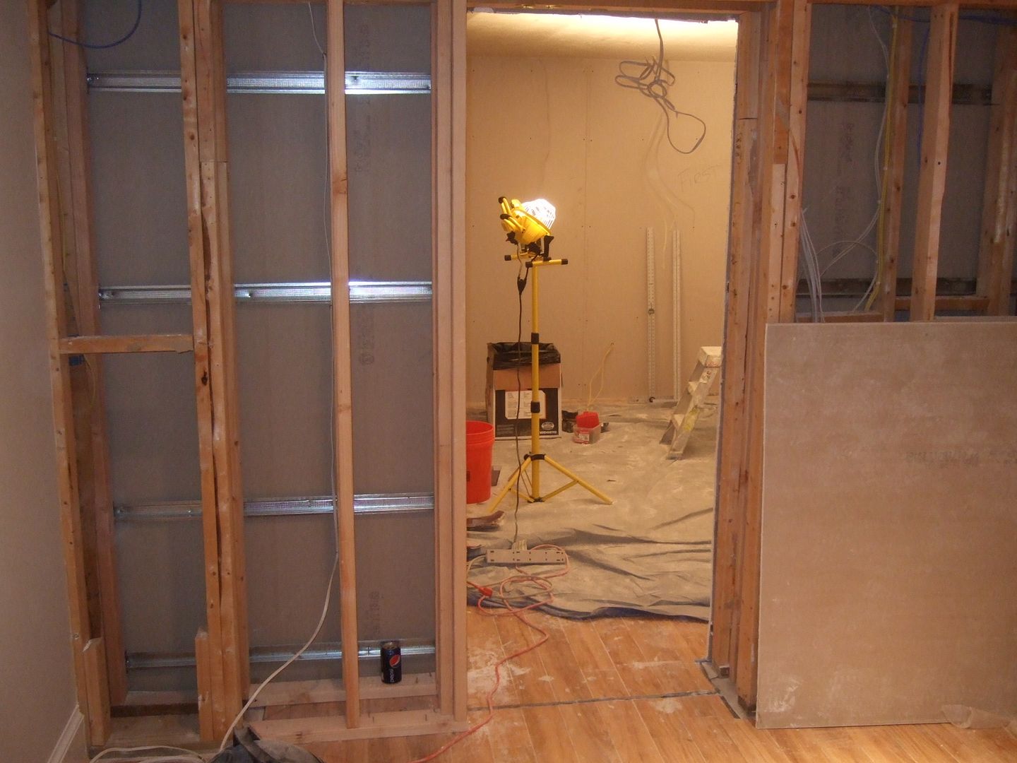

Close of day two, problem with getting more drywall in time to finish so just two walls left to go.
buttoning up all penetrations.
We are leaving two interior inside walls undone on the backside until ALL the electrical hook up is complete. That way we can back treat the light controls and house automation panel. Also pass the wires to the riser down low etc. All will sealed up tight. All outlet boxes will be inside the room. Mostly in columns. This wall ended up as a double stud wall because of the odd location of support columns and main drain stack. This way everything is tucked nicely in the wall.

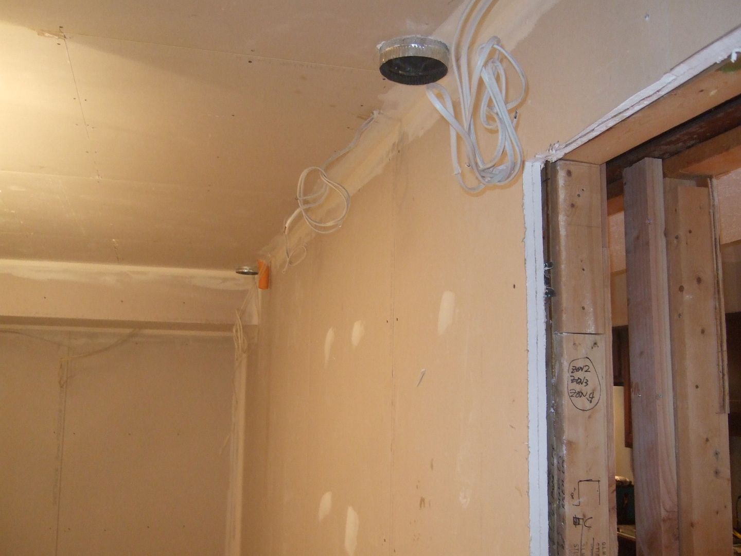

I think there was concern earlier that I covered up the projector boxes, no problem.

In case somebody wonders about what a wall does on clips and channel, It moves, probably not this much but I'm sure it must move with intense bass. Click the image for video.

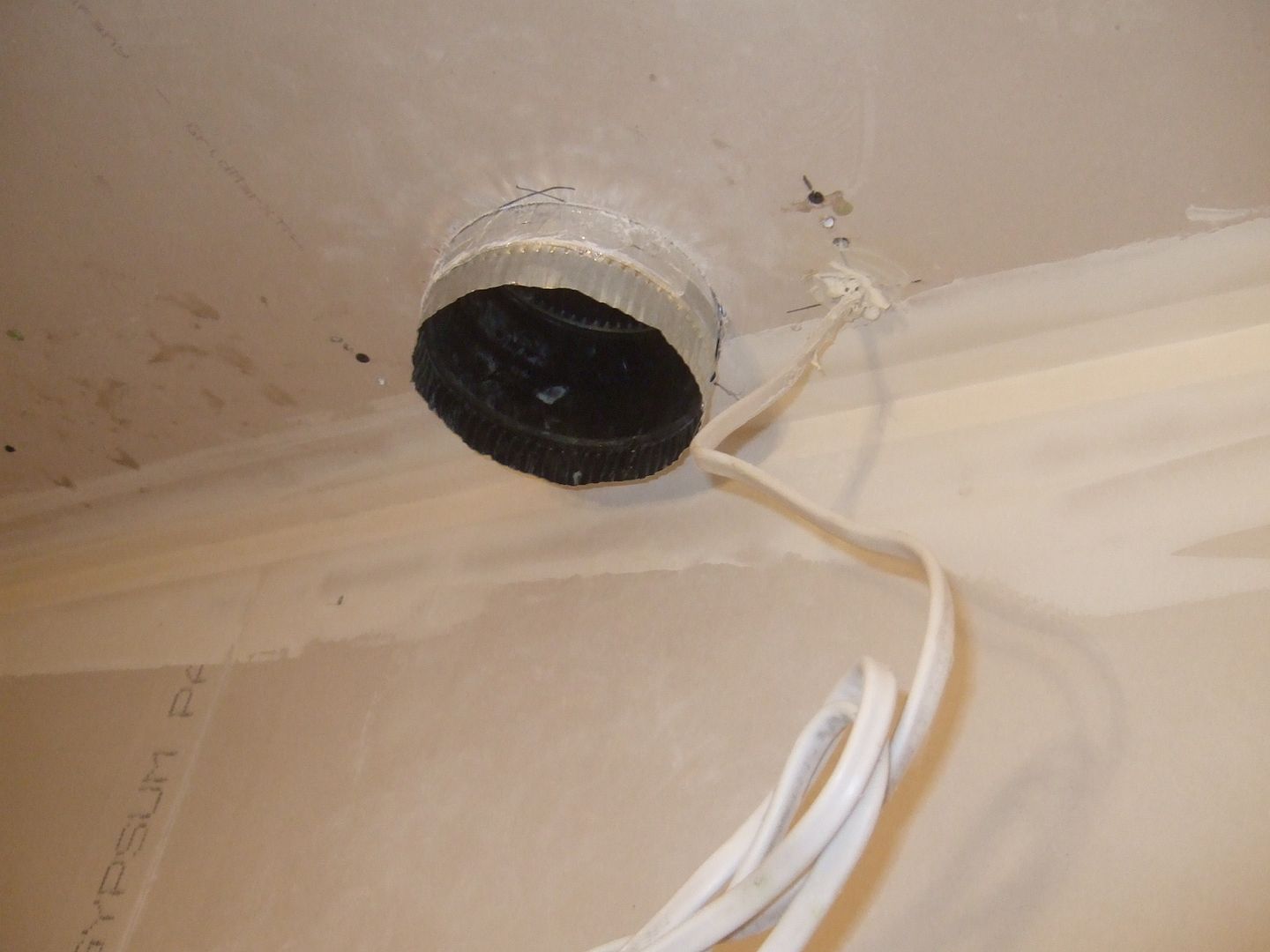

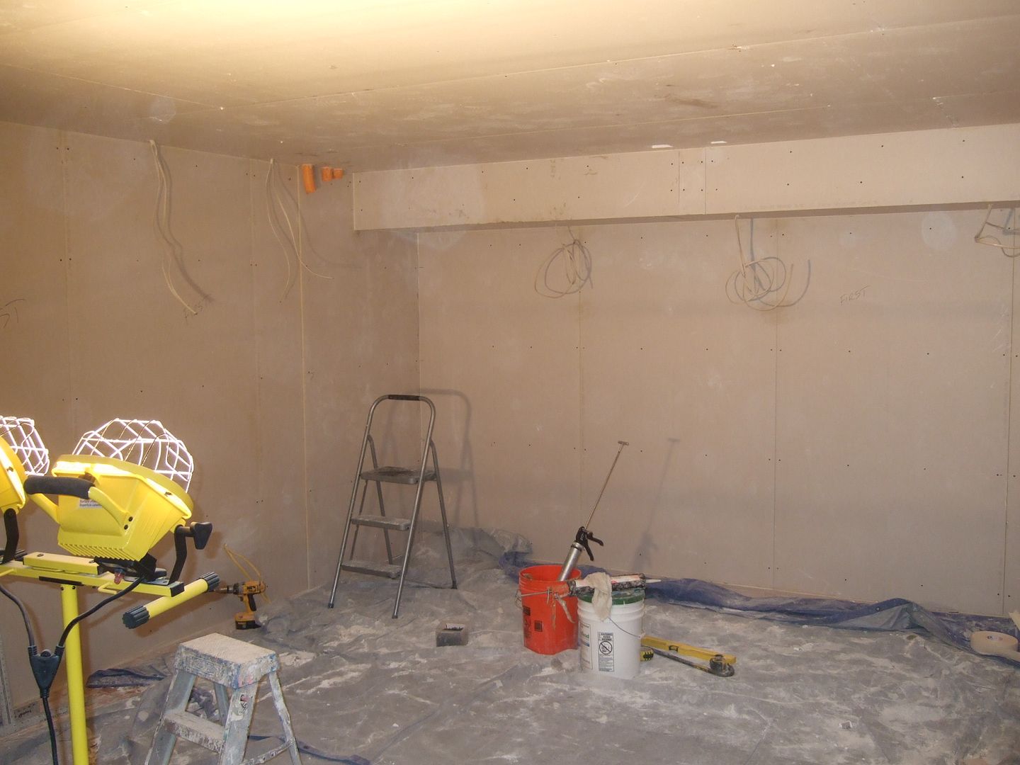

It was a special moment when I took this picture, this is the last of piece of the second layer of drywall for Jesto's theater. That is also the last of 4 buckets of GG that went into the room and Roberto had to literally scrape the bottom of the bucket to get enough.

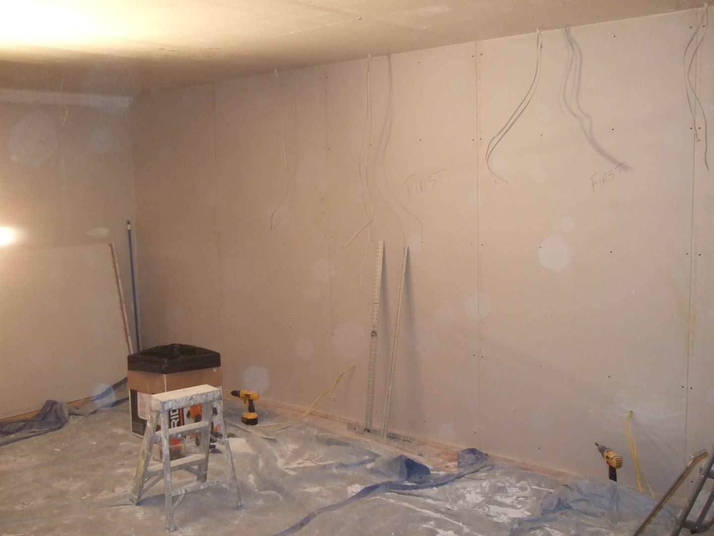

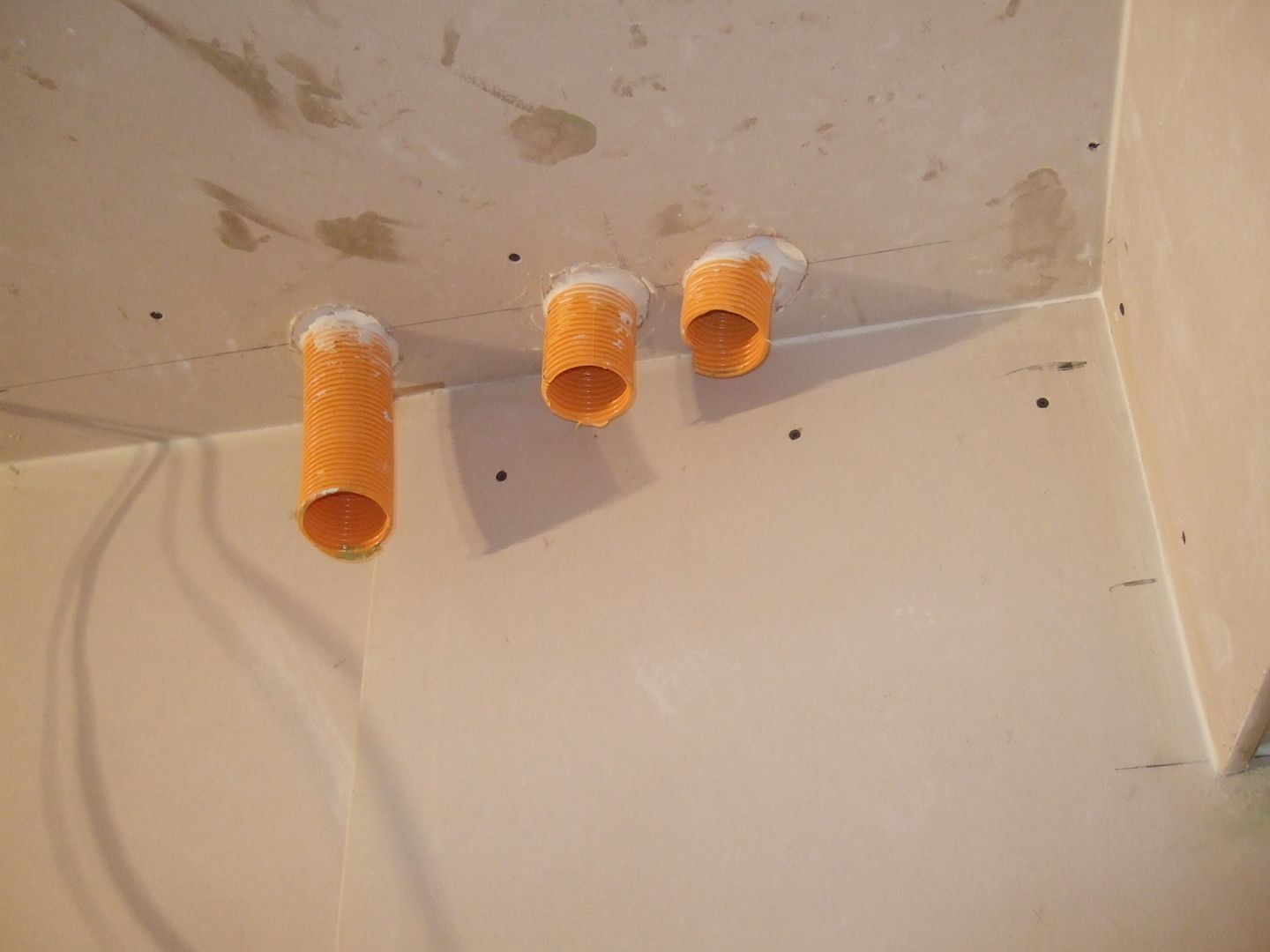

Next challenge, where did we put that flexduct in the ceiling? lucky I found my notes. Using a 6 inch metal collar to attach to flex ducts on either side of the double drywall. Inside the theater the duct will be inside our version of a dead vent in the soffit.

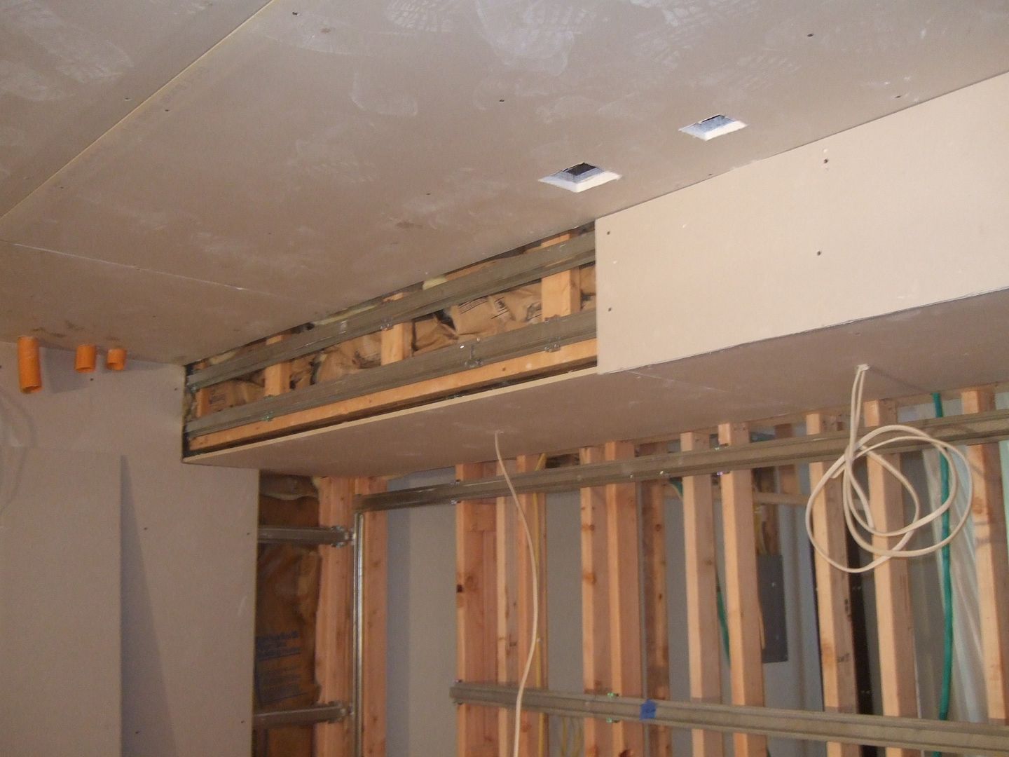

Another shot:
Taping and mudding is underway this PM.
By this weekend there should be a nice room ready for the fun part of theater building.
this makes me happy
this makes me very very happy
