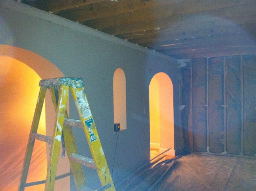

Attached are images from the previous thread with images of the initial build plan and a layout of the basement for the wiring
And an image of the room to be gutted and rebuilt

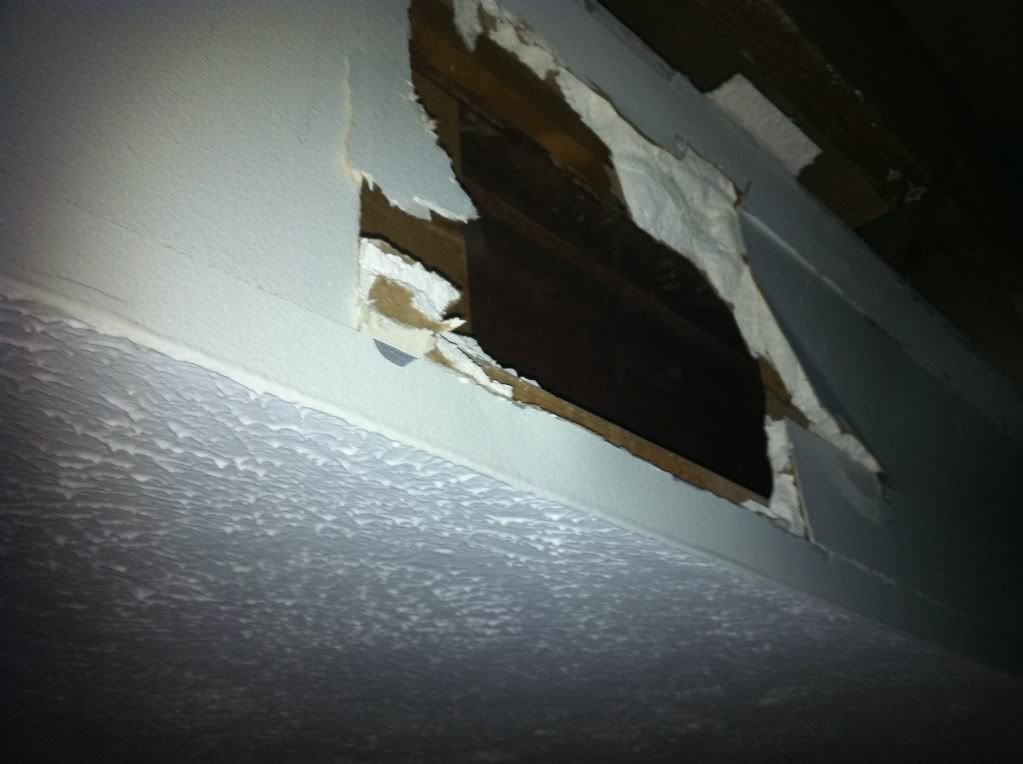

Sunday was a really fun day
  • Managed to get 5 drops up into the attic before we ran out of cable
  • Salvaged 2 lines for one drop to the rec room and one drop to the room directly above the garage
  • On impulse I bought a spool of 1000' cat5e from home depot (not good quality) and we cut it into 9 cables (5x100 and 4x125) for a run to the attic as well
and then..... we had a couple of mishaps with the electrician up in the attic
  1. Foot came down in the wrong place up in the attic
  2. Body came down in the wrong place in the attic
Luckily everyone was ok, he got his shoulder around a joist so it was an initial fall and then a short drop to the 2nd floor hardwood - 3ft over and it would have been 2 stories down onto marble
I've got to say - the dude was a trooper - he absolutely insisted on getting everything up there even after the fall. After that - i insisted on calling it quits. We had to tape up the ceiling b/c that spray insulation really makes a mess.
The smoke alarm is no real loss - we were planning on pulling that out anyway and using the wires for the new security panel and then using the cat5 up in the attic to hardwire new alarms
With a baby in the house wiring became second priority - on to my first drywall experience
End of the day - everyone is OK and everything is spooled up in the attic waiting to get pulled down into the bedrooms

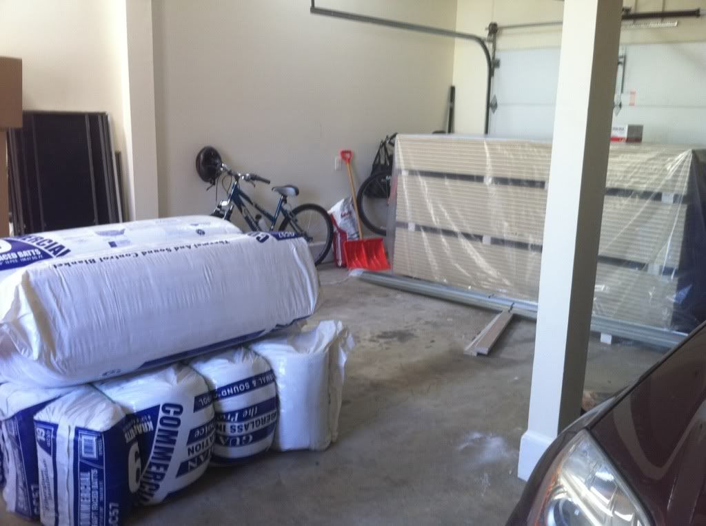

It's been an interesting couple of weeks, and unfortunately not too much has been done on the HT build front
Turns out my wife got a hold of my contractor and decided to completely remodel two bathrooms - so that's slowed things down a little, but the good news is:
1. Whole house wiring is done
2. Patch panel is 90% complete (just need to finish off some coax terminations)
3. Network is up and running (boy is it fast!)
4. Ran 7 additional Cat6 cables through the main run for future touch panels and security cameras
5. Ran 2" conduit to the attic, and 1.5" and 3/4" throughout the basement for future craziness
6. Soffit covering the wiring is complete (including access panels)
Regarding the fireplace - basically it needs to be rebuilt - which isn't necc a bad thing as it will allow me to make it smaller, put a drywall backing above the mantel, and install all the electronics appropriately.
Here are some pics of the patch panel, soffit and conduit
- the hanging loops are the aforementioned future runs for cameras and touch panels for the exterior, first floor and basement
- we also added some decent access panels for any crazy ideas i get in the future
This weekend - DEMOLITION OF THE OLD HT ROOM BEGINS

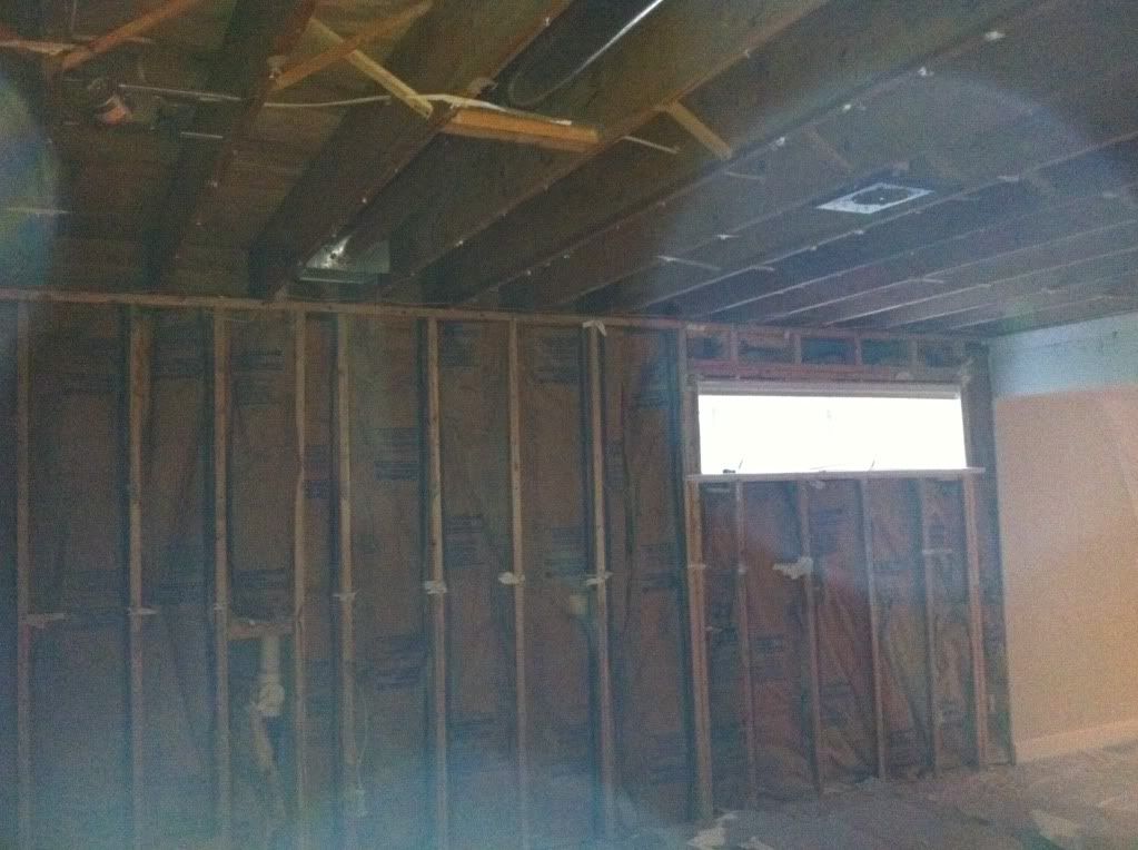

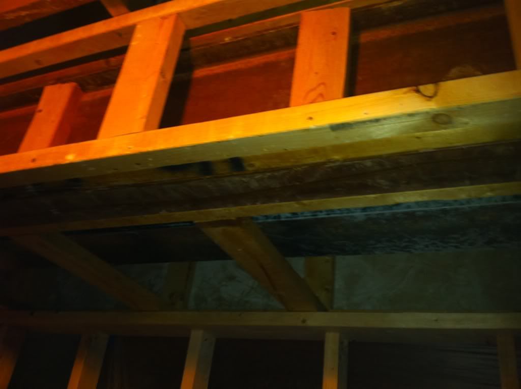

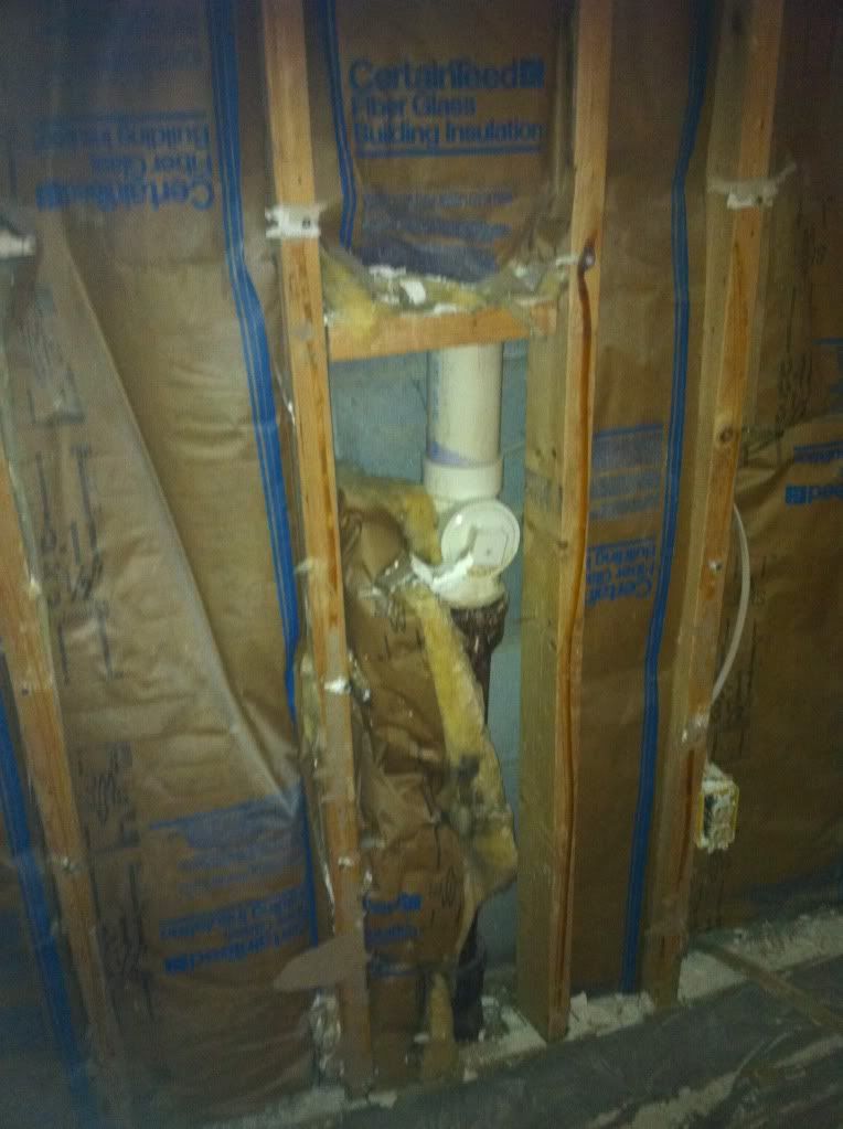

Well - Demo has begun and things are looking actually better than expected.. none of the issues below are really that scary
Looks like the exterior walls are decoupled, with pink stuff in the studs (r-13) and old school white styrofoam against the foundation
HDvid - thanks for the suggestion - see below (BTW - very impressive setup)
Sorry about the poor image quality - just got home and iphone was what i had in my hand
Before
Progress as of today
HVAC Issue #1 - This runs up to the living room
HVAC Issue #2 - this is the vent into the room - should be easy enough to shorten and keep towards one end - runs straight to the utility room so i'm not too worried about flanking here
Plumbing Issue #1 - this is the drain on the exterior wall - I believe it runs up to the master
Plumbing Issue #2 - no idea what's behind these walls - right now it looks like some vacuum tubes, some plumbing, and probably some structural stuff
Structural Issue #1 - Window
Structural Issue #2 - Steel Beam

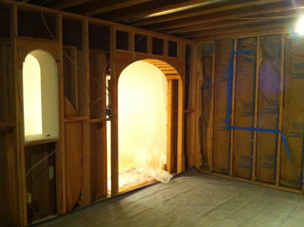

Status Update:
- Room is now completely gutted - here's what we found (pics later)
- 2 Water drains - we will cover and just mark locations (just in case)
- 2 steel beams, 1 horizontal along the future back wall, 1 just above the left wall
- 2 support posts
- 1 vacuum tube for the house vacuum system (will be relocated to the exterior wall)
- 1 double stud wall about 70% framed for the left hand wall - we'll frame out the rest of it
- 2 air supply ducts running up to the 1st floor
- 1 air supply duct running into the HT room
- Supplies are ordered:
- Soundproofing material from Soundproofing Company - thanks John and Ted!
- 3 pails of green glue and applicator
- acoustic caulk
- clips for walls and ceiling
- acoustically transparent tubing to replace supply ducts
- Building materials
- 70 sheets of drywall (planning on adding mass to the subfloor above)
- 500 lf of hat channel
- about 600sft of insulation (R-19 pink stuff)
- 1 box of screws
Overall - everything is a go for the original plan of a 14'x20' room so all is good - soundproofing supplies should arrive thursday and drywall / channel should arrive friday
Short Term Next Steps:
- frame out the rest of the room
- add mass (gg/dw/gg/dw) to the subfloor above
- add romex for additional power lines and lights
- insulate the room
- install clips and channel
- drywall
- build stage and riser
- order linacoustic and OC 703 for screen wall and bass traps

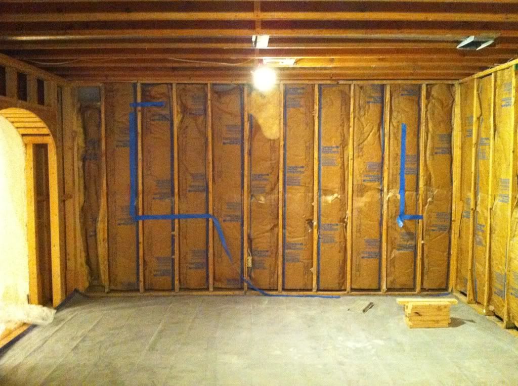

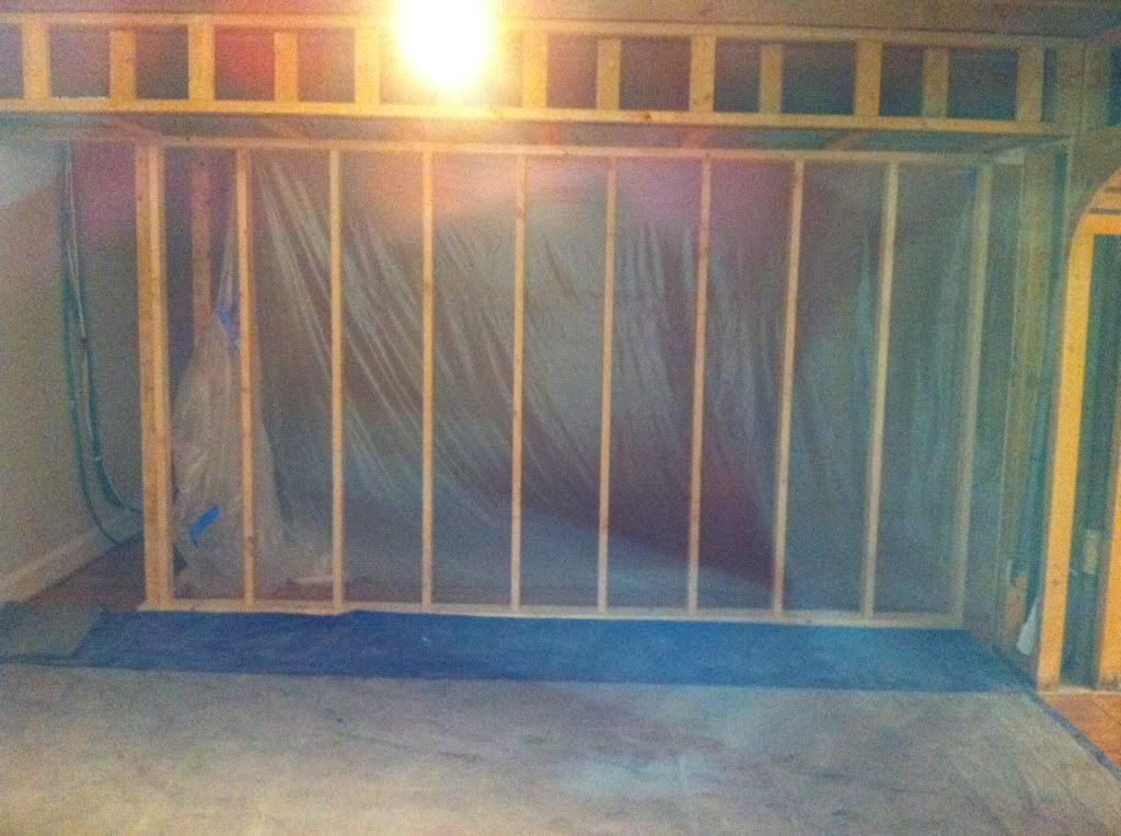

so the blue tape doesn't stick so well to old insulation paper - but this is the obligatory start to the screen on the wall - 130"
Nice double stud wall with lots of architectural / drainage goodies in there - need to build the door frame there and close off the arches
Back wall - framed out start to staggered stud wall . We were actually able to get about another foot in depth. All the way on the left is where the rack will go and will open into a dedicated closet in the room behind.
Rear bulkhead - I-beam and then a supply duct to the office upstairs and some dead space - will isolate around the beam with clips and stuff everything full of insulation
thats it for now... supplies come thurs/friday i hope - need to figure out the electrical - it's actually stressing me out

Big - not a bad option at all - really need to figure this out ASAP - round #1 of supplies delivered today
- 70 sheets of 5'8" drywall to buff up the floorboards in the ceiling and dd the walls
- 500 lft of hat channel
- lots of insulation
