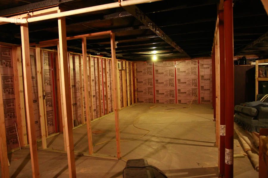

post #5 of 45 Old 02-12-2011, 05:07 PM - Thread Starter
swan man's Avatar
Join Date: Feb 2011
Location: Northern WI
Posts: 53
Here are pictures of the basement where I am going to build. Also pictures of the ceiling. I guess I could probably mount isolating channel up there and then the drywall. The ceiling has those metal beams and then 2x6's over them for the floor above. The 2x6's are fully insulated, they do that because a lot of these homes go on slabs or crawl spaces.
The shelves in the corner are on wheels and can be moved where ever.

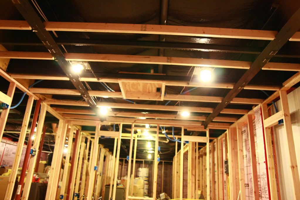

post #7 of 45 Old 12-01-2011, 06:34 AM - Thread Starter
swan man's Avatar
Join Date: Feb 2011
Posts: 53
Here is the start of framing. My bother in-law has been doing some work on the weekends. He is planning on finishing the framing this weekend. One thing I don't like is how the wall is anchored to the ceiling. I think it will transfer the sound too much. Now, I'm not trying to make a quiet room, but I think being anchored like this will carry the low frequencies through the whole house. I'm looking at using rubber isolators for this unless there is a better way. Unless by having a drop ceiling there won't be a noticeable difference? Maybe then this mount is fine?
swan man is offline
post #8 of 45 Old 12-02-2011, 11:38 AM - Thread Starter
swan man's Avatar
Join Date: Feb 2011
Posts: 53
Any thoughts? If the drop ceiling is going to negate the benefits of the isolators I might as well not do it. My brother in-law will be framing tomorrow so any thoughts would be appreciated.
swan man is offline

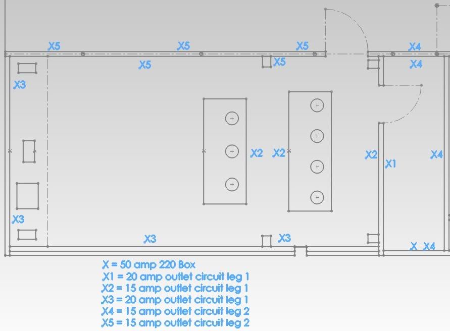

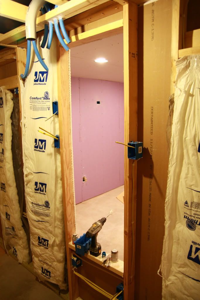

Well the rough framing is done and I am starting my electrical wiring, here is my plan.
The X1 circuit will power the Component rack.
For the X2 circuit one outlet will feed a UPS that feeds the projector in the ceiling and one is going to be in the front of the riser. I am also going to run hdmi and component to the front of the riser. I am also planing to have 4 aura bass shakers in the riser.
I am wondering if there will be an issue with those connections due to the vibration?
I would love to hear from someone.

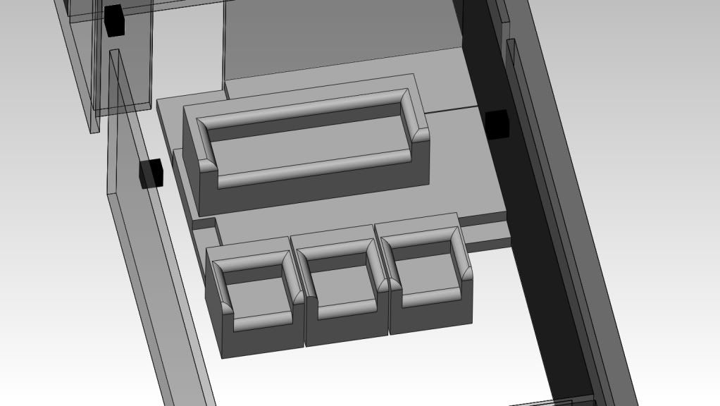

Thanks for the input Tom, I like the look of drywall better but I don't even know how I would go about doing it with that steel floor.

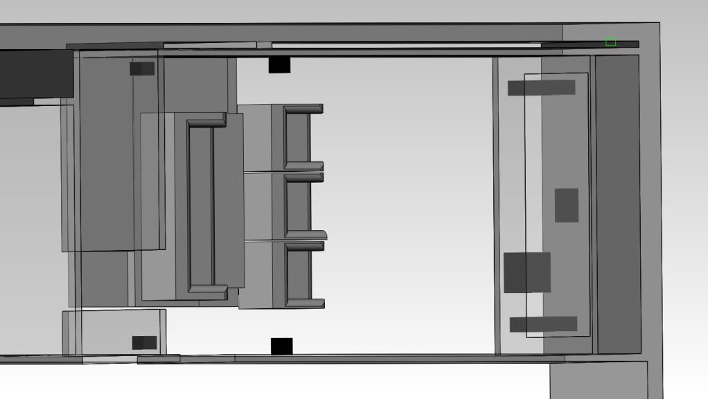

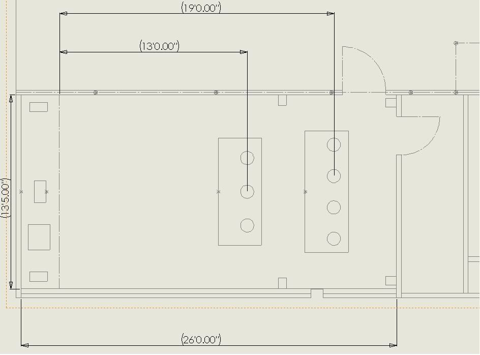

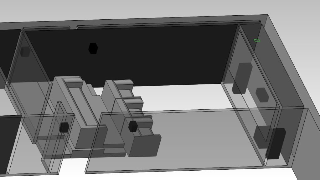

Here are some photos of what I am planing with the room and riser.
I am not sure what I want to do with the space behind the second row. I was thinking of possibly a bar and stools like some others on here have done. In the pictures I have the back part of the riser as a separate piece from the riser under the seats. I want the riser under the seats to be able to shake as much as possible.
I wanted to do pillars to hide the speakers and break up the room a little but I think the walk way will get to tight. Right now it is 25" from the seating to the wall. What do you think? Would it be worth it to make the seating areas smaller to allow for pillars on the sides? The speakers I am using are 9" deep.
Also any ideas to make a drop ceiling look better? I was thinking off adding soffits on the sides possibly.
Also as you can see in the pictures I am Leaning towards 142" wide Scope screen.

I've seen black drop ceilings and they seem to just disappear. Your rear surrounds are to close to the side walls, you want sound to come from behind you. You already have ones at the sides. They could be 5ft appart. I understand you have that door in the way. What is that room behind the theater for? Equipment room? I would move that door next to the theater entrance door if you can. The space behind the rear seats is a good thing. I'm not sure if you have support columns in the way. You could get by with a narrower door to the equipment room as well. Soffits can be visually appealing. The 25" number is a little crowded, you could scoot the seating closer to the opposite wall maybe 5" to help. I know others have done this to make for a larger walk way where you enter the room. Columns are a nice touch as well but your room is narrow so I wouldn't go to deep.

I would agree with Tom. If you're not looking to do significant soundproofing, than make it easy on yourself. If you'd like a drop ceiling, that's fine, of course. Just save yourself the effort of decoupling etc. You will not see the benefits of doing isolation techniques.

You Could just go with a 5.1 setup, sometimes less is more. The rears are mono in a 7.1 system you could use one speaker also. Anyway, back to the room. Your riser could go wall to wall and you could put a double step platform outside the theater if you have the ceiling height for the door or you could slide the theater entrance forward as you suggested to in front of the front row and the riser should still go wall to wall. With the riser wall to wall I think your 25" walkway becomes less of an issue, especially with the entrance in the front.
That screen is huge, you're going to need a light cannon to light up that size, especially since some of the light gets lost using an AT screen and bulb dimming after a few hundred hours.

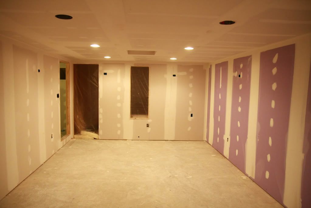

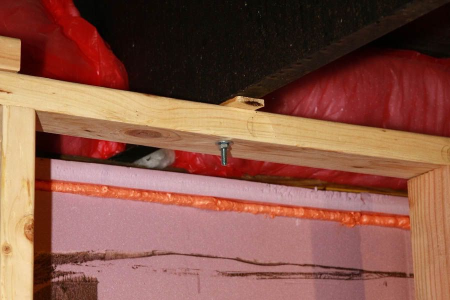

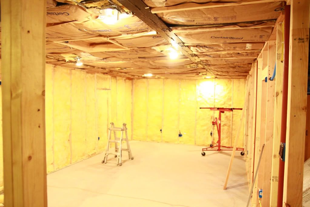

Well it has been a while since my last post, but the good news is that there has been progress. You all talked me into doing drywall even though it was a pain in the butt to frame up, you can see how I had to piece the ceiling together.
I've gotten everything insulated, there is more insulation in this ceiling then there is in the roof of my house
And here you can see all of the drywall in the main room is up.
Here is a close up of the sunken projector mounting space, the lower opening will be an outlet and the upper is a tee into the 2" conduit that runs above.
And here is an image of the electrical room, I plan to wait on sheet rock in here until everything else is done, that way I can make modifications easier.
I have a couple of other things to finish in the basement before getting it all tapped and mudded, so that will probably be in the next 3 weeks.

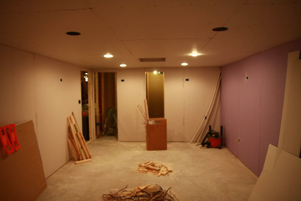

Well, the drywall finishing is done.
Screen wall
Back wall
Everything is also primed at this point, but I didn't get a picture of that. The ceiling has its first coat of black. I used the Pittsburgh paint "Grand distinction" as black as I could get it. I was really impressed with the coverage. I was almost going to leave it with one coat, but I have the paint for a second so I might as well.
I have also found a theater with a partial stage, the Ortheum Theater so I will go ahead with that plan.

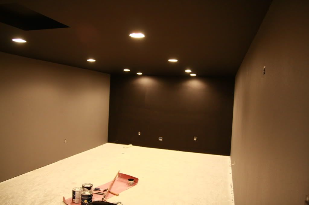

It's amazing what a little paint will do for a room.
The ceiling and front wall are black and the walls are gray, they look kind of brown in the pictures but they aren't in person.

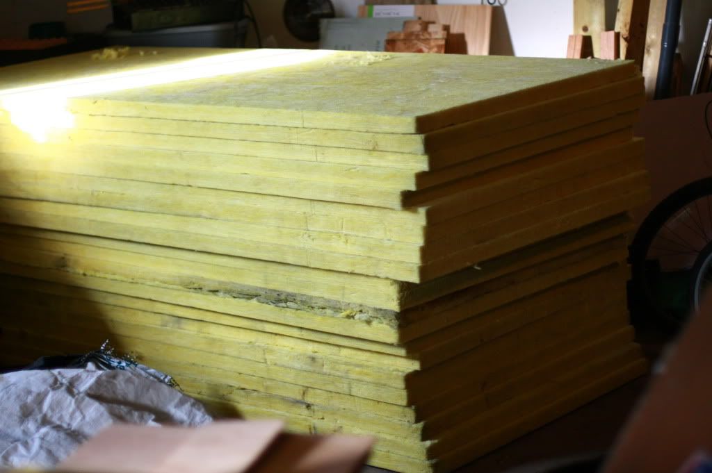

And here is my insulation for the front wall and traps. They are 4x8 sheets 2in. thick.

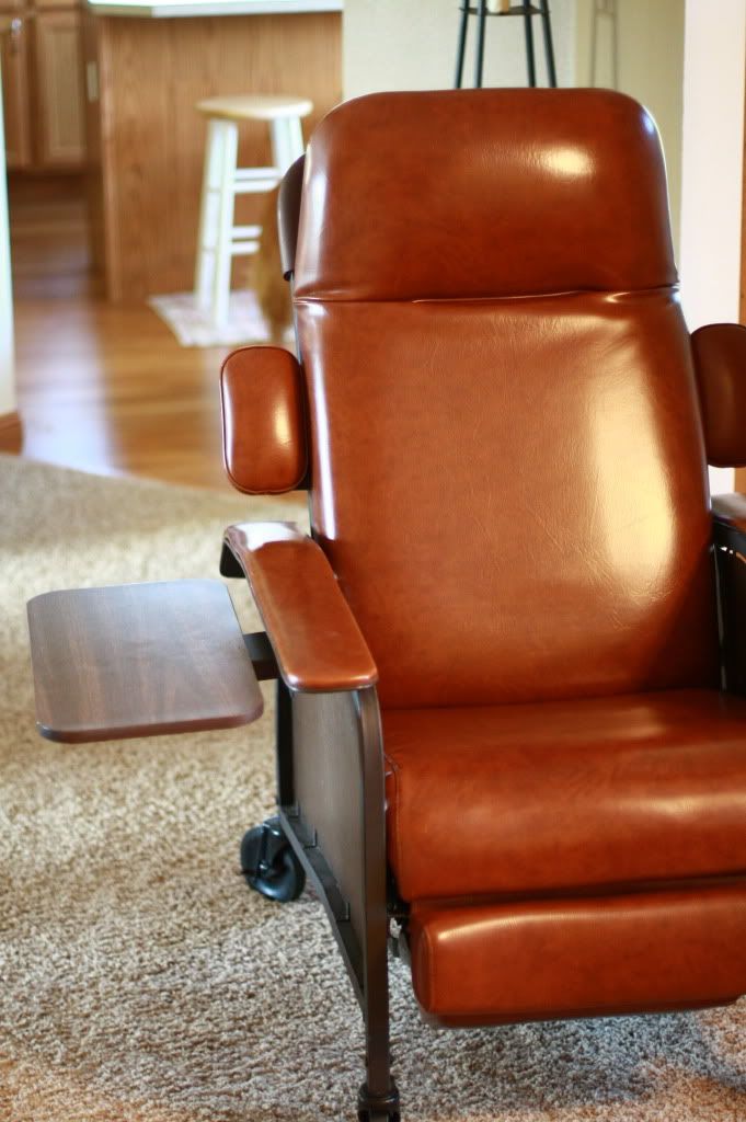

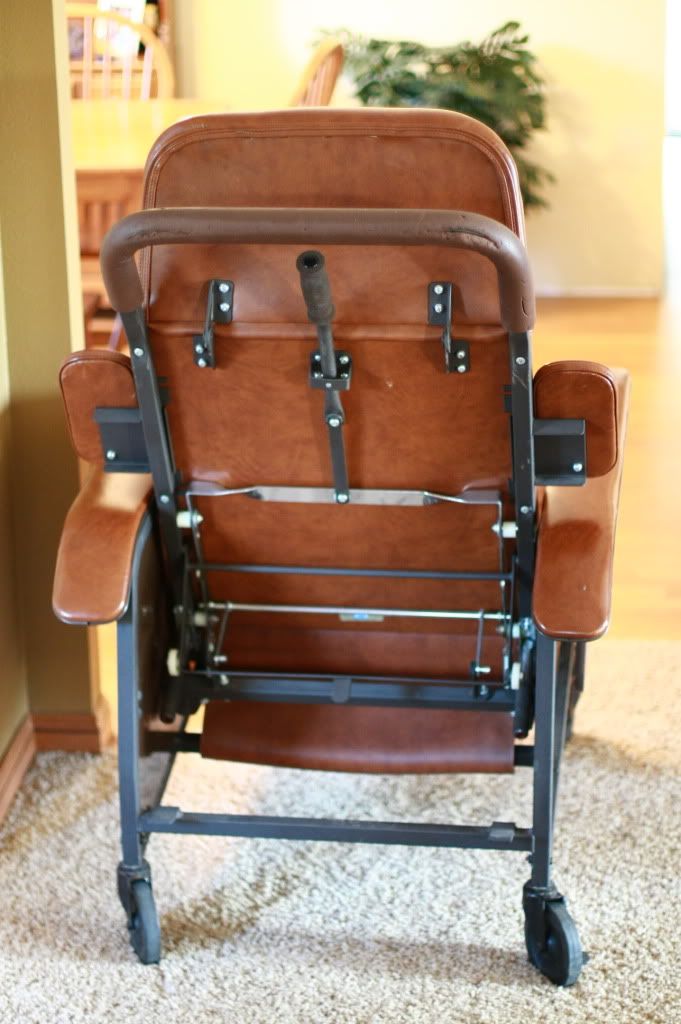

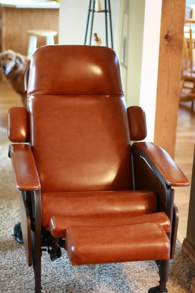

Now while my wife was shopping garage sales she bought me theater chairs. There were $15 dollars each. I think I can make them work but I'm not sure if I should.
They are pretty comfortable, now for the interesting part, they are clinical recliners used in the medical field. Look at the back.
I like the fact that they are comfortable and cheap, that frees up money for a projector sooner. But I'm not sure if I will be happy long term. I guess I could always sell them later and upgrade to something else.
What do you guys think? I would remove the wheels and make legs. I also might re-fabricate two of them to sit together as a love seat.
The only real downside to the seats as far as function is that the back is pretty high. It's about 3 inches higher then my ear level and I am 6' 3".

post #24 of 45 Old 05-22-2012, 07:14 PM
Bryceo's Avatar
Join Date: May 2012
Posts: 125
Looking good bud keep up the great work

post #25 of 45 Old 05-22-2012, 07:28 PM
Spaceman's Avatar
Location: North Houston
Posts: 2,014
Mentioned: 10 Post(s)
Quoted: 43 Post(s)
Liked: 150
Pretty good deal for $15 but movie watching should not feel like a trip to the dentist.

post #26 of 45 Old 05-22-2012, 07:49 PM - Thread Starter
swan man's Avatar
Join Date: Feb 2011
Posts: 53
Yeah they do look like dentist chairs don't they. Hey the dentist isn't so bad when they give you the laughing gas "Nitrous oxide". Maybe I will have to include that with the theater.

post #27 of 45 Old 05-29-2012, 09:35 AM - Thread Starter
swan man's Avatar
Join Date: Feb 2011
Posts: 53
OK, now you're really starting to gross me out. You're making it hard for me to justify using these chairs. I know I wouldn't if money wasn't so tight.
I guess I would rather have these and be watching movies then waiting another year to save up money instead.

Well now that winter is here I can finally get back to the theater room, although I have accomplished a few things in the time in between.
Here is the front wall insulated
And here are pictures of the riser
And here are pictures of my semi-dead vent. I figured it was good enough considering the room isn't very isolated.
This is were the dead vent is exhausted
Here with the rest of the duct liner
Finally it is closed up here minus the access panel door
