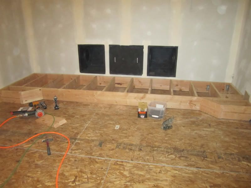

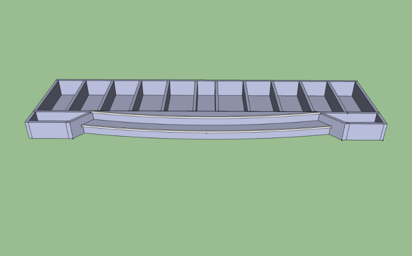

Brought home the wood for the stage. Thought I needed a better plan than just winging it, so I sketched up some dimensions.
One question I have is how much of an overhang does everybody usually leave on the top and on the steps? I planned 3/4" but was wondering if that is enough.

Do you plan to add a bullnose to the edge or use a router to round over the plywood? If you're using a router to trim it down, I would say you need at least double that - maybe even 2". (I think I saw a 2" overhang in some plans done by Dennis Erskine, but I'm not positive.)

Yes I was planning on rounding over the edges with a router. you may be right and 3/4 may not be enough. Stair treads are usually around an inch but on the stage I only really care about how it looks. I'm curious what others have done on their stages. I've looked at a lot of stages in the threads but none that I can find really seem to give any dimensions.

Stockmonkey how high will your stage be, are those 2x10's you're using? Your build looks great so far.

Yes they are 2x10. 2x10 are 9 1/4" so with the 3/4 flooring it will be 10" high. Here are the dimensions of the stage. I made the top "step" the same width as the space between my soffits so they will match up. The bottom step will be wider than the soffits above. Most stages I've seen have a smaller peice on the sides, but my soffits are fairly wide and that is why I made them larger.

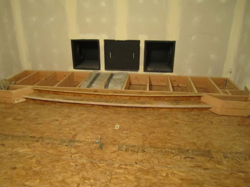

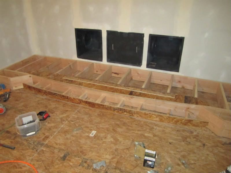

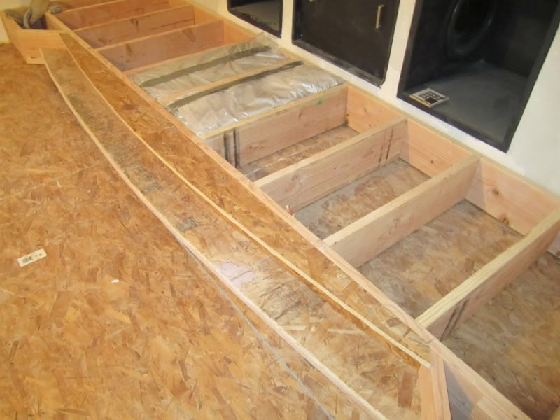

Did some more work on the stage over the weekend. Took a lot longer than I expected. I thought I would have the entire thing done on Saturday. I filled up a few chambers with sand and damelon was right. It looks like it is going to take roughly 40 bags which is about half what I was estimating.

Hey, that stage looks familiar! I just about finished up my stage if you want to see the videos and photos in my thread (check my signature). It looks like you're a far more competent builder than I am but since our stages are so similar I thought you might want to have a look. I decided to cut the decking flush with my router and then come back and add strips of pine for the overhang. My overhang is only going to be about an inch with a 3/8" roundover.
I wound up using just over 2000 pounds of sand in my stage and it was no fun lugging all of that in there!

Fully enclosed sand bagging in the stage, that is something I had not yet seen! You are far too clean to be doing construction. I require more mess in your photos.
Yes I will have to re-think the fully enclosed sand. I went down the next day and noticed moisture on the inside of the bag. I thought the sand was pretty dry but I'll have to open then back up so the sand can dry out. And the room is not always that clean. I usually clean things up a bit before taking pictures.

I've never really paid close attention to sand filled stages. If one is sand filling for resonance control/solidity, couldn't similar non-resonance attributes be accomplished by filling every-other stud bay? Cut the work in half,..? Again, way out of my wheel house here with stages, etc., just merely inquiring.
