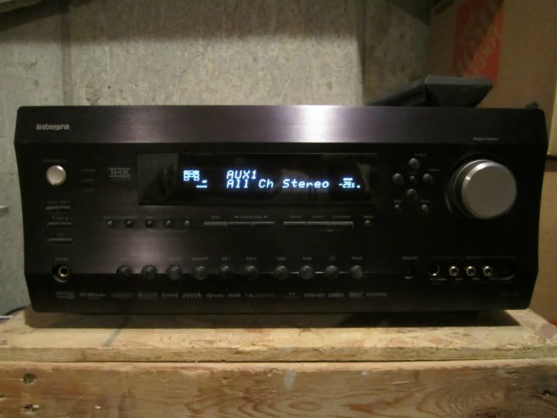

Not much progress to show on the theater, but I did get a new toy. This replaces my old Aragon Soundstage processor. It is the Integra DTC 9.8 processor.

Processor looks cool. You like it as well as the Aragon?
I have not spent any time critically listening to the Integra but I suspect it will not be as good as the Aragon in terms of analog performance or 2 channel. The Aragon was really a great sounding processor but of course lacks many features found in today's processors. The Aragon stopped accepting remote commands and I could not access any of the menus so it was time for a change.
The Integra is a few generations old but processors change so quickly I have a problem dropping $2500 on a processor that is outdated in a year. I want to eventually get a newer Integra with Audyssey XT32, but will probably wait a bit for that.
One nice thing with the integra over the Aragon is I can eliminate a bunch of cables and an external switcher. I used the analog inputs on the Aragon and an external 5.1 switcher because I had 3 5.1 sources, a blu ray, HDDVD and SACD/DVD-Audio player. Now I can replace 24 RCA cables and a switcher with 3 HDMI cables.

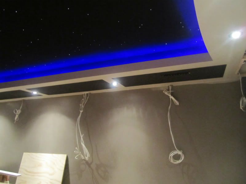

I'm nearly finished with the panels in the soffit. I have 2 more I need to install but am waiting for a cable to arrive tomorrow that I want to run to the stage before putting up the rest.

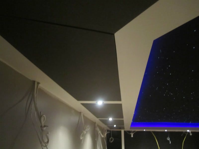

Do you plan to run that blue LED rope that bright ?
I can can dim the rope light to any level - it is connected to the Grafik eye. It will be off when watching a movie. My camera makes everything look lighter than they are in person. The room is generally much darker in person including the rope light. When I get the room finished I'll get some good photos taken with something other than a point and shoot camera.

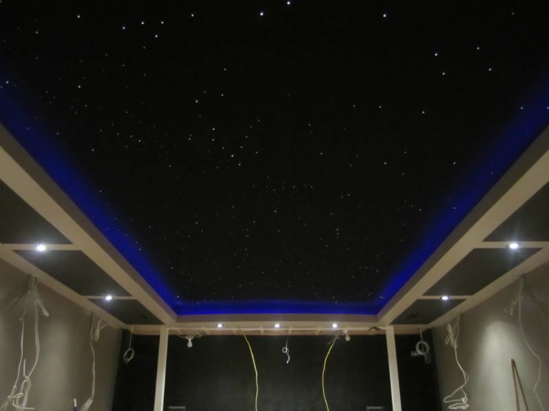

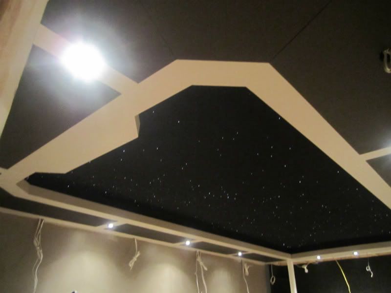

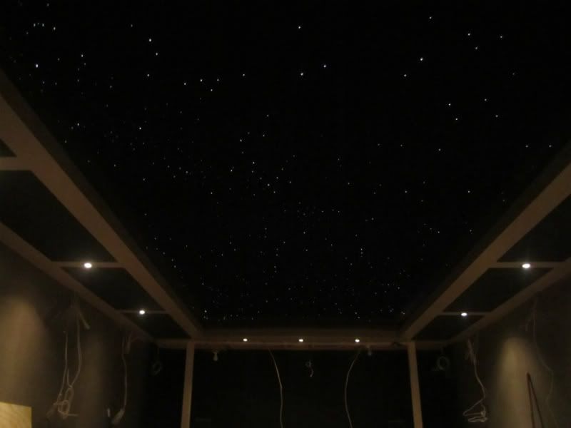

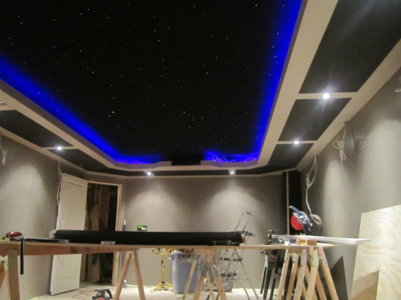

I finally finished with the panels for the soffit. Really glad to have that done as it takes a major item off my to do list. It also gives the room a more finished look. I took some photos in lower light this time. I think with the light dimmed it gives a more accurate picture of what the colors are like. The darker photos lack the detail of the photos taken with more light.

Here is a shot of the soffit with the lights on full.

OK now I want stars.

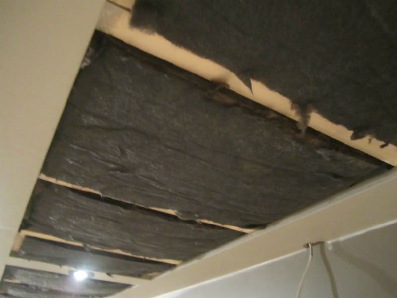

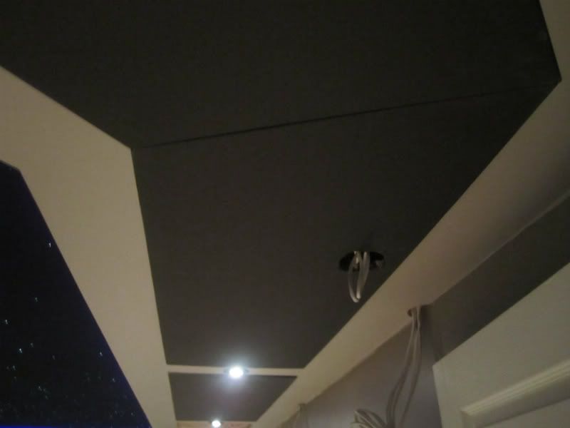

I realized that I never put up any pictures showing what is underneath the panels. I put in 2" of Knauff Sonic XP (linacoustic equivalent) between the panels and the HVAC in the side soffit. The panels on the sides of the room are solid panels not frames like the back. I wanted to do what I can to minimize any potential HVAC noise. The back of the room will have the entire soffit stuffed with insulation. I'll use Roxul Acoustical Fire Batts for that since I have some left over. I hope to get the rear bass trap done tonight. I also hid a doorbell ringer in the back soffit so I can hear if someone is at the door.

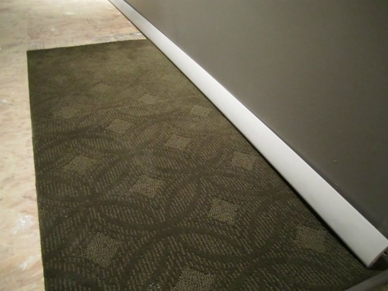

I think I'm a few weeks away from the point where I can have carpet installed and am inclined to go with the carpet in the photo below. I am wondering if the pattern will be too distracting if I have it go up on the stage. I was wondering if it would be a better idea to do the stage in a black carpet and have the rest of the theater with the patterned carpet. Any thoughts on this?

Just my $0.02 but I really like the look of black carpet on the stage- it just sets the whole front wall off and says "hey look at me." You have a really nice carpet choice there and I think it will make a very cool contrast.

The carpet sample looks green on my screen but I am not sure that it is accurate. If I am seeing it correctly then I vote for stage and all to be the same. I have seen several builds on here where they use black for the stage and I personally don't care for it. The only time I think it looks ok is when the main carpet area is dark as well (shades of gray and black). I think you will be just fine doing it all the same.

The carpet does have a green hue to it but is pretty dark and does match the colors of the walls and fabric I've chosen. One concern I have with continuing the carpet up the stage is the pattern will be impossible to line up on the curve of the stage. Sometimes this is not an issue but on some patterns that can be distracting.

Damelon has a small pattern on his carpet and I don't think it is distracting on the stage portion.
A buddy I work with used to install carpet and he says anyone worth anything can make the patterns work around the curve. He says there all kinds of things that they can do like making little cuts and inserting pieces to extend or sometimes cutting out little sections and piecing it together to make it smaller. If they match up the floor and the top of the stage/steps, they can make the curve work.
