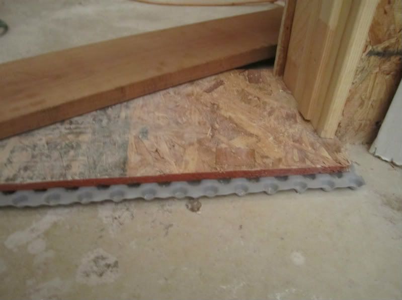

I'm working on the threshold for the automatic door bottom. I'm planning on having the threshold stick up 1/2 inch from the rest of the subfloor. Is this a good height to allow for carpet while not having the threshold stick up too far?
The threshold will be a piece of cherry wood.
How is that Cherry Hardwood door threshold holding up to abuse and usage?
I'm putting this 4ft solid core dore
Into this just re-framed 6 ft to 4 ft opening
and also will go hardwood threshold with auto door bottom and seals from soundproofing company.
Since your has 2+ years usage will be nice to hear about it.

My threshold looks the same as it did the day I installed it. No issues at all. My carpet is low pile like yours. The bottom of my door is just barely above the top of the carpet so the 1/2 inch worked perfectly.

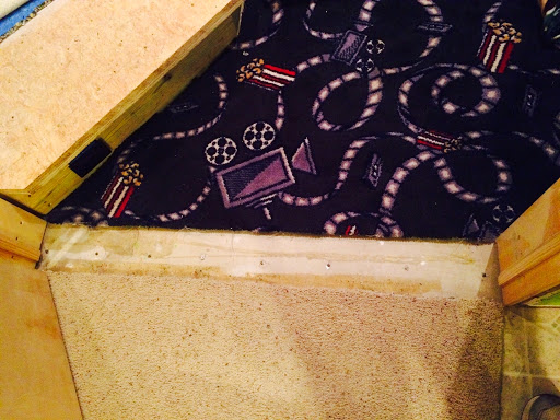

One more question:
Door is in and I'm getting ready to glue my hardwood threshold down.
Looking at the bottom of traditional 3/4" hardwood flooring, I see grooves there, just got me thinking....
(I realize hardwood floors are nailed not glued, still bear with me here)
When you installed and glued your hardwood down did you put slight grooves on the bottom side?
Then put glue on the not cut areas and then glue would squish into those grooves??
Or just glue down, level and put weight on top overnight?

I did not use any glue on the threshold at all. I used a couple finish nails toed into the sides to hold it in place. I thought I might have to replace it someday with the seal rubbing against it so I wanted it easy to remove. If you plan on gluing the floor down, I don't think you would need the grooves.

Yep just glued down as it, I notched the ends to fit under with slight gap for expansion due to humidity, will seal those with tan non-hardening caulk (actually same as I use for my outside log home sealing)
Then construction glue with weight on top, drying now, tonight will be 24 hours so can proceed to finalizing the trim out
