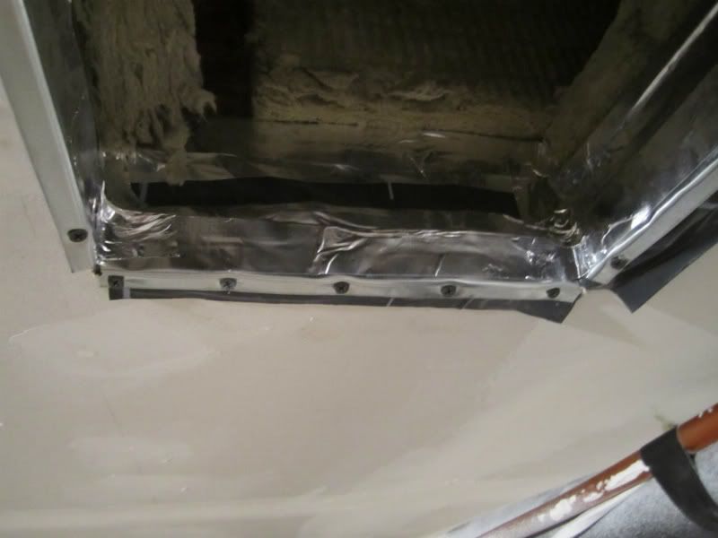

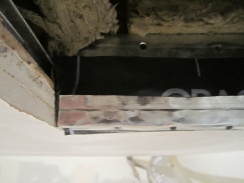

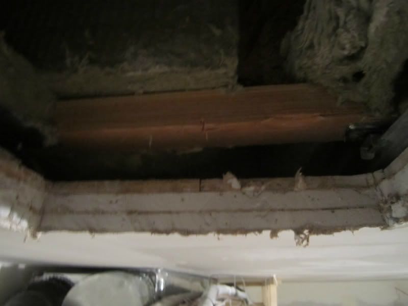

I have 2 return air ducts that go through the ceiling that I needed to deal with before installing the soffits. I had to come up with a way to decouple the ceiling from the joist so I came up with this solution. The first picture shows the gap between the ceiling and the joists. I put a rubber membrane to connect the sections together. I cut up some hat channel to make a metal clamp to hold the rubber membrane in place. I then sealed it off with aluminum tape. This is the best solution I could think of but if anyone has any other ideas that might work better I'm open to suggestions.
stockmonkey2000 is offline

Originally Posted by DavidK442 View Post
So with the returns taken care of is the sound proofing now complete, or do you have more stripping to add around the door? Do you plan on measuring the attenuation when you are done? Crude, but you could play white noise at a measured level inside the room (100db say) then take readings at various locations outside of the room. With all the time and effort people spend on sound proofing I'm surprised I see so little measurement to confirm the results afterwards. Glad to see you are making progress again. Once the mud is done the exciting stuff begins to happen.
I still have not sealed the door and the return air will not be isolated until the soffit is up. I will take some measurements once I have the system set up and everything done. I think the reason many people do not take measurements is that it is readily apparent just being in the room. Even without the door sealed it seems very quiet in the room as long as you are very still. The room is still very live with no treatments up. When my air conditioner is running the condenser lines seem very loud against the quiet background. I never noticed the noise they made before. Hopefully I will not hear them once they are sealed up in the soffit.

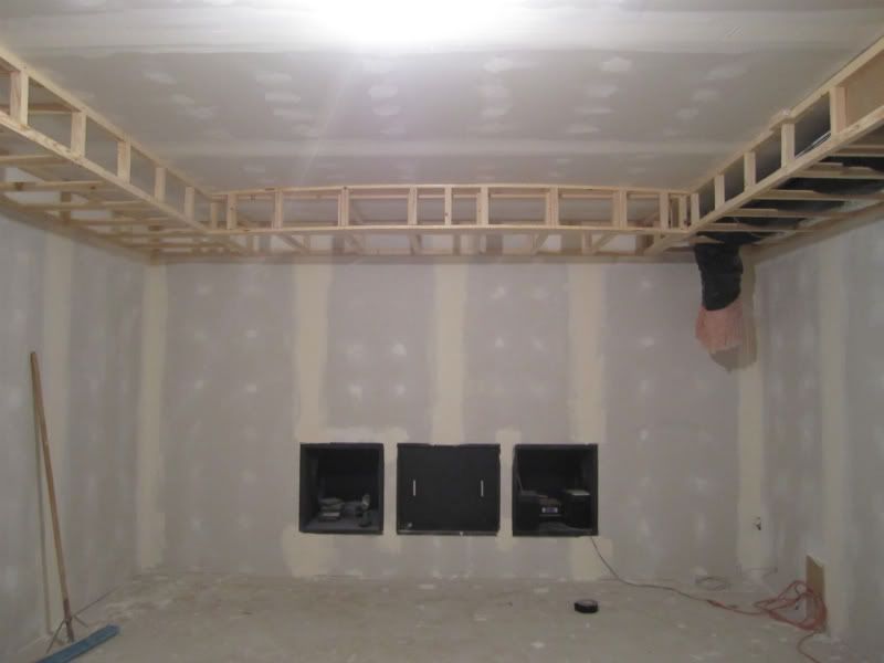

I framed all the soffits over the weekend. Only part remaining is the radius curve on the soffit for the screenwall. Had to stop before I could get the room cleaned up so I did not take pictures but will get some pictures up of the soffits tonight.

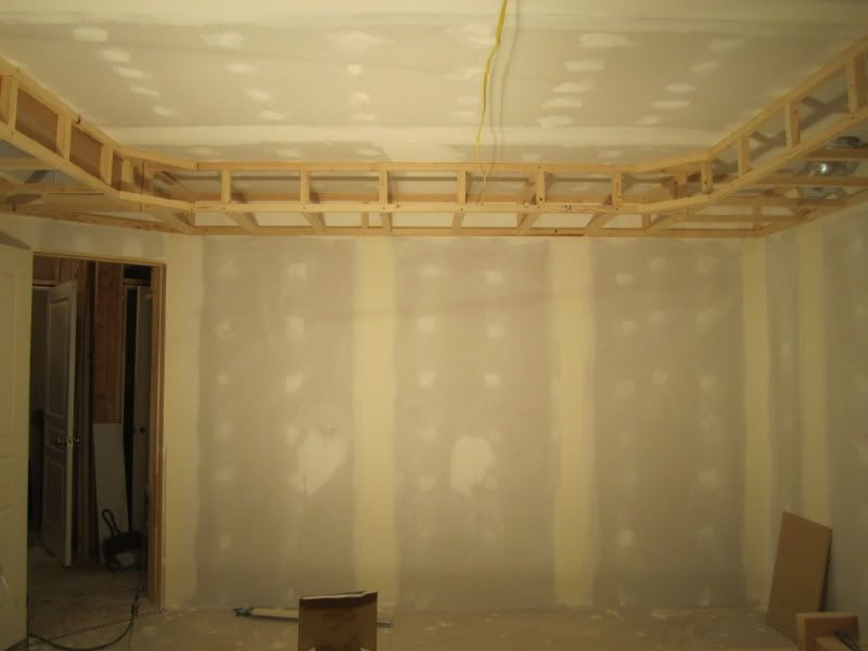

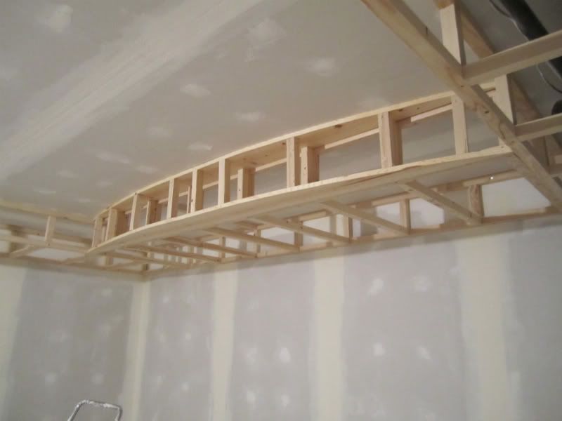

Here is the soffit work I did over the weekend. I put up the curve for the screenwall tonight.
Better shot of the curve.
post #257 of 1105 Old 09-19-2011, 08:52 PM - Thread Starter
stockmonkey2000's Avatar
Location: Utah County
Posts: 1,733
Here is the soffit at the rear of the room.

What are the dimensions of your soffit?
Chase "Fetch"
Old Theater Build
New House Build
cdika17 is offline
post #259 of 1105 Old 09-20-2011, 03:14 AM
NGiovas's Avatar
Location: Michigan
Posts: 1,393
Liked: 43
Also, what is your ceiling height? The soffit looks great.
NGiovas is offline
post #260 of 1105 Old 09-20-2011, 07:20 AM - Thread Starter
Posts: 1,733
The soffit dimensions are 10" by 30" A bit bigger than I would have liked but it was the width I needed for the HVAC for the theater and the room above. Now that it is up I am pleased with the look. The star ceiling will be about 9'8" wide.
The ceiling height is 8'6 or so after the clips and channel and all the drywall were in. There's plenty of clearance now but I'm a bit worried about the ceiling height where the riser is going to be.

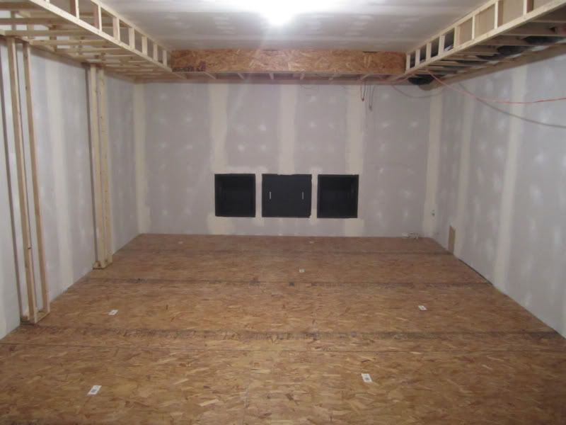

Started installing the Delta-FL and Subfloor.
post #270 of 1105 Old 09-25-2011, 09:23 AM - Thread Starter
Posts: 1,733
Finished laying the floor in the theater this weekend. Thought I would be able to get this and the stage done but the floor took a lot longer than expected.
