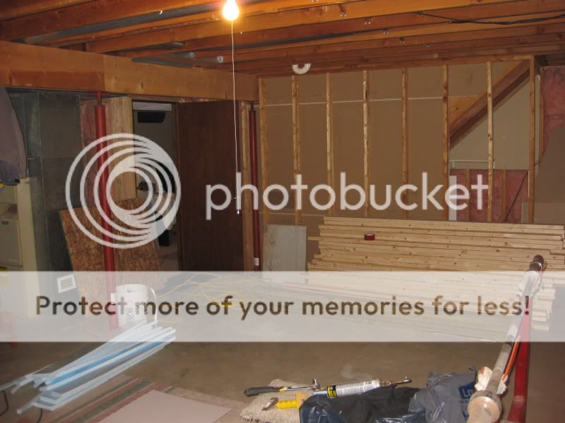

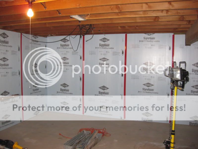

Well due to a mental lapse I failed to take any pics of the room either while full of junk (as it was a storage room prior to this)or after I cleaned it out and prior to any construction starting so the first pics I have are starting now. In an attempt to warm this room up substantially I decided to place 1" poly foam board around the perimeter seeing how it adds an extra R-5 of R-value (every little bit helps right?). I attached it to the concrete with PL foam board adhesive. Again I was a little slow at snapping pictures at the beginning so I only have a few but these arent that exciting anyway.
Screen wall
Side wall....the weight bench is there to help keep me in shape during this build.......or just as a tool storage shelf
Another of the rear side wall looking toward rear closet and the very important pile o' lumber
Here is another of the rear wall, pile o' lumber and main entrance. That wall was already framed as it is the stairwell wall.

post #11 of 1013 Old 02-21-2011, 04:42 AM
RTROSE's Avatar
Posts: 6,732
Quoted: 192 Post(s)
Liked: 167
Looking good. You won't regret doing something towards insulation to help moderate the basement temps. I would also suggest since it is still open to either put more of the "fluffy stuff" around your rim joists areas, or remove what you have and buy a higher "R" value to put in the space. It is surprising how much thermal energy is lost in this area because of the exposure directly to the elements.
Now that you have actual construction photos, including one with a wood pile, Hanes should be pleased, no actually, he should be proud of you.

I'm betting on tool storage shelf, seeing as there's no actual weight on the bar. =)
RTROSE
Way ahead of you my friend these pics are prior to "any" ceiling insulation issues being addressed. What you see is what the builder place up there and it will all be removed (if it hasnt already )
I hope that hanes is proud of me. Maybe he is even proud enough to stop bye and wish me much success?!
Craig lets just say the party is just beginning!
Brad congrats as you were the first to point this out and be absolutely correct!
Any build involving wood piles is, by definition, successful.
Least-wise, that's what I keep telling myself, and so far I believe me.
Way to go, Steve. I just never thought I'd live to see the day you actually began HT 2.0, much less the build thread for it.

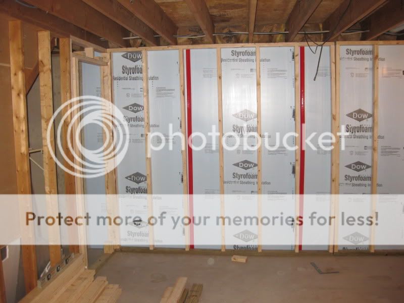

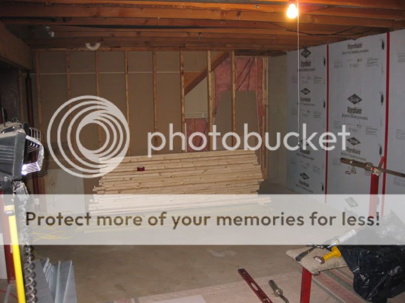

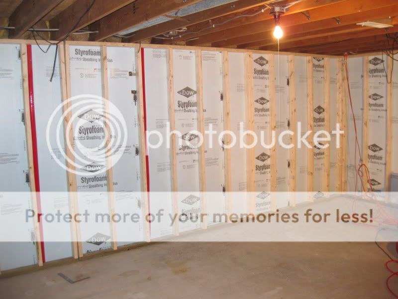

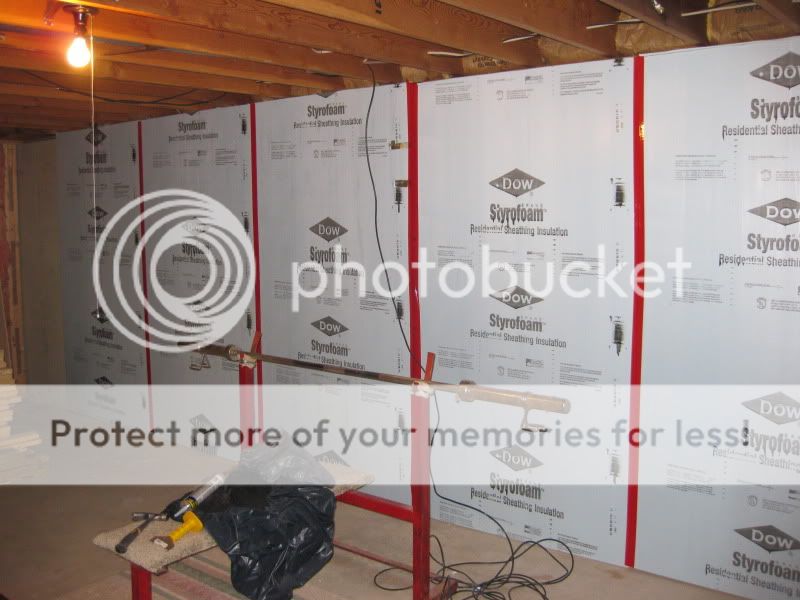

So in the honor of progress I present the exciting world of framing.
First the left side wall and rear closet
Another of the same wall moving toward the front of the room
And the screen wall
And front right screen wall corner and a look at the future media closet area, just as soon as I find a home for ALL that crap
