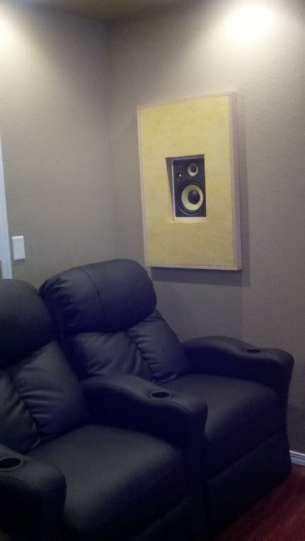

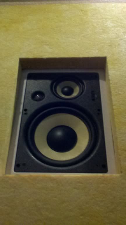

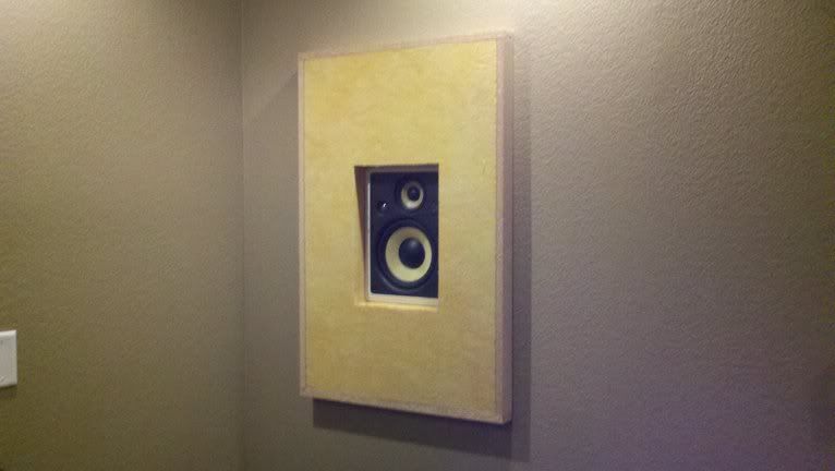

Quick consensus please.
Should I cut an angled bevel for the surround speaker cut out?? I'm about ready to cover them.
Thoughts??
I would. It's such a small amount that I don't think it'll affect the properties of the panel, but having the speaker 'recessed' like that may affect the sound quality.
They are (at most) 8 feet directly parallel to the listeners ears. There are no seats in front nor behind the panels. I have heard no degradation in sound.
Here is a picture showing the seating arrangement...
This picture was taken from where the closest listeners ear would be...

After seeing those pics and only having 1 row, I'd say your fine leaving them alone then.
Thoughts??
IMO, w/o taking measurements, since the fiberglass is proud to face of speakers I'd error on conservative side and cut 45deg bevels in the fiberglass like you were thinking. The fabric will cover that and it won't hurt, and just ensure less stray reflections.
