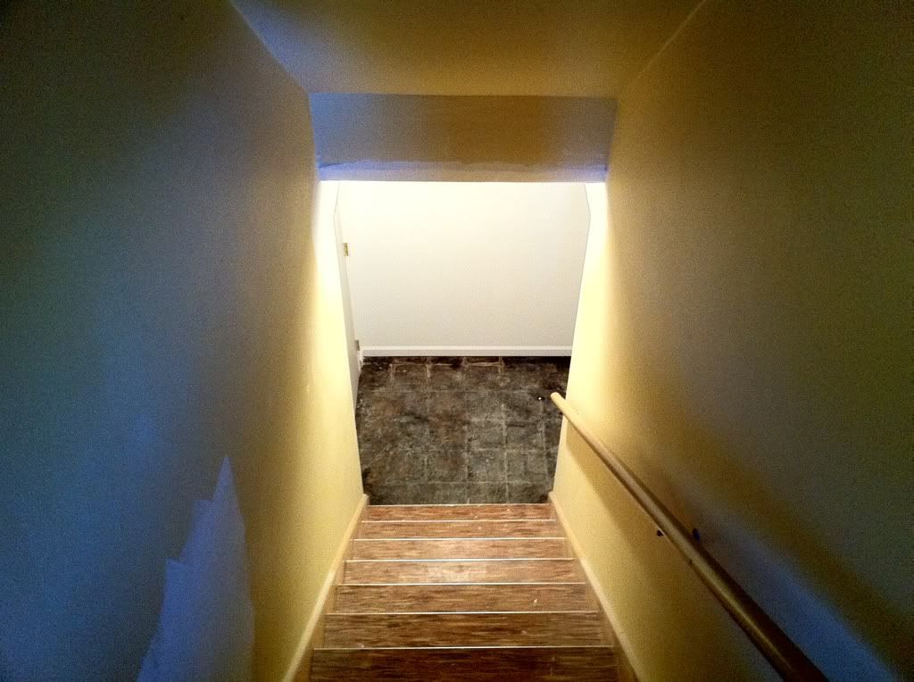

Barely livable setup until theater room is done... J/K
But here is a picture of the living room.

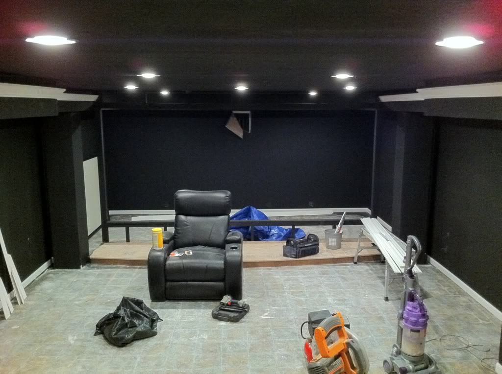

Just checked your video out SOWK, pretty cool. Nice open space you have to work with there. What are the rooms dimensions? How many seats are you able to get in there?
oman321 is offline

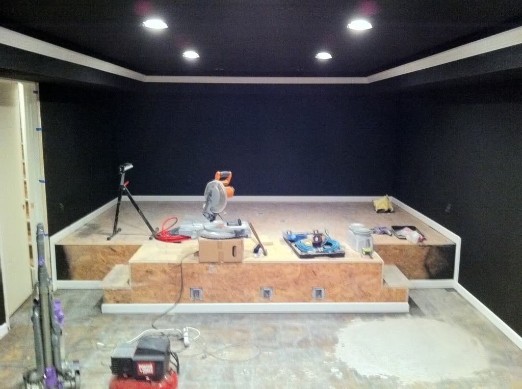

How deep is your false wall? Looks extremely deep?
7'
This is going to be an audiophile room as well.
Not just home theater.
Need good distance from side and front wall for best imaging and soundstage.

Very nice man. Cool videos. I really wish I had more space in my basement for a bigger theater. I was only able to fit 14x19 room.
Also, only 5 seats? I am positive you can fit 3 seats on the riser and 4 seats in front.

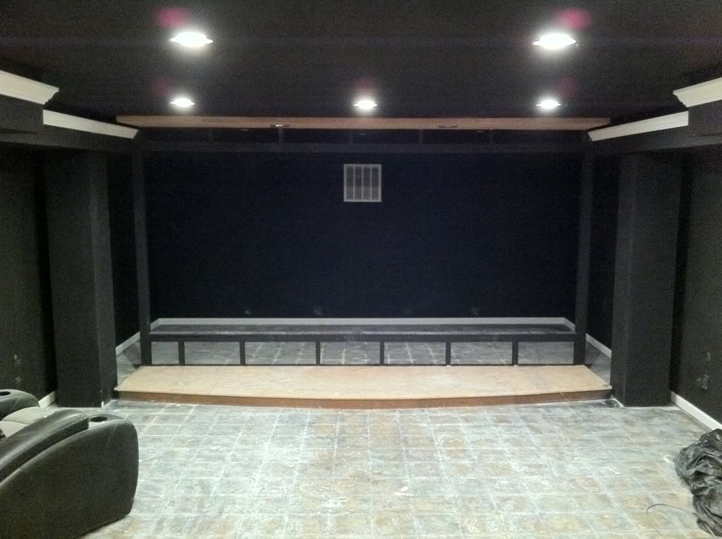

post #20 of 227 Old 07-07-2011, 05:46 PM - Thread Starter
SOWK's Avatar
Location: WI
Posts: 4,741
Mentioned: 29 Post(s)
Quoted: 480 Post(s)
Liked: 376
SOWK is online now

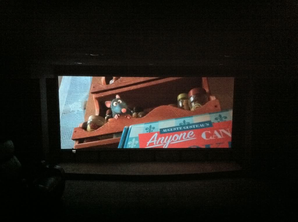

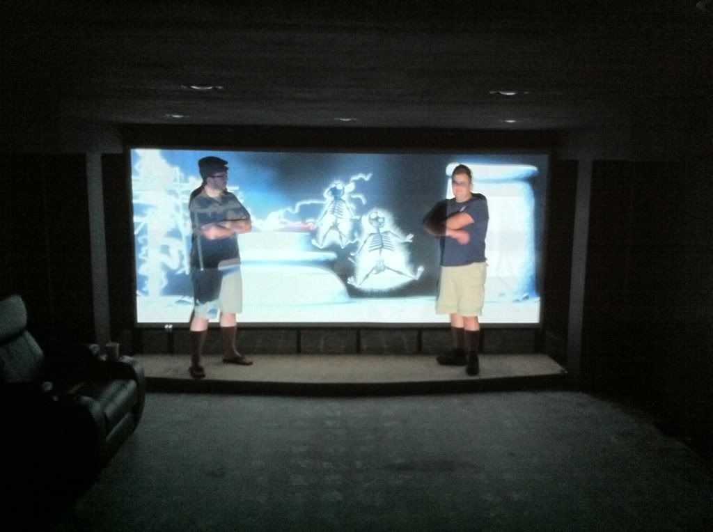

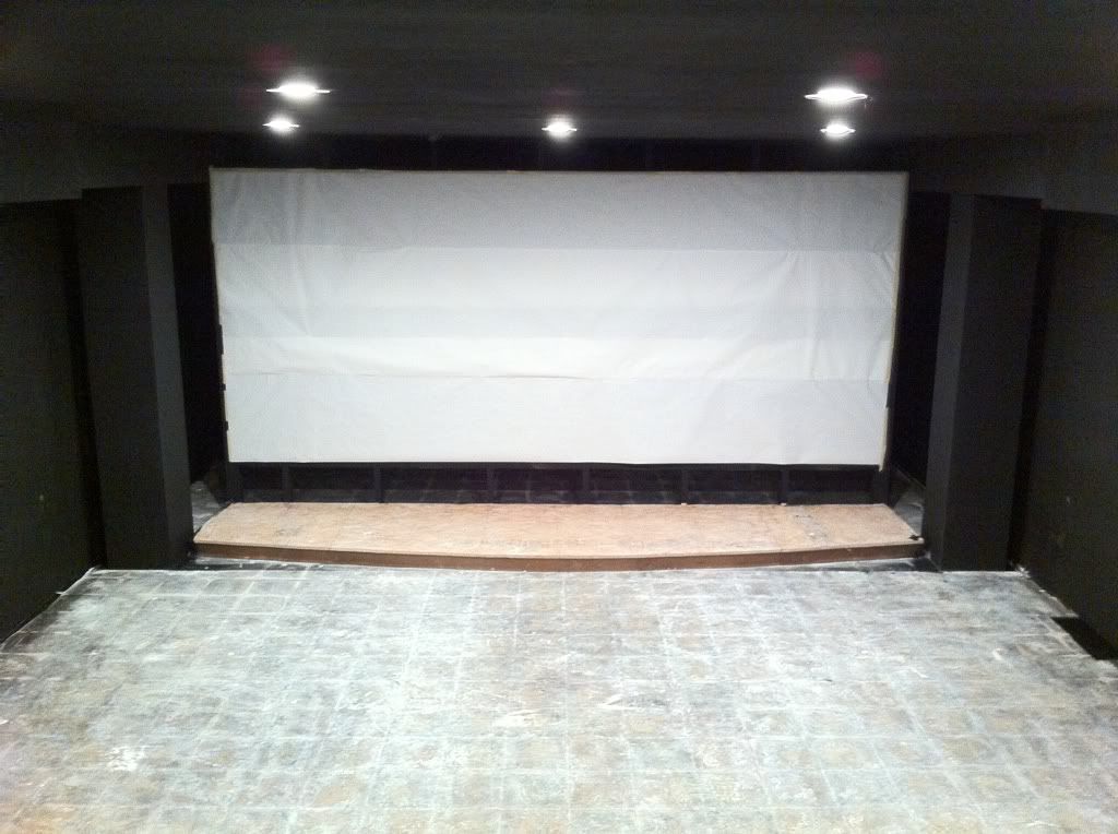

I know you're all going to be super jealous of my new screen...
Nothing but the highest quality here!
Image testing:
Included in the last picture is 2 of my friends for screen size comparison. Both are ~ 6' in height.

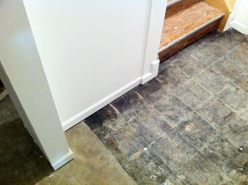

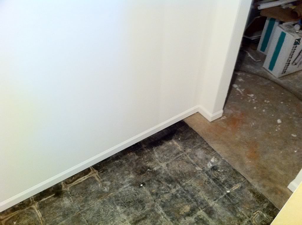

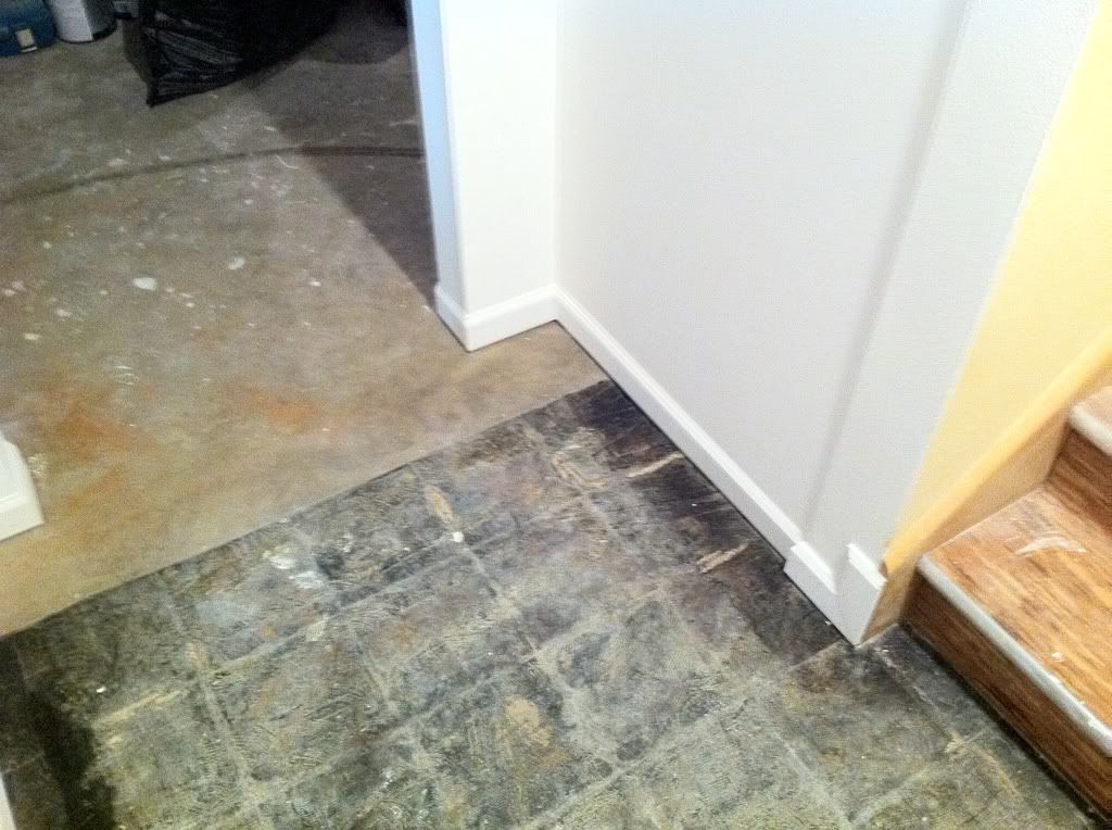

Molding are in and ready for caulk and wood filler.
Looking down into the main entrance area.
Entrance base molding.
Theater base and crown molding.
Full update avail in post 1.

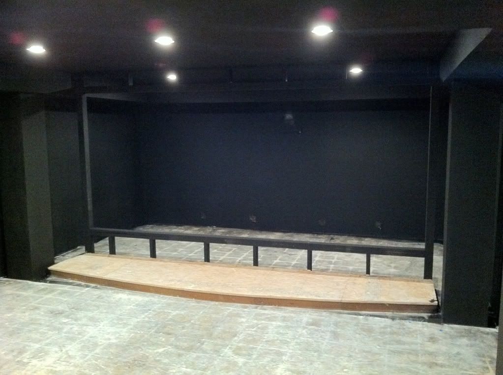

post #29 of 227 Old 07-22-2011, 06:49 AM - Thread Starter
SOWK's Avatar
Location: WI
Posts: 4,741
Quoted: 480 Post(s)
Liked: 376

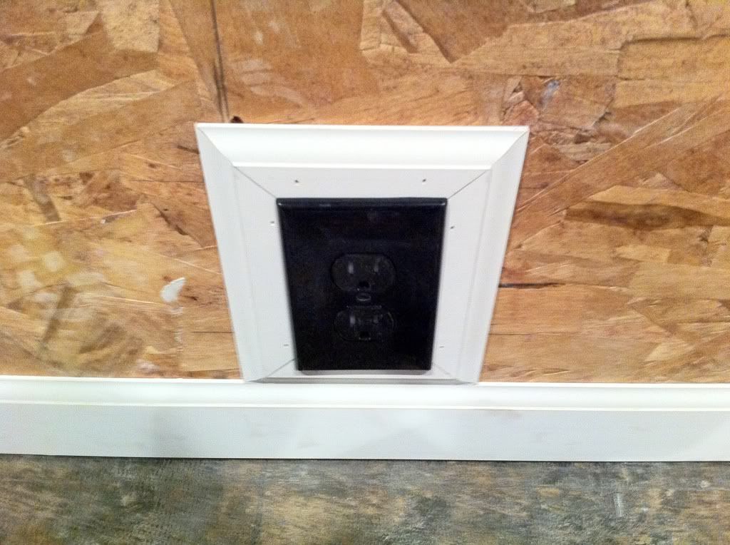

Small updates from here on out as it is now in the finishing stages...

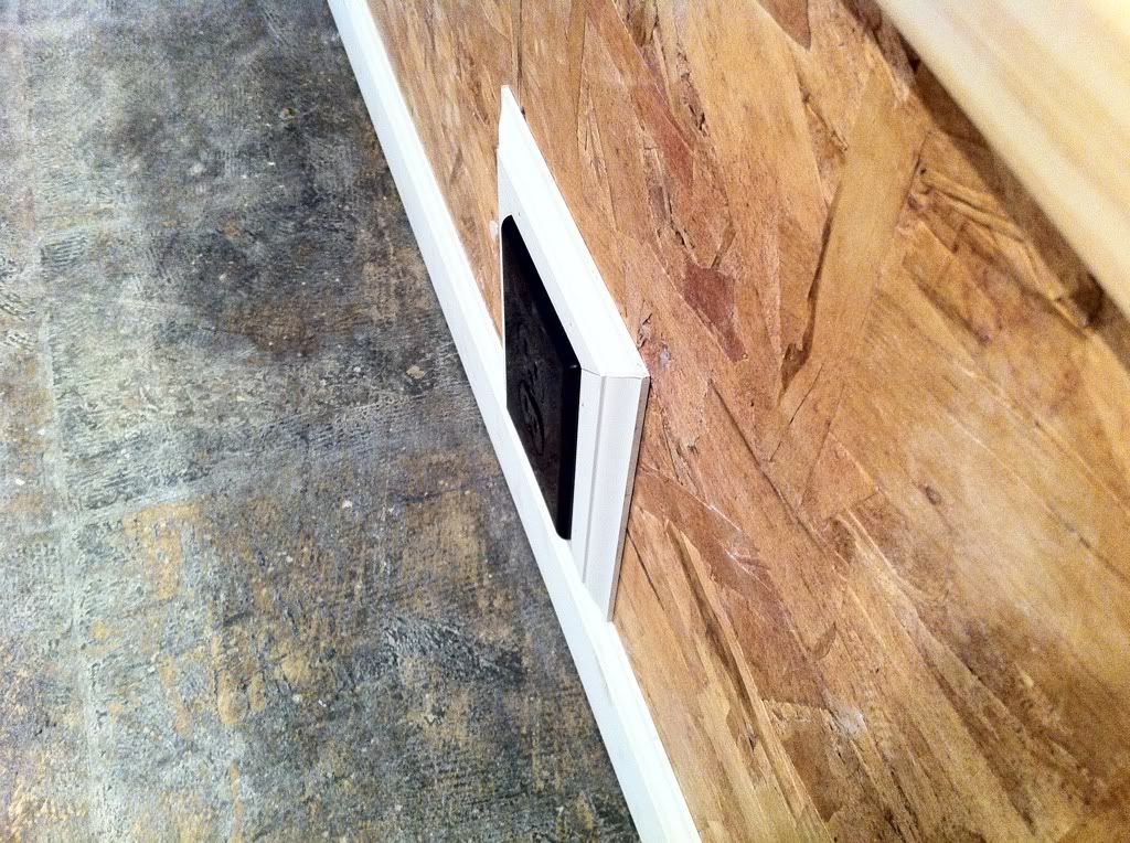

Fancy outlet decor:
Top stage is up:
Back of the room with riser:
SOWK is online now
