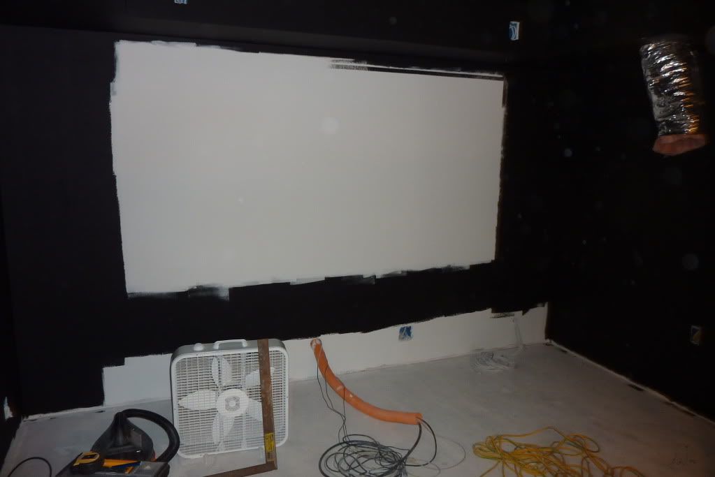

Finished painting the first coat of black. I purchased the Steeler's Black paint from Home Depot and had it color matched at Sherwin Williams, then bought a bunch of it from there. I stopped at the first coating to find the flaws in the drywall work (so they can be repaired) and to wait until the rest of the work was done prior to doing the second coating. I should have waited until after the work was done to do the first coating, it literally sucks up the light! I had to use 600 watts of light in order to make the place lit up enough to read a tape measure!!

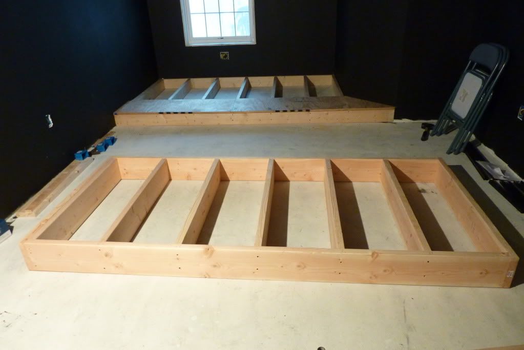

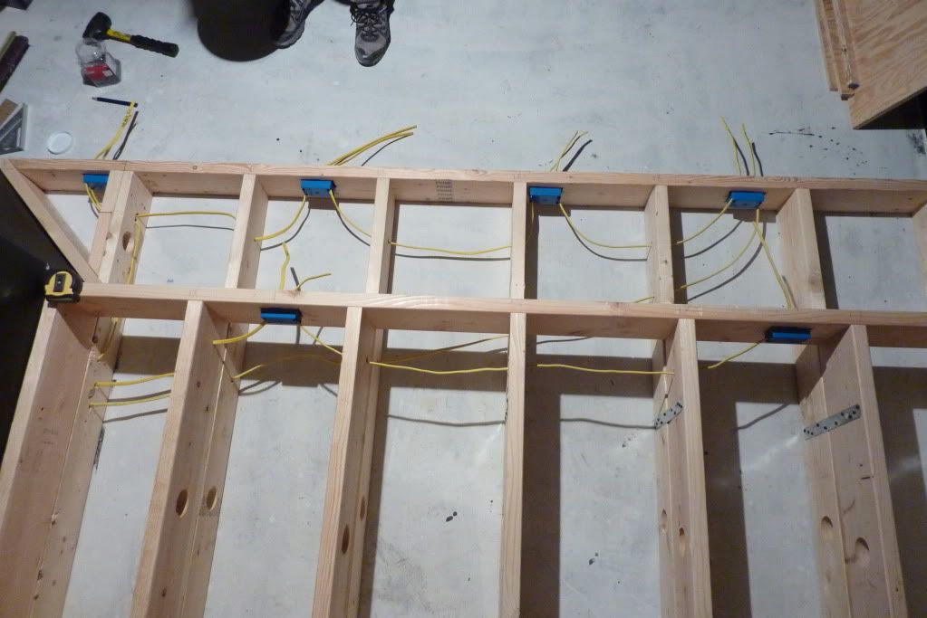

Anyway, here is the very roughed out screen wall:

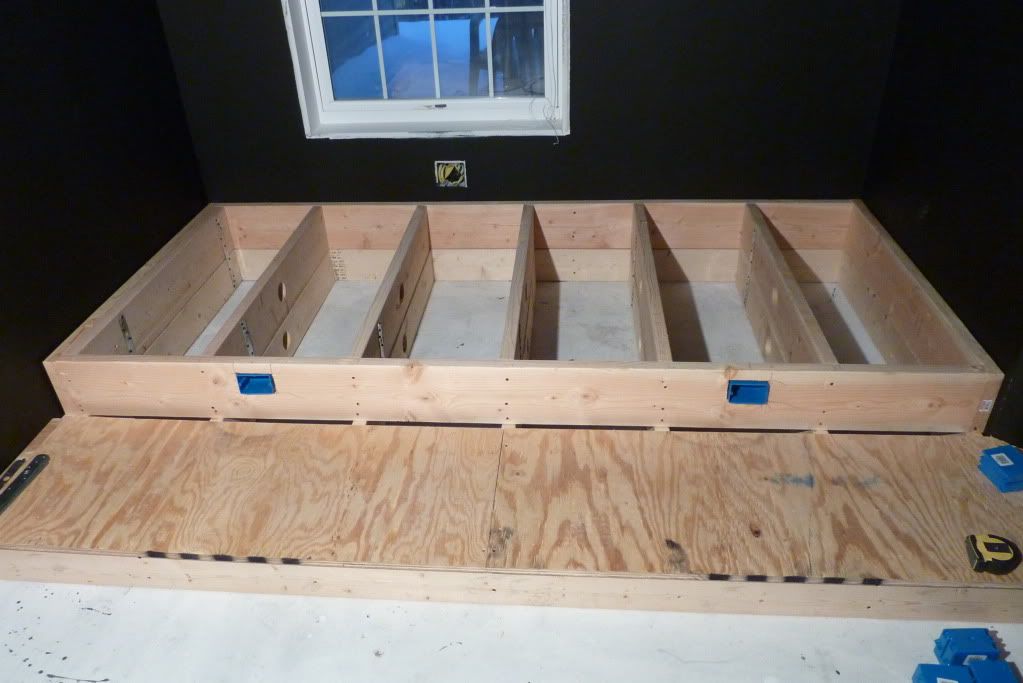

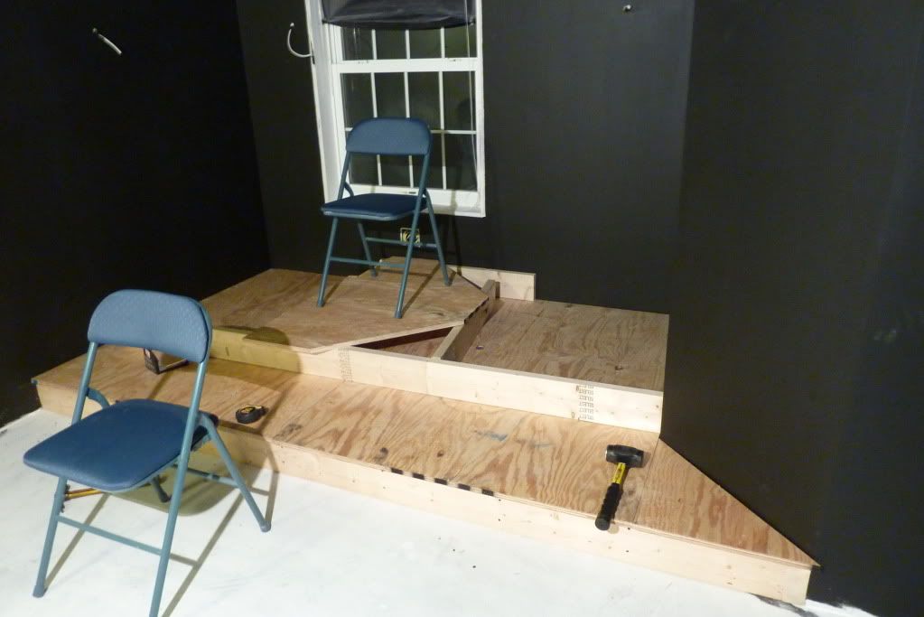

We built the riser...then realized we needed to have it a bit higher. We initially used 2x8s with 3/4 plywood on top, but that was simply not high enough. We are removing the plywood and adding a second layer on the top of 2X10s with plywood ontop of that. it is going to look nice. Some pictures:

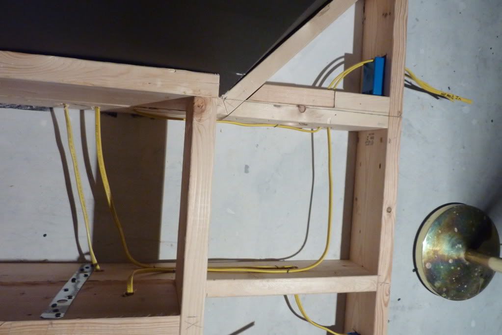

I am changing my plans to put the electronics in the stage...it ends up just being too hard to access it. I am moving it to outside the theater, next to the bathroom, on shelves on the wall. You will not be able to access it from inside the theater, but no big deal as we use a HTPC and the only time a physical disc is used is to rip it to ISO or Folder and store it on the Hard Drives. I now have to reroute some things, but the outside wall of the theater is not yet done so it is easy to do.

Well OK...I overview-ed your Link to your Thread in DTDC.
It seems painting a screen "IS" in consideration. It also seems that at first you were considering a 115" wide x 48' high screen. Why change?
I see two rows of seats as well. Plans to move the electronics elsewhere too (...thank goodness...)
The Soffit does work to limit your screen height, and obviously that was a factor in your having to raise your Riser height.
A word of advice....although with having painted the underside of the soffit Black it will help mitigate reflections, don't expect the Black used to be completely "anti-reflective" when the top edge of the Screen will be close. Flat Blacks usually tend to reflect a Blue-ish cast under such conditions, especially under bright content, and the entire underside of that Soffit will light up.
Surfacing the underside with this stuff :
http://www.fpi-protostar.com/flock.htm
http://www.fpi-protostar.com/hitack.htm (FPR-2)
.....and you'll NEVER have such issues.
I'd like to invite you to wander over to the DIY Screen Forum. Don't underplay your hand too much on the "painted screen" idea. And Brother, don't wait much longer to get that screen painted! Really, it should of been painted "Before" you applied the wall paint, and the latter cut in around a masked edge.
Spraying a screen is what is called for, as you will note that on Projector Central, that was the stated preference, but they tried to show that rolling was possible. Well while that is true, when creating a "perfect" surface, rolling just does not fit that job description. Spraying is very easy and affordable: http://www.gleempaint.com/noname.html
....and at this point, masking off the needed area is going to be easy, and very little re-rolling of wall areas will be required. We/I can provide you with timely advice and helpful suggestions on all of the aforementioned screen considerations, as well as any other aspect of your remaining build (...We are actually one of the best "One stop Shop" Forum on AVS ....)

If I wanted to spray the final coat of black onto my walls (I am waiting to do that until all the construction work is done), what size tip would I use for the gleempaint machine. It is Steelers Black from Glidden (VERY VERY thick, lots of pigment). I suppose I could just thin it a lot and use several coats. I want to paint without ANY brush or roller marks...they will show up instantly when using the projector.

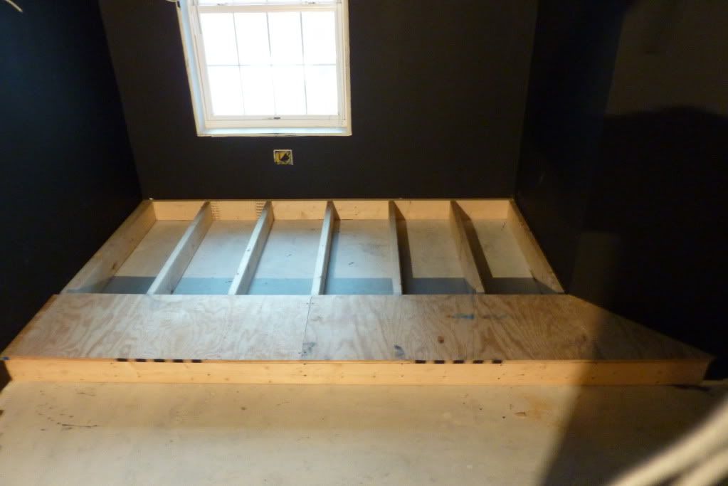

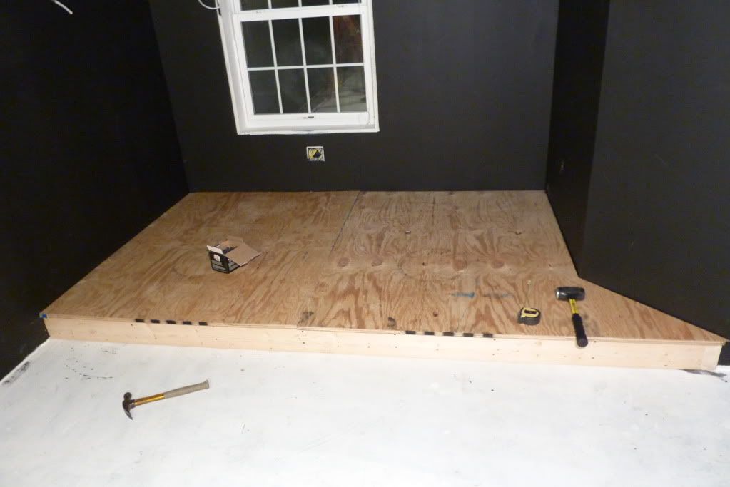

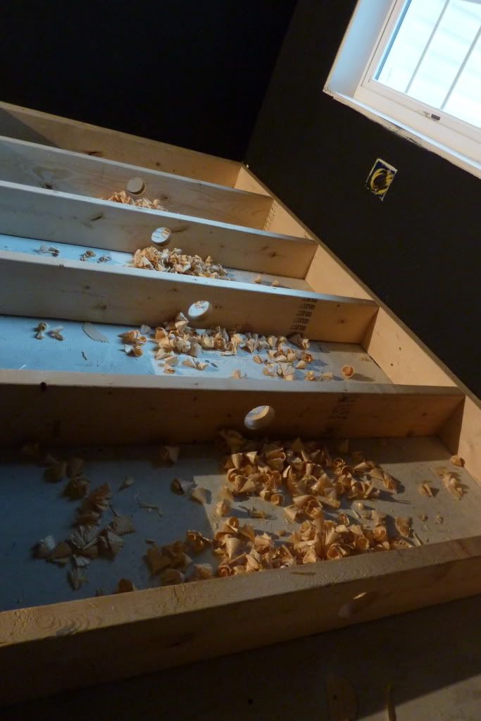

More updates...lots of pics this time. The Riser in the back is DONE!!
I am surprised at just how SOLID the riser sounds. There is a good 11 inches between the top of the riser and the floor...I expected it to at least sound slightly hollow...it does not. It sounds completely solid.

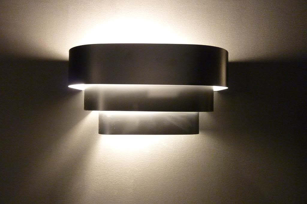

Another update. A friend wanted to view the theater room, having heard about it. He also happens to be a licenses electrician, so we quickly busted out my electrical work. I now have lights and electric outlets in the room!!!
Here are some pics. In this one, you can see the uncovered lights on the walls and the uncovered LED lights on the riser. There are also three standard outlets on the bottom level of the riser, for use by powered recliners.
Here is what the lights on the wall look like with the cover on one of them:
I am using a dimmer switch for the LED lights, to make them a little less bright. I am using a standard rocker switch for the wall lights. I will eventually replace it with a remote controlled wall switch.
cybrsage is offline

They are from Home Depot and are for purchase online only:
http://www.homedepot.com/h_d1/N-25ec...kuId=202573203
I will be putting a Steelers' logo sticker on them. I was afraid they would not provide enough light, but they do when you put in 100 watt flourescents. 150s buzz slightly, so they cannot be used.
EDIT: I discovered 125 watt flourescents at Lowes. They provide more light and do not buzz. I will be using them for a total of 500 watts of light for only 120 watts of power.

Looking great, Cybrsage! I was wondering what the holes in the top of your riser were for... does this allow it to act as a bass trap or something? I didn't see any ducts underneath or anything.
Yes, that is what they are there for. I cut two holes in each board to allow airflow/soundflow between the cavities.
