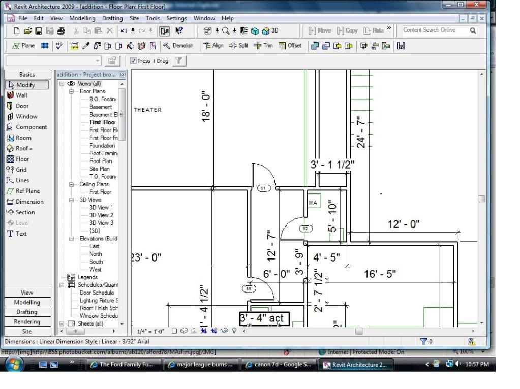

off topic
I see you using Revit Architecture...Are you an architect? That's the real deal, AFAIK.
Yeah, I have an architectural engineering degree.

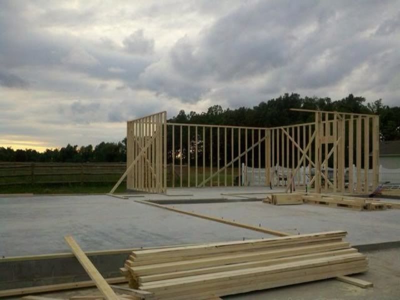

All the sole plates are glued and anchored. 1/4 of the walls are erected. Not bad for one day and one framer. Found a huge mistake made by the block layers today, about a week too late to fix!!!! The garage is one block out but luckily it is on the theater side so it can be hidden. It sucks majorly just because of the fact that I know its not square but atleast its only the garage and it will be almost visually flawless. I'll have a large air gap in that wall lol but will look square.
audiovideoholic is offline
post #64 of 480 Old 05-19-2011, 08:52 PM - Thread Starter
audiovideoholic's Avatar
Location: Murray KY
Posts: 3,175
Quoted: 451 Post(s)
Liked: 141
We have walls!! Moving right along. 3 days and counting.
7:00 a.m.
about 10:30 a.m.
Garage
Media room facingaway from bar towards fish tank and 3D plasma wall
Theater facing stage
Theater facing seating
7:30 p.m. ISO setting around 2000. will need a better pic in the morning before they start

It's always amazing just how fast framing goes! Enjoying the pictures, here. Keep em coming!

Love the progress. Nice stick built work,...too bad the brickie screwed up! It'll be fine, you'll be the only one that'll ever notice.

Question about the rack/racks placement. How close to the closet wall can I place these? Like when I need to put a shelf in how much room between the side and the wall will I need? I have the one labeled MA framed out aprox 6 inches. The one for the media room I want to be as close to the exterior closet wall as possible. I have no idea how the shelves are installed is why I am asking.

The Middle Atlantic rack shelves are installed from the front, just like the way you installed the "square braces" you have installed there. The rack could be framed in tight but depending on finish trimwork, you might need some clearance considerations on the front wall.
Here's a quick scan of the MA shelves.

Got trusses? More PICS!
Nope, no trusses. Everything will be cut and erected by itself. The framer works by himself most of the time. He had help the first two days but has been alone since then. He built a spec house for me 14 years ago completely by himself. He also built my mothers house by himself. Its actually pretty amazing watching him build. He's considered the best framer by most contractors in my home town. But, they dont use him because they would rather a crew of guys get out there and get it thrown up ASAP. Every cut and connection has to be perfect or it doesnt stay up. Today he put up 4 3/4"x16"x24' LVLs on top of the plates all by himself. My wife wishes he would do our tile just because of how paticular he is, but he's only doing our hardwood.
Man that was a lot of rambling about a longtime framer/friend. Just wish I could express how good he really is. He drives about an hour and a half just to get here. He'll finish up on ceiling joists tomorrow morning and then cut rafters all day. Hopefully he'll get a few up but its supposed to rain in the afternoon.
