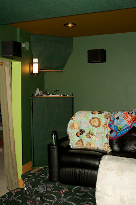

This is a main floor theater.  I implemented my old materials into a basement pseudo 114" theater/tv room.
