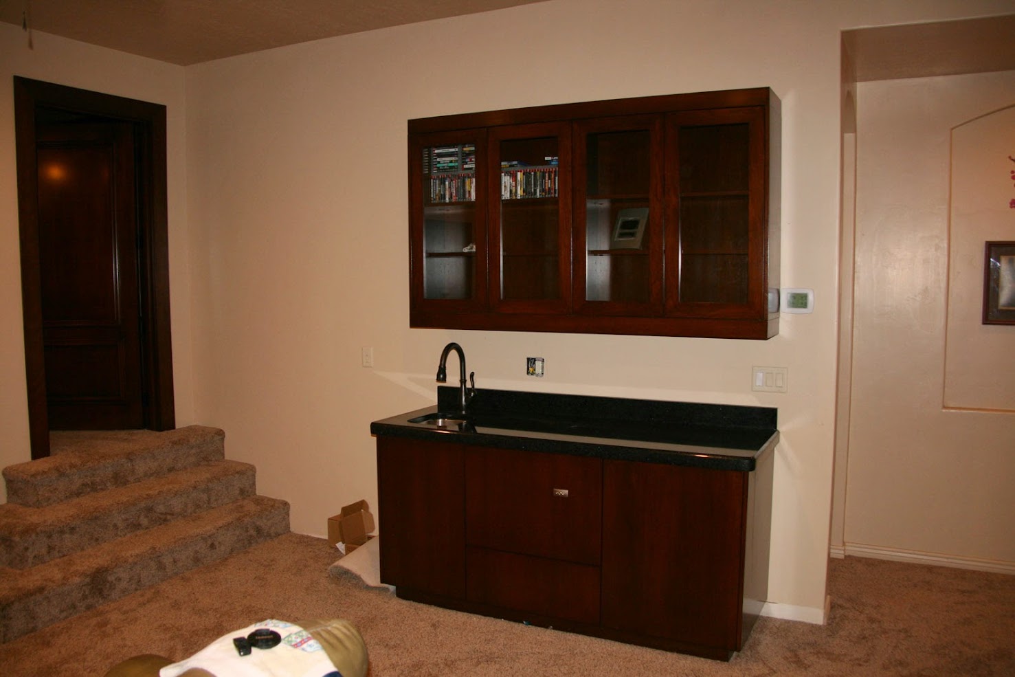

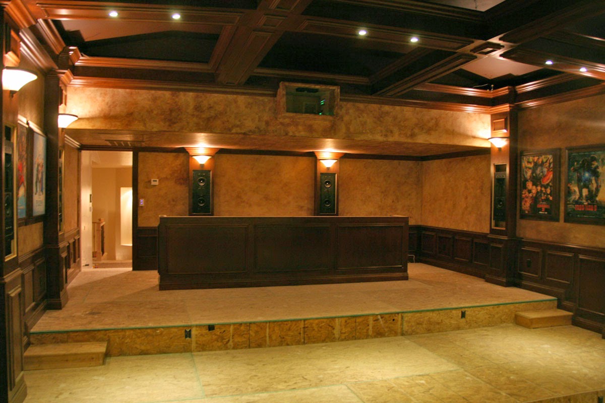

post #103 of 135 Old 07-23-2014, 09:33 PM - Thread Starter
robinsj's Avatar
Posts: 192
The screen is a 199" 2.35 stewart screen. It is just over 15' wide. Thanks!!
Few more pictures of updates. Got the bar installed. Some of the posters hung. Carpet is going in tomorrow. Unfortunate thing, hooked up the Brand New DHC 80.3, and it has problems, and is off to be warrantied.... Brand new out of the box.... Man, what luck!
design1stcode2nd likes this.
robinsj is offline

post #105 of 135 Old 07-24-2014, 08:09 AM
DougUSMC's Avatar
Join Date: Jun 2014
Location: Ellicott City, MD
Posts: 322
Quoted: 155 Post(s)
Liked: 66
Wow, that is AMAZING!! How do you deal w/the accoustic issues with all of the wood and hard reflective surfaces???
______________________________
DIY Expert / HT Noobie
My Build Thread
Trying to figure out DIY speakers
1st Timer Fusion-15 Build Thread
DougUSMC is online now
post #106 of 135 Old 07-24-2014, 09:24 AM

Thanks for all the nice comments. I think I have been saying for the last two months, its almost done, we are in the home stretch. I think now I am really starting to believe it. Reflections? I just wear headphones, problem solved. Just kidding. Honestly, I am not a complete audiophile. I have 6 kids, and 75% of the time it will be my kids (could you honestly hear the reflections over children?), and friends watching movies, and neighbors, and other family members. The other 25%, will probably just be my and the wife. I tried minimizing it, by adding the posters, at the same height of the speakers, as they do have 2" of Roxul inside the frame behind the poster, and those do help alot. Just the posters I have up so far have cut the echoing down in half, and there wasn't even carpet in the room yet. The only wall that shares the house is the back wall, and we double drywall'd both sides, and filled it with Roxul insulation, and put 2 layers of MLV between the drywall. The attic of the theater doesn't even share the same space as the existing part of the house, as we left the original roof there, just removed the roof tiles. The door that is being built is a complete custom solid wood door. It was here yesterday, but it needs some adjustments made to it, but that door weighs about 150-200lbs, so it should have no problem stopping sound...
robinsj is offline
post #110 of 135 Old 07-24-2014, 01:41 PM
DougUSMC's Avatar
Join Date: Jun 2014
Posts: 322
Quoted: 155 Post(s)
Liked: 66
Very cool, thanks for the response. I was so dazzled by the woodwork that I didn't realize the posters were accoustic treatments.
