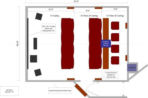

That pretty much describes my room: 16' x 22'. First row is at 10'. Prime seats at 15.5', bar table behind. 136" CIH 2.35:1 screen (108" at 16x9).
If I did it over again, I'd have made the room 17' x 24'. With 4 seats across, there's only about 18" on each side for the steps. Not "tight", but an extra 6" would make it more comfortable. And length, I'd like another 6-12" in the middle row, and another foot in front.

Jeff, based on your experience I would need about 26' to do this comfortably with an AT screen. How is the front row viewing now? Is it overwhelming?
It's big, but not overwhelming. No one has complained saying it was too big, either. Had a full house watching Inception (which is a pretty good visual/motion test! ) and it was fine.
I tested the size before purchasing the screen - adjusting it down didn't really change the experience from the front, but certainly impacted the size from the middle/back.
But yes, the experience from the front was my only concern when choosing the largest screen I could buy/fit...
