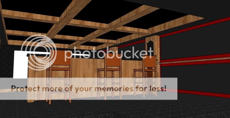

This photo shows how most large-radius wood mouldings are made:
Those look expensive! I don't know if I would go with an actual molding, or possibly just use a veneer on larger flat surfaces. It is good to know I've got some options though. I'll take a look at that website and see if I get any more ideas.
Originally Posted by Mr.Tim View Post
I kind of like the ceiling. I think the render is partly to blame-- if it were a darker, richer color it would look completely different.
What would really be kick-a-s is if you dropped the coffer a few inches so the black ceiling above was continuous.. then install a star ceiling. It would be like looking at the sky through skylights.
Darker color - check! We'll give that a try in some upcoming renders.
And the continuous ceiling is a great idea! I wanted the coffered part of the ceiling to look like it was floating using the lighting, but why not make it actually floating. I don't know that I will use a star ceiling, but I think having the continuous ceiling under my coffered ceiling would be really nice. The only problem I can think of is how I would span a 19' wide room and support the beams. I know it won't be holding a lot of weight, but I don't know if a 2x4 would be enough. Any thoughts?
........If you do any decoupling with these clips and accompanying hat track, you will already be (or be very close) to 2 inches of height down from your joists so you could simply drywall over everything without even contacting the joist...........
..........I assume you are talking about adding stain-grade 1x material as an applied molding directly to the ceiling to preserve maximum height, right? I don't see it pictured, but were you considering a small "back-bar" behind the last row of seats for overflow seating during big events? If you are, traffic flow to this seating area is the only thing I see as being a real height restriction for you in the room. Even if you built out the finish carpentry on the ceiling several inches to give added depth, your height to the seating on the riser will still be perfectly fine. I had a friend who's height underneath the soffit on the riser ended up being 6'7". It felt a bit strange at first but you really get used to the lower ceiling height very quickly!
I'm definitely going to decouple the entire room, but right now I haven't decided if I'm going with a room within a room design (and put joists between my existing joists) or or if I will go with some sort of clips and channel.
I'm also planning a bar at the back, but I took it out of the render to show the ceiling better. Here's another view showing the bar. I could see us spending a lot of time back there using it as a place to have "dinner and a movie." or a place for me to work while listening to music. Since I'm nearly 6'-4", having a low ceiling worries me a bit. The door header going into the theater now feels a little low without a soffit already, but we'll see how it feels once the riser is in. I would really like to have a more traditional depth coffered ceiling as I think it looks nicer.
As always, thanks for the feedback everyone! I really do appreciate all the different perspectives. It's easy to get locked into one way of seeing things, so another view is always good to have!

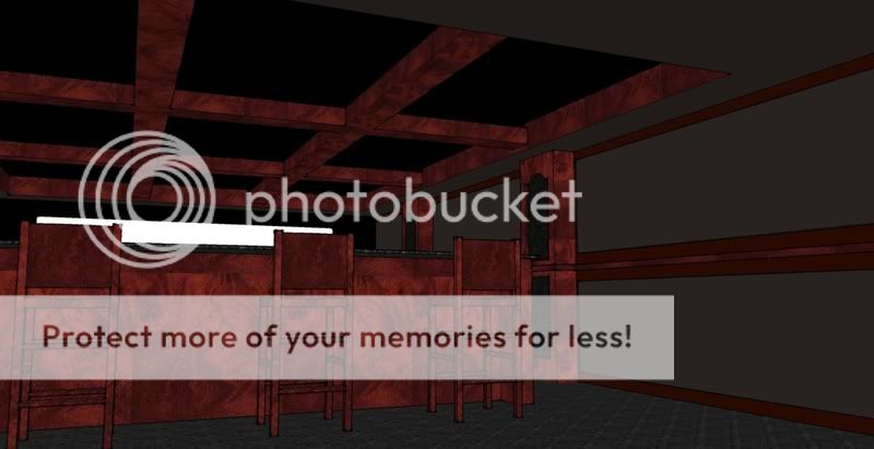

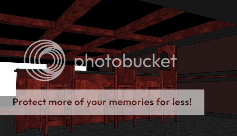

Now for renderings. You shamed me into it, RT. I tried a traditional coffered ceiling, and I like that it feels lighter, but it may be a little plain. Of course, once rope lights are added, that might change.
Next I tried playing with some colors. I changed the wood color to something darker as recommended, and I think I like the darker wood, but that didn't go with the original wall colors. So I toyed around with that a bit as well. Unfortunately, I'm hopeless at things like colors. I may very well hire the designer that's been working on our house to pick out colors. Here's a couple of attempts
And a little different
What do you guys think? I think I'd like to come up with a color scheme with blues in it to see if I like the cooler colors, but I don't know if it will go with the redder wood stains.
Edit: Here's another one with darker wood that has less red in it. Still trying for a blue color scheme that works.

A quick decorator hint - choose your carpet FIRST. Assuming it will have a pattern and not a monochromatic color, pull a coordinating fabric color from one of the accent colors in the carpet. Then choose your woods species and stain color (stain-grade pine is the cheapest that still looks nice). From there the granite color and some of the smaller detail pieces are easy choices once you have the major color scheme wrapped up.
Two things on the coffered ceiling to "dress it up" - One is to make all the beams wider to add heft. Second, for the beams that run left to right, you could recess them approximately 3 inches compared to the main beams that run front to back. This will create additional depth. And I am sure you were going to run crown inside the coffers with it just being difficult to show in Sketch-Up.
Glad the hints on framing the rack rails helped. One clarification - when I said 1x material I meant 1x4 finish grade (trim) material so it matches the depth of your standard 2x4 rough framing. Your 1x4" box containing the rails is then shimmed plum in position. For additional strength I actually shift the whole unit to one side or the other within the rough framing for maximum holding power from the screws. Pre-painting the wood black on the rail side of the framing will make your life easy and later removal of the rails to paint a non-issue. Good luck!

I like the traditional coffered ceiling renders better than your earlier renders.
I agree with TMcG -- pick your carpet first and choose colors to coordinate. The folks who choose colors first and then try to find carpet to match seem to have a heckuva hard time.

You guys are raining on my parade. I know you're right, but I really hate looking at carpet

I picked my carpet after I had my colors picked out. It definitely made it easier to narrow down the carpet. There are so many different carpet options that I do not think it is too difficult to find something to match whatever you choose. My room has earth-tones so that might have made it easier - If you do end up going blue then yes carpet might be harder to match.

See now, let me make those dark rain clouds into friendly puffy white fair weather clouds (cumulus clouds if anyone is paying attention) and tell you that I (the official carpet counselor) picked his carpet AFTER he had chosen his room decor. I know may that have done the exact same thing. Just another way to do it. Actually in just about every circumstance I/we (Mrs. RTROSE) have gone with all the colors and decor first and then picked the floor covering to go with that. The only room I did not do that with was the boys bathroom and I just happened to find a vinyl floor I liked and then worked around that. Otherwise I usually put the cart before the horse according to TNcG.
Hey its your room do it the way you want.
I too like the latest renderings much better than the first ones, but you have lots of time yet to play around with different ideas.
Adding on SM's comment regarding colors I went with blue, but I did not find it very difficult to find carpet.

In all honesty, I'm not a big fan of the colors in any of the renderings, but I was just trying to get the gears turning to see if anything would put me in the ballpark. I'm sure I'll have to go the same route as everyone else as far as ordering fabric samples and getting paint chips and the like.
